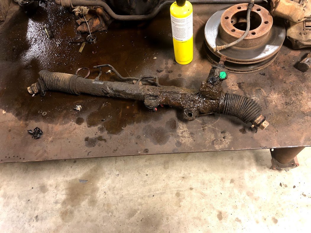

    Old shitty rack
    48s-2yyV1dE97disxpM2VEreo9eLaqF1HrMRe1a6_cdc2feca74644888ece1e97de0204d016aed9d27.jpg

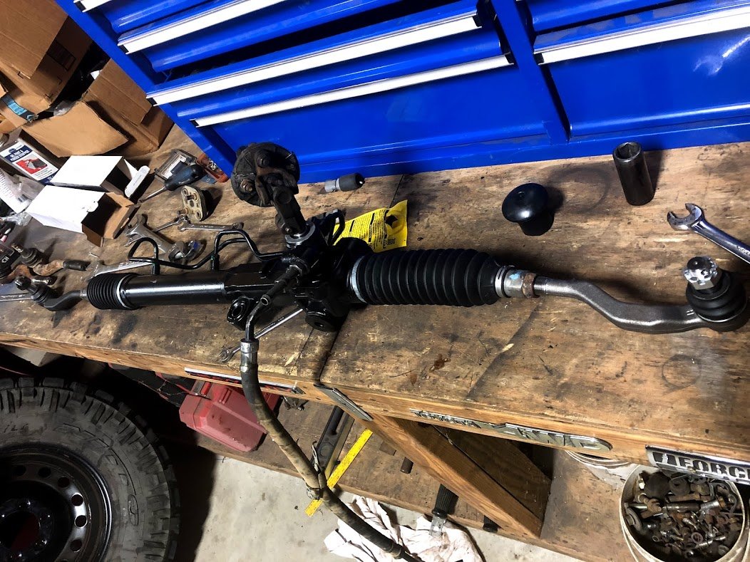

    new hotness
    lgbatCRieP5QQcSXm4LS5XAsIyfuPnGmxea0KRl-_edfb3f50f4ce1114077ae0ec0805b7a6e39df69d.jpg
    Im waiting on some Prothane bushings to come in from Amazon to swap out on this rack. The bushings on the old rack were nonexistent.
    easleycrawler and ChadsPride like this.

    i have never changed a rack before... what was causing the need for a new rack? age, issue while driving, or it just looked busted?
  9. Dec 11, 2019 at 8:40 AM
    #49
    the_white_shadow
    the_white_shadow [OP] Well-Known Member
    Jul 30, 2018
    #261052
    933
    Leaked like a sieve. Boots wore torn. Had 334k miles on it by the looks of it. Bushings were shot. It was time.
