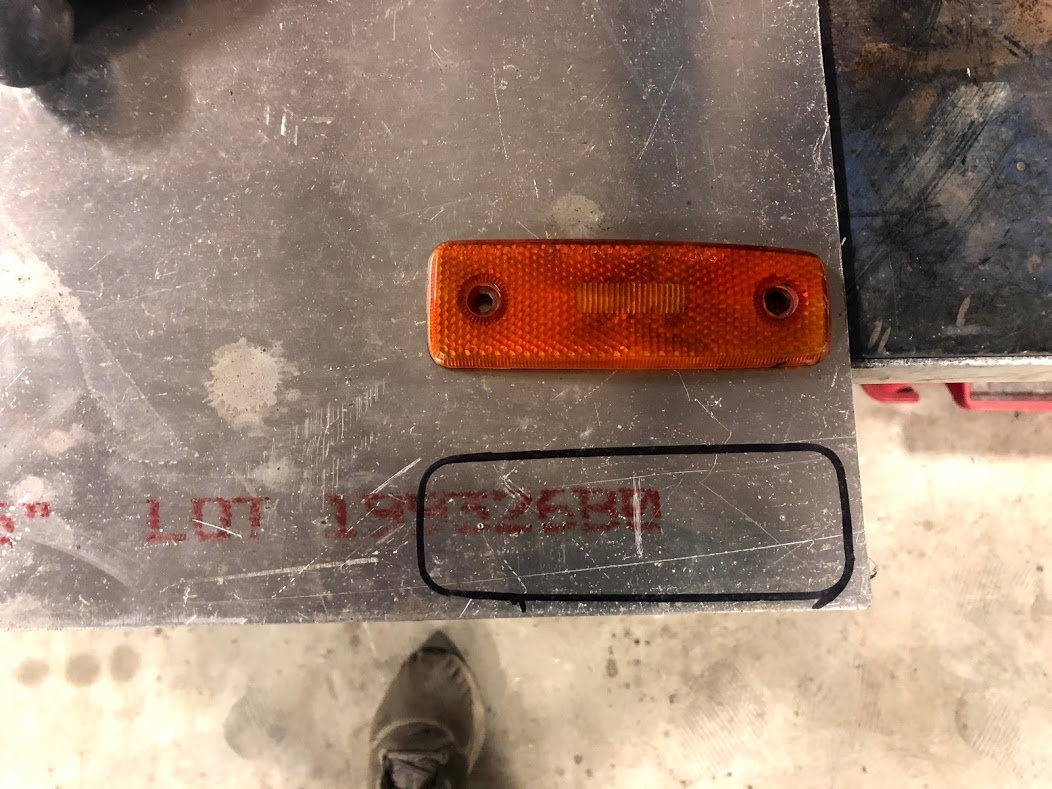

    Also made a few marker light adapter plates since the ones i had were beyond cracked and disintegrated. New gaskets and harnesses were like $50 per pair online so i decided to make my own. Im going to get my bud with a plasma table to draw up the file and make some more.

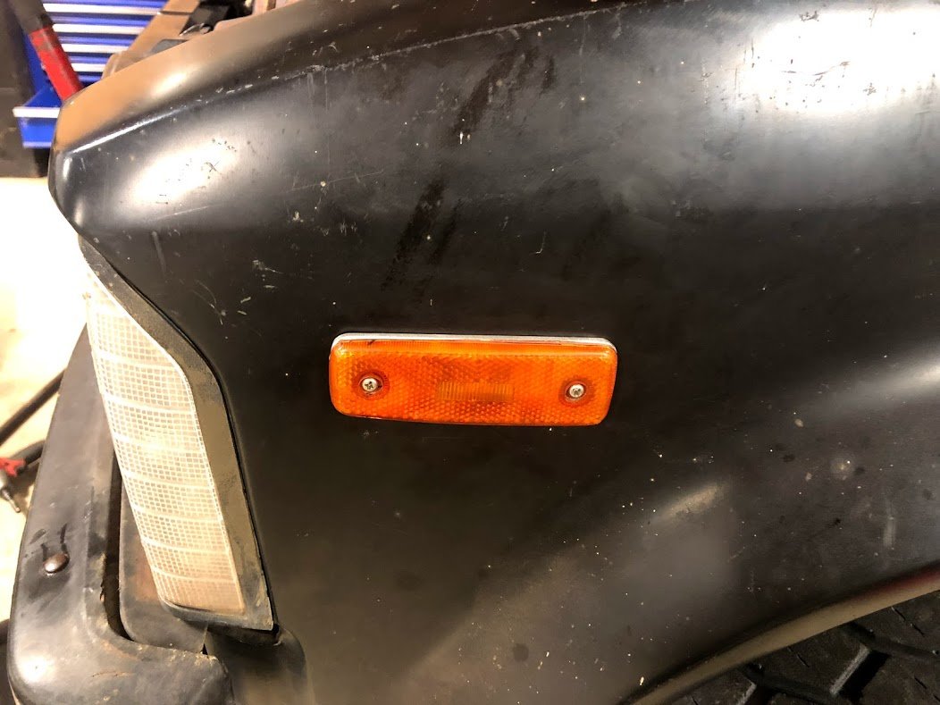

    Started by tracing the light onto some 1/8" aluminum i had on the ground. They arent perfectly square or symmetric. One side is a little larger than the other.
    bTcfnaYqed41vqUGfEp9P1lMwDp_Fch8KHl9bK41_0bec43ea50985eaf2fa859c6c80e1ed5aa618a1a.jpg

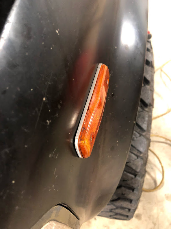

    Bought some 3/4" LEDs on Amazon and mounted them in. The two mounting holes are large enough that they go over the plastic square factory mounts to let the lens sit flush against the body.

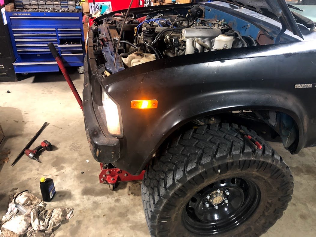

    And connected.

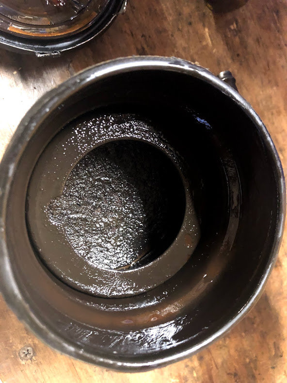

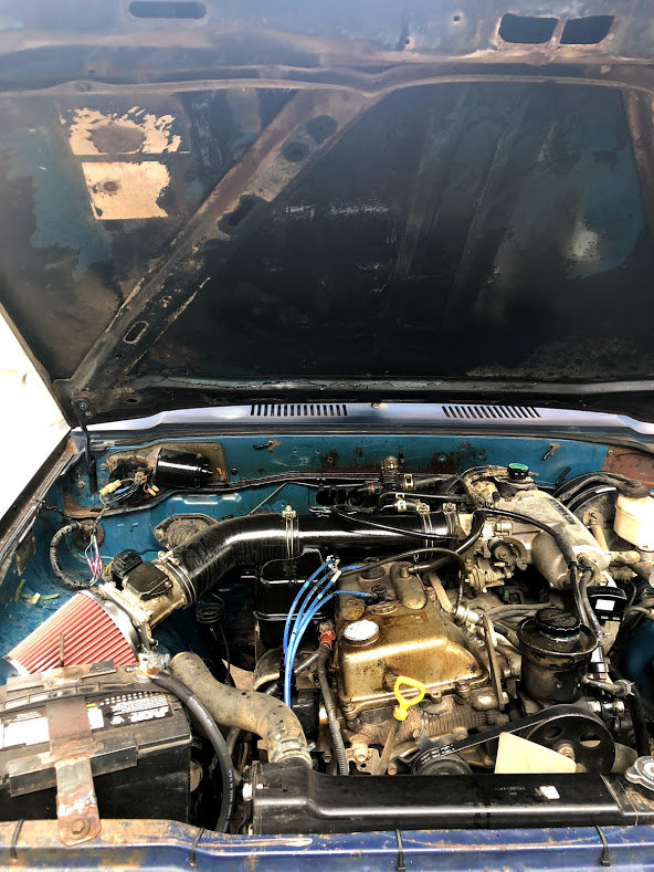

    I think i found the likely source of the whine.

    Some updates. Fixed the sludge shit as seen above ans now the pump no longer whines. Took it to get it aligned and it drives nice and straight at 70.

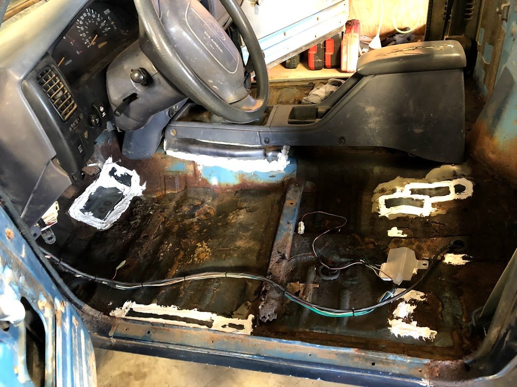

    Patched up the rust on the floor and seam sealed it.

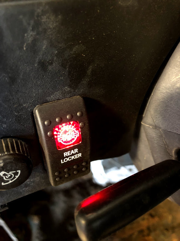

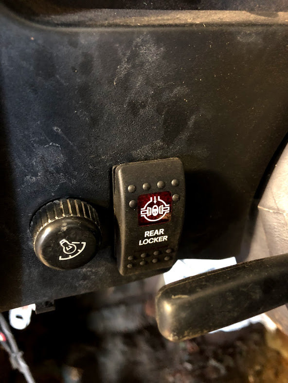

    e-locker wired in and working for those mall crawler days

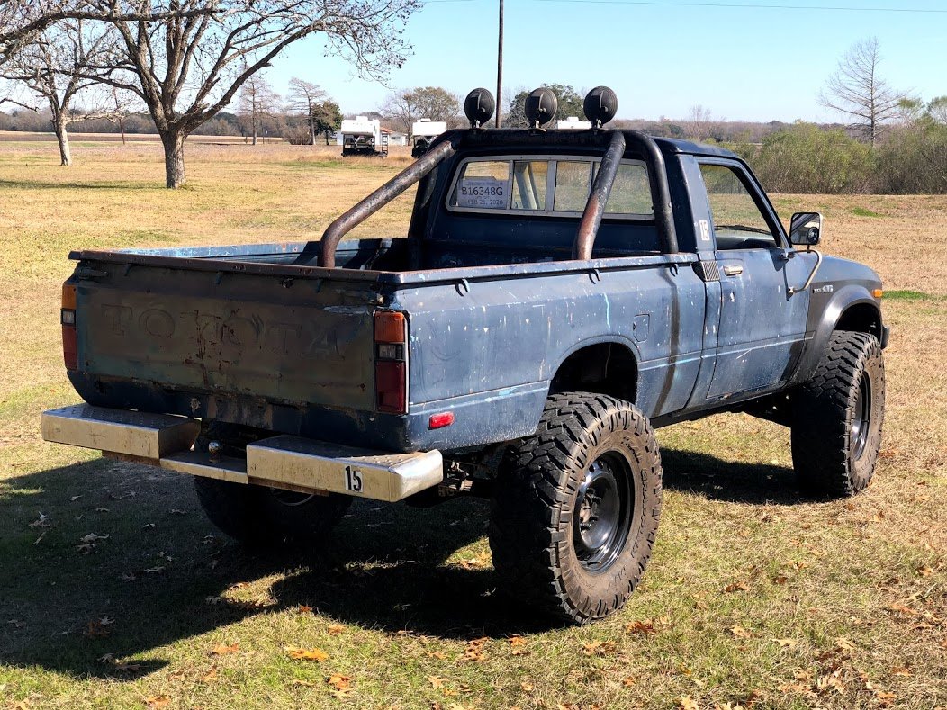

    Installed the OG stainless bumper and a 3rd light on the roll bar.
