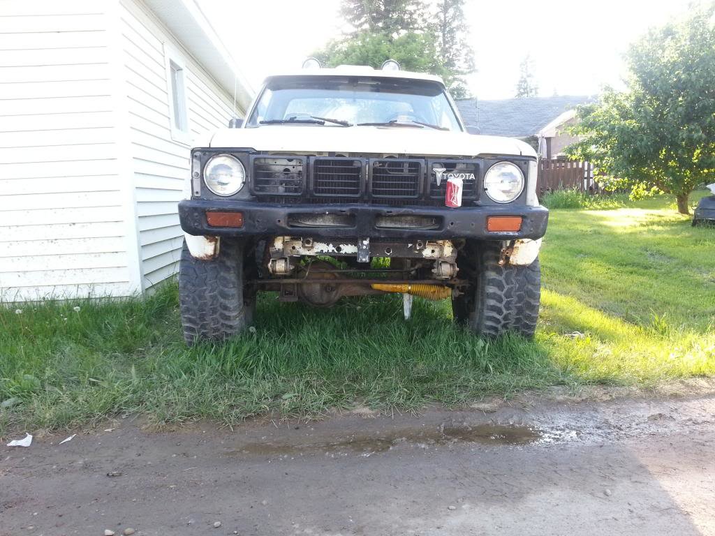

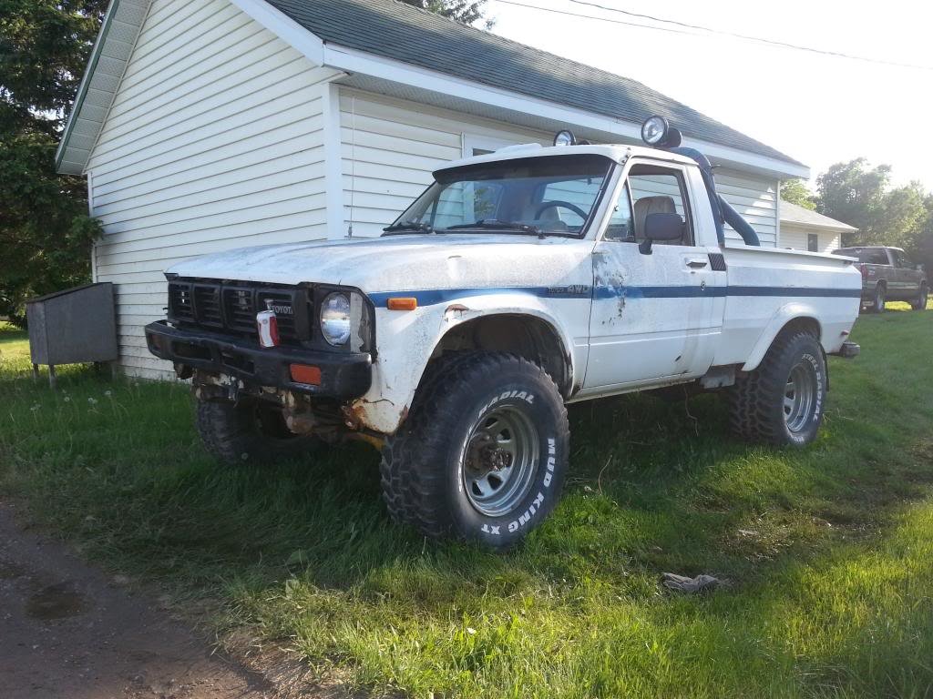

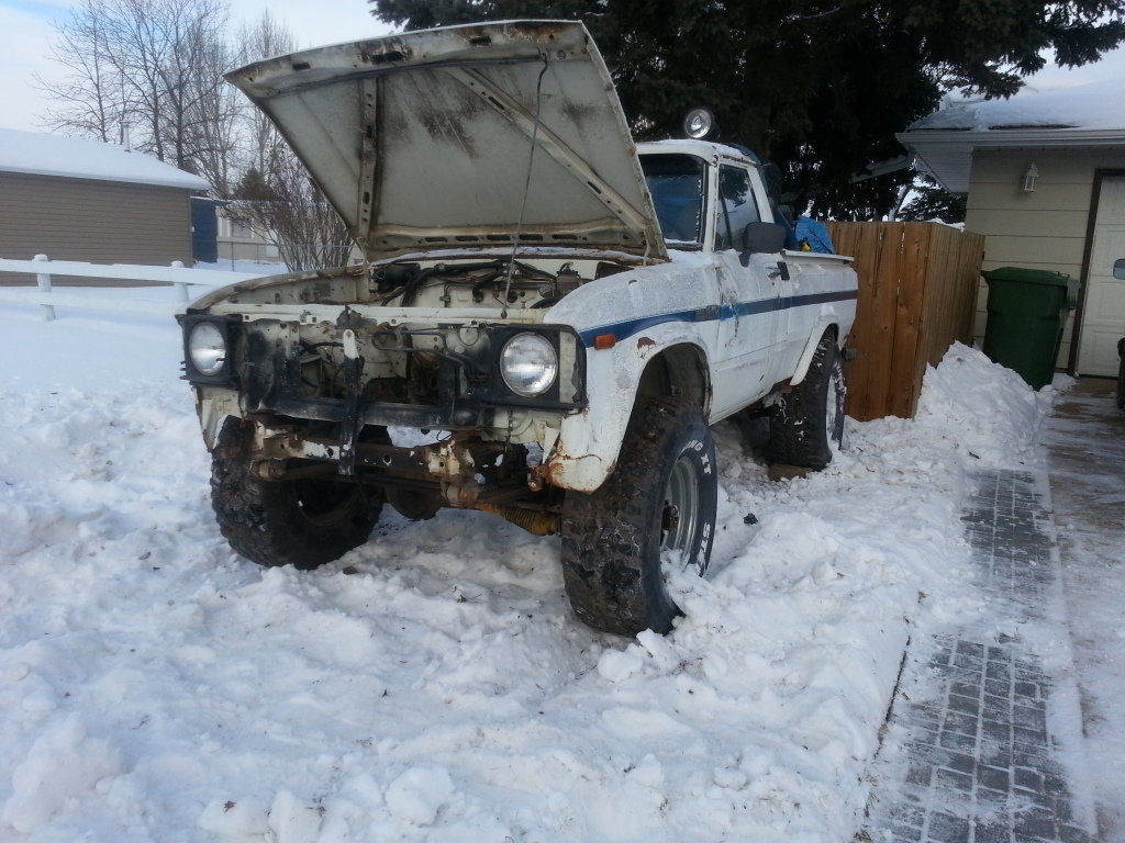

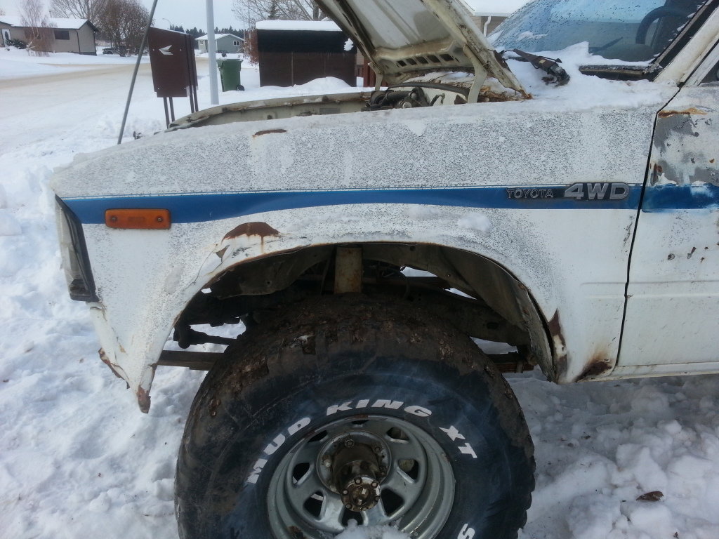

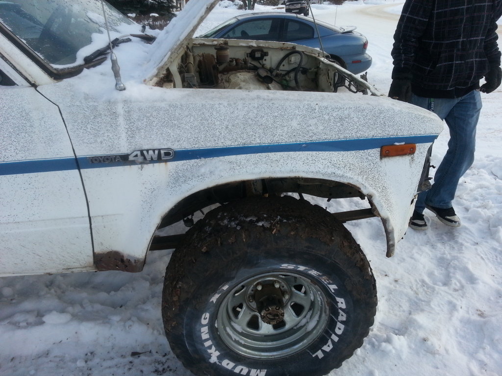

    so some of you know I bought a Toyota back in December. I guess I never got around to posting a build on it yet.

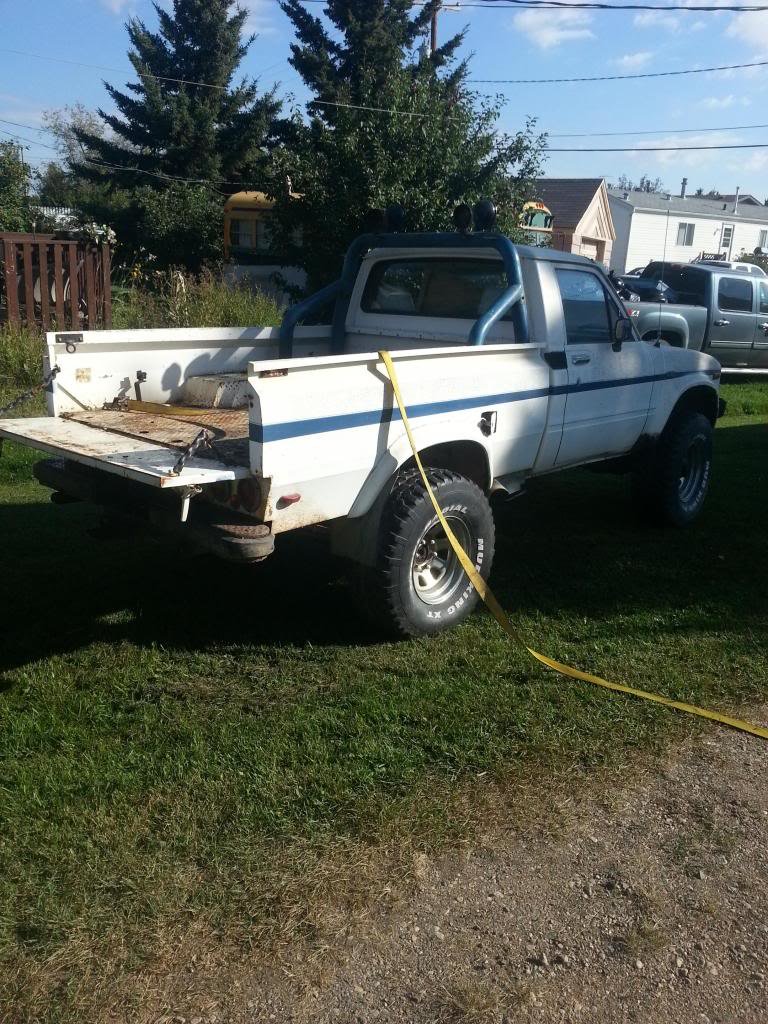

    the day she came home.

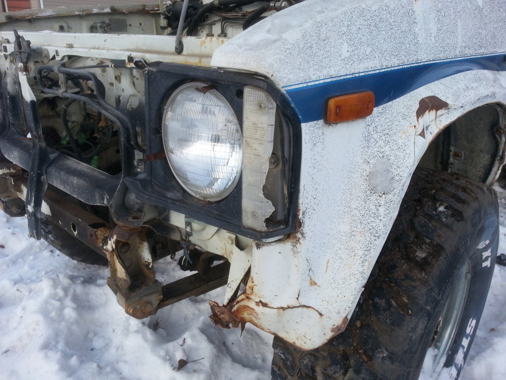

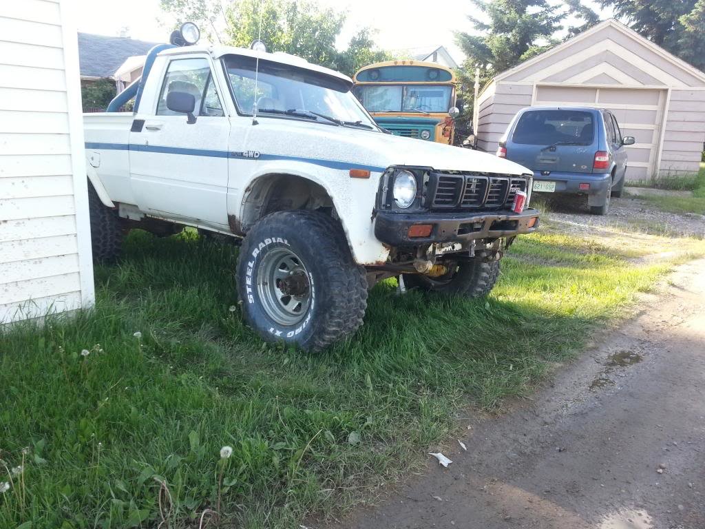

    few walk around pictures

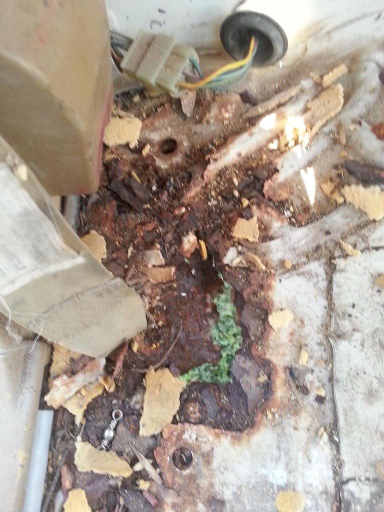

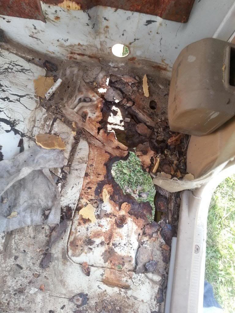

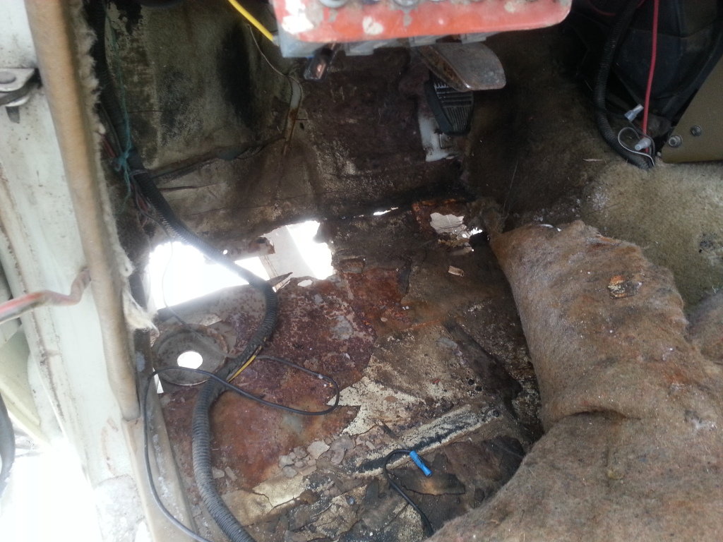

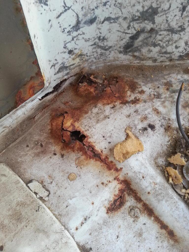

    so shes got some extremely bad floor rot. gonna have to cut the floor out and weld in some new metal. while im at it ill reinforsce the inner rockers as well and put in new cab mounts. I gotta replace two of the frame cab mounts as they are structurally done.

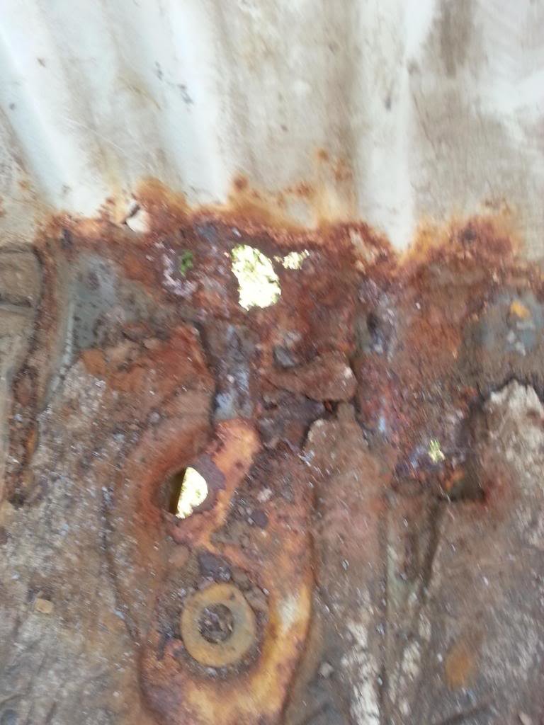

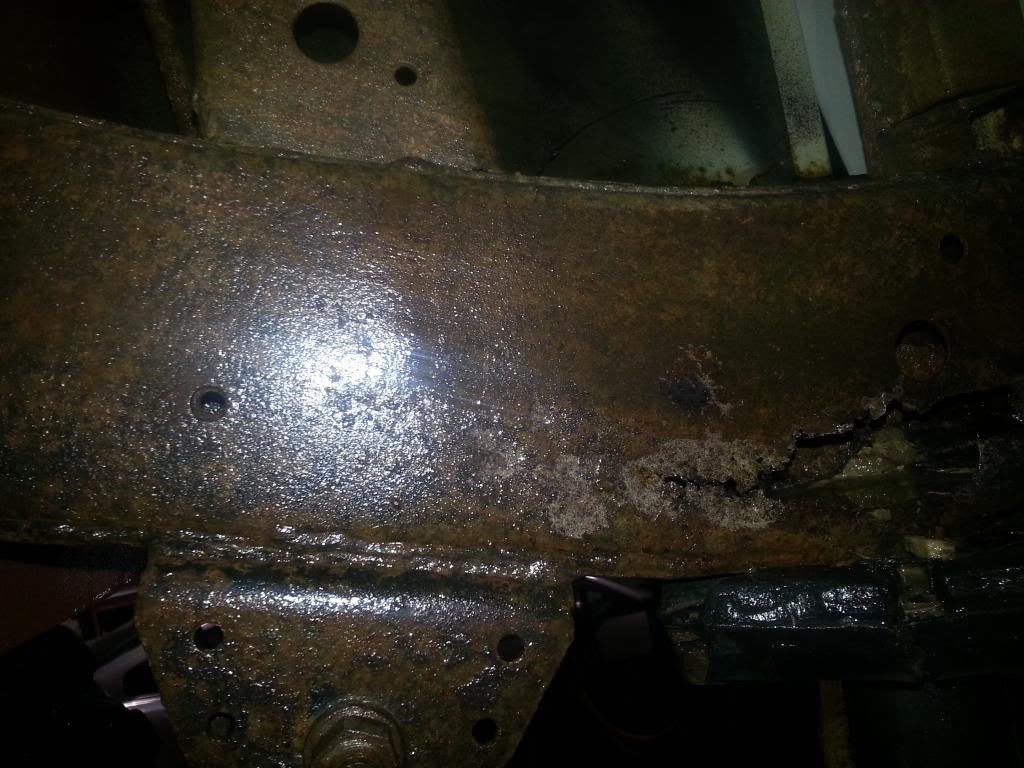

    I went and inspected the frame and was rather saddened. :( found this on the LH side in front of the rear front leaf spring perch.

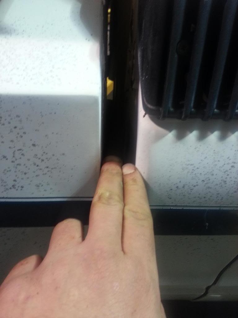

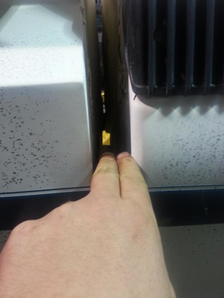

    while lifted on the hoist I fit two fingers between the box and the cab
    while rested o nthe ground its a finger and a half... so idk if I need to be concerned... is that to much frame flex?

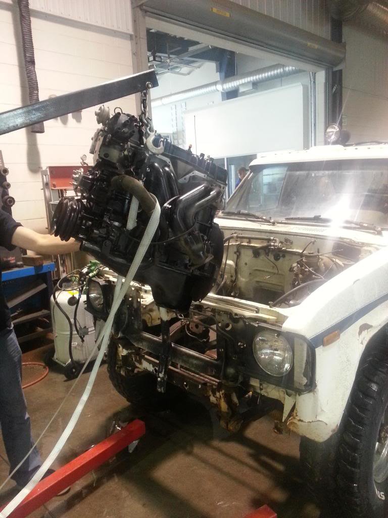

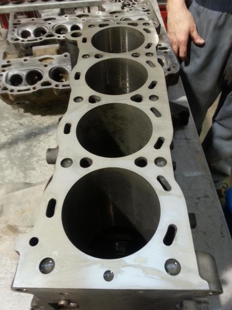

    while I was in college we rebuilt the old 22R.
    deck plained and straightened

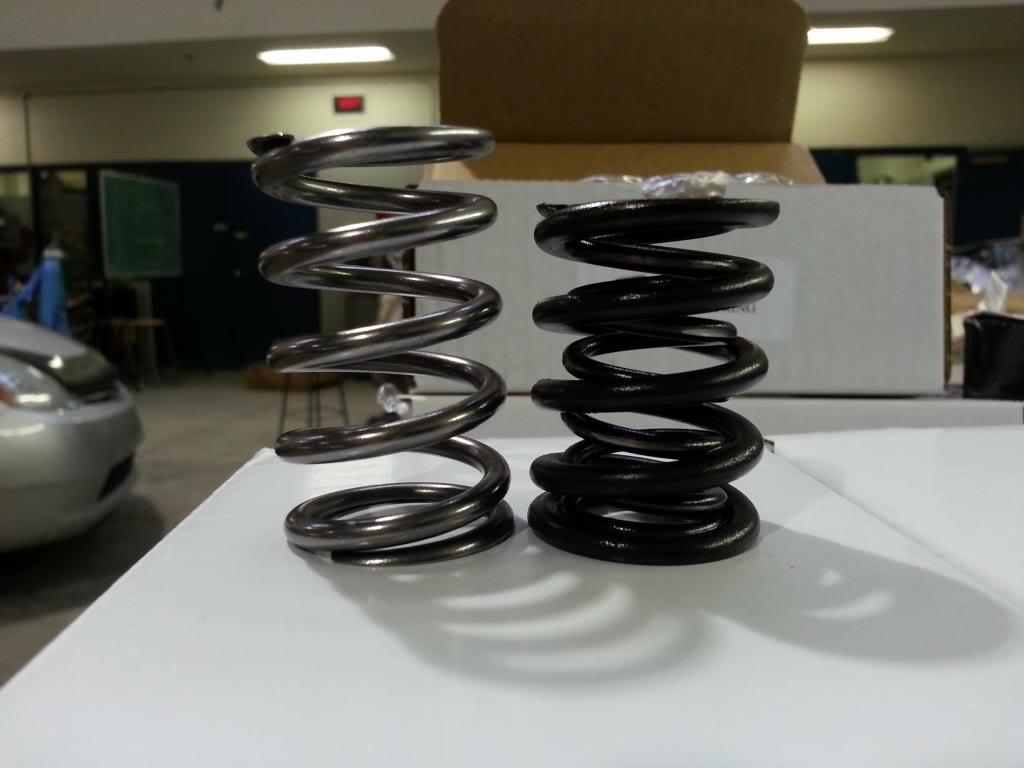

    stock comapired to after market

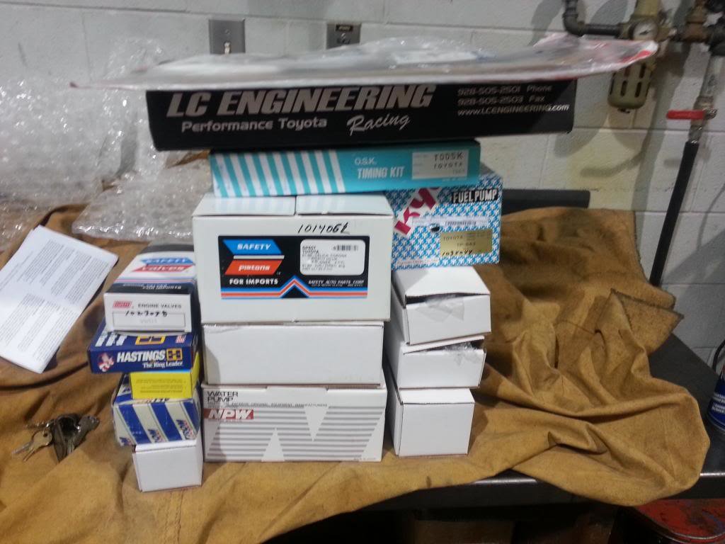

    the engine was bored .040 over already. so we bored it out and sleeved it back to STD. installed a small cam, replaced all the bearings and such.

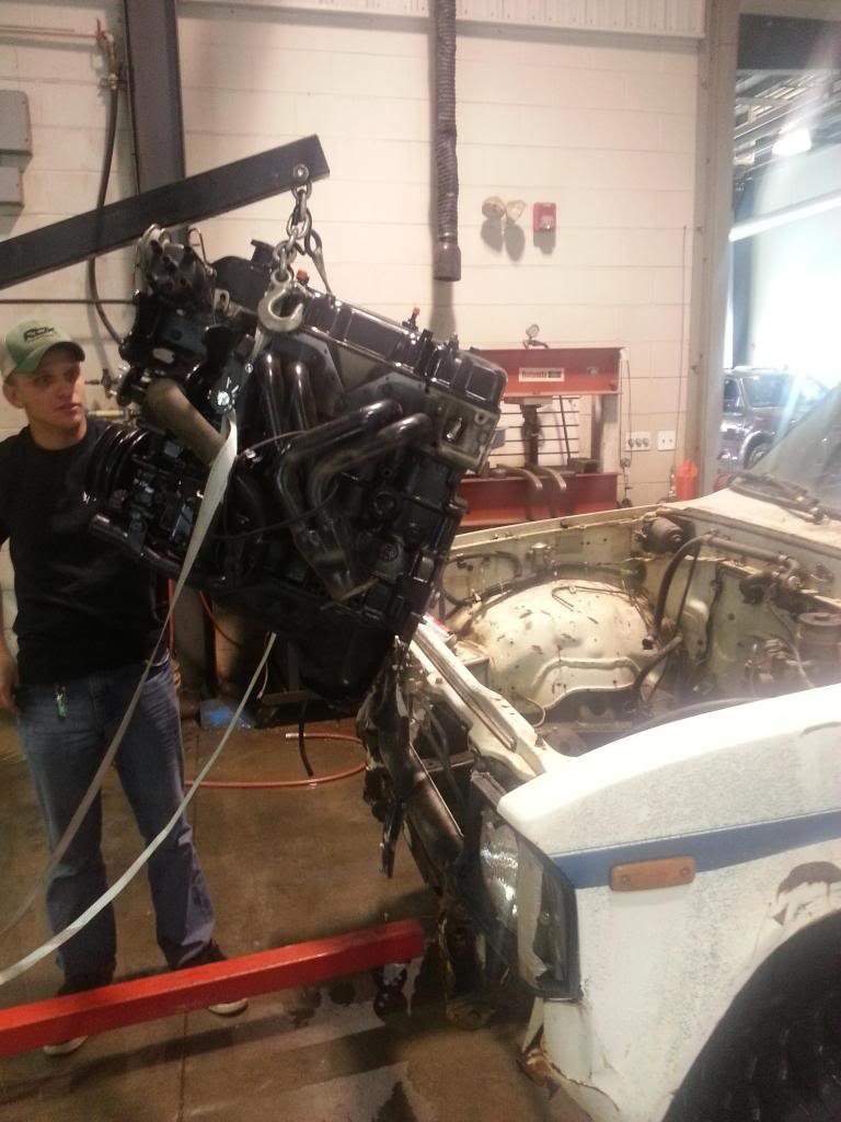

    this past weekend. June 15th 2013 I brought the truck to my shop and started working on it again. got the engine into her home.

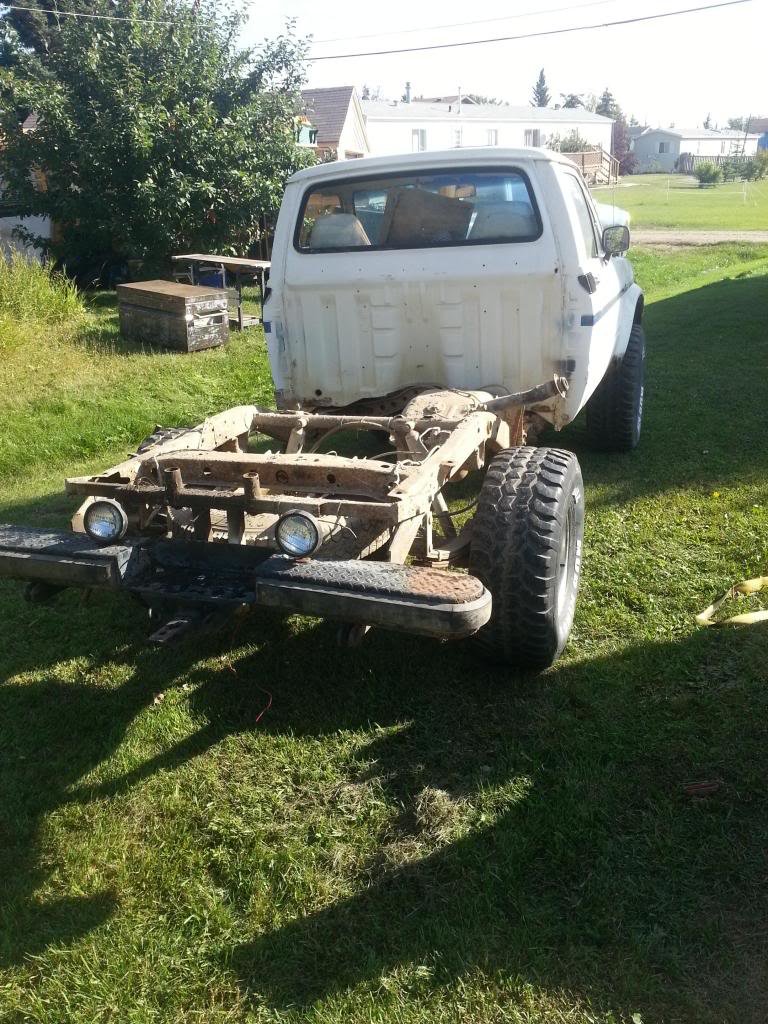

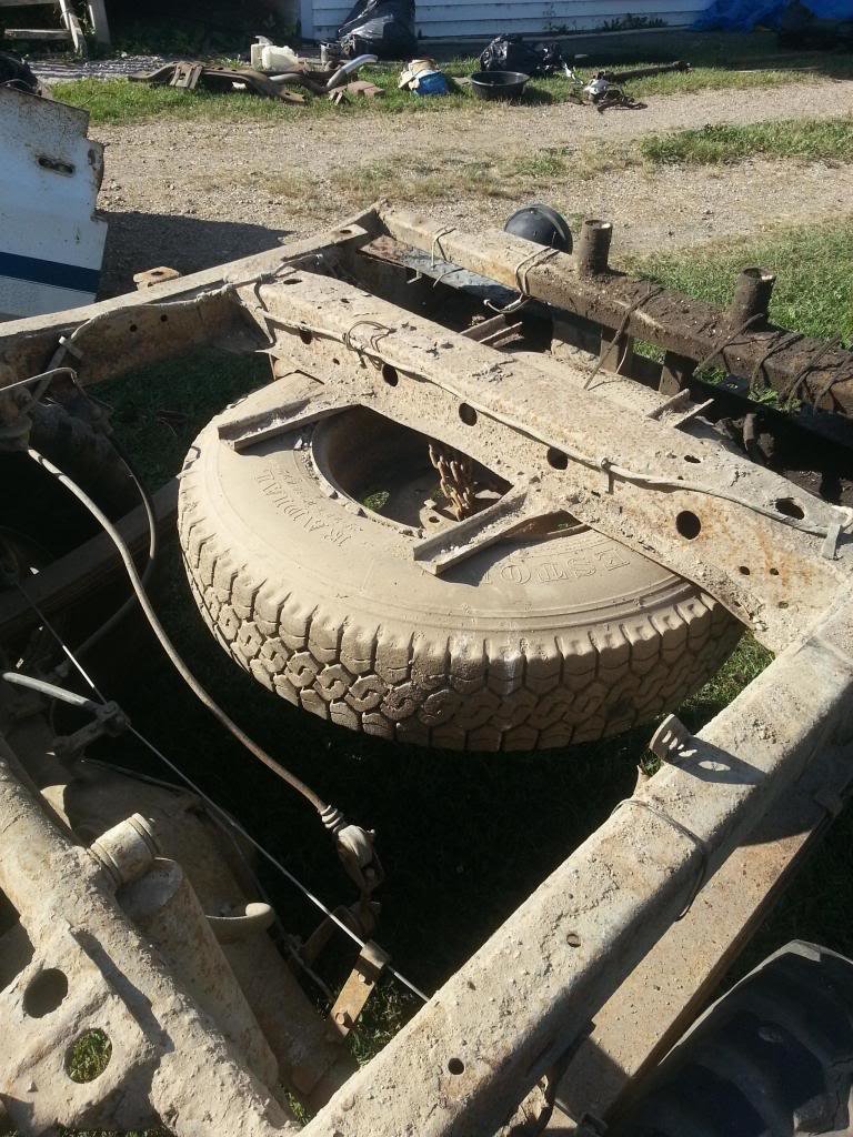

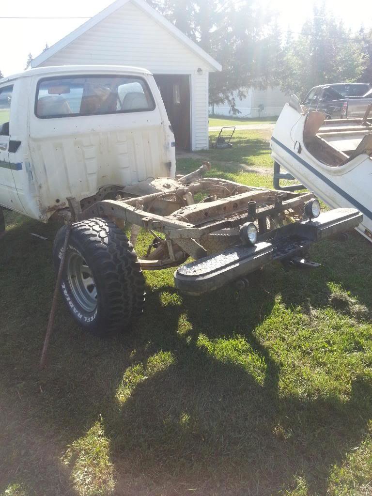

    Gonna pull the box off and access the extent of the rot. Got all the nuts and bolts off. So now I can pull the box off. I'm just going to build a flat deck. No need for a box on this unit for what I'm building.
    If the rot is to bad I might have to either find a new frame, or build a rear portion. Time will tell.

    UPDATE:
    well truck is booked in for october to get the frame finished profesionally!

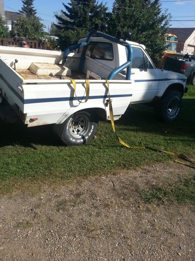

    Today Sept 1st the box and fuel tank will be coming off. :) i wanted 4 people to help, but i guess myself, my toy hauler and some red neck mechanics will work.

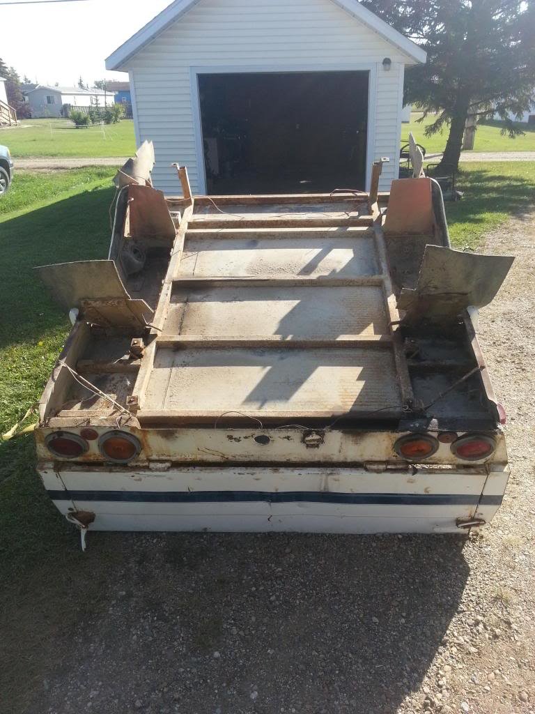

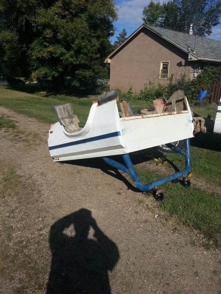

    heres some pictures
    oh and hell the thing that helped hoist the box off. :)
    Now i shall go out and remove the fuel tank and prep the frame. :D

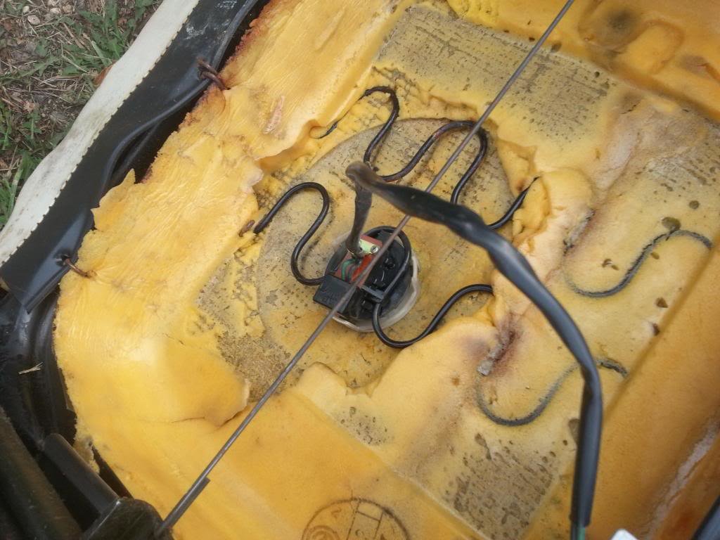

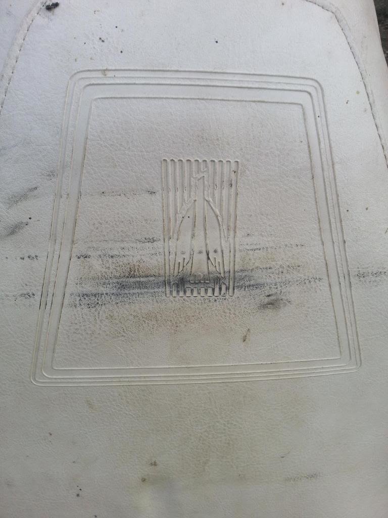

    blah... got the seats removed.... and what i feared... MORE cancer lol well looks like ive got some fabricating ahead of me.
    kinda a cool design on the back of hte seats. is that factory?
    and what the heck is this thing... it was only on the passenger seat
  16. Sep 2, 2013 at 6:43 PM

    Looks kinda like a pressure switch. Are those actually the factory seats?

    I'm not sure. It wasn't hooked up to anything. To be honest I don't know if they are our aren't. The guy who did me it was sketchy and I'm slowly discovering just how sketchy he was lol

    Never seen that on the back of any Toyota seats.
    I'm not even sure buckets were available in '81. Pretty sure those are transplants.
    From what, no clue... maybe a boat? White definitely would not have been used.

    That makes perfect sense.

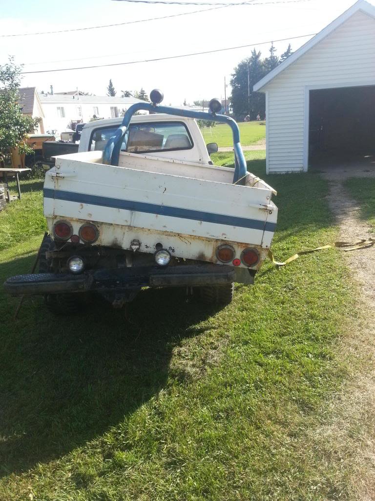

    Nice, I've never seen a tailgate/taillight combo like that before on a 1st gen? Doesn't look factory but maybe it is up there in Canada ? Cool setup!
