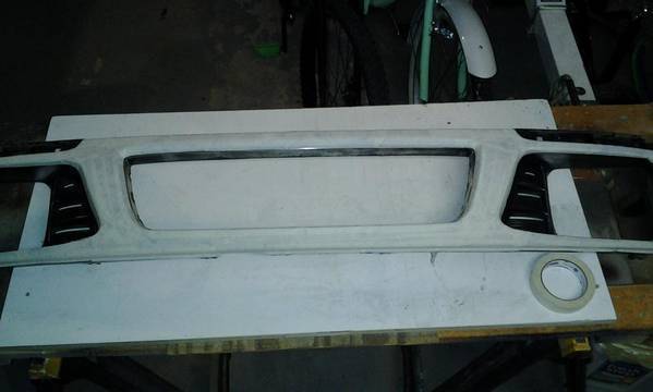

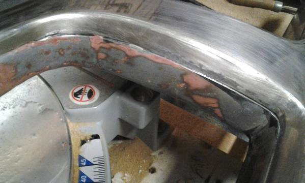

    I started by trimming out the center plastic piece. I used a hacksaw and a jigsaw and trimmed it close to edge. Then I sanded down the edges on the surround.
    I masked off the edge of the sides in prep for the fiberglass.
    I also masked off the front of the grille for protection from messy resin, etc...
    Next was laying down resin/fiberglass/resin (two layers of fiberglass).

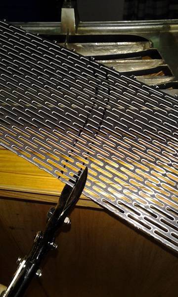

    While the glass dries I did a test fit of mesh and cut an inch offset from sides with Aviator Snips.
    Bondo time, on the edges. "It ain't no good unless you get it all over" as my pappy used to say.;) Don't worry about globs, it sands off.

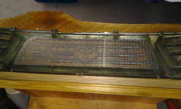

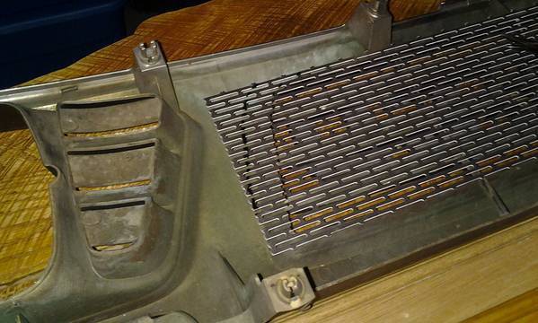

    I also epoxied some zip tie mounts to the back of the grille.

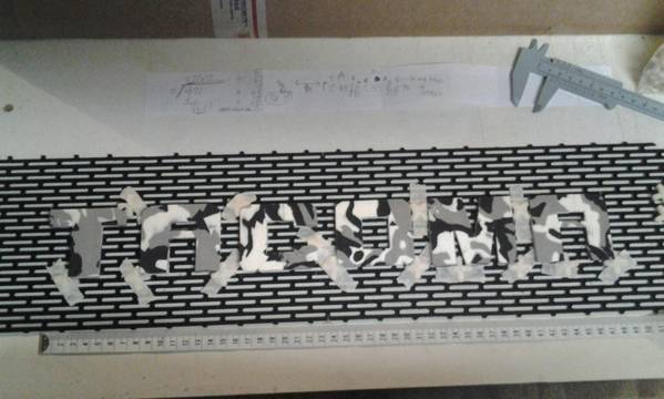

    Cut w/razor and spaced with tile spacers the Hydroturf Snow Camo letters. The turf has 3M tape already on the back.

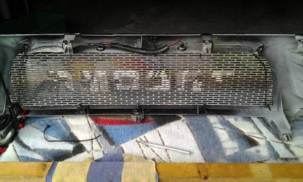

    Filler Primer, Sanding & Glazing time, followed by painting primer, semi-gloss black, clear (two coats each).
    While I had the grille removed I installed two amber LED's and added wires.
    Next I zip tied the mesh to the grille surround w/mtg tabs that were epoxied to grille plastic.
    I added the Hydroturf letters to the mesh prior to zip tie install. It has 3M tape already on the back when I purchased this mat mat'l.
    And the final install on the truck. Next up is to finish the Raptor LED's.
