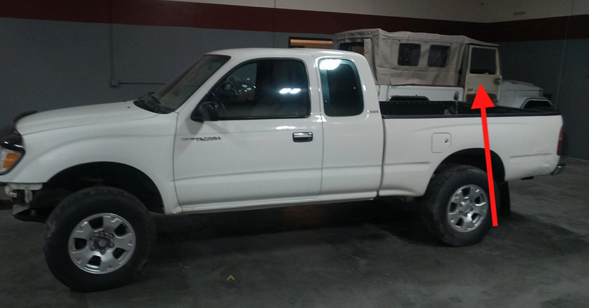

    Nice project, more importantly is that a BJ45? And an 80 series in the other pic?

    That's my boss's Bandeirante resto-mod project. It's sitting on an 80 chassis with a custom soft top currently. We got the drivetrain moved forward 11" and built the tunnel and floorboards but had to stop because business picked up. The 80 is a customer's truck. We built a front bumper and it's currently waiting for a rear.
