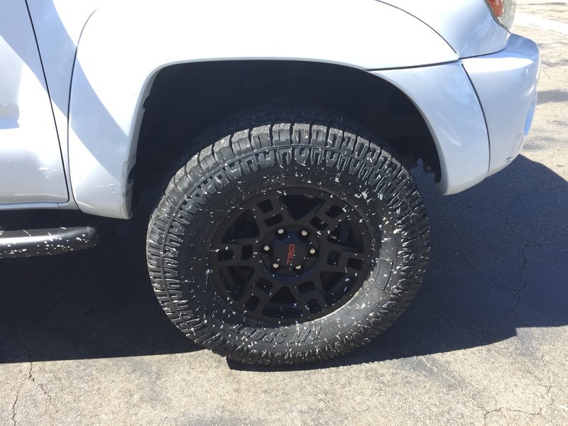

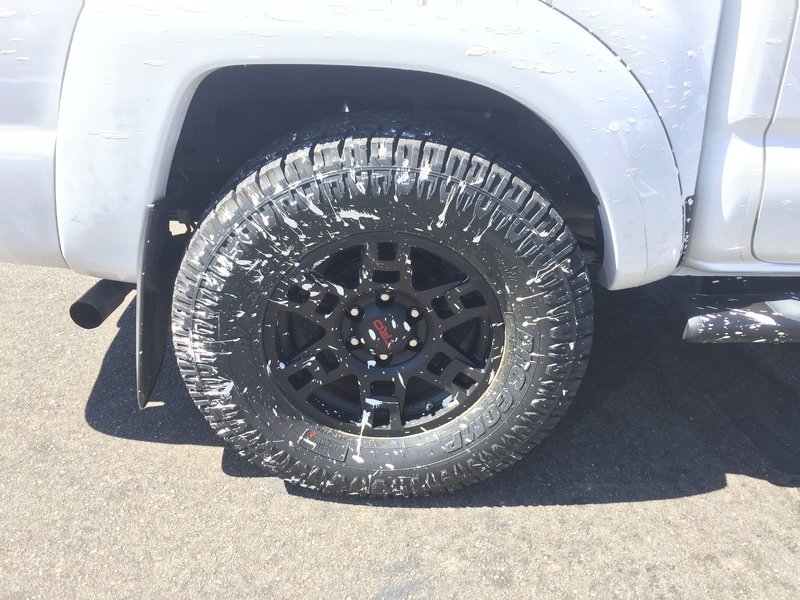

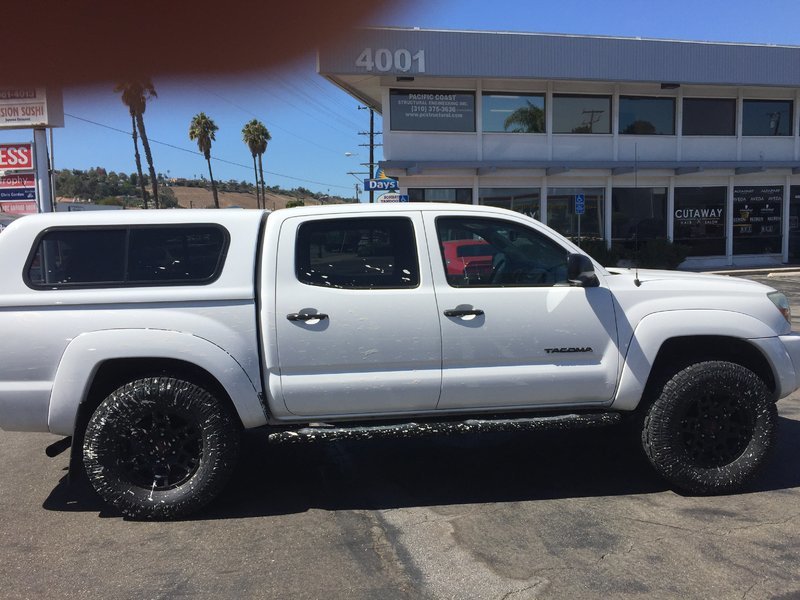

    It is definately water based, I was able to power wash it off the body only, I think the paint got into the matte finish.

    WD-40 the hell out of the tires and get a gallon of goof off. Take the rims and tires off and soak the shit out of some rags with goof off and set them in the rims. My daughters car got vandalized with spray paint and thats how we got it off. WD-40 and goof off.

    Do you think that will take off the matte finish of the rims at all?

    My daughters rims had a gunmetal finish on them with black spay paint on top. Her car is white and it got spray painted black. It all came off with no damage to the paint or the rims. Disclaimer time your experience may be different. It has to be better than the someone blew their wad on your truck look. JK good luck

    You need to figure out what kind of paint it is first.
    Use a pocket knife or something to carefully peel a few blobs of paint off the tires. Because the tires are flexible and easier to do that with.
    Put the blobs in various small containers of solvents and see what softens the blobs.

    Serious note, bring it back to the tire place and have them flip the tires?
    For the steps, plastidip and call it a day. :notsure:

    Try Brillo pads on the tire. The blue ones with the soapy stuff. I got paint off tires with it before. I was the guy who drove thru it in front of a new car....:anonymous:
