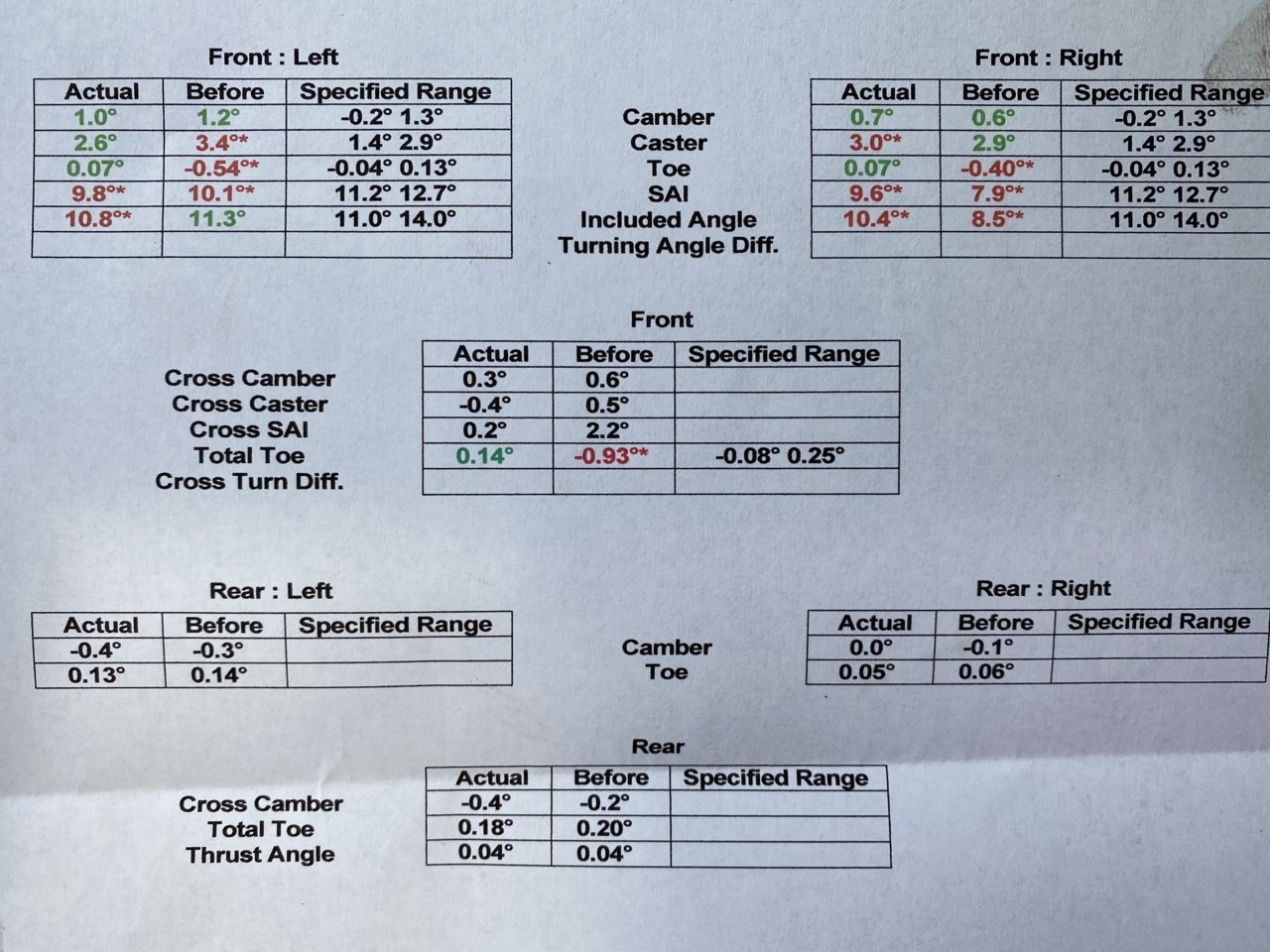

    Had the eibach pro lift, Icon AAL and SPC control arms installed and after I had my alignment done Iv noticed the steering wheel doesn’t return to center as fast as it did before. I also went up a size and have a beefier tire so that could contribute.
    it returns to center but I notice it’s not As snappy as it was before.
    Truck tracks strait on the highway.
    Does this alignment look ok?

    Personally I don’t like that they didn’t get toe and camber to zero. That should have been a none issue. Also I prefer more caster. I’d say it was a mediocre alignment at best.

    according to that, you had a wildly toe-out alignment before. not sure that was the actual reading before, maybe that was saved during the alignment process. but if that's how it was before that's like race car toe levels. the tires were pointed outwards. OE factory spec is 0.05 inward.

    That was after I had my lift installed. The previous shop eye balled it so I could drive it home for the night and get it aligned today.

    Probably not gonna cause any drastic tire wear, technically it’s in the green. Just sucks that the alignment guys didn’t do a better job. With the spc ucas they should have been able to dial in all those adjustments perfectly and it appears they were just to lazy to do it perfectly, they saw green and called it a day.

    SAI and included angle look wonky...

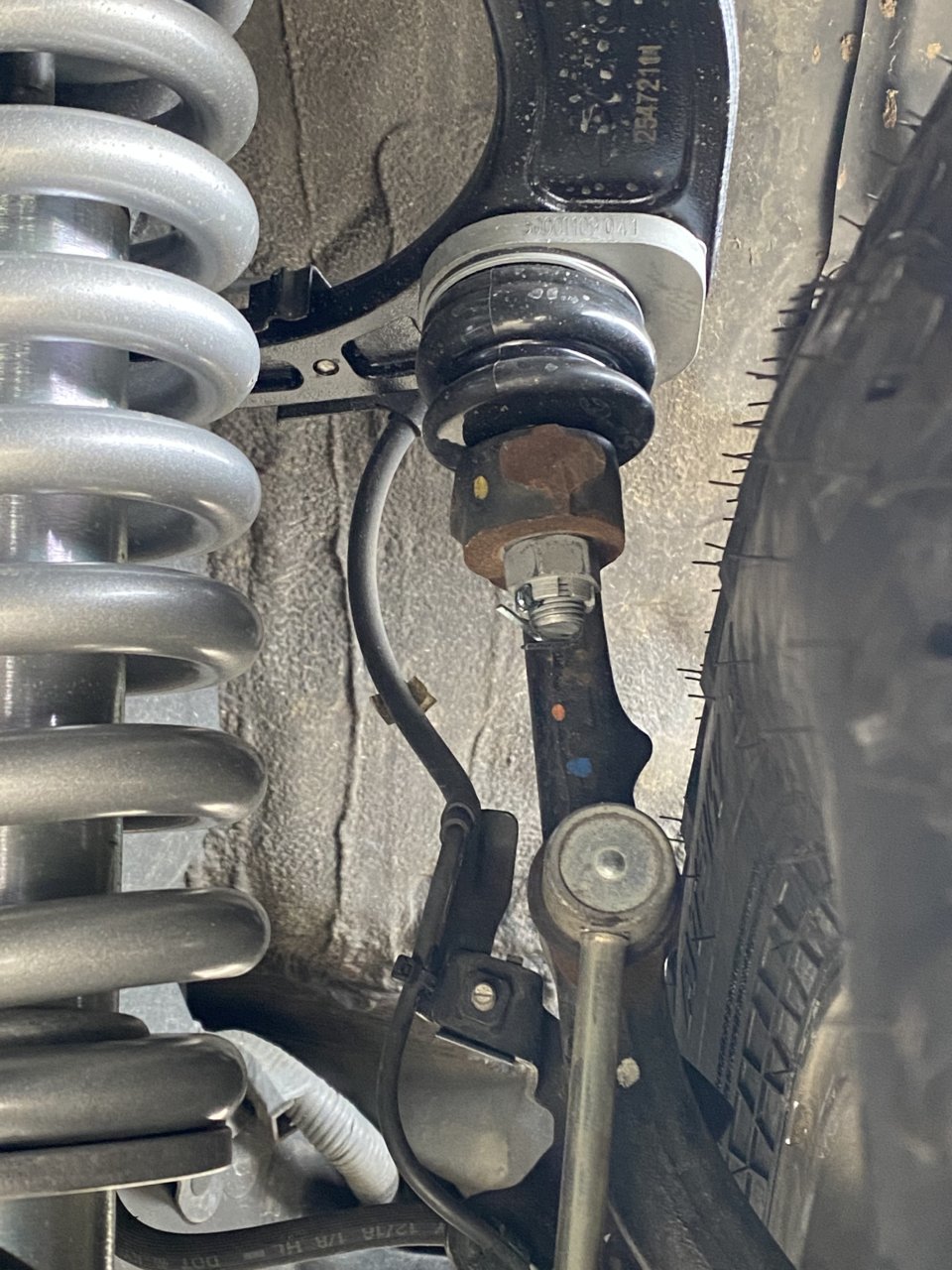

    Post pics of SPC alignment tab/ball joint?

    279
  10. Mar 11, 2020 at 1:35 PM
    Mitch65
    Mitch65 [OP] Well-Known Member
    Jul 22, 2019
    #299934
    279
    Is that what your talking about?

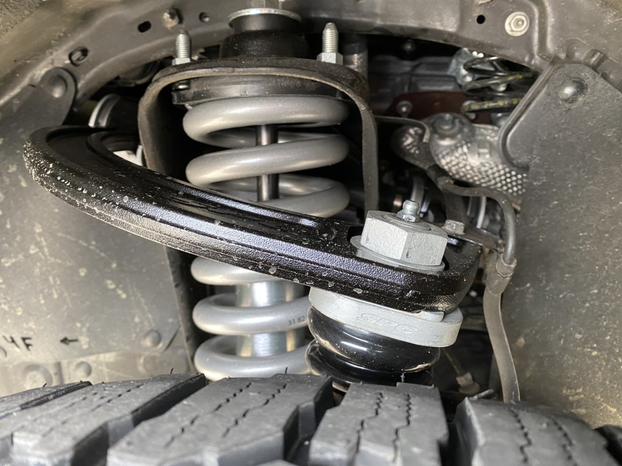

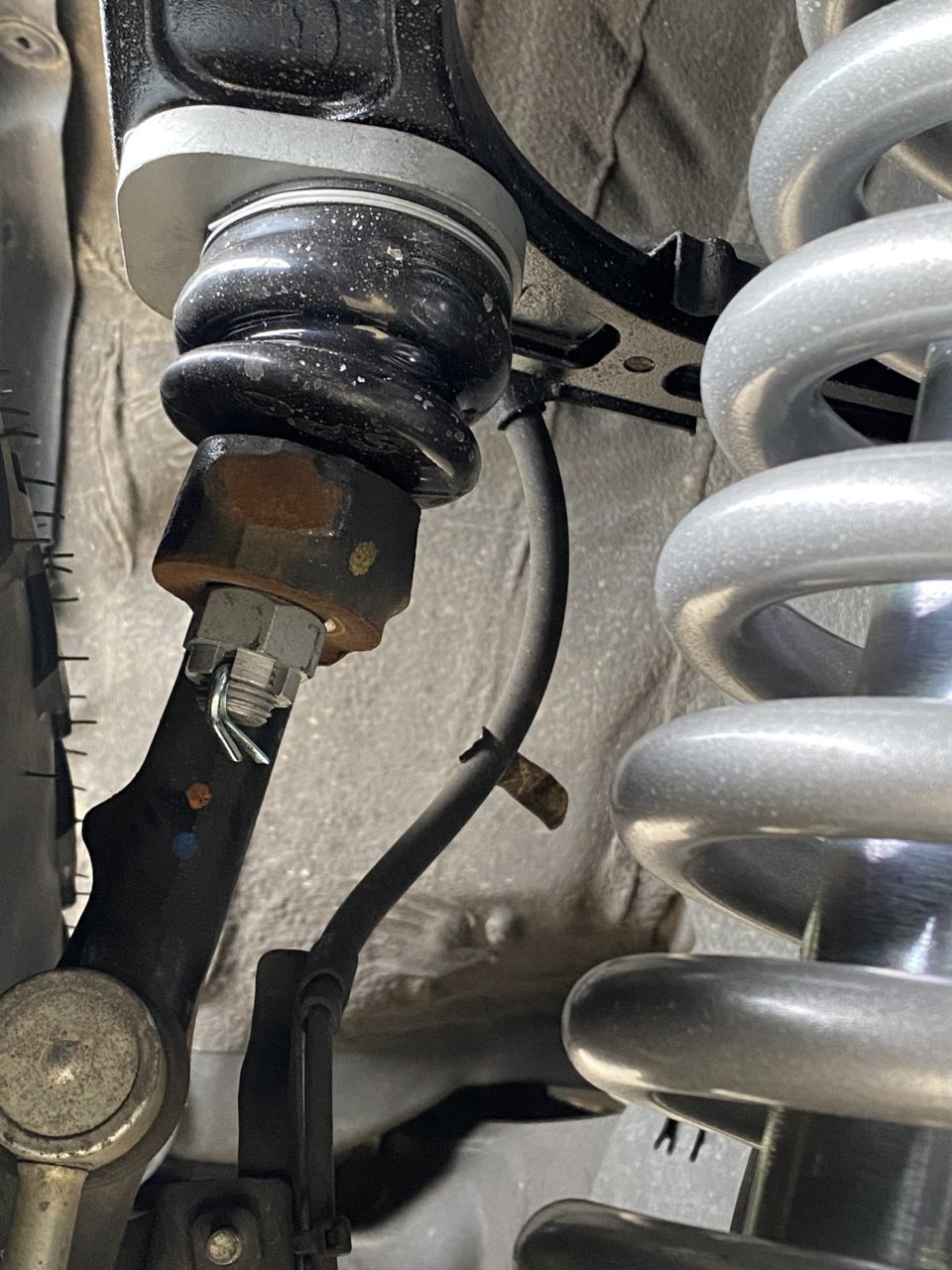

    No...from the side; pic of the logo on the alignment tab.
  12. Mar 11, 2020 at 1:41 PM
    Mitch65
    Jul 22, 2019
    #299934
    279
    Better?

    Yeah...it's not what I thought.

    Alignment plate not orientated correctly.

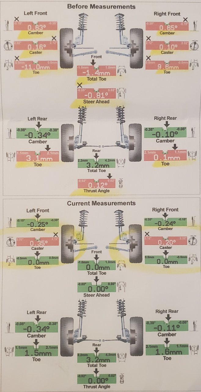

    I just did the same yesterday, so I'll add my point of reference for the discussion and the next traveler who wonders across this.
    I did OME888, Dakar Heavy, 5100s. I opted not to do the UCA to see if we could get it aligned. If the were 1/3 the price, I would have just done them.
    Now the alignment. Note, this is a reputable shop that I got many recommendations for. It also was a bit on the pricey side. They took into consideration my weight, driving conditions and the fact that I did not have my camper shell currently installed (note the slightly negative camber).
    I am now full team UCA on this class of lift, and will be picking some up. The caster is just too negative low for my and my shop's liking (not to mention out of spec) and it definitely comes through as not liking to center or stay center. Otherwise, perfectly drivable.

    Did they even make an attempt at caster?

    Yeah they said they did their best, but with OEM adjustment points, they got it as far as it would go without impacting targets for toe and camber
