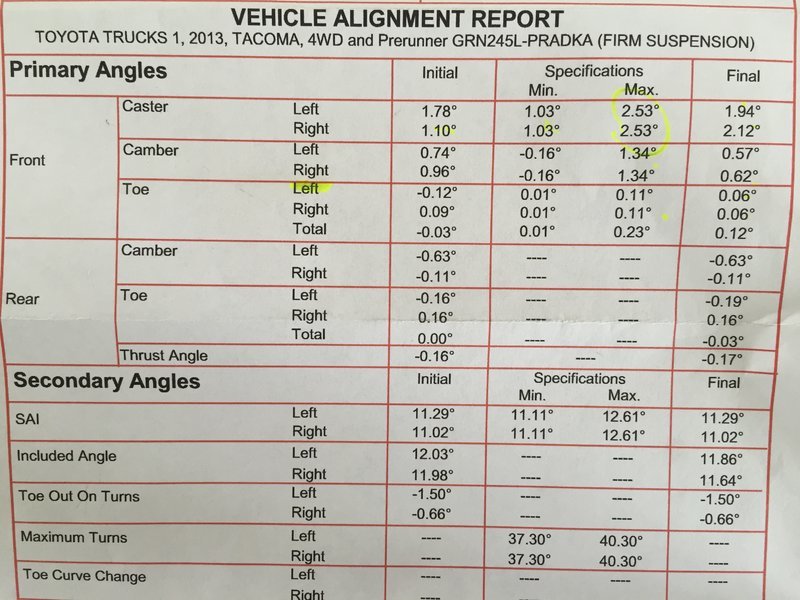

    Wanted to confirm with you guys to see if the results of my alignment were good.
    Bought new tires so I'd hate to start getting uneven wear.
    Any and all feedback is greatly appreciated.

    Your tires will wear great with that alignment. Caster is slightly lower than I would personally want, but I'm assuming this has a ~2" lift on stock control arms so it's not bad.

    You are correct sir, 2 inch lift on stock UCAs. I was demanding more caster as well, but I'm sure I'm limited on that with my set up.

    I noticed my truck pulls to the right now.
    Got brand new BFG KO2s along with an alignment this past Saturday.
    Any thoughts?

    Adjust air pressure ,my guess.

    Ill double check that, thank you!
