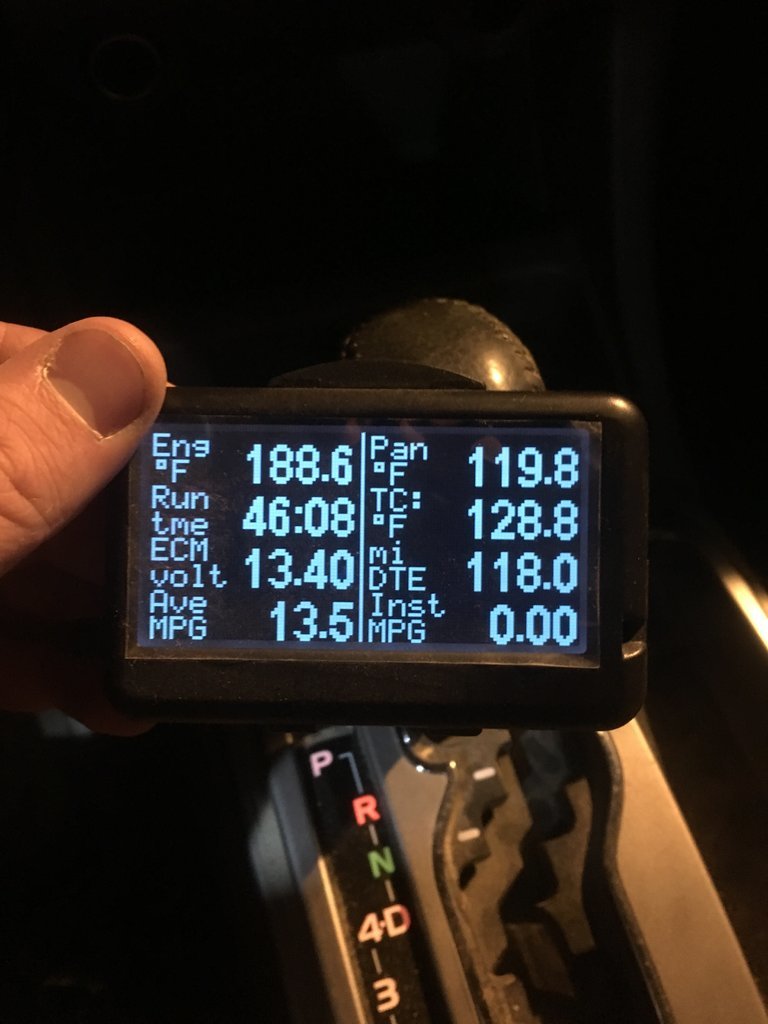

    Ultragauge, my friend..has both.
    PapaBear and 07 sport 4x4 like this.

    Actually it doesn't show oil pressure, it does show voltage though. My understanding is that the oil pressure sensor/sending unit is basically an on/off switch, if it's got some oil pressure it turns the dummy light off. If the dummy light comes on you have basically no oil pressure... it's too late. IMG_4688.jpg
