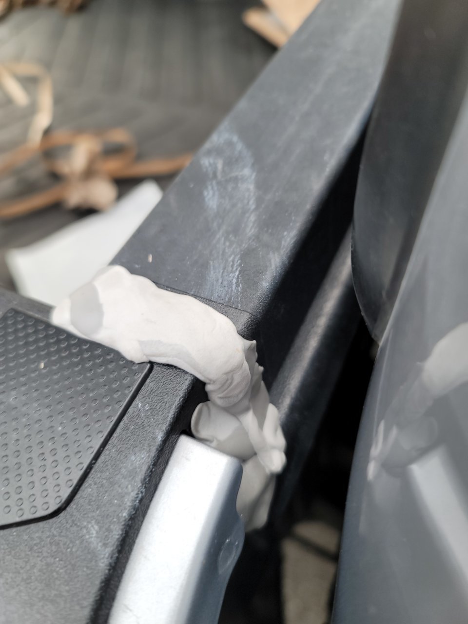

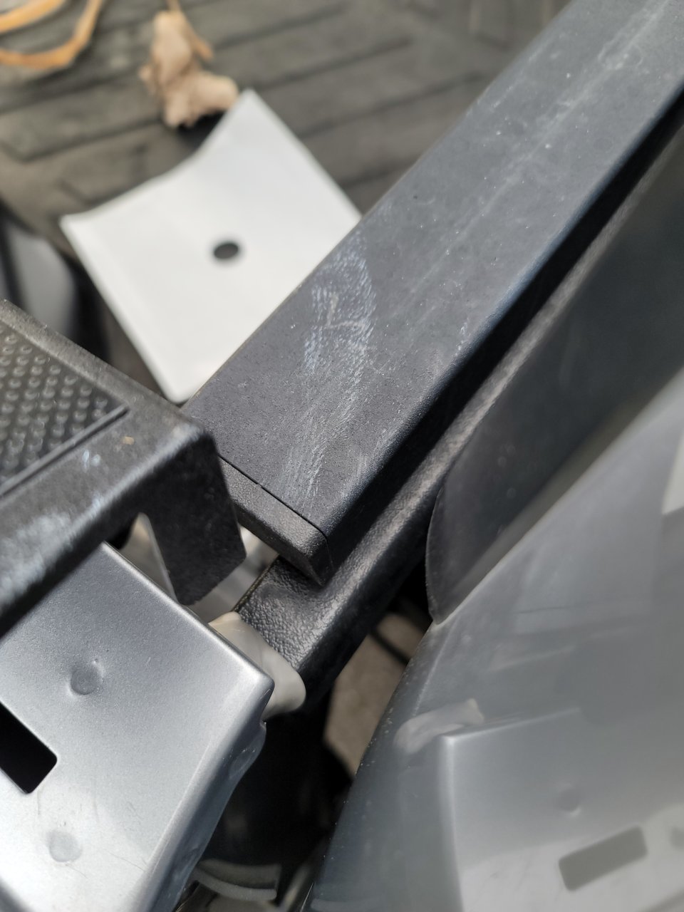

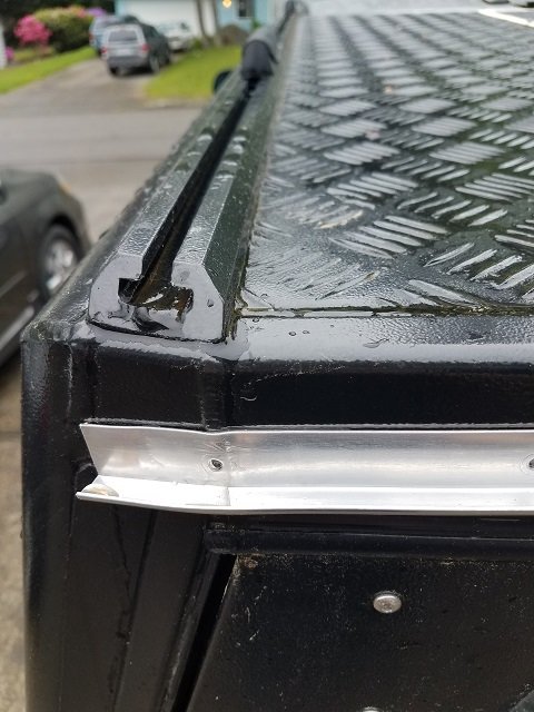

    I've had another issue with water being channeled by the roof rack tracks when the truck is parked on hills. The water has been running to the roof rack track which then directs it aft. It runs down the back of the truck right at the gap between the canopy and back hatch. In my case, it was somehow collecting in the trough inside and at the bottom of the hatch. The result was that when you opened the canopy you received a drenching that would also get anything near the tailgate wet. The water is somehow working around the seals in the area. I've tried several times to seal the joints better, but I think I'm at the point to where there's not much else I can do. I wound up installing some aluminum rain gutter trim that was leftover from my teardrop trailer build. It catches and redirects water running off my roof so that it goes outboard of the tailgate. You can see the aluminum trim in these pictures:

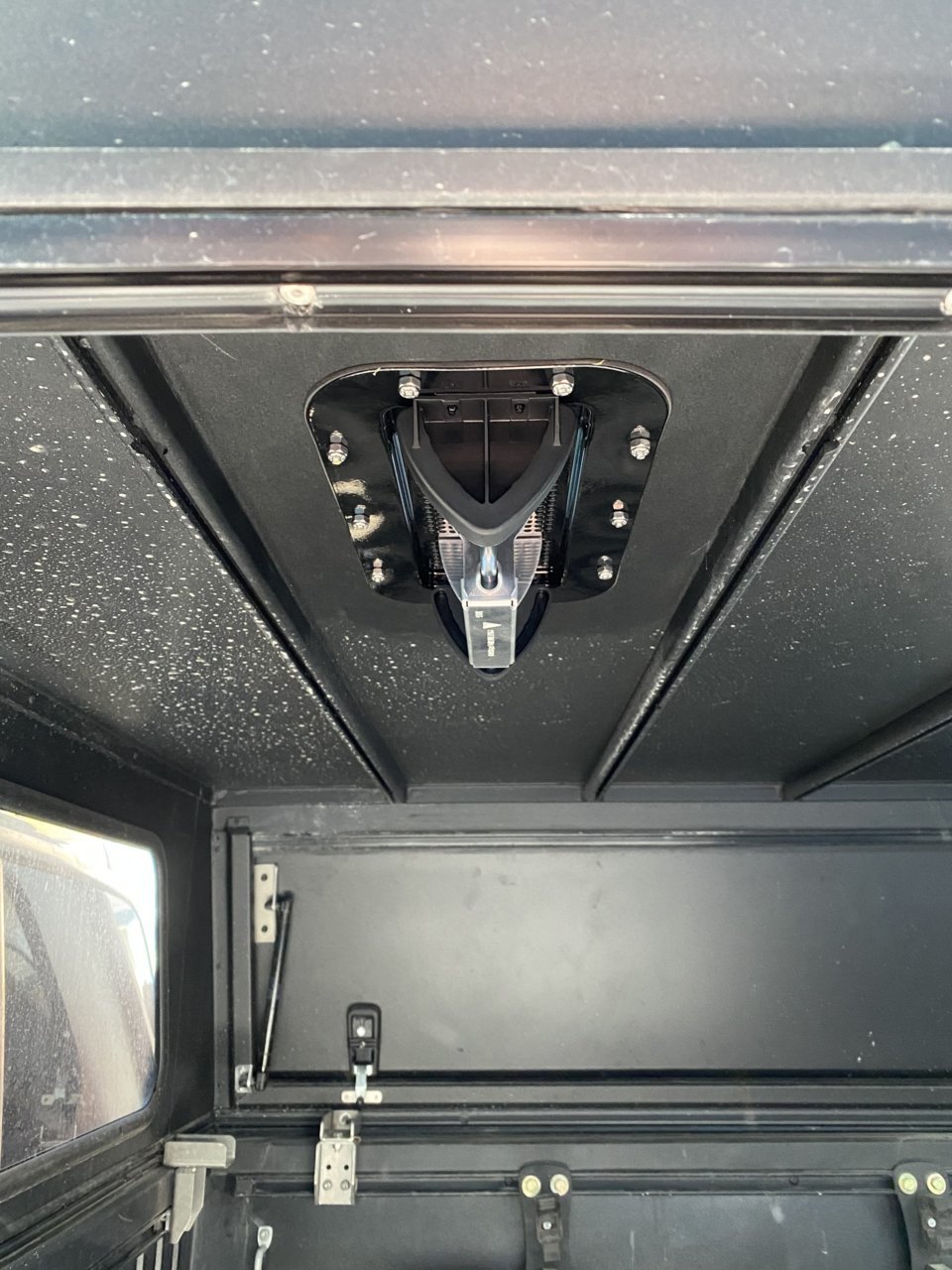

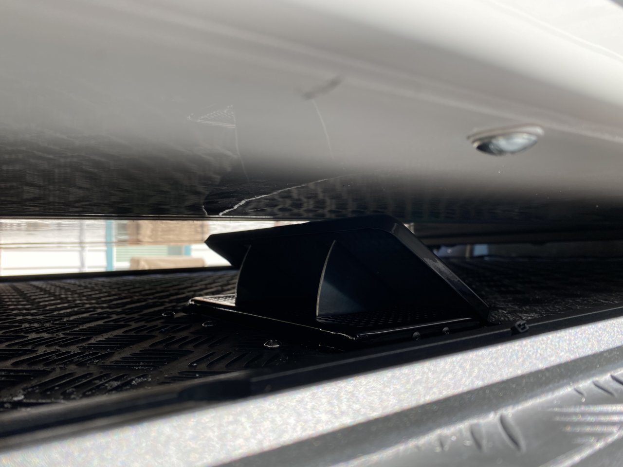

    Now for my final point. THE DUST. This is more an issue with the Tacoma beds and not the shell but holy shit the back gets dusty and there’s no amount of weatherstripping that will solve it. Last month I finally broke down and cut a big ass hole in the top to add a positive pressure vent like the RLD canopies have. I get ZERO dust in the back now and it stays way cooler. Yeah it sucks cutting into the $3k shell but it was so worth it.
    I used a vent like this from eBay that opens both ways. https://www.ebay.com/itm/113371371546

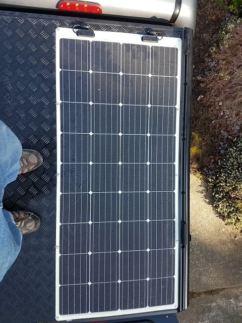

    Thanks for the lead on the vent. I've been wanting to add a positive pressure system for a while but so far all I've been able to find are big honkin horse trailer vents that stick up really high when closed. I should have enough room to fit a vent like that between the solar panel and roof rack track:
    The Renogy 160w flexible panel juuuuuuuust barely fits lengthwise on the DCSB canopy.

    Yeah it took me a while to find the right vent that would fit under my tent. This one is nice because it can open either way and it has like 5 open positions in each direction. Also it seems to be watertight when closed. I’ve power washed it a couple times now and it hasn’t leaked.
    I’m really surprised Alu Cab hasn’t at least added it as an option on the canopies. It’s amazing to pull up to camp and not have all my stuff covered in dust.

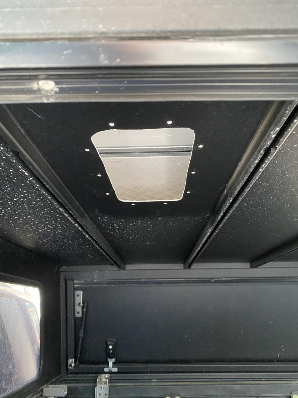

    I just got mine this weekend and had a vent like that delivered already. We’ll see when I’m brave enough to install!
    #19
  20. Dec 19, 2021 at 10:16 PM
    #20
    Jayhat
    Jayhat Well-Known Member
    Feb 3, 2021
    #354979
    112
    so for the positive pressure system to work, do you open the vent facing the front of the truck so it rams air inside or do you open facing the back (and still get enough pressure)? I’m guessing facing back, otherwise it would probably act as a dust scoop.
