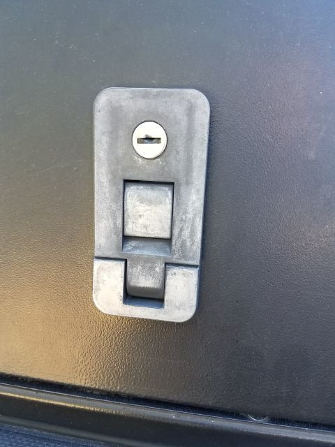

    The latches have faded something fierce. They are no longer black:

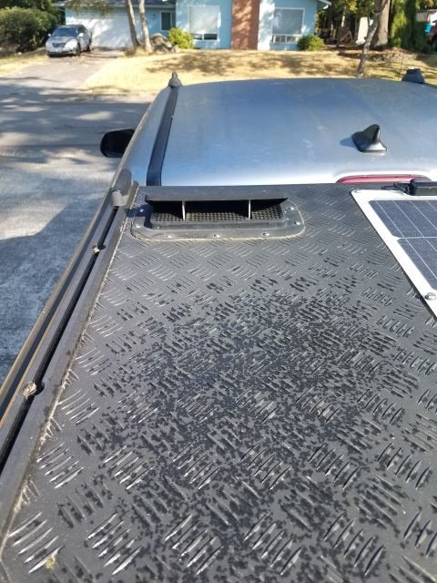

    I also added a vent similar to @nvnv and, for me, it has been a tremendous help. I leave it open on the aft edge most of the time unless I'm on the dirt, then I'll open it on the forward edge. It made a huge difference in the amount of dust I get. So much so that I haven't done any further work trying to seal the aft hatch. When I'm not on dirt I'll leave it cracked just to let the hot air out. I haven't measured with a thermometer, but it feels like the back of the truck is cooler on hot days than it used to get. It does seem like the fridge runs less with the vent open. I close it down to the first setting if it's raining, but honestly it hasn't let in much water. I get more water from the leak through the front window rubber.

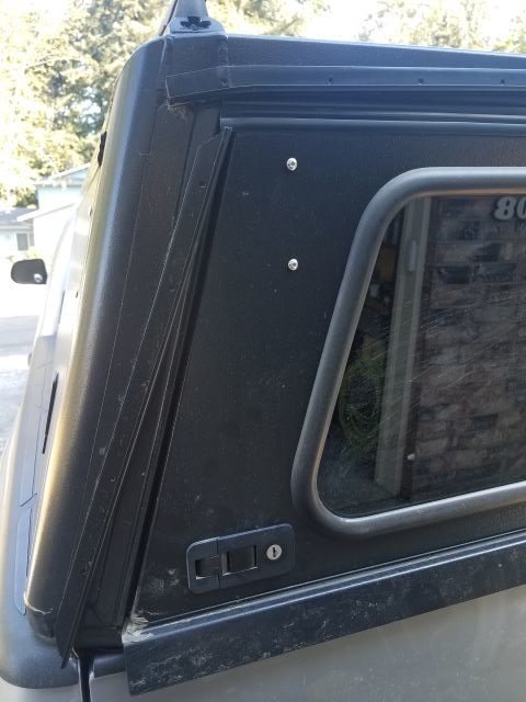

    The drip rails that I installed work great to direct water away from the rear hatch. I'd definitely do that again. They do collect pine needles if I don't drive the truck much. That's not often an issue though.

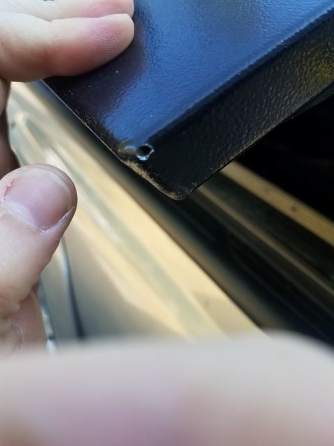

    Speaking of doors, I did have to make a slight modification to the side doors. Somewhere they're getting water in them. I haven't been able to figure out where it's getting in; I haven't seen any paths or obvious entry points. It could be coming around the edge of the side door or through the paddle latches. It was pretty annoying as the leak would fill up the bottom edge of the door panel and then dump the water all over you and the inside of the truck when you opened it. My solution was to drill a small drain hole in the aft corner of the door, water buildup hasn't been an issue since:
    So far it's still working for me
