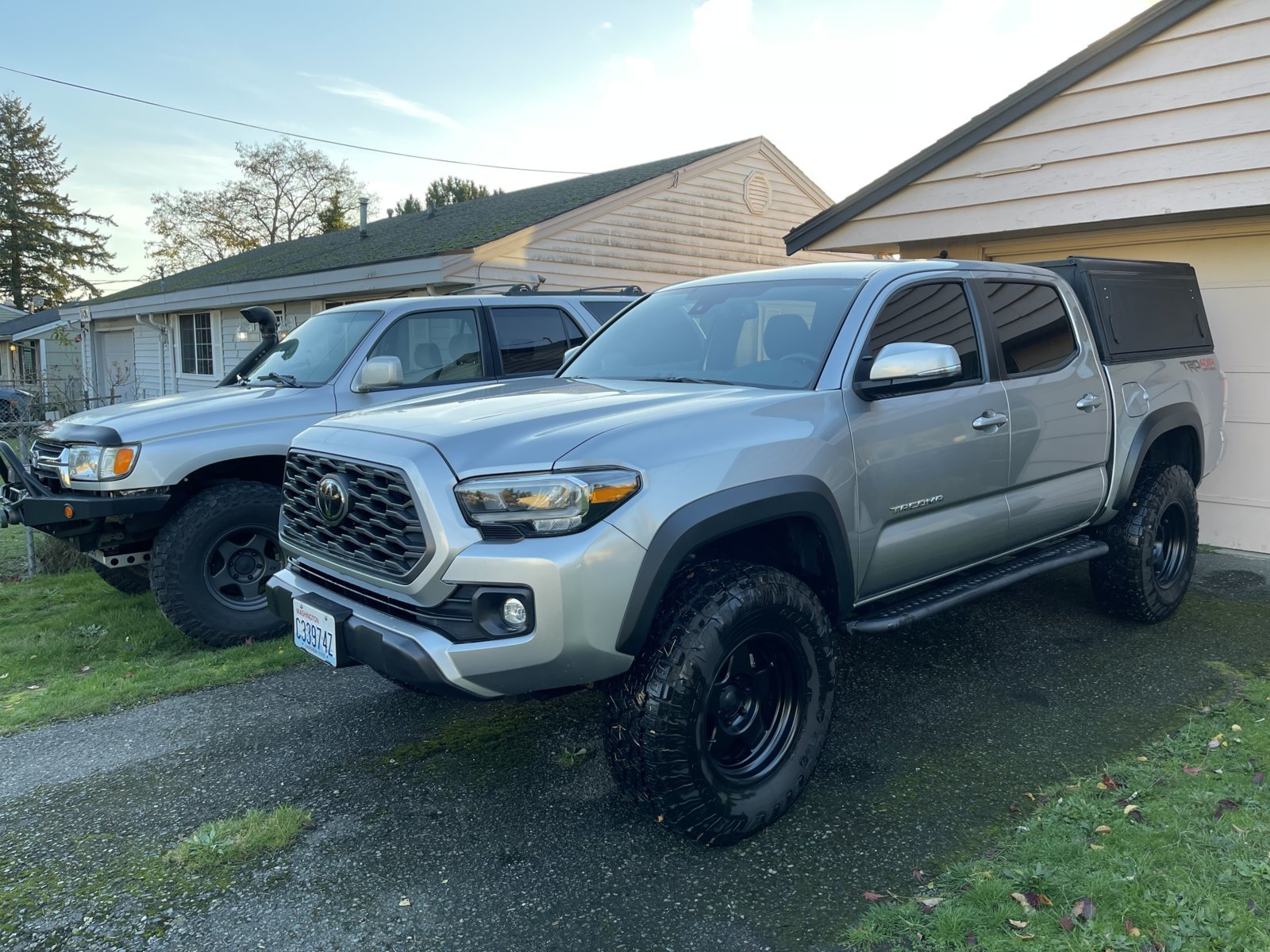

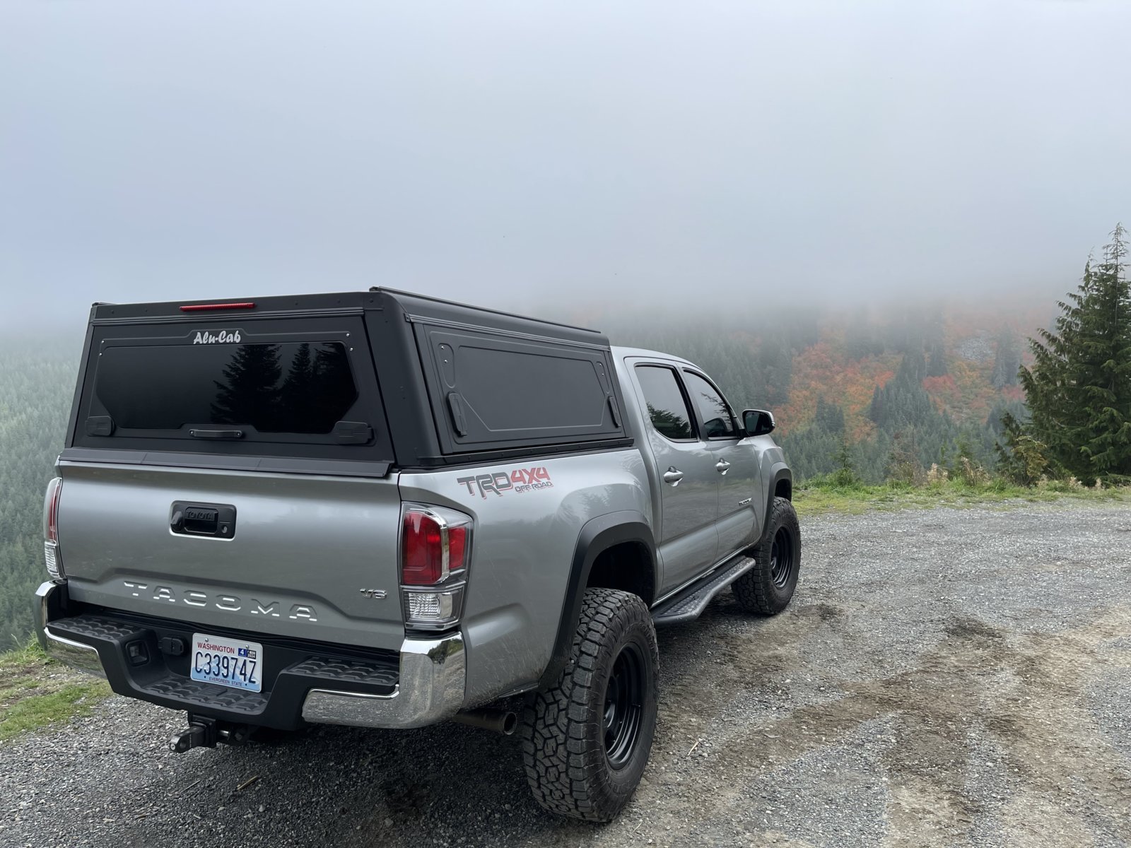

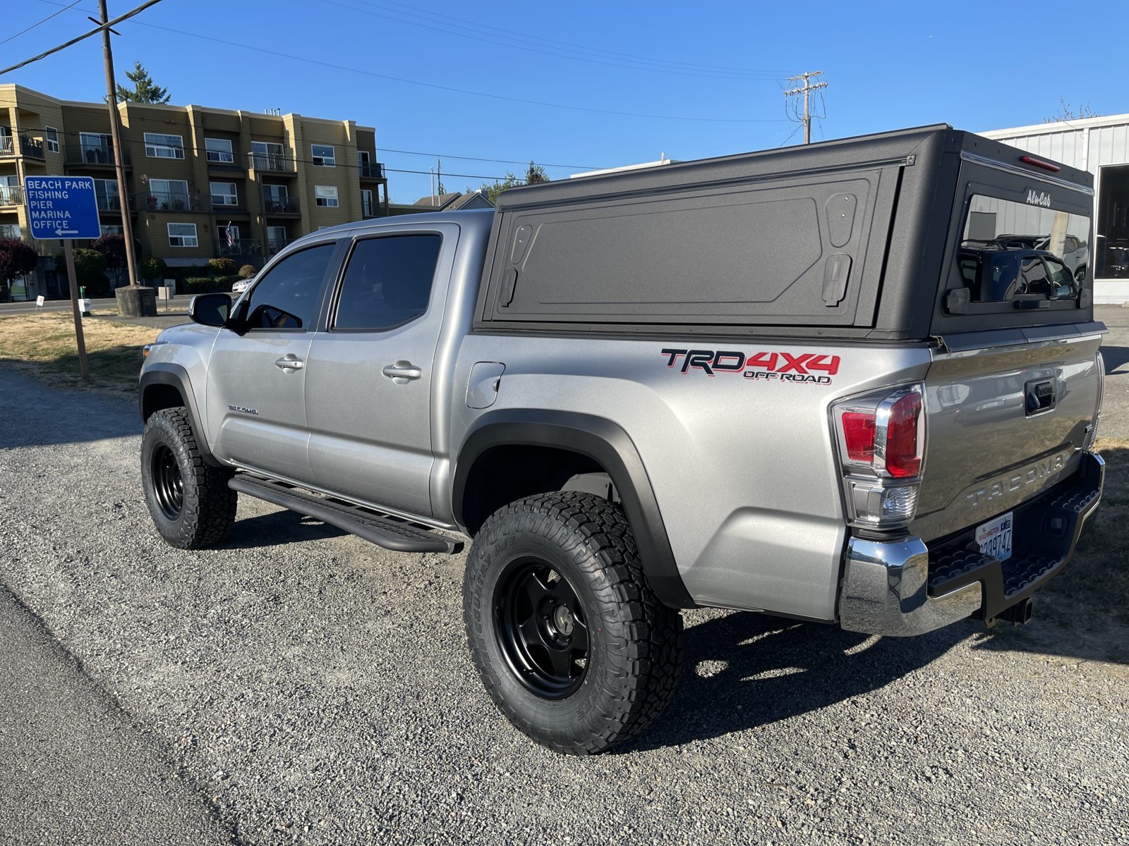

    Man… sorry about your experience with Leer. What a fiasco.
    Onward and upward my friend. I think you made a solid choice. Your decision that brought you to the top two aluminum canopies on the market. It was a very similar decision making process for me. I think both GFC and Alu-Cab make solid options for canopies. I went with Alu-Cab as well. I really dig the look. I might have leaned more towards a GFC had their lead times, location, and price been closer to the Contour.

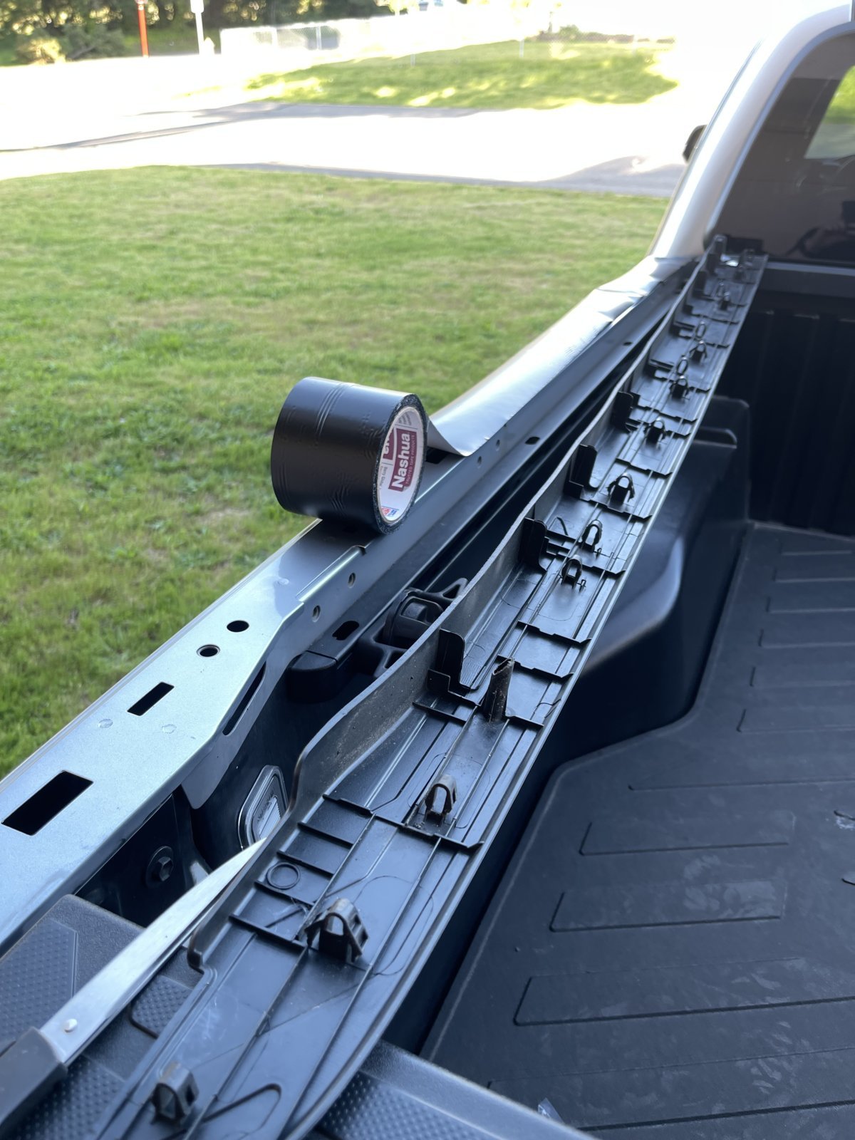

    If you haven’t done it already, take this time to prep and seal the tops of the bed rails while you are waiting for your canopy to land. It’s super easy and just helps to keep things a lot cleaner back there.
    some pics because what thread doesn’t need more pics?

    Why do you tape on top of the side rail? What tape are you using? Also, what is your recommendation for sealing the gap in the front rail nest to the rear window?

    That's a great looking setup you have! Love the look of the Alu-Cab on your truck too! I never thought of taping underneath those top bed rails. When I had my Leer installed I would constantly get water leaks on the sides of the bed rails and no doubt that is where it came from.

    As soon as you pull the top rail caps on the bed, it will become pretty obvious that, left unaddressed, the tops of the bed rail will funnel water in unless sealed off.
    I got a lot of my guidance from the GFC forum page. I mean, you will not turn your taco’s bed area into a submarine or anything, but I feel with very little effort and investment, you can significantly improve the water and dust intrusion into the bed area.
    You can go further than I did, but it’s best to address the areas that will be a PITA once you have a canopy mounted.
    I go into more detail about what I did here. https://www.tacomaworld.com/threads/gfc-finally-releases-the-new-topper.778711/page-8

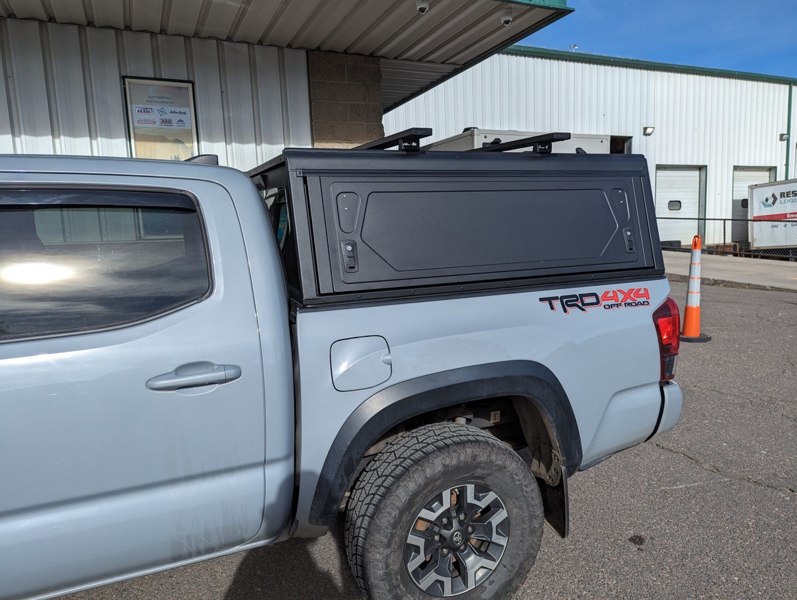

    just got my contour installed this morning. took about 4 hours from drop off to drive away.
    initial thoughts after driving it for an hour, the rear view isn't bad. i drove for a month with no rear view mirror since my tent was in the way. with the contour on, its like the back seat head rests are up and you lose some visibility on the top end (where the roof of the canopy is).
    I heard a little tapping under the footwell while driving. im guessing one of the wires needs to be zip tied or something. i'll check later since i just got to work and dont wanna roll around on the ground looking for a wire.
    there isn't as much space on the bed sides to stand on compared to some other pictures i saw floating around here. i did install the total chaos bed stiffeners last night, so maybe there shouldn't be that much space?
    the lip hangs over the tailgate a little more than i thought, but its contoured to fit it real nice with a gasket there.
    the three position switch in the canopy is only on and off? whats the point of the third position then?
    either way, im excited to use this through the winter. i'll buy some of those covers for peace of mind in the winter and i like the look.

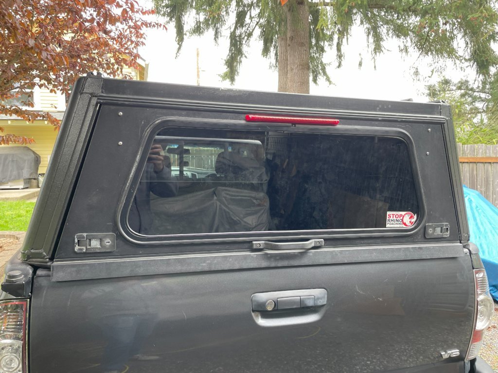

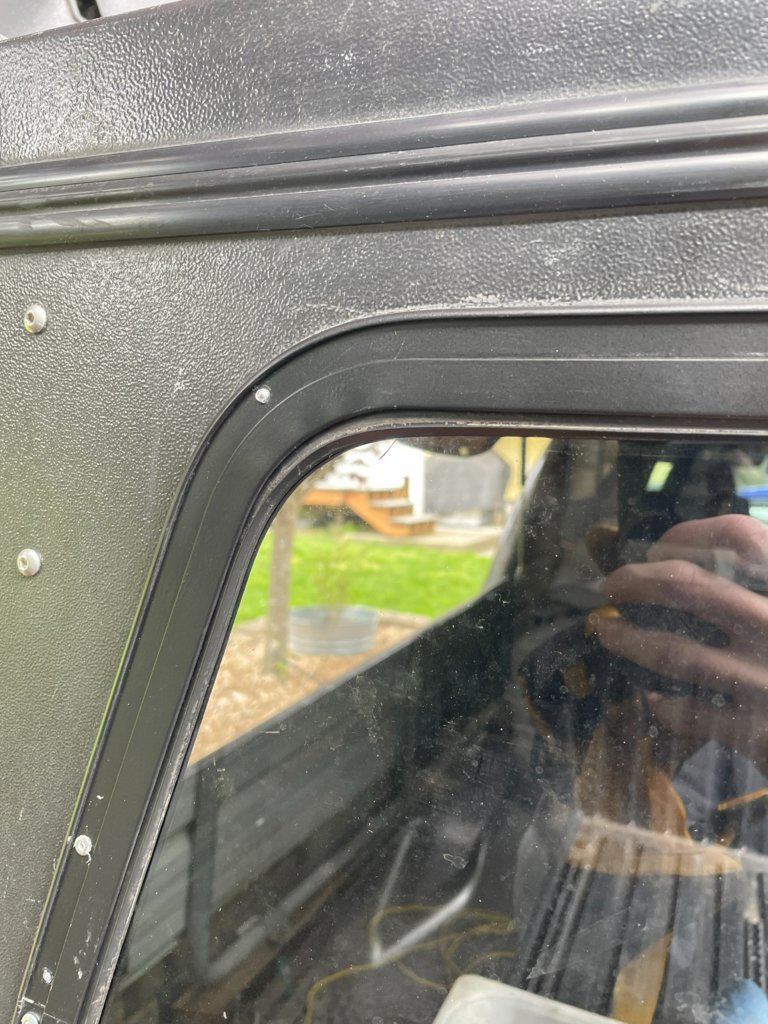

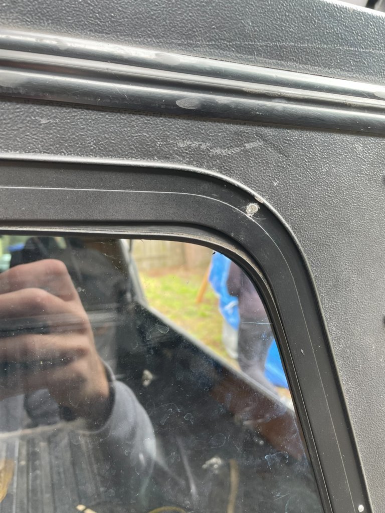

    Just keep throwin' money at it.
    Cross posting this here as well as the Let's see those Alu-cab setups | Page 69 | Tacoma World
    Got the new back window installed. The fit is questionable. Looks like they changed the seal design from the riveted frame on the early one (which I have) to a bulb seal on the newer Explorers. Emailed Alu-Cab about it and waiting to hear back. Anyone with an early Explorer care to post some photos of the rear hatch glass?
    Update: Heard back from Alu-Cab. Looks like somewhere along the way someone installed a wrong window on the back of the canopy. They used the window between the cab and front of the canopy on the back hatch. Trying to locate the correct seal now.
