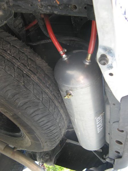

    hoping to fit in one 0.5 gal. and one 2 gallon tank (or maybe just a 2 gallon with one flow control for the back - not letting them go past 80/85 psi). not going crazy on this one. After that I still have to figure out how to route the valves, but once I get the compressors, tanks and valves on and hidden, I'll be able to handle the rest fine. :D

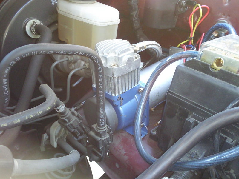

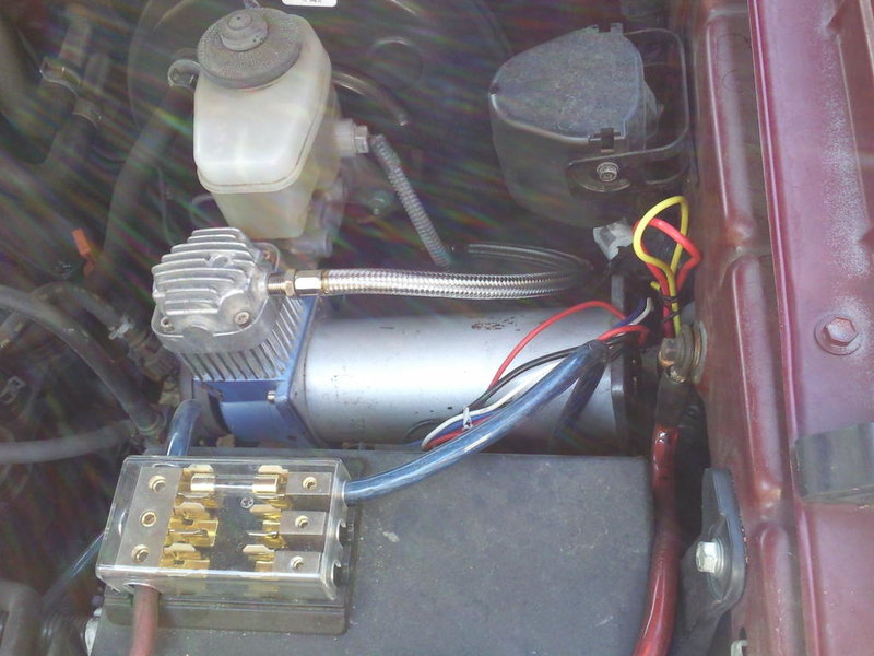

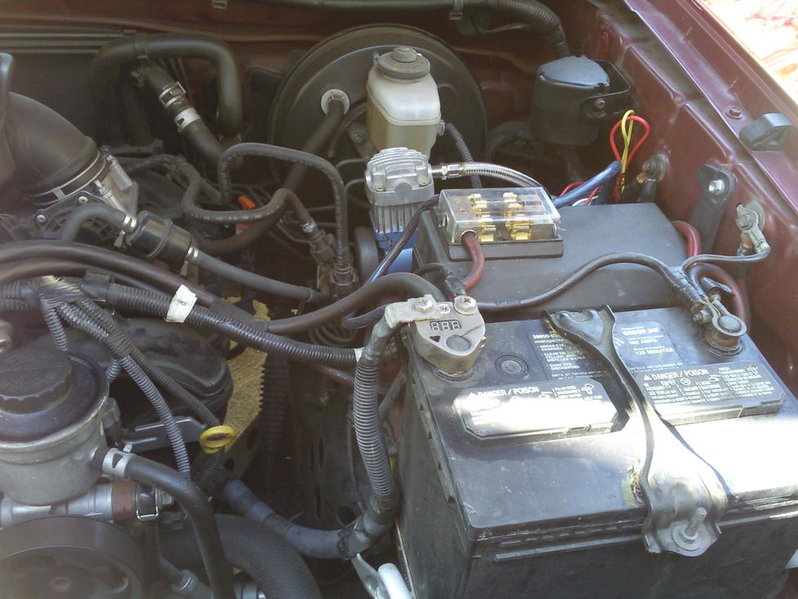

    did a mock fit of the compressor in the engine bay ... ... bow to get it all plumbed up and ready for install. I am going to repaint the compressor all black and add in some bushings so that it will be ... somewhat quiet.
    figure I'll run a line all the way to the back for the air tank and valves. this way it will be easier to hide everything.
