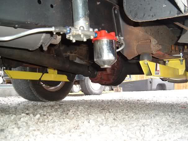

    With this type of set-up though you get some bad from it - it's just a cheaper way of lowering the rear - within time, IF you are constantly lifting/lowering the rear, you will get what is called "warping". This is when the main leaf starts to deform and wear out (no longer able to do it's job). In short, the smiley face leaf turns into this
    hotrod riders do this to drop the back also BUT you also see them with "slapper" bars too, this is to prevent what is called "axle hop". If you have a heavy foot on the pedal, you will get this A LOT, but if your soft on the gas, you should be fine.
    *NOT to be done with air suspension due to the leaf being in a "static" position when slapper bars are installed, ability to adjust ride height will become a problem.
    Slapper bar
