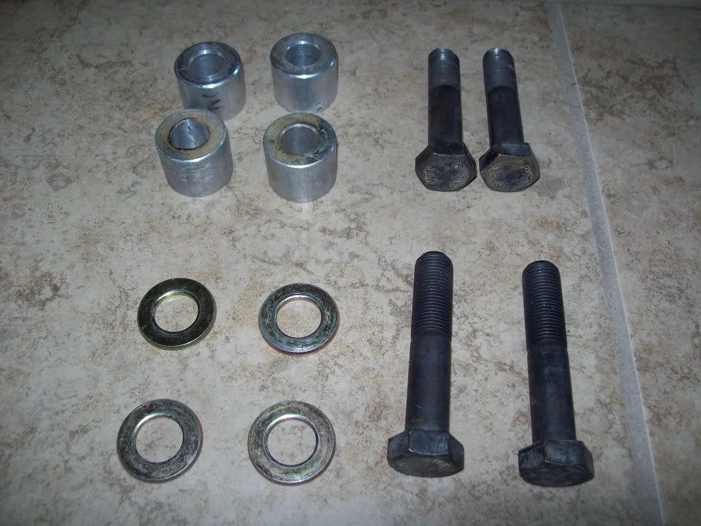

    if I can find out where to get these bolts I'd be set (from the looks of it it says WT 10.9 on the bolt). :mad:

    After having new light shined upon me I am going to try to hit up this one Napa store I found. Hopefully I get the right bolt!!!!
    Big ups to Yoytoda for the EXTREMELY helpful info :cool:

    I haven't gotten the correct bolt yet, not hard at all - just remember that left is to loosen and right is to tighten

    going to have to do this, I hate that there's always that "off" threaded bolt from the dealership. But makes sense since dealerships are always doing "off" shit all the damn time. :mad:
    NICE!!! I am hoping to get the right bolt, had some insight from Yoytoda about how to find the bolt, just need to get some time to hit up the Napa store (hopefully if they don't have it I can at least get an exact size/type of bolt that is being used).
    I know that the I.D. of the spacer should be equal to a 5/8" or M16 bolt. The 3/4" I.D. hex nuts that I bought jiggle a little bit on the OE spindle bolt BUT not as much. O.D. ... not sure but the package for the 3/4" hex nut says 3/4" - 16 on them.

    via pm we discussed metric thread pitches.
    american/ SAE use a different method to determine the threads. threads on SAE are how many threads per inch of bolt or nut. so 5/8"-16 is a 5/8" nut with 16 threads per inch
    the 16 has nothing to do with it being similar size to a 16mm bolt
    5/8" = 15.875mm

    well today was a bust ... the guy at the Fastenal place wasn't very helpful at all! :mad: only got the type of bolt, which he said it was a 5/8" flange bolt (he pretty much did the same thing I did when I went to OSH but I guess he knew what kind of bolt it was). not sure about the rest because just wasn't much of any help PERIOD ... sorry just got back and a little irritated.

    MORE UPDATES!!!!!! lol yeah I know, so as I am lurking around more and more in the Fastenal site, I find this!!!
    http://www.fastenal.com/web/products/detail.ex?sku=11115660&ucst=t
    notice it has the same WT 10.9 on it as the bolts in this picture to a spacer kit (keep in mind that the one in the Fastenal link is NOT Fine, it is Corse sadly).

    mainly trying to get the bolt now. found the hex nut and washers easily ... the bolt ... proving to be very difficult :(
