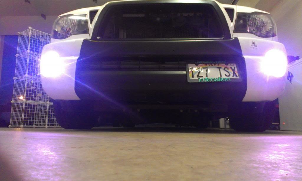

    oooooooo!!!! can i join the party and take pics like this toooo:):) you make me feel lifted:p
    from speed bumps and manholes and roots and a bunch of stuff:/
