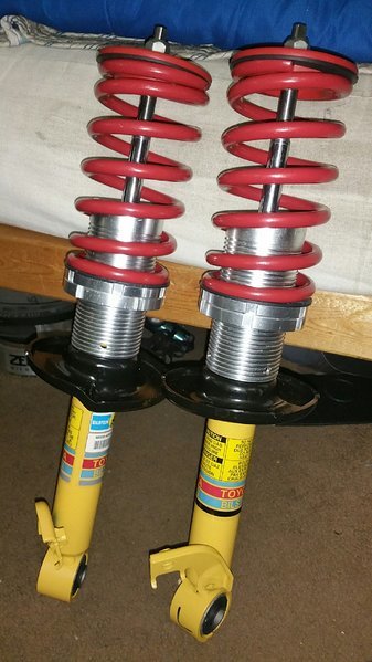

    Thanks for the link bc I've never seen these djm offset bushings
    -Know if they're tacoma specific or for all djm arms?
    -Ever use them?

    Been using the offset bushings on my djm ucas for the past three years with no issues. The link description says they are for all calmax arms...three years is a long time so I don't recall if I had to trim the bushings or not.
    I'm on my phone now so details would be tough to type out but basically I used all QA1 parts and bolted it to the stock strut top hat (no custom top plate like the xii kit). I had to grind away some of my lower shock mount but in hindsight I know what I need to do to keep from needing to grind anything and still bolt up. I'm debating doing the "improved" version since what I have on now is working beautifully. If you look at my avatar you will see that I am not using a custom top plate...instead I leveraged the stock configuration. For me, I am fully satisfied with it.

    Glad that you've been using the offset bushings for couple years bc I'm going to order some now that I know they'll work.
    I looked at your avatar closely and that front qa1 setup looks really nice. I'd be interested in info of this improved version too.
    Undecided on whether to add xii performance drop coils to my djm arms or coilovers to get about 4-5" in front.
    These offset bushings will hopefully help reduce the camber that will exist by maybe 1-2* maybe

    I was looking at some QA1's on eBay and there's kits out there but the shock looks short (I found one with 550# springs, but are for GM models). How long are your shocks? I want to do a coilover bag strut. If I take away my 1" spindle spacers, I'm back to 3" up front. Which isn't bad. I still have 4" of travel to play with on the strut bags. So ... positioning will be vital for this to work out the way I would like it to.
