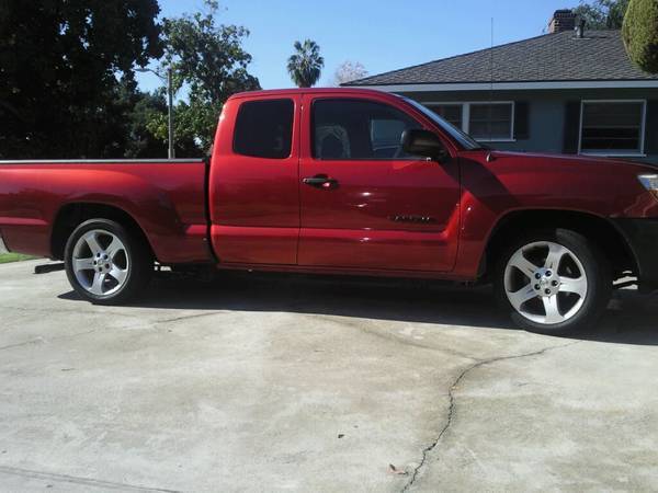

    here's how she looks with the 1" front spacers (still trying to find the damn bolt that was used), and 4x4 leafs w/1" drop blocks.
