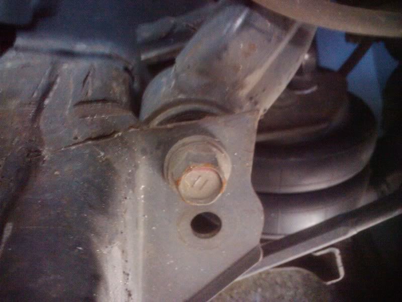

    found where I put this picture - next is to plan out front drop.
    - Relocated UCA's (move up 1" from OE placement)
    - Cut OE springs (0.25 to 0.5 turn for 1"/close to 1" drop)
    * attached picture is of actual mod Inthablood had to do to correct camber (he was bagged up front, but none the less this should remedy the camber issue).
