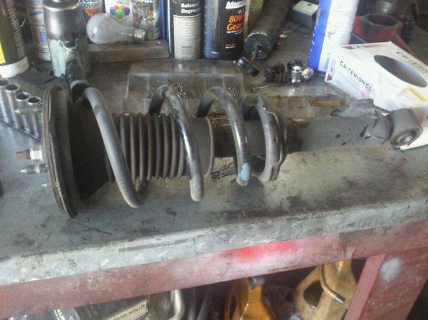

    Stock strut removed
    Cut spring placed in

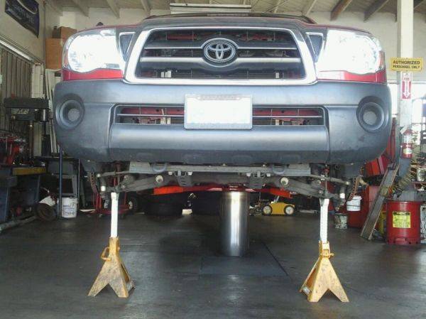

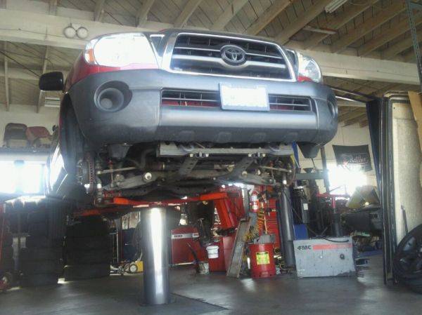

    DID IT!!!!! went well too yesterday. Didn't even take as long as I thought it would. Will be posting pictures later today but for the most I have the 1" I wanted out of the springs. There is camber, but for myself I don't mind how much I am getting. Will be fiddling with the back as soon as I get a bag replacement and some blocks. :D

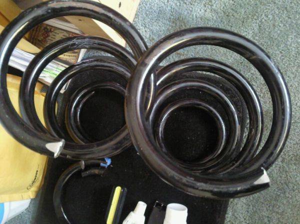

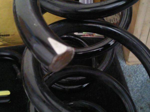

    after hitting up a car meet on Sat. I wasn't happy with how the front looked, so going to hack off yet another 0.5 turn, then get 3" blocks along with some sleeve bags to keep the back from donking all the time.

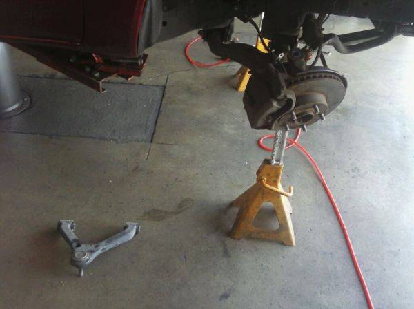

    here's what I found out though while dropping, the bottom perch for the spring on the front strut will hit the UCA, so be careful in planning out the UCA mod (please to read a couple pages back). If you do raise it 1", make sure that it won't cause problems with the spring since it starts to get wider at the top. As of now, my UCA's are VERY close to the bottom spring perch, but not hitting, if I probably go nuts like I was off road or something I guess I'd be in trouble but other than that it's fine from the looks of things. Top of springs are still seated, but it was somewhat of a pain trying to get the to stay seated when replacing everything. Be sure to watch for that when re installing.

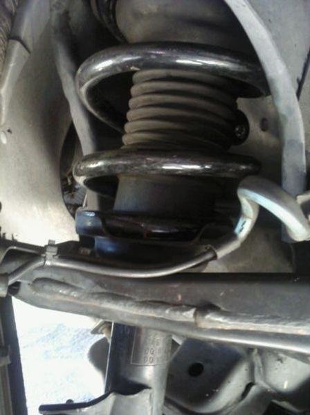

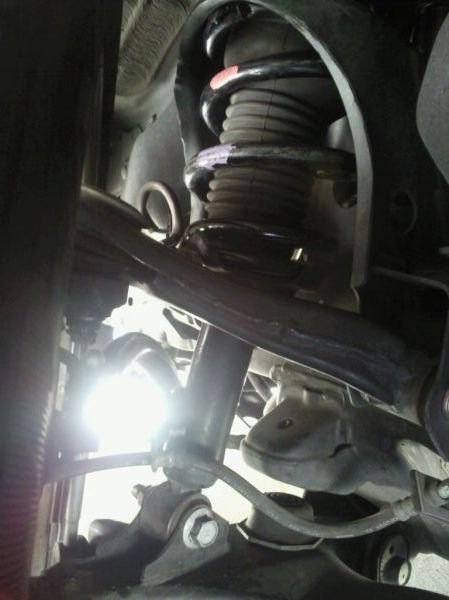

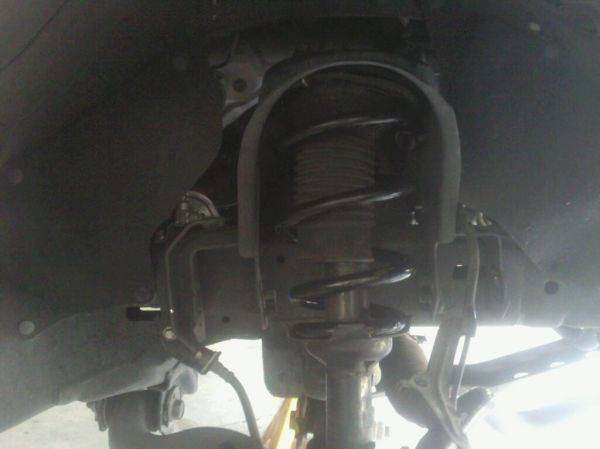

    this is the driver side, the overall picture. You can see where the bottom of the spring perch on the strut is close to the UCA. When I was taking out the spring, using the DIY home method with the jack, I had to remove the UCA bolts (long with the brake line and that other small bolt on the UCA and swat bar bolt) from the frame so that the strut itself would be able to come out.

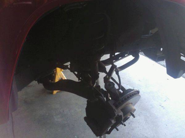

    this is how the passenger side looks.
