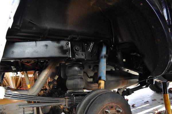

    Bought 2 cans of Eastmans Rust Encapsulator. Starting from the rear I used 2 cans in and around the rear. Seems to cover nicely. Clogged a bit but kept at it and used up both cans. A bit pricey at $22 per can.
    Started trying to use a wheel sander but quickly determined that wasn't going to get into any of the smaller places. Went to a brass brush and finally gave that up and just used the air compressor with a small tip to blast the loose pieces of rust away.
    Hopefully this will stop or at least put off the rust for a while. Will continue forward in the coming few weeks.
    Lowered the rear spare and painted.

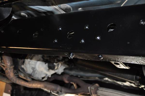

    Side
    Where I stopped painting for today.
    Unpainted portion (toward front).

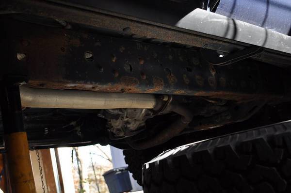

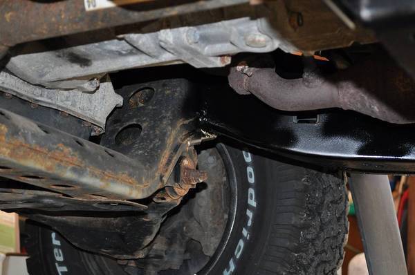

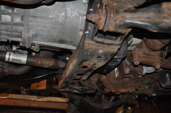

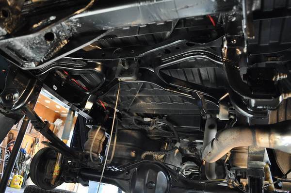

    Continuing my quest to stop the frame rust.
    3 more cans and 3 more hours under the truck. Sanded off the rust I could get to and used an air hose with a high pressure tip to get the loose stuff off where I couldn't get with the sander.
    I think I'll need 2 more cans for the front portion. I'll do that in the next couple of weeks.

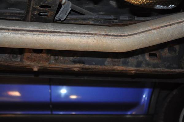

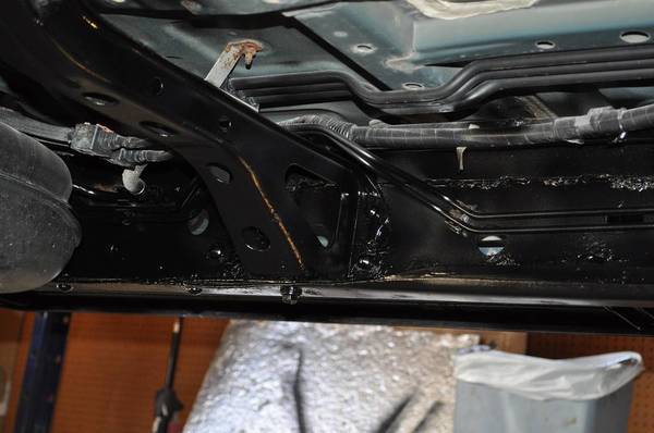

    I paid special attention to the frame next to the cat. And yes there was more rust and even "peeling" there. I took off the peeling portion and made sure it got 2 very heavy coats.
    Before being painted outside frame:
    Inside frame before being painted:
    Outside frame looking good:
    Inside frame painted:
    Where I stopped for today:

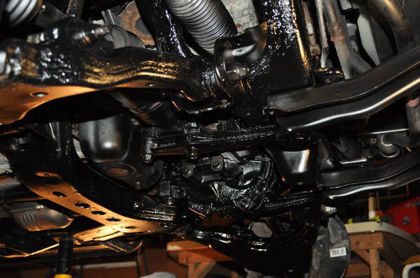

    Ordered 3 more cans of Eastwood's rubberized rust protector on Sunday and they arrived yesterday. Just in time for the East coast storm and all the salt that comes with it.
    I also got my letter today from Toyota on the Corrosion-Resistant Compound - Limited Service Campaign. Going to throw the letter out since I've already started my own Corrosion Resistant Campaign.
    Curious - has anyone had this done and does it work? I've heard mixed results but would like to know your opinions?
    Keep in mind this is a 07 V6 TRD double cab manual.
    I've done a lot of research on the rust. If looked at fluid film and Amsoil's product (cant' remember the name). Both of those seem to work before rust. Mixed reviews but mostly positive on Eastwood's rubberized rust protector.
    I'll let you know after this winter how much comes back. I'm under no illusion that this will be a yearly application. Hopefully only a can or 2 instead of the 8 I've used so far.

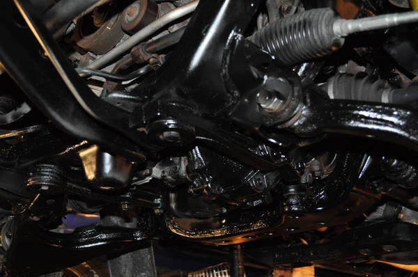

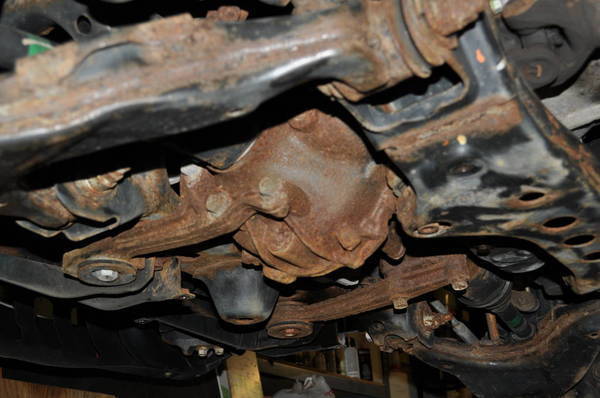

    Anyway before and after pictures below of the front. Middle and back have already been done. Anything that looked like rust got a good 2 coats. Sanded as much as I could and used an air compressor with a small tip on the rest.
    REALLY!!!
    AFTER
