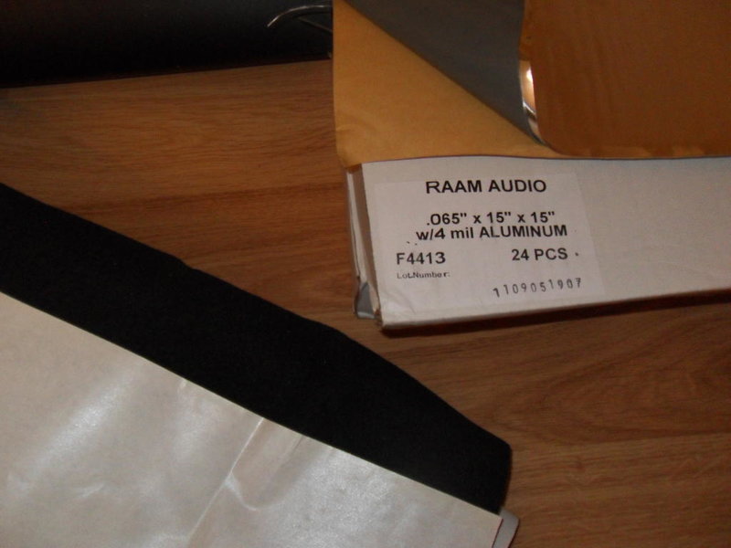

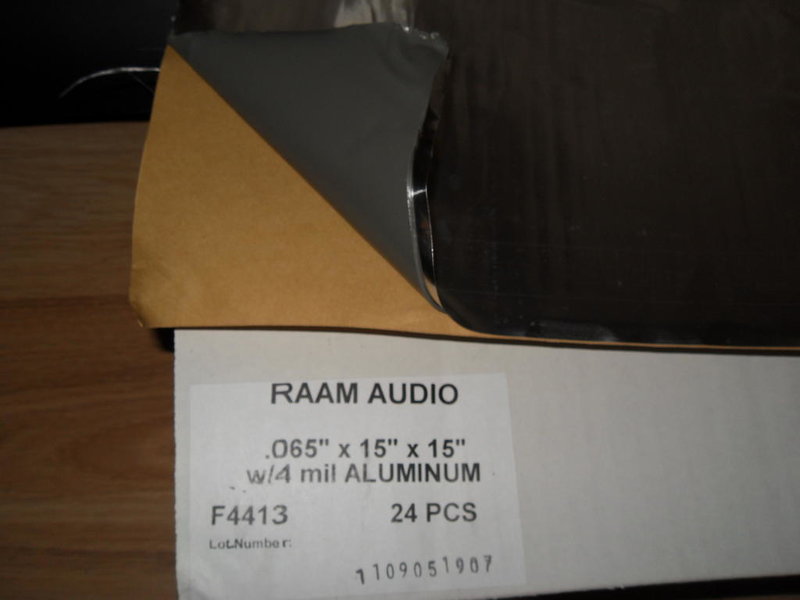

    After reading what everyone else has done, I've decided to create my own build thread for my car sound system. I'm going to try to avoid duplicating information that can be found elsewhere on this forum. If you haven't done anything yet, I'd recommend reading http://www.tacomaworld.com/forum/audio-video/59941-my-deadening-project.html too.
    First of all I want to say there are many ways to skin a cat. What I did for my '09 Access Cab may not be what you want to do, and someone else may do it differently too. There's no right or wrong. It's your truck do what sounds best to you! (pun intended.)http://www.tacomaworld.com/forum/at...43524-my-audio-deadening-project-sdc10003.jpg
    UPDATE: I ordered 2 boxes of each from RAAMAudio. The BXT II comes in 37.5 sq ft box and the Ensolite 14 sq ft. I had just a little left over of both.

    I began by buying everything I needed to deaden and create a fantastic showcase. I used RaamMat BXT II for deadening bass vibrations, Ensolite (a closed cell foam(ccf)) for acoustical accuracy, MLV - mass loaded vinyl (1lb/sq ft) as a sound barrier, and a 1/4" CCF as a sound absorber/decoupler for the MLV.
