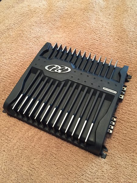

    Starting my audio build (as a total newb). Going to try and do everything myself but if there's one thing i'm really bad at regarding vehicles, its electronics/wiring. So, this will hopefully be a great learning experience for me.
    I'm no audiophile, but I would appreciate a decent sound system. Hopefully what i've come up with will do the trick for a reasonable amount of money.
    So far I have:
    - Phoenix Gold Tantrum 500.2 amp (an oldie but a goodie - bridged - powering the sub)

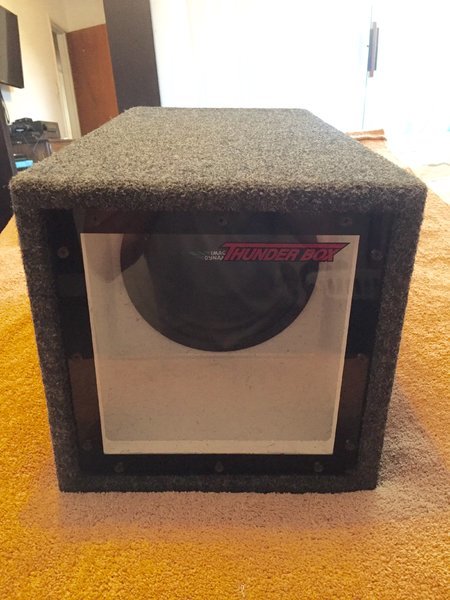

    - Image Dynamics IDQ 10" secured in a bandpass box (an oldie but a goodie)

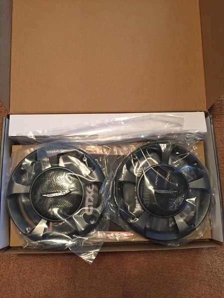

    - Image Dynamics 6.5" Component speakers/tweeters (front doors)
    I'm starting to wonder if I got jipped, all the "unboxing" videos/pics i've seen include speaker cable for the pair... mine didn't!

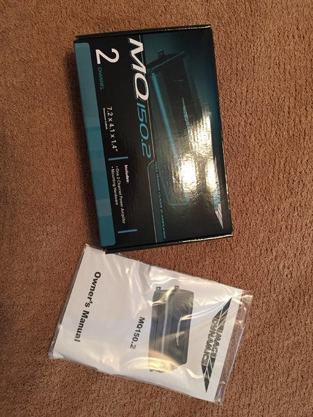

    - Image Dynamics MQ150.2 Class D amp (powering the speakers)

    that's a solid start. you can't go wrong with the IDQ and i've read good things about the ID components. you also have plenty of power to get really loud. was the bandpass box custom built to the IDQ's specs? reason i ask is those types of enclosures are not very forgiving to miscalculations.

    I doubt the bandpass box was custom built. However, I ran that sub/amp setup for many years and for a 10" it hit hard. It's been sitting in my garage for years and was the start of this whole build... figured I should use them. Any help on wiring kits for two amps??

    gotcha. well if it treated you well then you might as well continue using it.

    Another question for the Audio guru's... is the Image Dynamics MQ150.2 overkill for the CTX65CS speakers? I only ask because I was looking at the "2016 highest rated amplifiers" and the Polk Audio D2000.2 was on the list at $100 cheaper than the ID MQ150.2. It's specs are:
    • Polk Audio PA D2000.2 2-channel car amplifier
    • 125w x 2 RMS
    • Max power handling: 300W
    • MOSFET switching power
    • Efficient Class D bridgeable design
    • Toroidal transformers
    • Full, HPF, BPF switch
    • Adjustable low and high pass frequency
    • Level controls
    • Line level outputs and inputs
    • Nickel-plated wire terminals and RCA connectors
    • Stainless steel hardware
    • Protection: thermal, DC offset, reverse polarity and short circuit protection
    • Dimensions (with panels): 1.81”H x 8.25”W x 6.75”D

    You may void your warranty, but using an amp rated for more power shouldn't be a problem - particularly with that margin. You'll want to keep that in mind setting gains though. Your amp isn't making max power all the time. It's usually making some amount below the rated (err, actual which you can get from an amp dyno test) amount under normal conditions...typically a small fraction of what they can do. So you could use a grossly overpowered amp as long as you didn't ask it to make gross amounts of power. Power rating is more of an internal thermal limit, so a set wattage number is more of a suggestion. Manufacturers typically build in some headroom as well. In the case of a company like Sundown, a lot of headroom. IDK with ID, but I wouldn't sweat it.

    Just went out and measured the height dimensions for both driver/passenger seat. The PG Tantrum 500.2 will fit under the drivers seat but not the passenger seat. SO, I need to find an amp to power the components with a height less than 1.75" which the Polk does not meet (1.81" tall). The ID MQ150.2 would fit (at 1.4" tall).

    Went ahead and ordered the ID MQ150.2. Fits the power requirements and dimensions are right for under passenger seat placement.

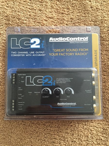

    So I opened my LC2i line output converter last night and there is some serious rattling going on inside. Anyone else experience this? I'm afraid to open it up in case that voids any warranty or something.
    Edit 1: AudioControl promptly responded and will have to exchange the unit for a new one.
    Edit 2: The replacement AudioControl LC2i also has a rattle so i'm thinking maybe it is just how the unit is. The first one sounded like something was loose and this one just sounds like a rattle. Hmm...

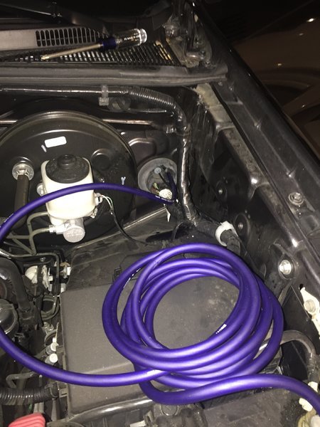

    Starting assembling the power cable. Made a small wooden mount for the inline fuse and will bolt to the two open holes on the inside drivers side of the engine bay (that others have mentioned). Made the short cable from the battery to fuse (20"). Ran the cable from the other side of the fuse through the existing grommet on the driver side and currently have the remainder of the cable coiled up behind my seat.
    Cable looks purple but its actually blue. The cable was a B to run through the grommet!

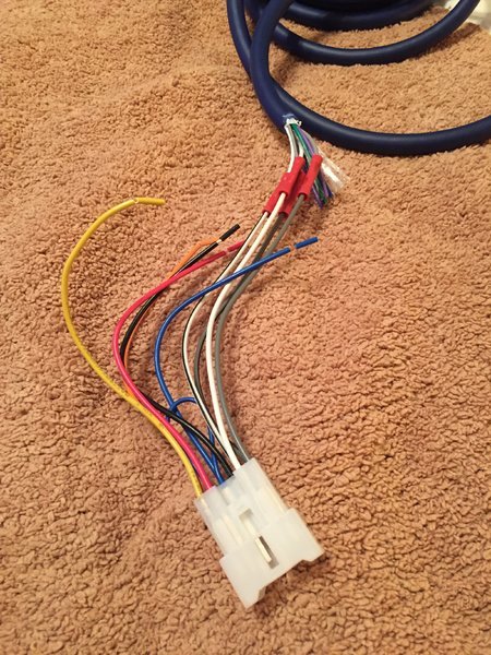

    Started assembling the dash harness to LC2i wiring. This is the Metra harness and Stinger Speedwire:
    What you're seeing is the (+) and (-) connections for the front door speakers connected with butt connectors. My plan is to remove or unpin all remaining wires and replace the with the OEM harness wires once i'm ready to take the HU out. I got frustrated and quit for the night because I couldn't unpin them... any tricks?

    if you have the liberty of time and funds, then a pin remover is what you need. something like this (not sure if this will work with your connector, but you may be able to find one sized properly for your connector): http://www.amazon.com/Connector-Remover-Computer-Extractor-Sleeving/dp/B0094MIS9U
    if you don't want to bother with a specialty tool then you need something that mimics a small barrel. maybe the internals of a disassembled pen will work? or a small flat screwdriver to push in the tabs around the pin.
