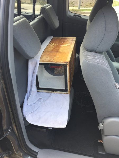

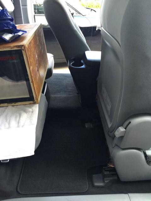

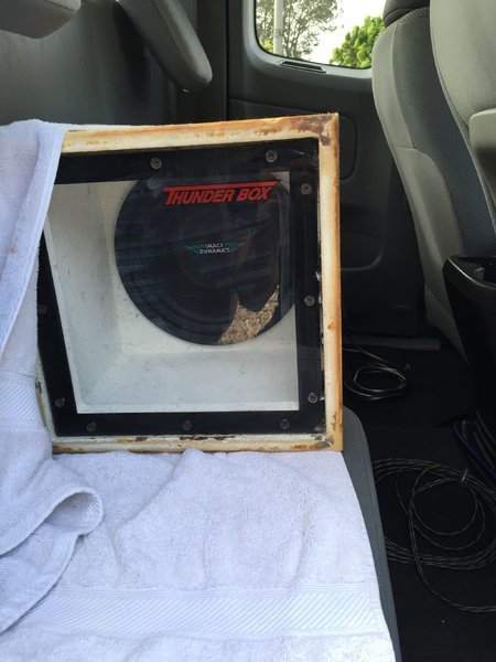

    Here's my current setup with my ugly ass box. I removed all the carpet in an attempt to get rid of the mold smell. It definitely helped. I spent hours sanding down the glue and carpet fragments that stuck to the box and bought paint and everything to make it look nice and that's where I got frustrated because it still smelt a little like mold. SO, until my new box arrives this is how it will be. Also, you can notice the wires on the floor. Again, once the new box arrives i'll cut those to length and hide everything.

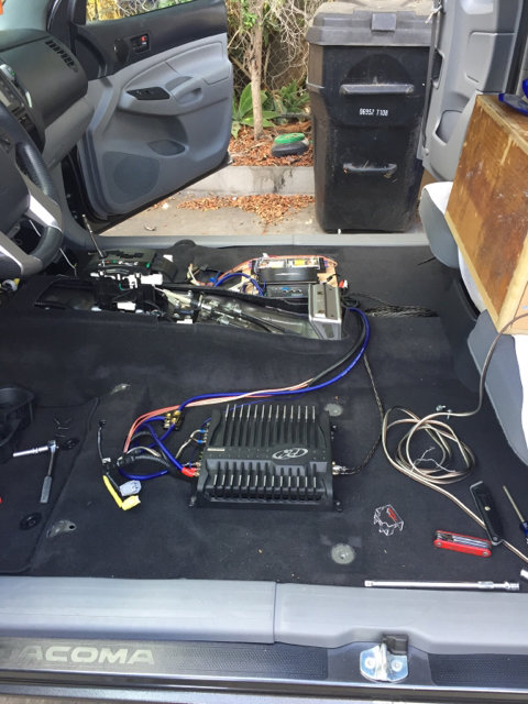

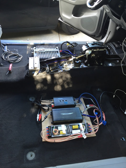

    Well I figured no better time than now so I red did the wiring in a much better way.
    And made it all nice!
