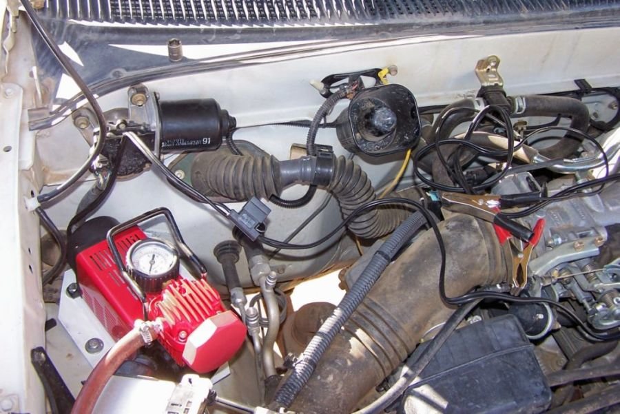

    Air compressor (hardmounted under hood)

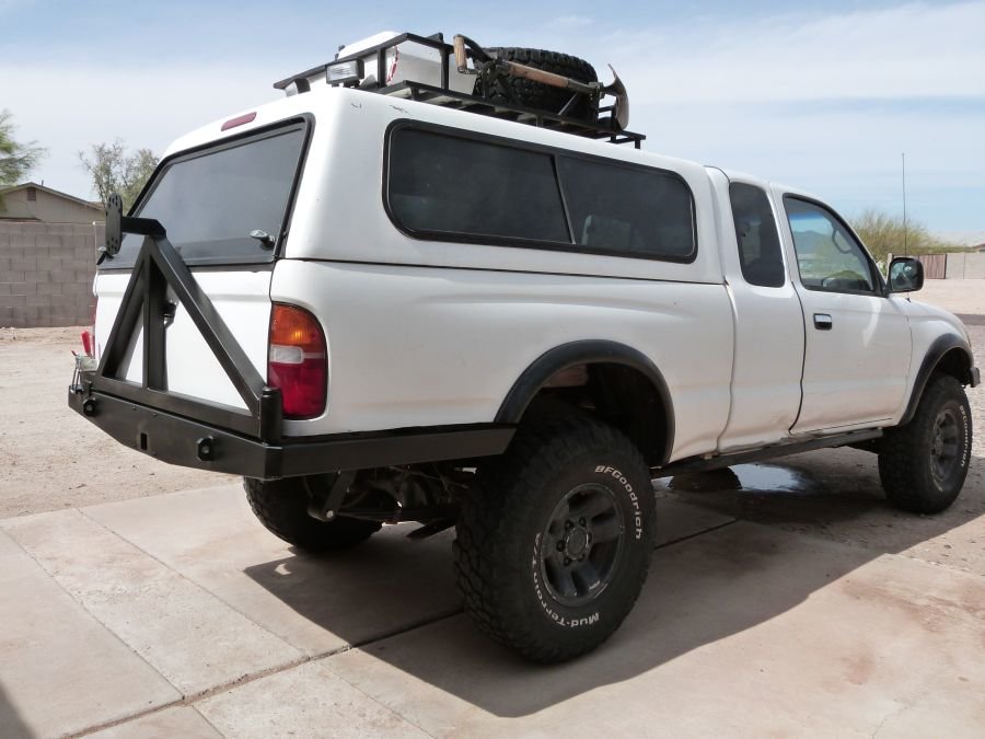

    As It Sits Now Pic:

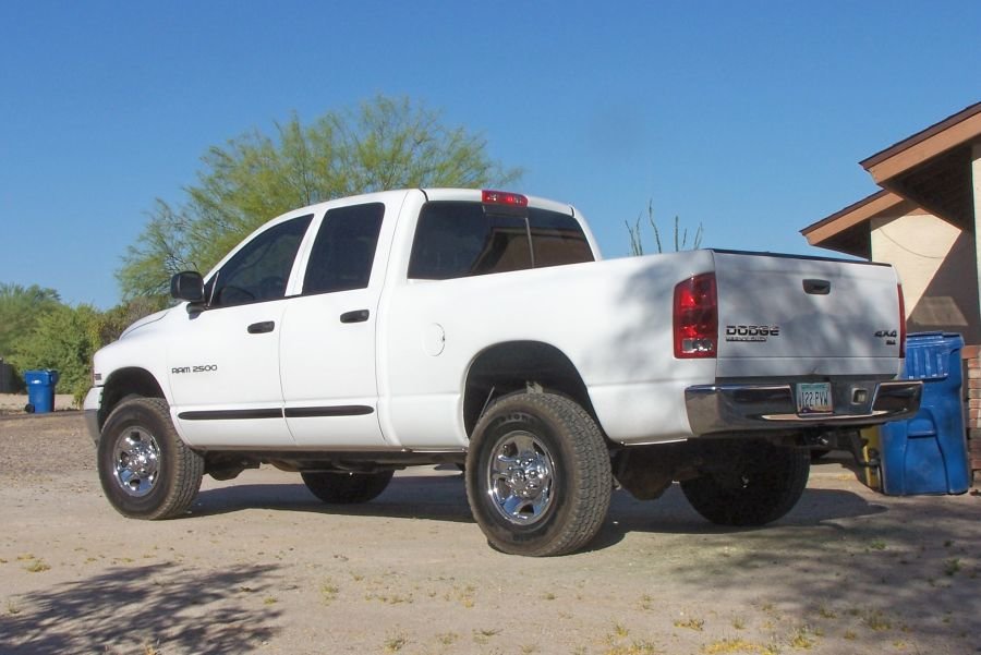

    2004 Dodge Ram 2500HD 4x4
    She's used mainly to haul heavy loads and tow the travel, horse, and boat trailers.

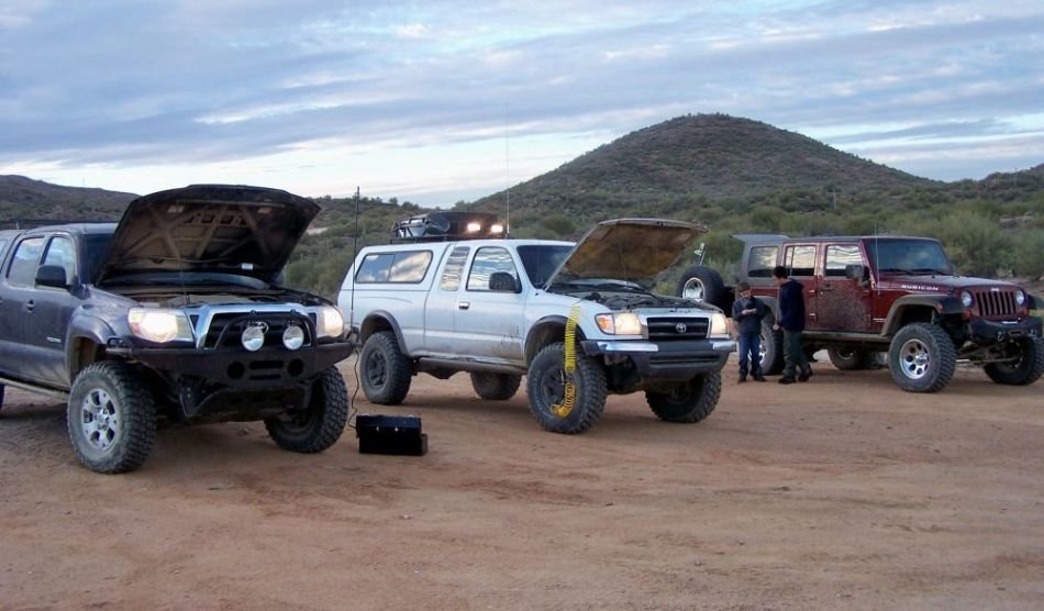

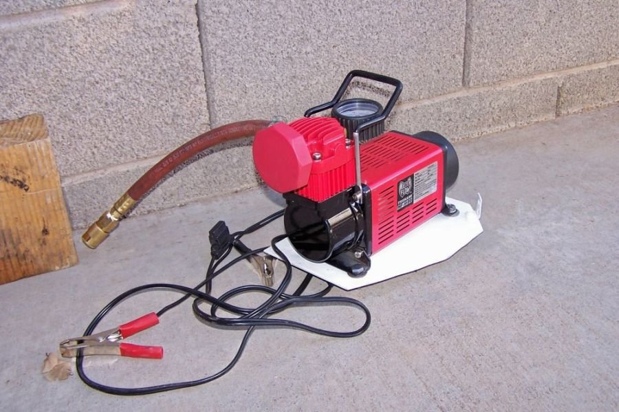

    Early on I knew I needed air so I could air-down for comfort and traction. Went with a Master Flow for $50, lasted almost 10 years. I exchanged the crap hose connections with my own universal, fabbed a mounting plate, and stuck it in. I relocated my alarm horn and snipped the alligator clips to permattach to the battery.
    Here we are airing up. You can also see my KC 26 series lights. The two front are long range and the two rear are flood. I got them because they are small and rectangular, like my roof rack. They are good for the price, but if I had to do it again I'd probably get bigger ones for the front. Maybe I'll put two more up front someday.

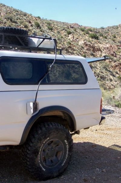

    This pic shows the rear lights and "external fuel cell," which is my low budget auxiliary fuel tank. It's a 9 gallon boat tank, painted and secured. All I do is attach a fuel hose to the tank, squish the primer bulb a couple times, and it gravity feeds into the main tank. Right now my max cruise range is 600 miles; 18 gal tank, 9 gal fuel cell, 5 gal jug.

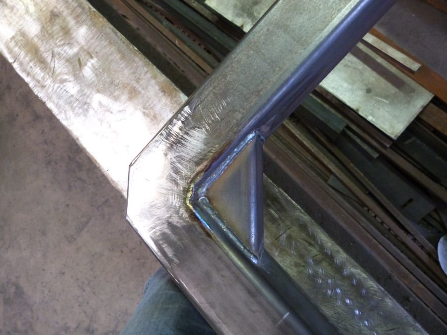

    I hadn't planned on a winch so a heavy front bumper didn't make a lot of sense to me. I did want a better approach angle for the tires though so I cut the sides of the bumper! To do this, I had to move the blinker light into the corner light... ghetto, but pretty easy. I recently put on an All Pro tube bumper and kind of wish I had done it sooner.
    This shows the cut bumper pretty well:

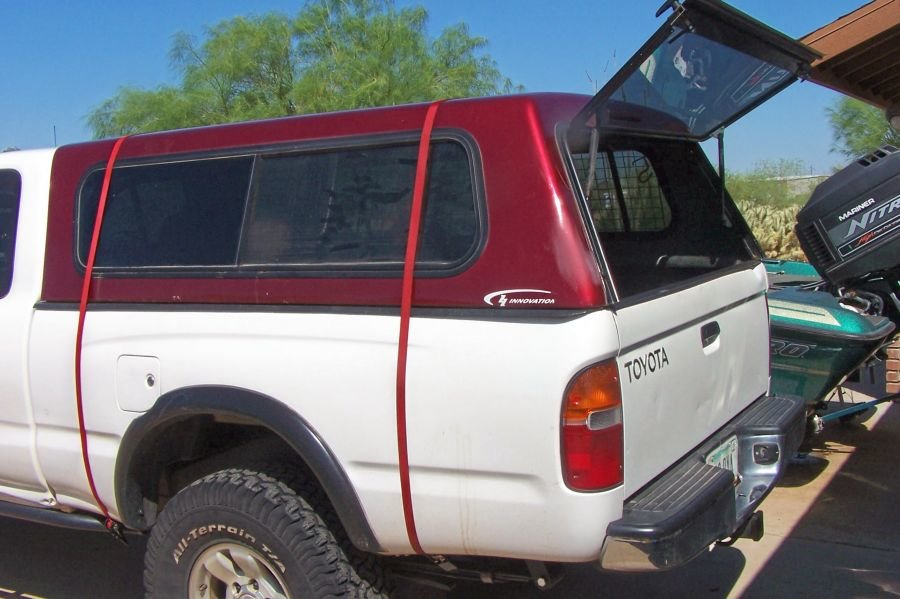

    I bought the camper shell off craigslist for $125. Scuffed it, primed it, and rattle-canned it for about $50. Is the paint an exact match? Nope. Does it matter? Nope!

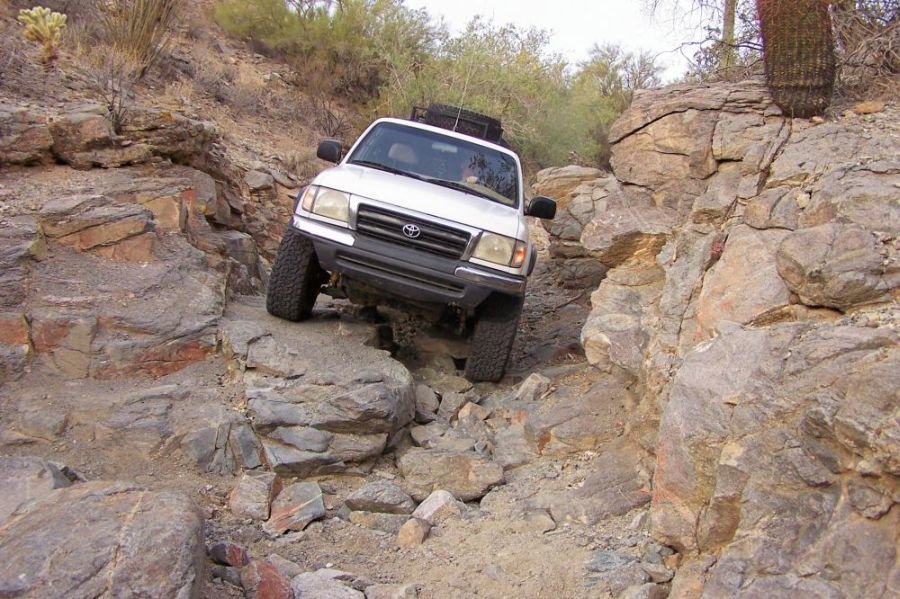

    RANDOM WHEELING PICS
    Near Prescott, AZ
    Anza Borrego, CA
    Pyeatt Draw, AZ
    Big Bend, TX
    Mohave Road, CA
    White Tanks, AZ
    Elk Mountains, CO
    Outside Las Vegas
    Near Oatman, AZ
    Moab, UT
    Joshua Tree, CA
    Broken Arrow, AZ

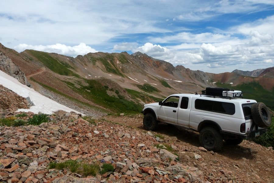

    White Rim Road (Canyonlands) UT
    El Camino Del Diablo, AZ
    Elephant Hill (Needles District) UT
    Death Valley, CA
    Grand Canyon (stock!)
    San Juan's, CO
    Big Bear, CA
    New Mexico

    I think I got the compressor from Pep Boys, but you can get it off Amazon for $60. And I've never considered my poor old truck "great looking" but I'll take the compliment!

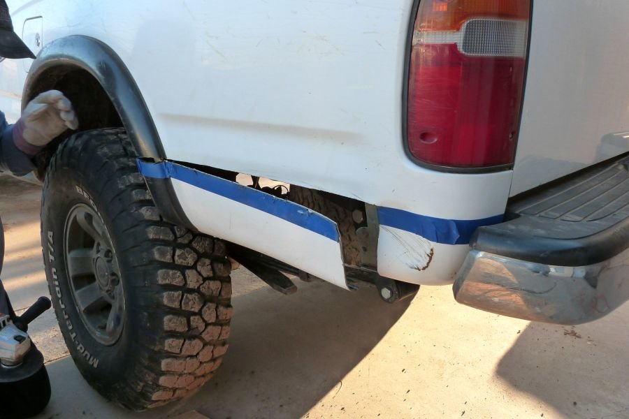

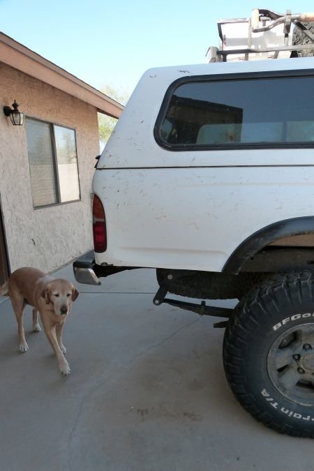

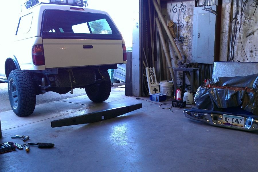

    Yanked off the receiver hitch and cut my rear quarter panels to make room for the new bumper. Actually my cousin did most of the cutting. The nice part about having faded, dinged, scratched, 200,000+ miles is you don't necessarily need precision!

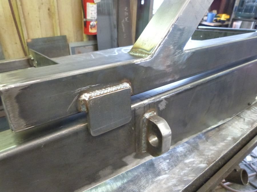

    Rear bumper is almost done!

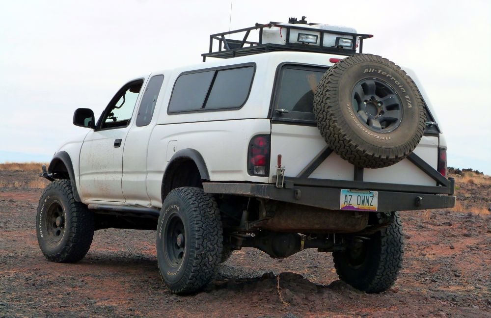

    Bumper is ON.
    My Rustoleum Satin paint job was about as good as my sheetmetal cutting...
    Now I will mount my tire and install a license light. Pretty soon I will put on some mounts for my hi-lift jack.
    Special thanks to Aaron for making this at an incredible price. Super quality and a really nice guy who's easy to work with.

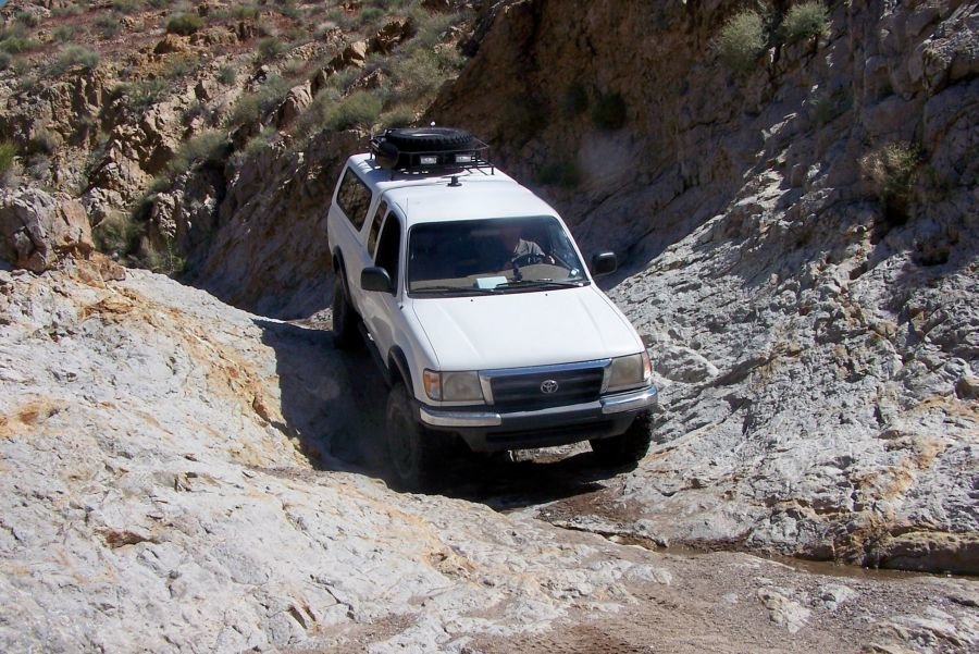

    First pic was in the White Tanks, probably Lower Scorpion... quite a long time ago. The 2nd pic was a trail near Oatman, here is another one from that trail:
    And a few more from that trip in 2011.
