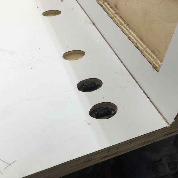

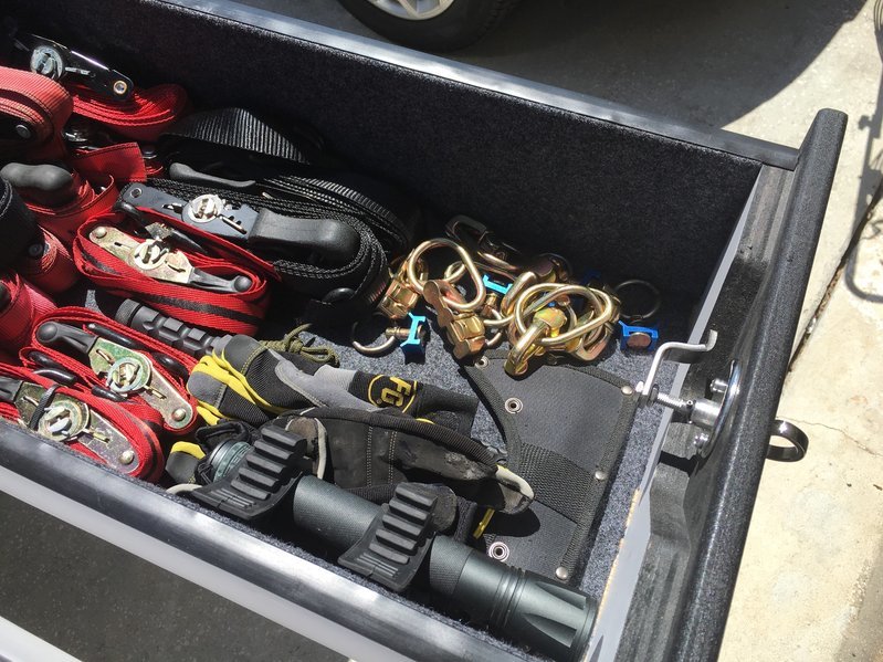

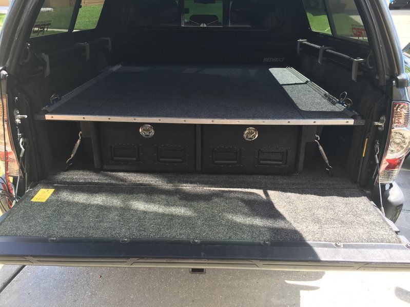

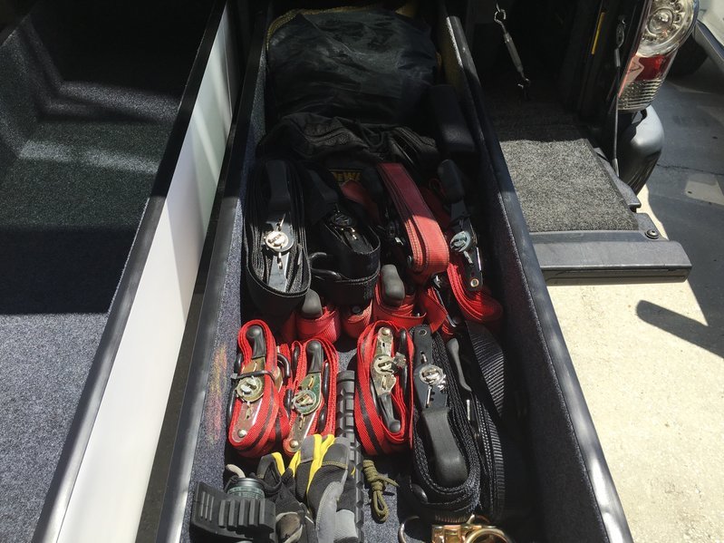

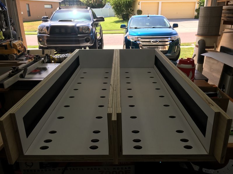

    Several weeks ago I started building my bed storage/platform. I would have loved to have purchased the Truck Vault one, but $2,800 was not something I wanted to spend so I decided to build my own. Used 3/4" plywood for everything, and the drawer rollers are trunk casters. Turned out good in my opinion what do you think?

    Based on load rating for 3/4" plywood and adding the laminate you are looking at a load rating in a 3" square of 1,000lbs easy. My drawers are 14" wide so that is the span of the plywood. Basically you don't have anything to worry about with load if that is your concern with what you listed.

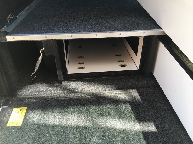

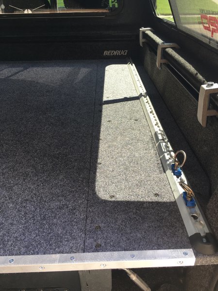

    Nice setup. So is the top deck stationary or does it slide out?

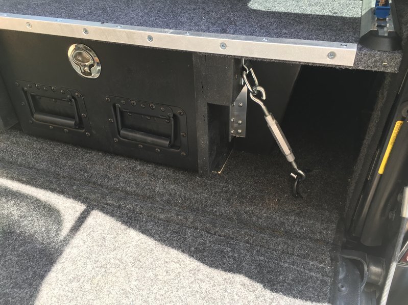

    I assume the turnbuckles prevent the whole framework from leaving the truck bed. Are there just the two rear turnbuckles or do you have other means of keeping the unit from shifting?

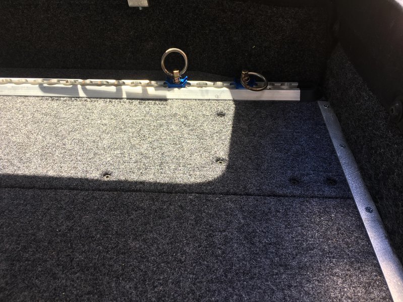

    The top is stationary. Yes the turnbuckles are precautionary so if I put something heavy on top that hangs out it won't tip or slide out if the tailgate is down. Their are (2) turnbuckles at the front of the truck where I added the bed d-rings and the (2) at the rear that are shown.

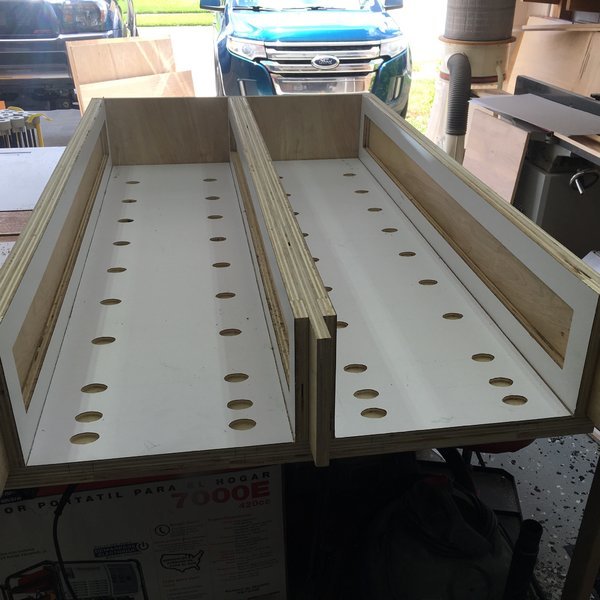

    More questions: did you build the drawers too? What kind of construction? Where did you get the casters? More details, More Details

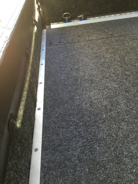

    I built the whole thing including the drawers. It is all out of 3/4" birch plywood. Any surface not bed lined is laminated with Formica which also strengthens the wood. The casters are trunk casters which you can get from Van Dyke restorers pretty cheap. Damn near everything else I sourced from Amazon like the marine carpet, tie down track, plastic trim on doors, spring handles, marine latch. Wood and misc hardware was from lowes. All in materials and everything was about $700. As for making it I have a full woodworking shop in my garage. What other details do you want?
