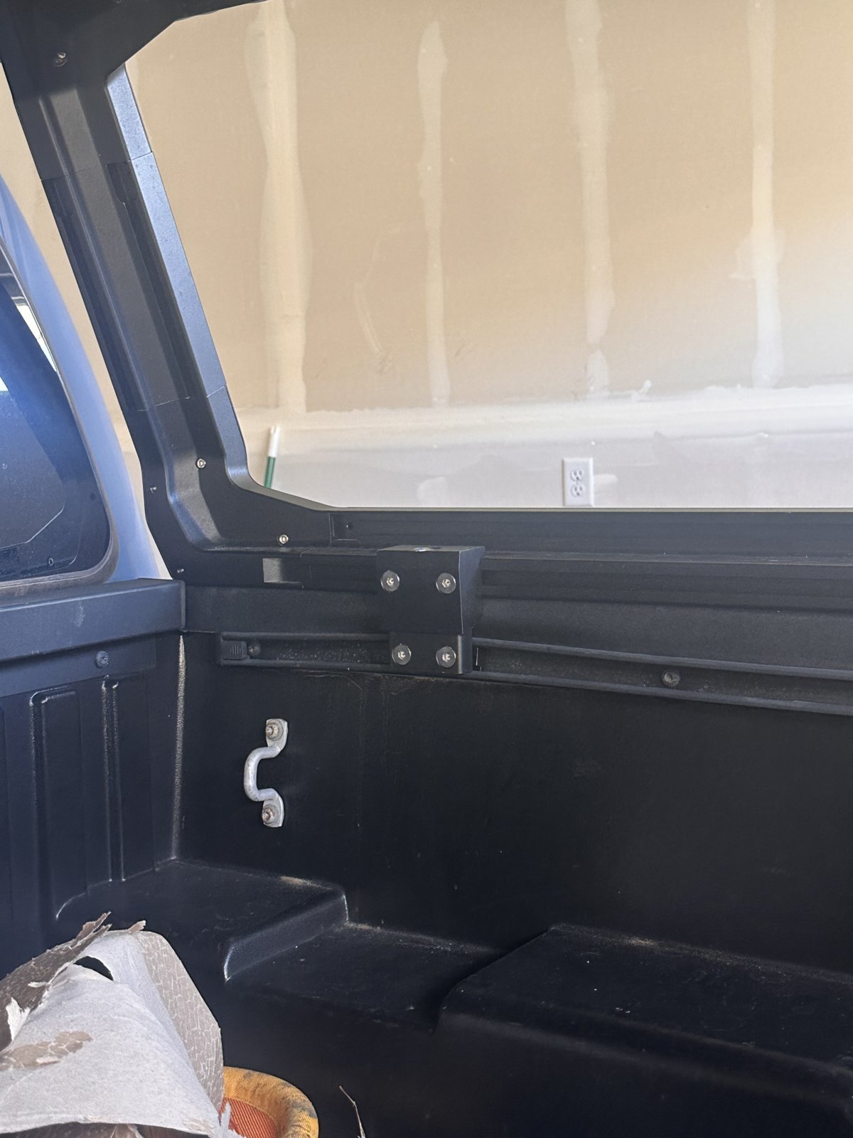

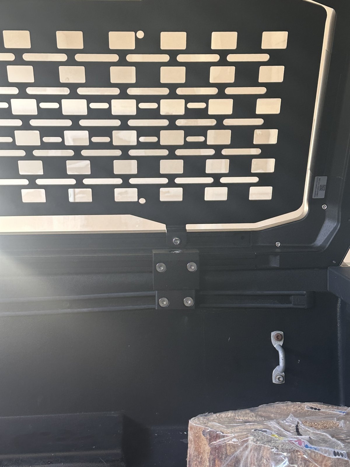

    Hi there. I have attached two photos of my bed mounting channels which I’ve used to mount my bed rack. I tightened the bed rack brackets in the photos onto the bed channels, and to my surprise the bed channels started to bend. The plastic is bending as well as you can see. I was shocked by how weak the channels are. Is this normal? The bed rack feels secure, but I’m not sure what will happen once I go off-road. There is a 200 pound hard shell tent on top of the racks, and as the racks wobble back and forth off-road, I am concerned that the weight of the tent will lift the brackets against the channels, bending them even more. Any suggestions to fix this or is it normal/okay?

    those mounting channels are not intended to support large loads… they are thing sheet metal. You’d also do better mounting those brackets close to where the channels are mounted with a screw. Less likely for it to bend there.

    ^This. Put the mounting brackets right next to a channel mounting screw, and don't go nuts torquing it down. Most of the weight is going to rest on the bed sides, you should be just fine. Might want to consider bed stiffeners, though.

    Yes, I’ve seen it.
    The issue goes all the way back to the 2nd Gen trucks.
    I experienced this back in 2006 when I used the channels to mount my tool box.
    I still think Toyota should have added more bolts. Maybe one more between each that are there now.
    And it would be nice if the channels were a bit “stronger”.
    While my case wasn’t as extreme as yours, I knew then “there was a problem”.
    While the bed rails are nice, they are not robust.

    I don’t think they will “bust”.
    What will happen is the “C” will open up and then things will get loose.
    As soon as you start putting any lateral movement on the rack, it’s going to get loose.
    Next issue will be the bed corners.
    They like to crack too.
    Go ahead and look into bed stiffeners.
    You’re going to need them.

    Moving the brackets closer to the screws will help.
    Definitely do that.

    Using more mounts would help too.
    My 4 on each side. Maybe more.
    I love Toyota, but the bed rail system is “weak”.
    There will be guys disagree, but I’ve used mine enough to know that they bend if you put “up” or “down” strain on the channels. The “D” anchors also add leverage. And make the torque applied “worse”.

    can you adjust how the rack is mounted to those bed rails? like extend them a little more so they dont skew the bed rail up?
    like adjusting these 2 bolts on each clamp?

    The entire bed will flex separate from the cab. That may be part of what you are noticing. Watching your video, it looks like the rack itself is flexing a bit and deforming. With that modular design and minimal cross-bracing, I would expect a little of that.
    You may be overthinking this a bit. Make sure all rack assembly bolts are snugged up and check them again after using it a bit. Move those clamps near a channel mounting bolt. Go have fun.

    I have the same KUAT bed rack installed on my Tacoma. Definitely a different mounting syste than I am used to from previous bed rack. I mounted my mounts closer, so do not have quite that issue.
