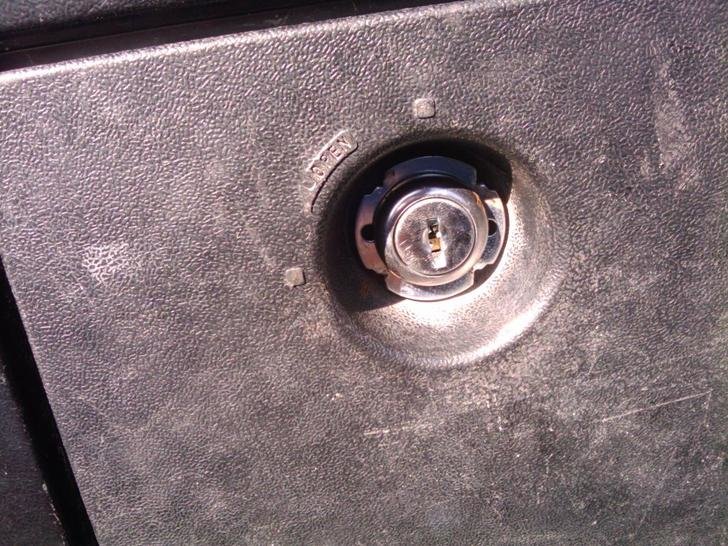

    ok guys heres my first write up so bear with me..

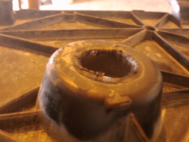

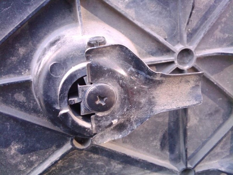

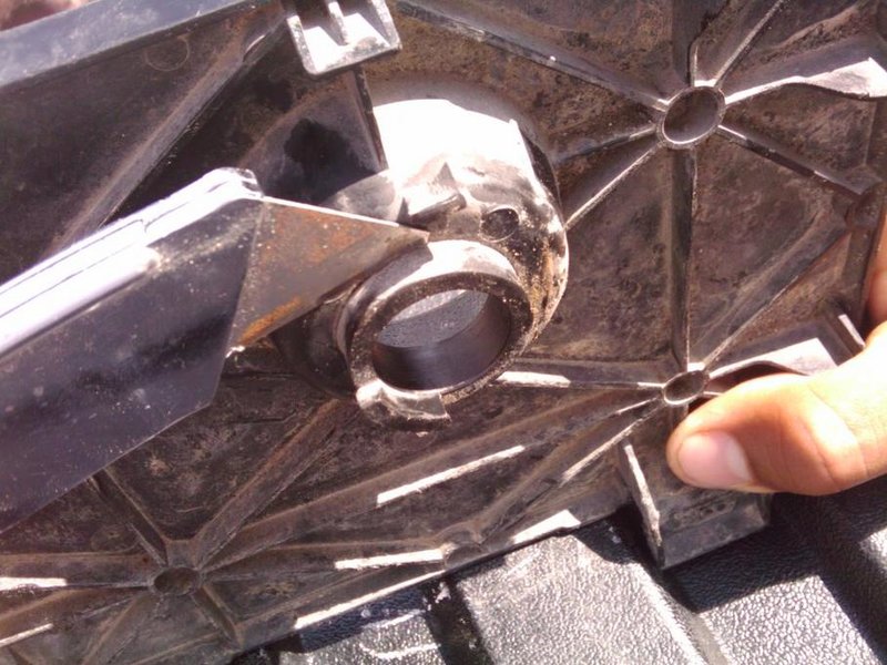

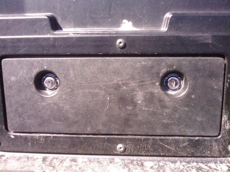

    so i decided to put locks in the bedcompartments. i bought them at home depot.they are actually cabinet and drawer locks. for 5\16" thick panels. you can buy them all with the same key code so you can used one key for all of them. so first i took off the doors and unscrewed the original 'locks".. then i had to trim the lip off of the back and open the hole up just a little bit so the lock cam would go through the hole.. then push the cam threw and put the locking nut on. tighten it up so cam doesnt move. then just put the long flatbar on and screw it in. i had to trim the end of the flat bar to fit, plus i had to bend it in alittle. its not difficult to do and if some one really wants in they can pry it open but usually people will see the locks and just leave them alone.. hopefully this helped..

    Looks good. Pretty cool mod.

    I like it... would do it if I didn't have an access literider and a dynolock... but good job anyways

    Very nice mod and very useful. Should be standard along with a locking tailgate. Great job

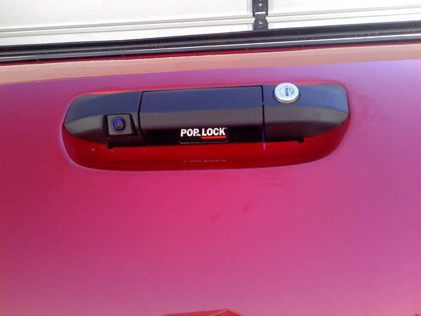

    Nice mod. I'm waiting to get a tonneau before I store anything in those compartments, but I still wouldn't put it past some scumbag to take off w/ the covers.

    The Pop N Lock PL5300 works with the backup camera

    Dynolock works with camera too, and it works with power doors and keyless entry
