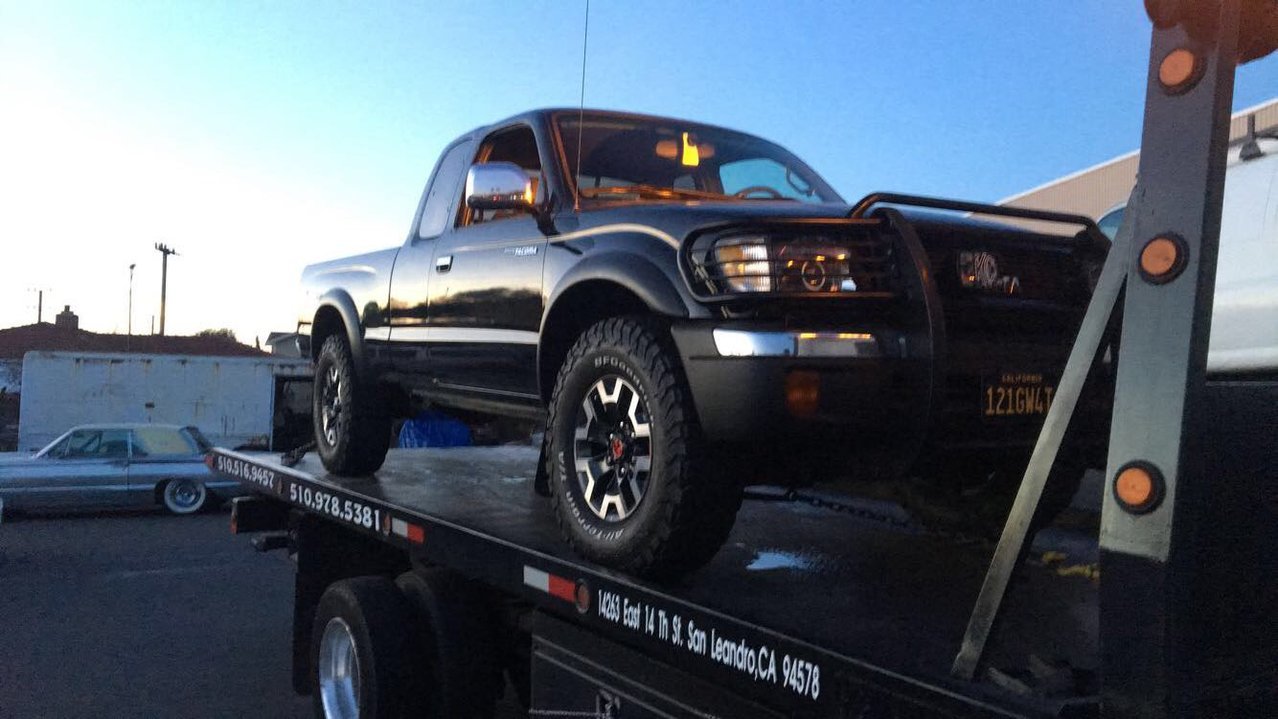

  17. Feb 1, 2018 at 12:42 AM
    #217
    Dalandser
    Dalandser [OP] ¡Me Gustan Las Tacos-mas!
    Feb 19, 2015
    #149090
    17,621
    Anthony
    Downey
    08 PreRunner Regular Cab / 98 4x4 Extra Cab
    Empty Wallet Mod
    Solo is one of the best companies I've interacted with - they have said it's their way or the highway if I didn't want to pay the full price they were asking to install my front kit (there's welding involved, so that leaves me without many options for mounting the coilovers myself).
    Instead they said they'd weld on some temporary shock tabs and let me drive over to their shop with my stock coilovers after I do all the bolt on part of the install. They didn't have a stock lca on hand to figure out how far out to put the shock tabs so they asked me to measure for them - just how far out from the cam bolt, I think they can keep it in line with the coil bucket since their jig would have that measurement anyway. I included the space between the tabs in case the ones they install are different.
    I love that they don't talk down to me at all even though I'm cutting costs wherever I can and they install $10k + worth of parts at a time on some customers' vehicles and build luxury prerunners. \m/ Solo rules!
