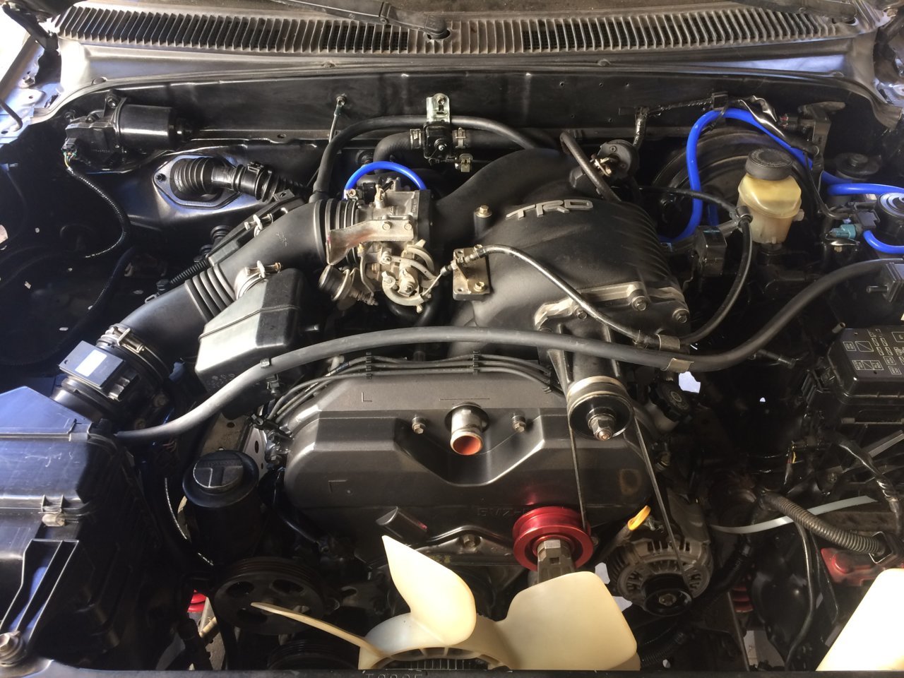

    Got the first belt on the engine. It's looking more and more like a functioning truck.

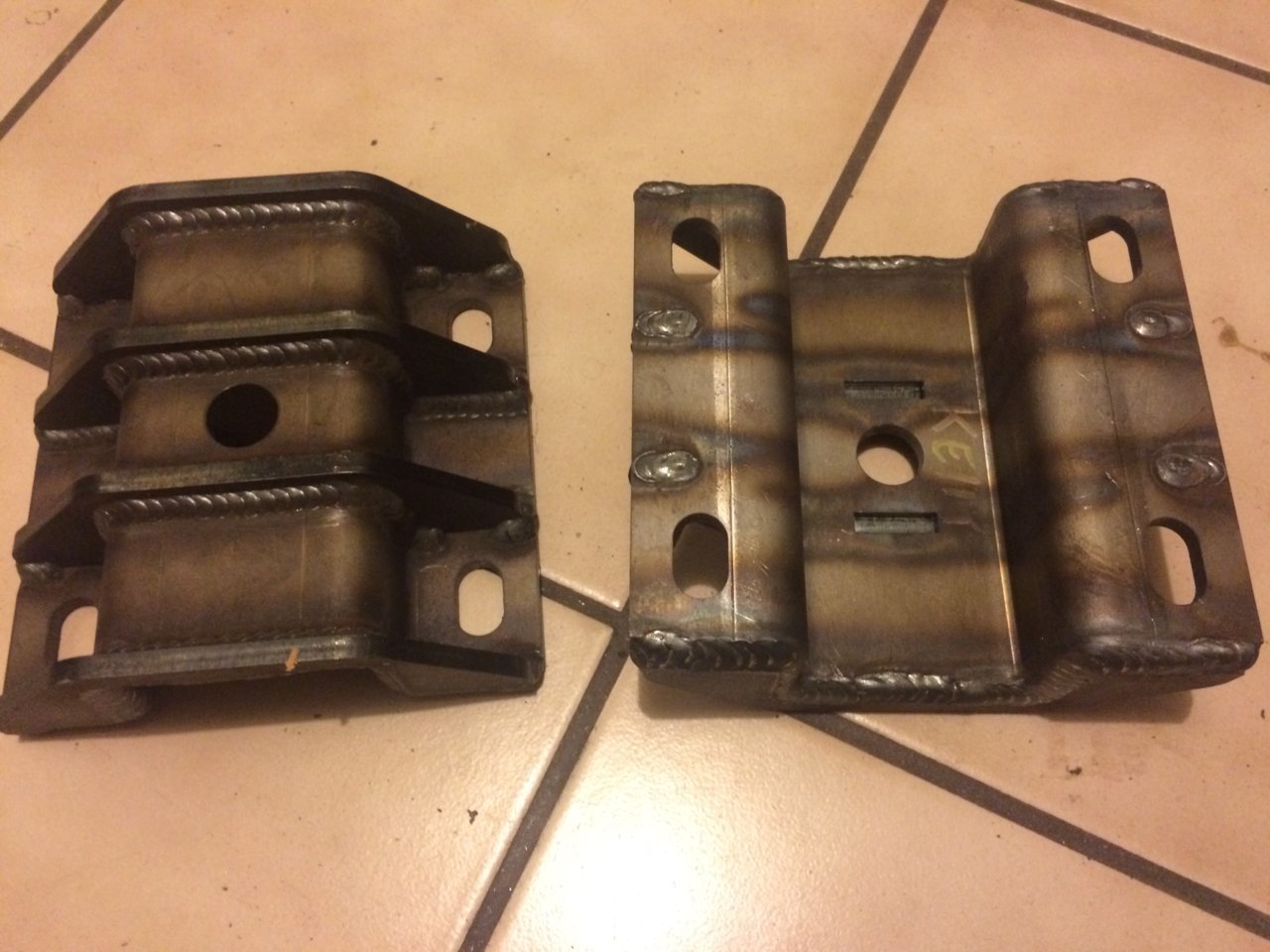

    Then I met up with a guy selling some DMZ fab spring under u bolt plates. Turned out that he works at DMZ and we had a good conversation about his truck he's building.

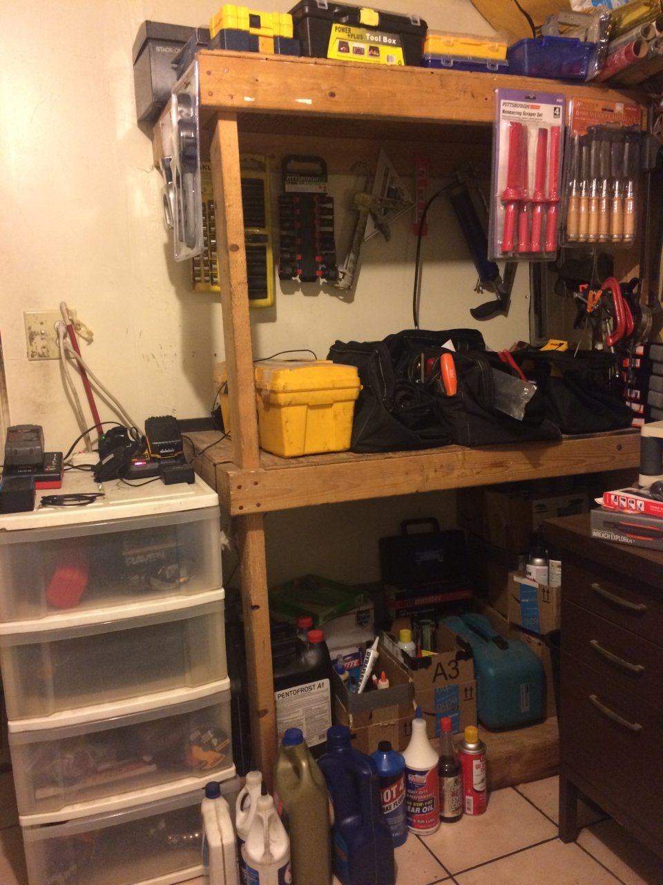

    Gave it an oil change and washed it and organized my tools:

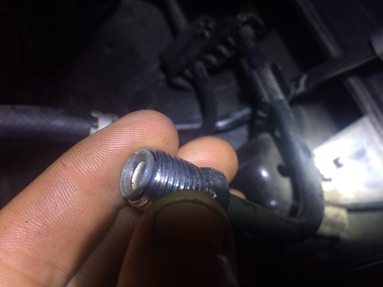

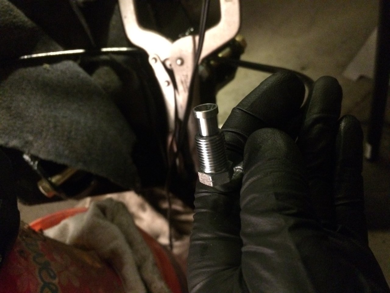

    One bummer is the threads on the fuel hard line were messed up at the end. Getting some rest and I'll try filing down the first thread or two to get rid of the messed up threads!

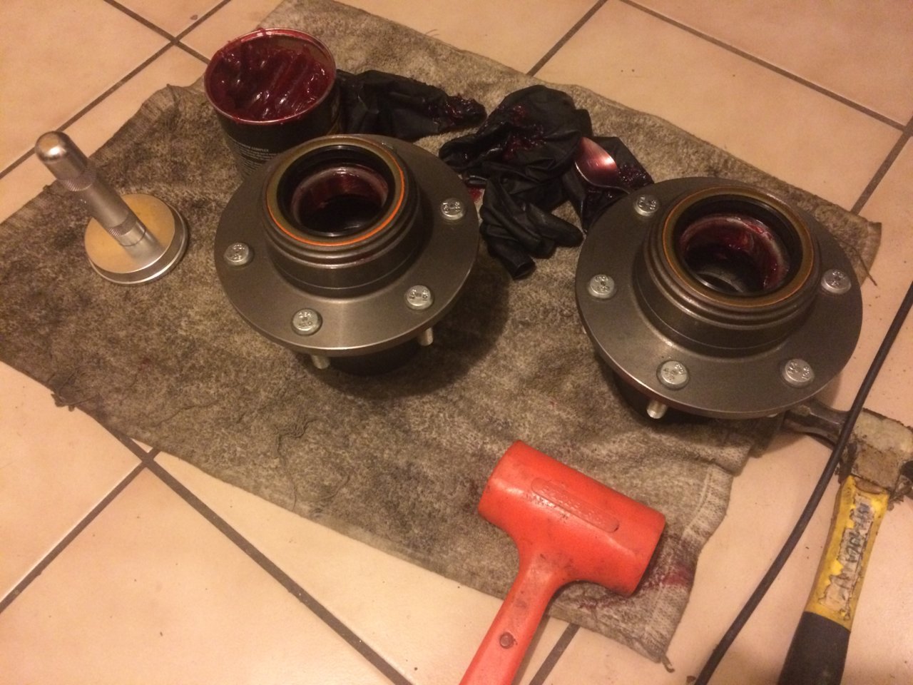

    Filed the threads on the fuel line so they would work again
    Packed a couple bearings with grease and installed the back seals on my hubs

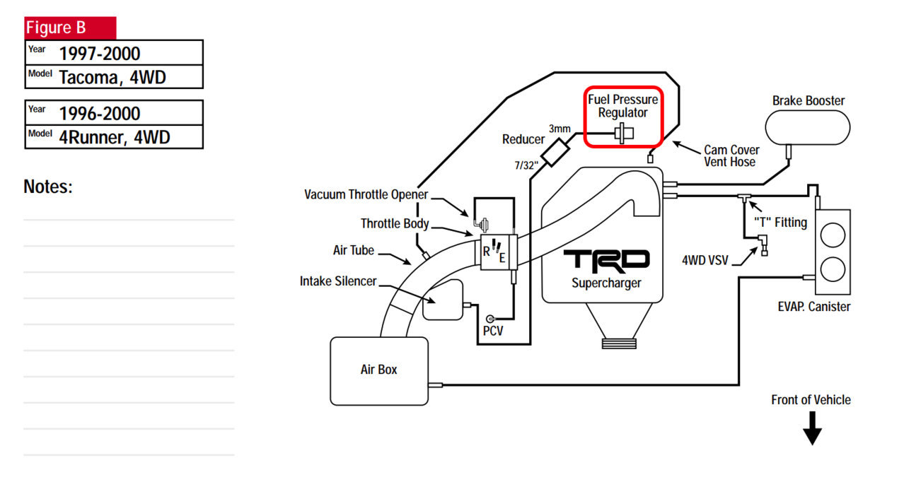

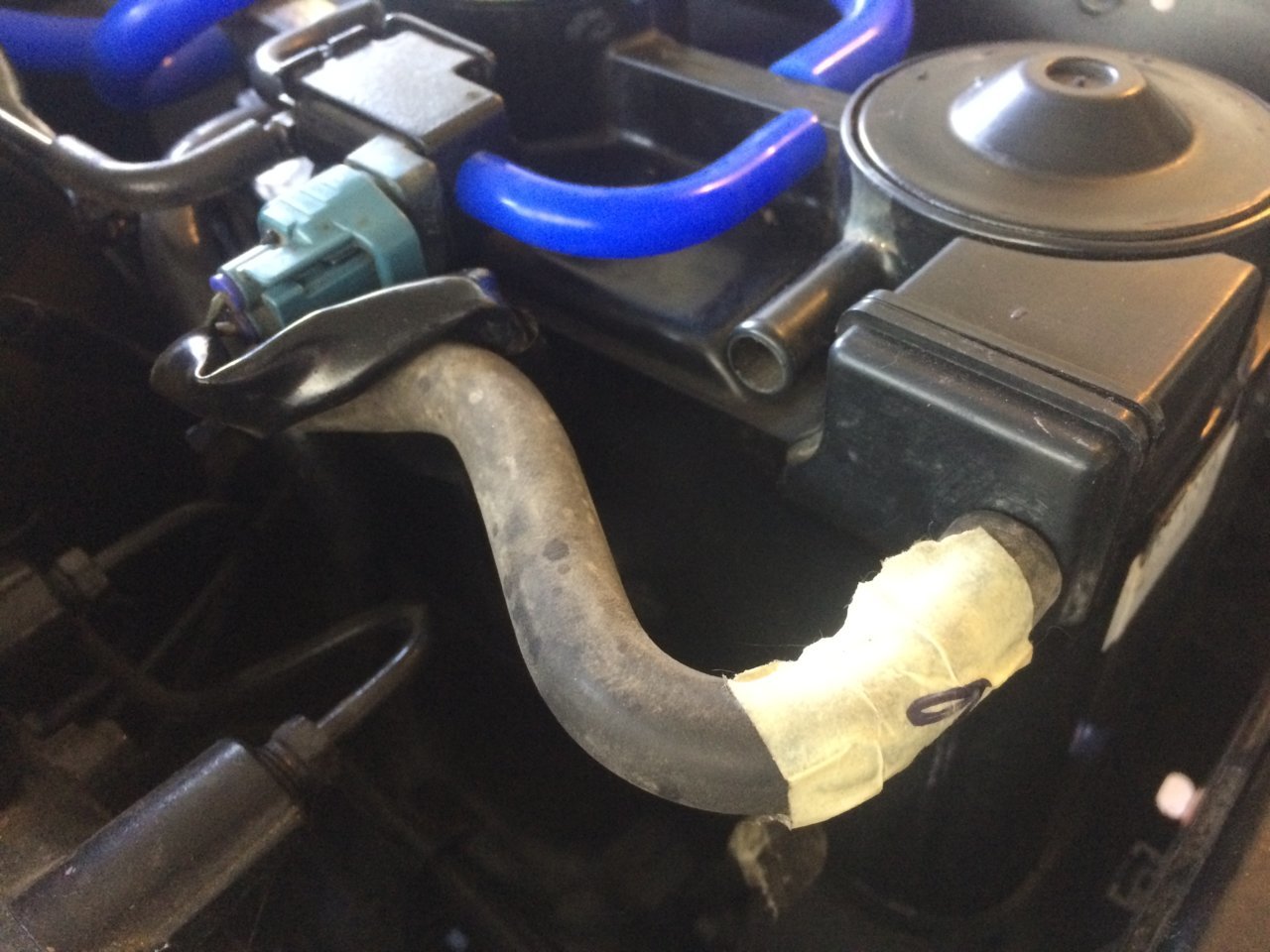

    For some reason the TRD manual suggests an atmospheric FPR reference, the Magnuson copy of the manual suggests a boost reference of the FPR from that rear nipple on the SC (also where you tee in your boost gauge). Here's more of my signature unsolicited advice ;), boost reference your FPR and throw a nice Aeromotive fuel pump in the tank.
    Dalandser[QUOTED][OP] likes this.

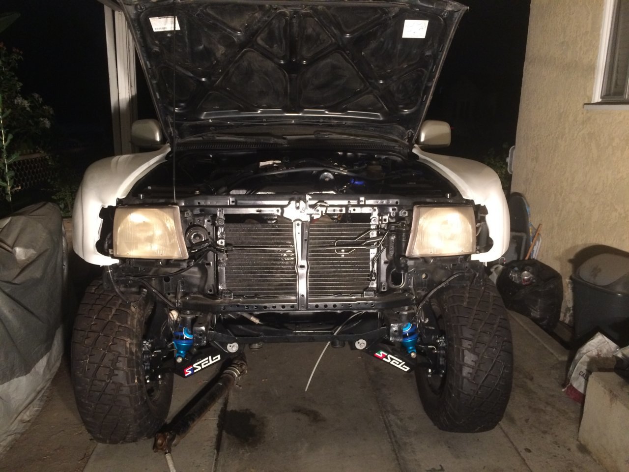

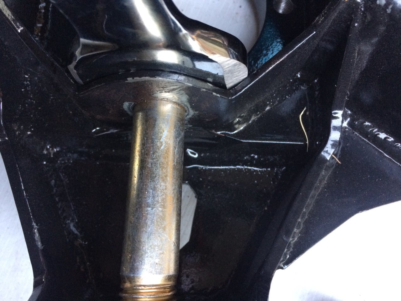

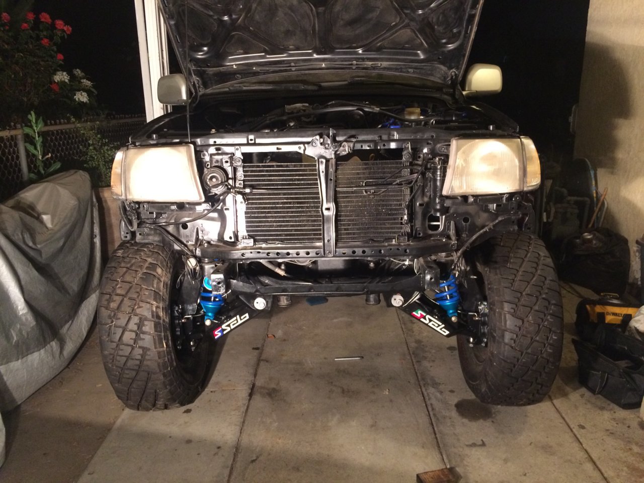

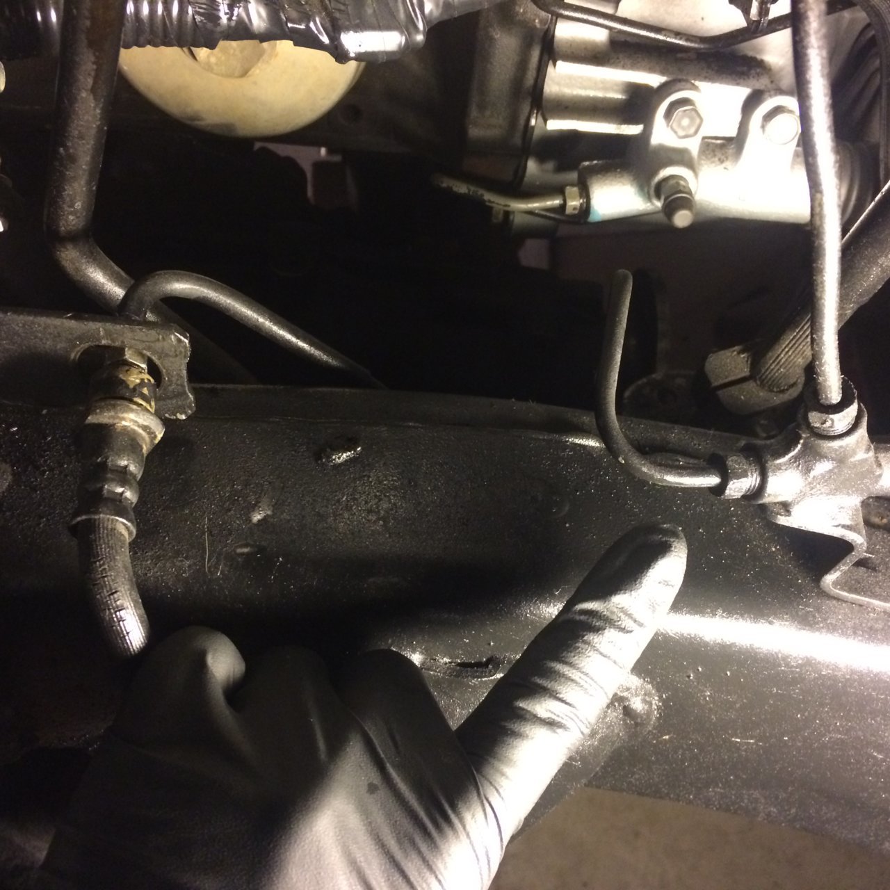

    That was the consensus in what I read too, some people said it could *possibly* help the afr under boost, but to me it was the easiest way to connect it so it got done lol. I'll upgrade the fuel pump eventually - still gotta get the 7th injector and see where I'm at with all that first. Oh yeah, I should probably start the truck first lol. Almost did that before leaving for my folks' place for a couple weeks, but other stuff was keeping me super busy...
    First, I decided against the Tundra brake mod since hearing I'd have to change out the master cylinder and brake booster as well. I just don't have time for that with all the other stuff I'm doing right now. Later on down the line it wouldn't be that hard when I have the time. I cleaned up my calipers:

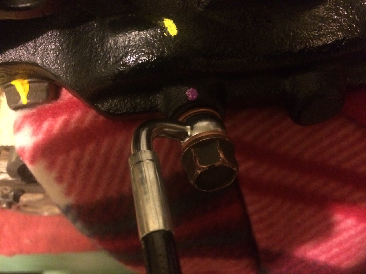

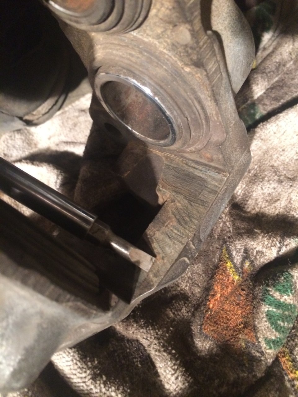

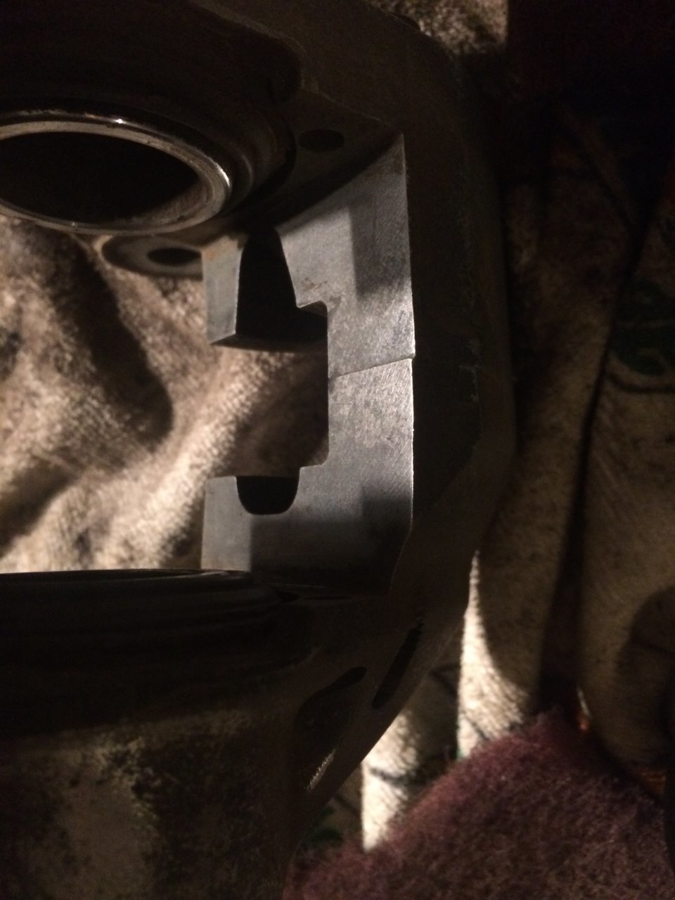

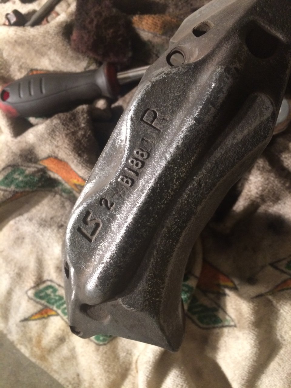

    They were nasty - I soent about 4 hours total getting the friction surfaces down to clean metal, prepping the surface, and painting them. One of the piston dust boots was torn so I removed them all and decided I'd just replace them all since they were looking awesome after painting them.
    But the boots I bought from NAPA were impossible to install - I even had one on correctly after removing a piston, but then when pushing the piston into the cylinder the whole thing popped off, even with the snap ring on place. For what it would cost for oem boots that were made better and even then the Toyota caliper design making it super unfriendly by not having a channel for the snap ring - just a smooth tiny boss to snap it to, I decided to just get the remanned calipers from NAPA for $120 out the door. I was bummed though - I put a ton of work into my calipers. Test fit the new lines in them:
    The cool thing is that with the new lines from Solo, the little section of hard line by the coil bucket gets bypassed and the line hooks up to the hard lines on the frame:
    I laughed and said these were the cleanest cores the NAPA guy would ever get. I forgot to take a picture of them when they were painted - I was running out of time before leaving to visit my folks.

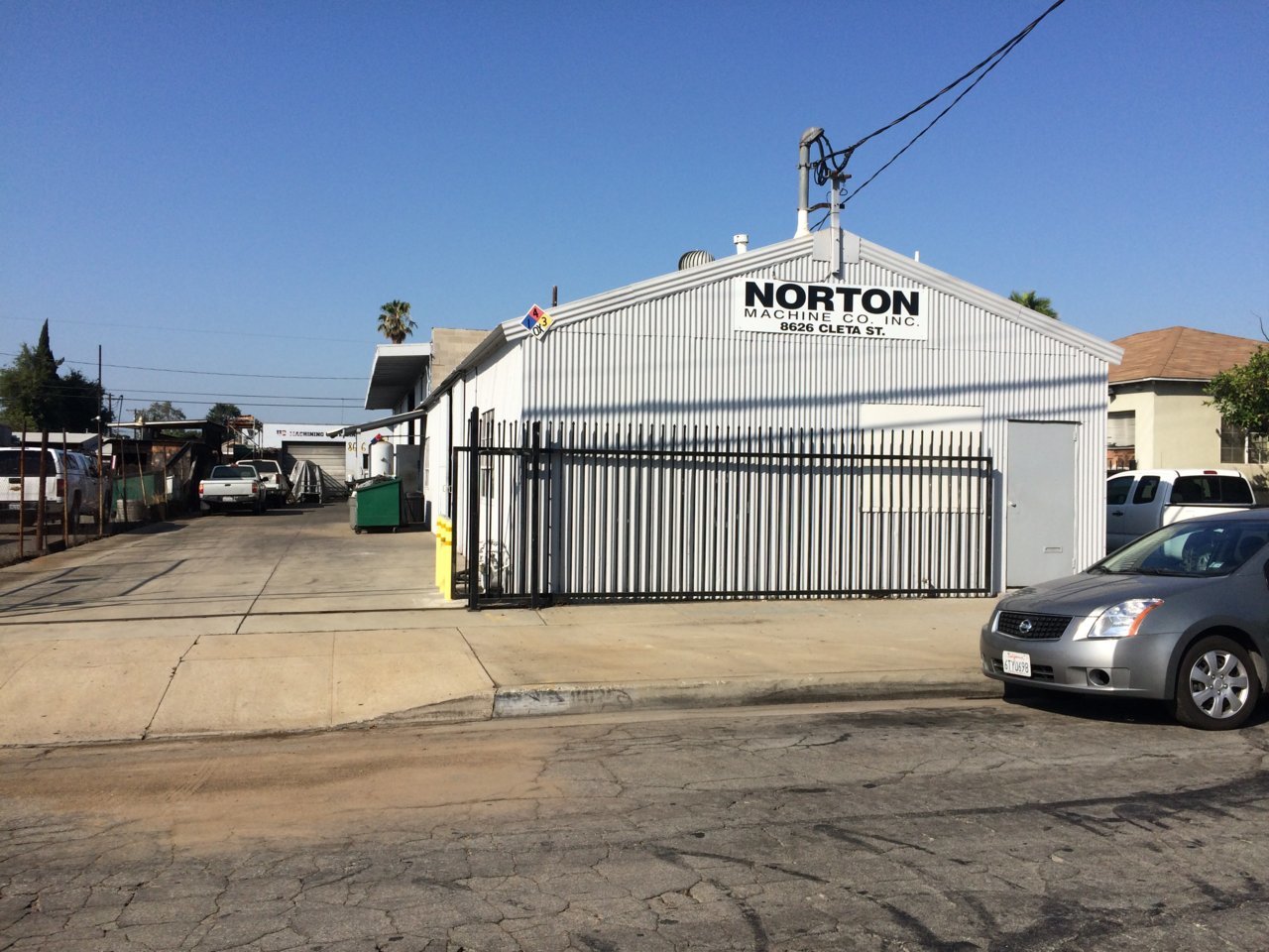

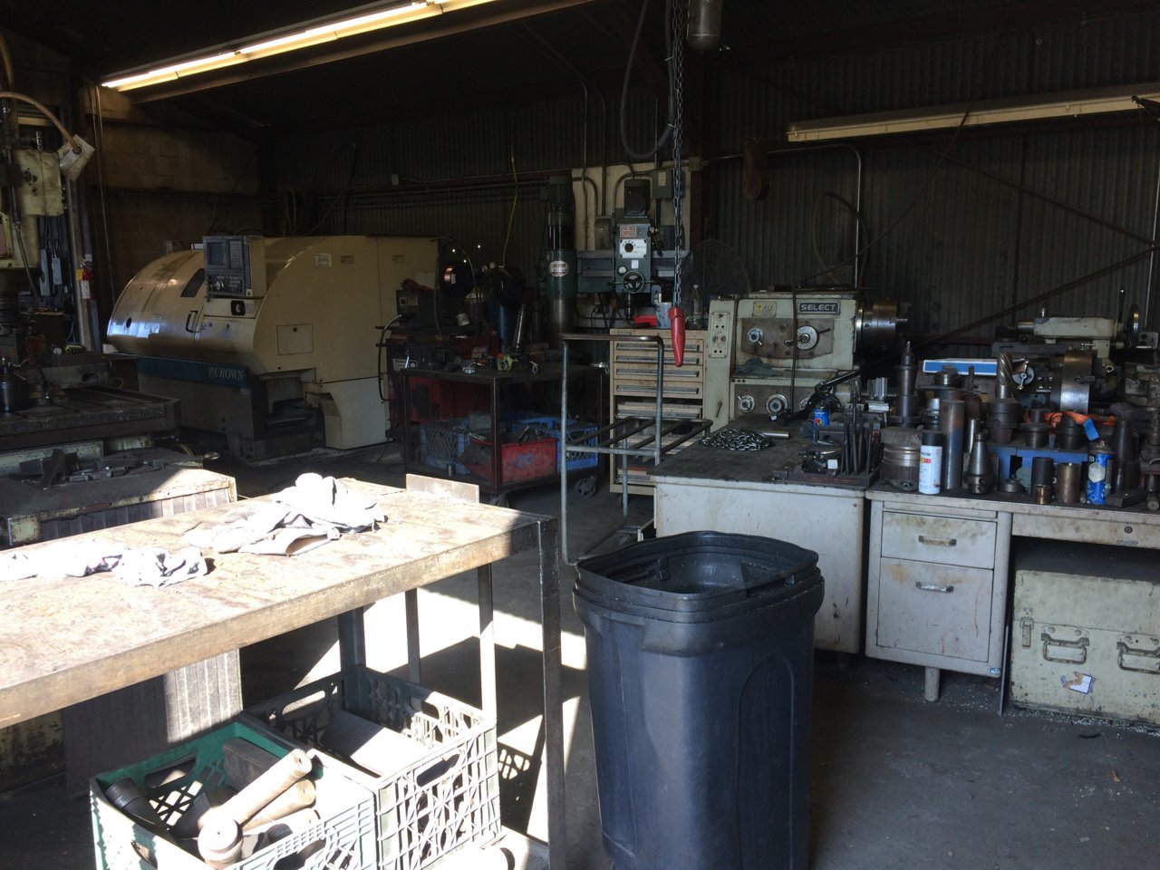

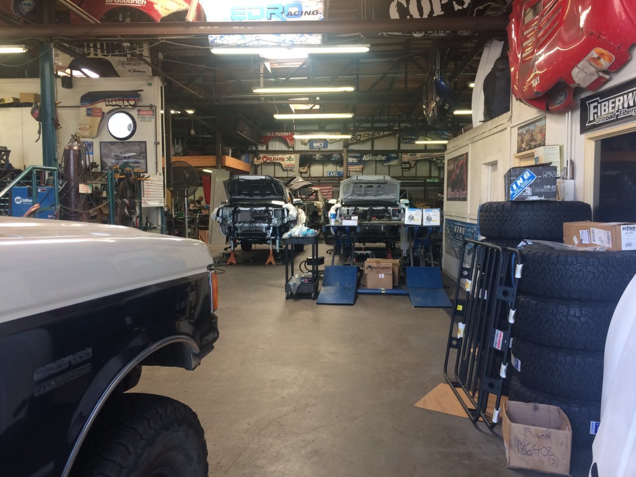

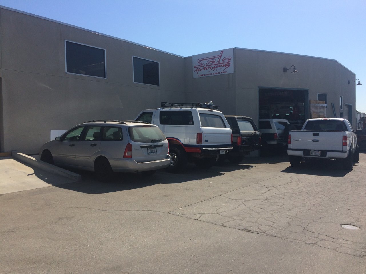

    I had previously had my hubs machined by Carl at Solo but had dropped them off with the Tundra rotors. The hubs wouldn't fit inside my old rotors and I was super bummed. The guy's at Solo had been going out of their way to fix a couple errors on some of the machining on uniball spacers on my kit and pushing me to the front of their workload. Since it was kind of my fault for making the swap for Tundra brakes w/o knowing about the master cylinder issue, I really didn't want to bug them about it. I figured I'd handle it locally on my own.
    The first machine shop owner I went to said it would be a couple of hours work and was kind of insulted that I brought the hubs to him. I was super polite, but kind of left with a bad taste in my mouth. Luckily the second place which is literally on the same block as me hooked it up - FOR FREE - no less. I gotta get the guy some business or lunch or something - I was too busy to do it since I was leaving for my trip and couldn't leave the truck on jack stands for 2 weeks. But if you're ever in need of machine work nearby Downey, here's the spot to go:
    Sark, the owner, has worked here and eventually owned it since 1980 when his father bought it and he started working here in high school. He's got a couple machines from the 1940's - I thought that was pretty cool!

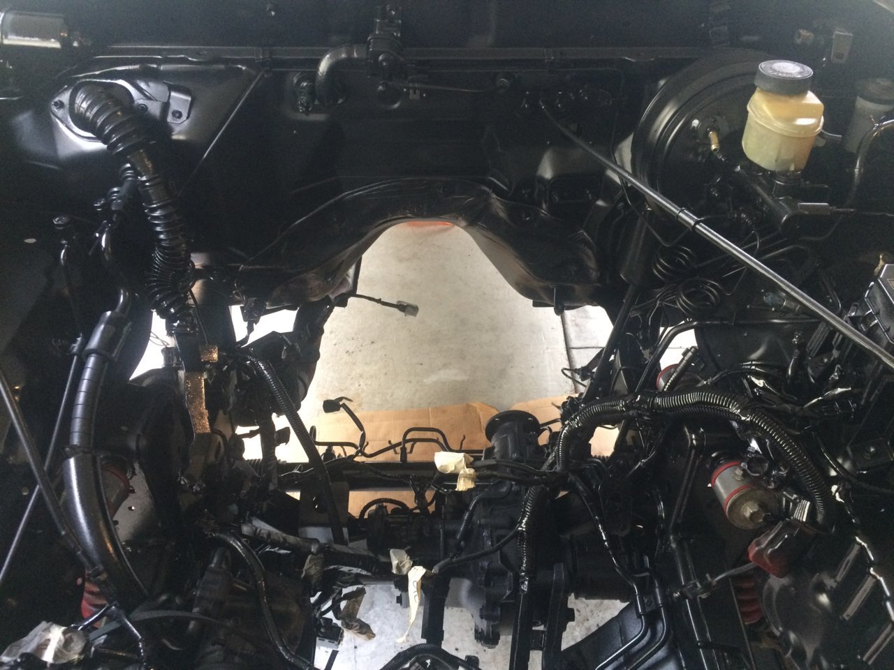

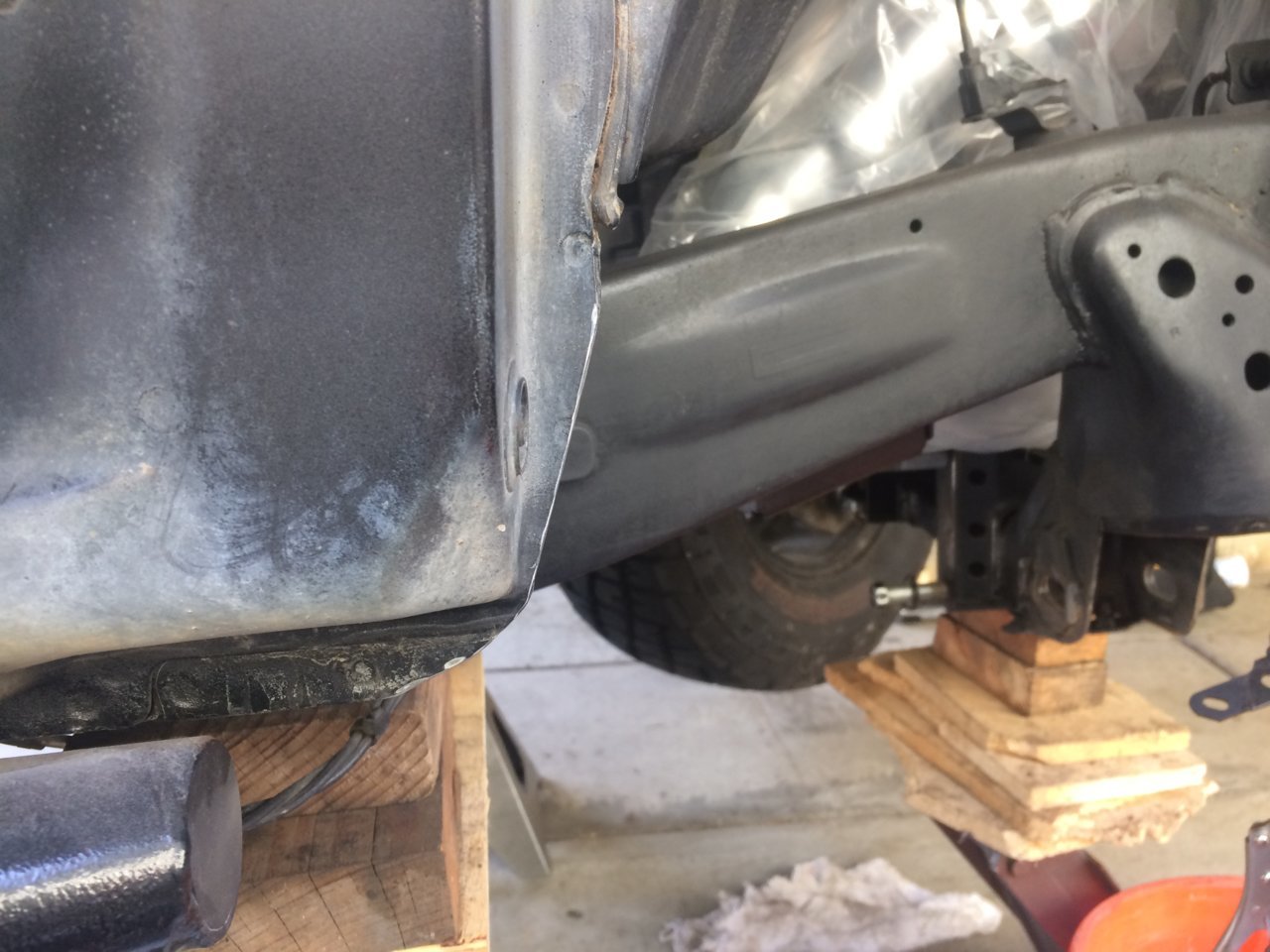

    I kept on pushing forward, cutting the pinch weld, cleaning up bolts and such, and painting. I've been using work light to bake the paint on parts - it works really well.

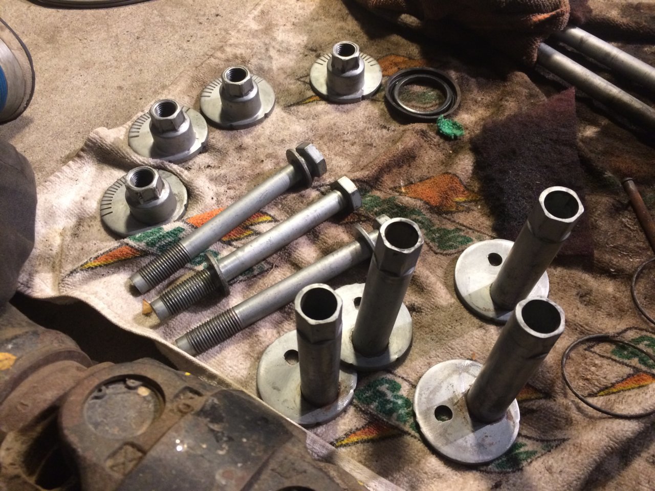

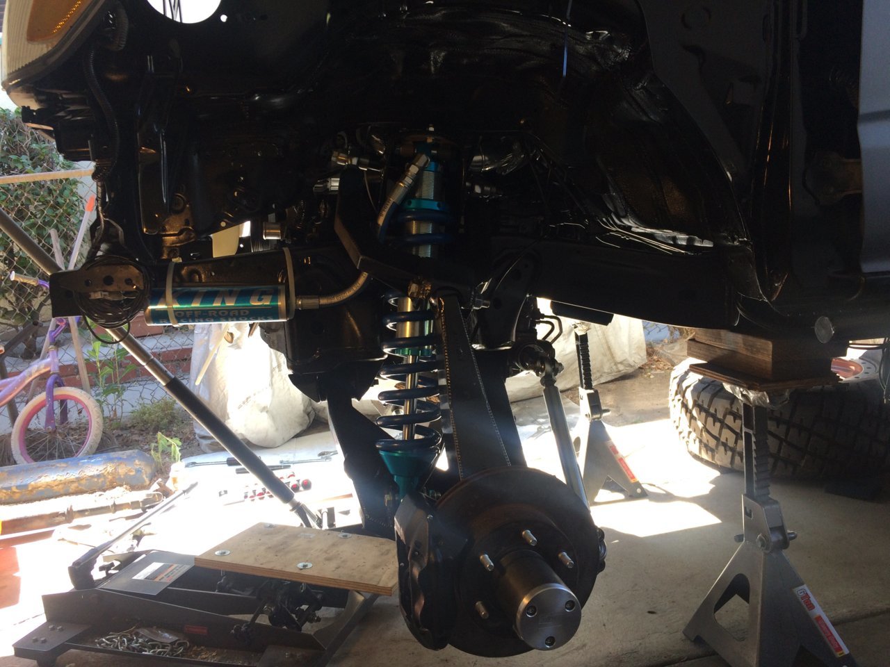

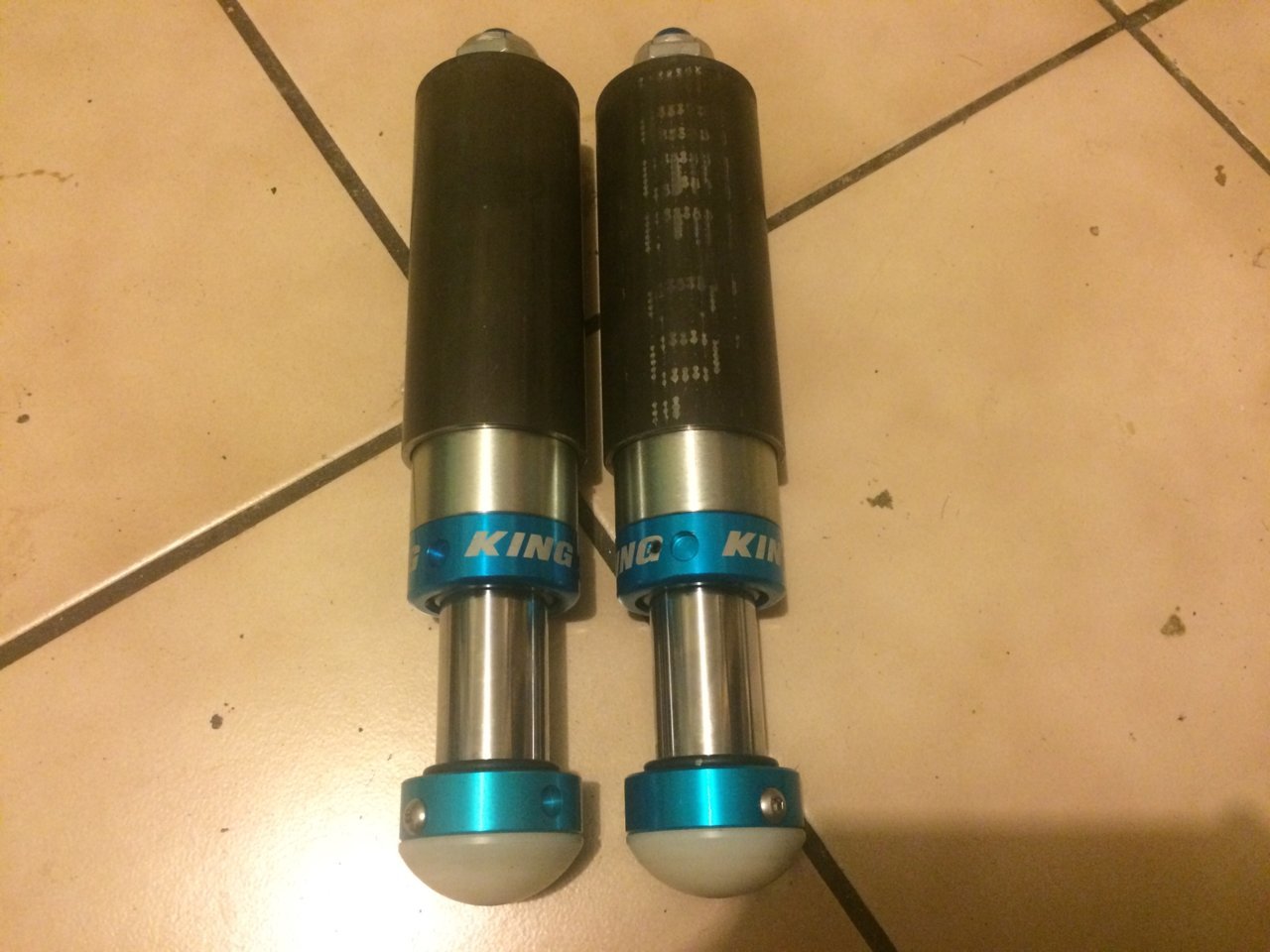

    Had to stop by King again to get some uniball spacers. They're really helpful if you're able to stop by in person. They offered to change them out for free which would have been nice since this one took me forever with all the rust on it, but I already had got it out by then. Oh yeah saw these monsters as well.

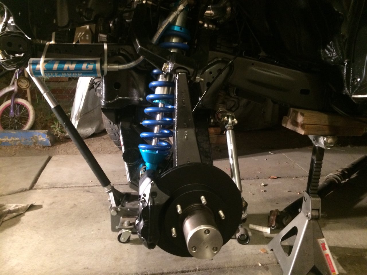

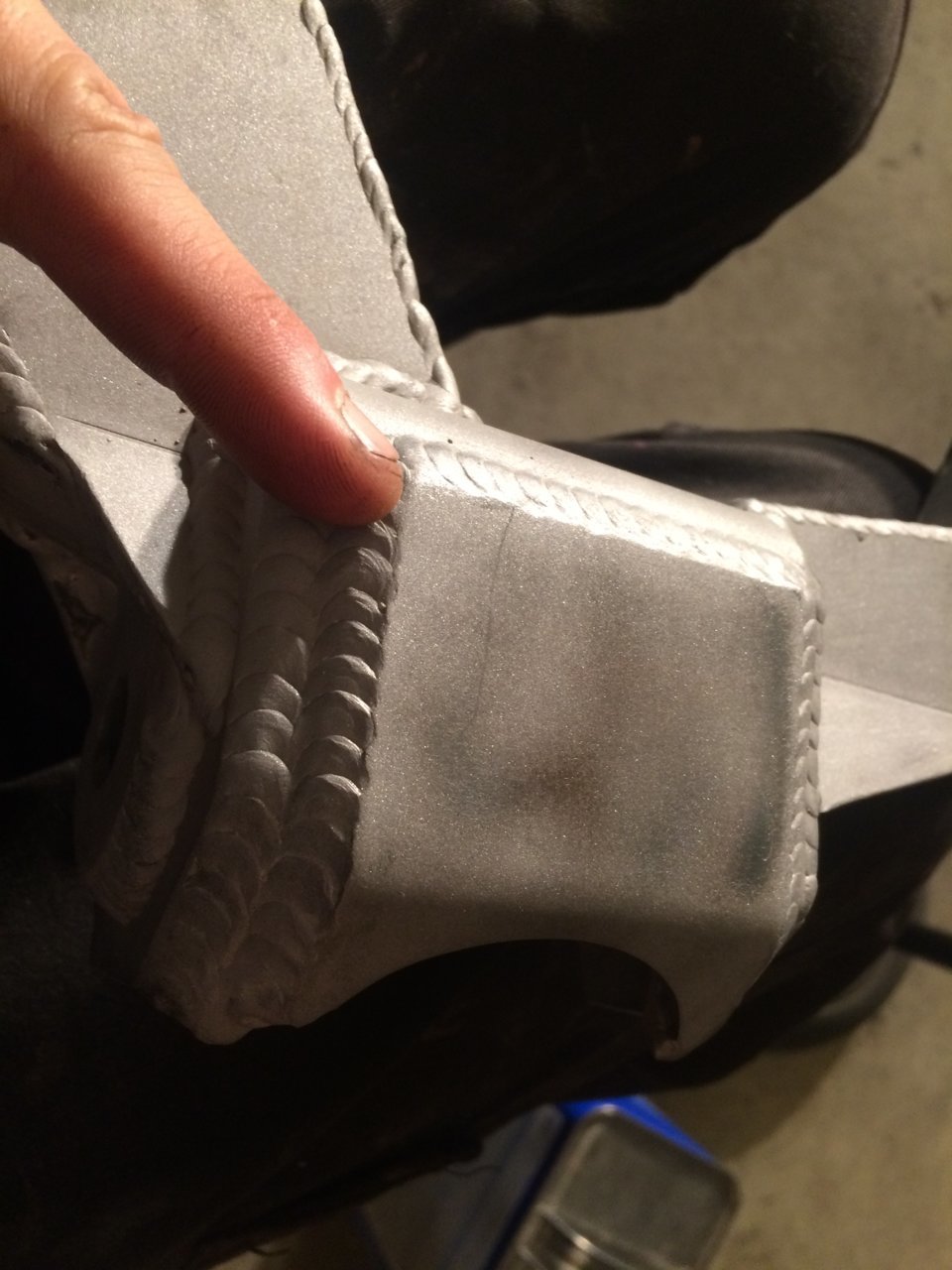

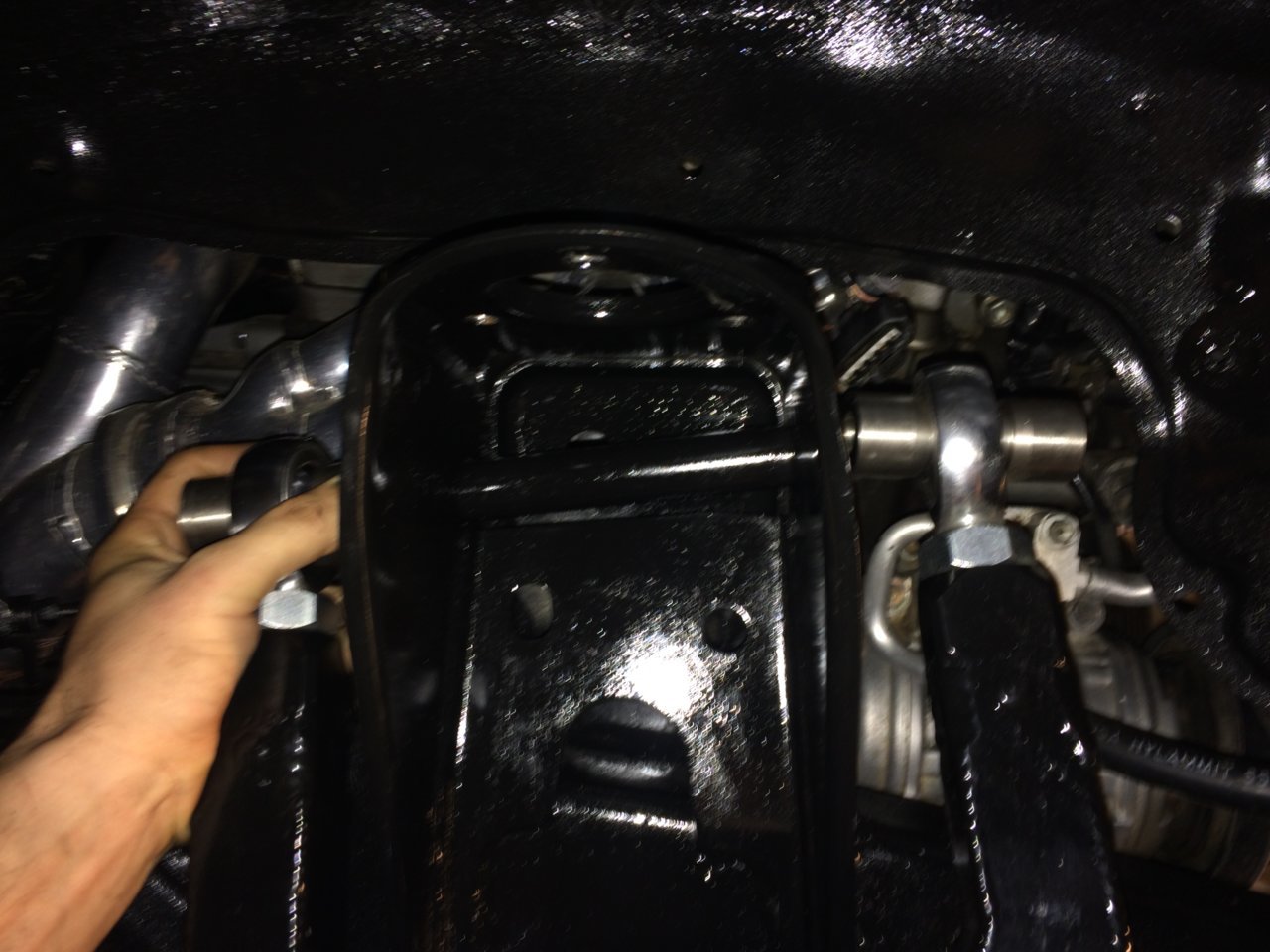

    I met up with Bobby at 7:30 Thursday night here to pick up my uca's that had to be modified as they had been part of a bad batch at the lazer cutter. They made the pocket larger to clear the spindle.
    I had already only had 4 hours of sleep in the previous 24 hours and it would be another 32 before finally sleeping some more! I didn't take many pics of the process since I was trying to get the truck on its own weight in time.

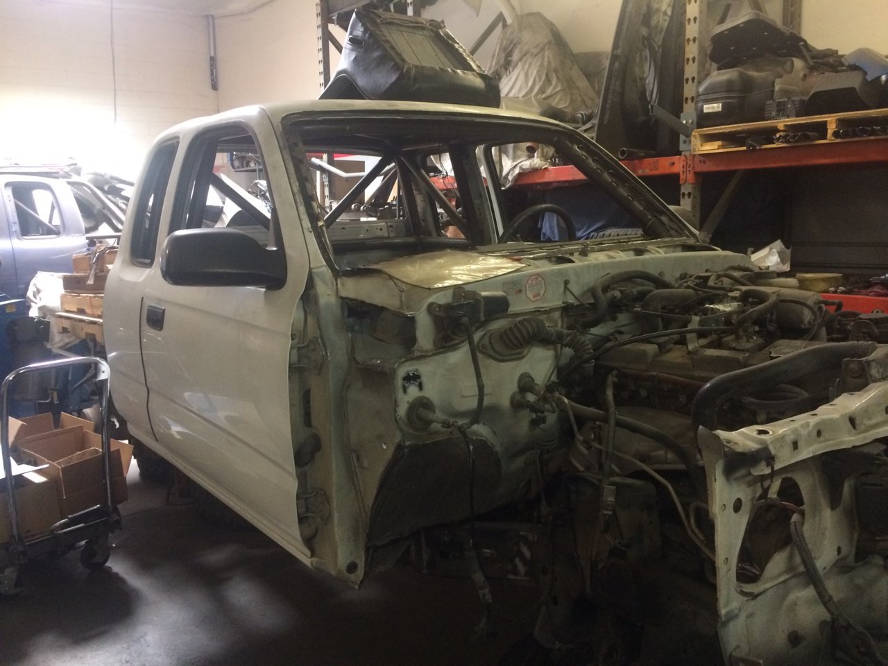

    Saw this sweet old school 4runner coming back from the shop for the final time - I was pretty stoked to have all of the parts I needed to finally install the kit. Took it as a good omen!

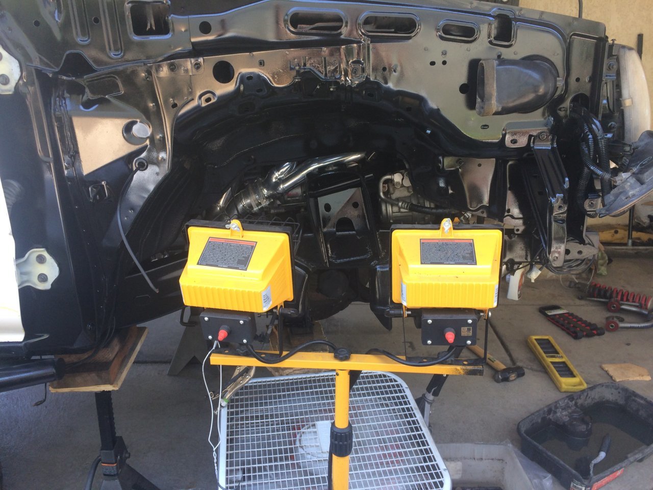

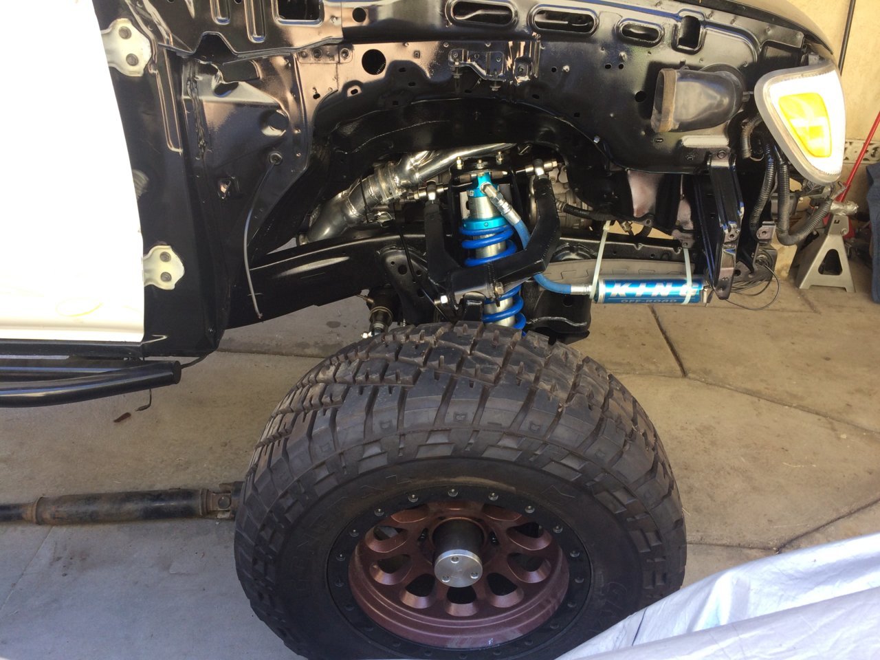

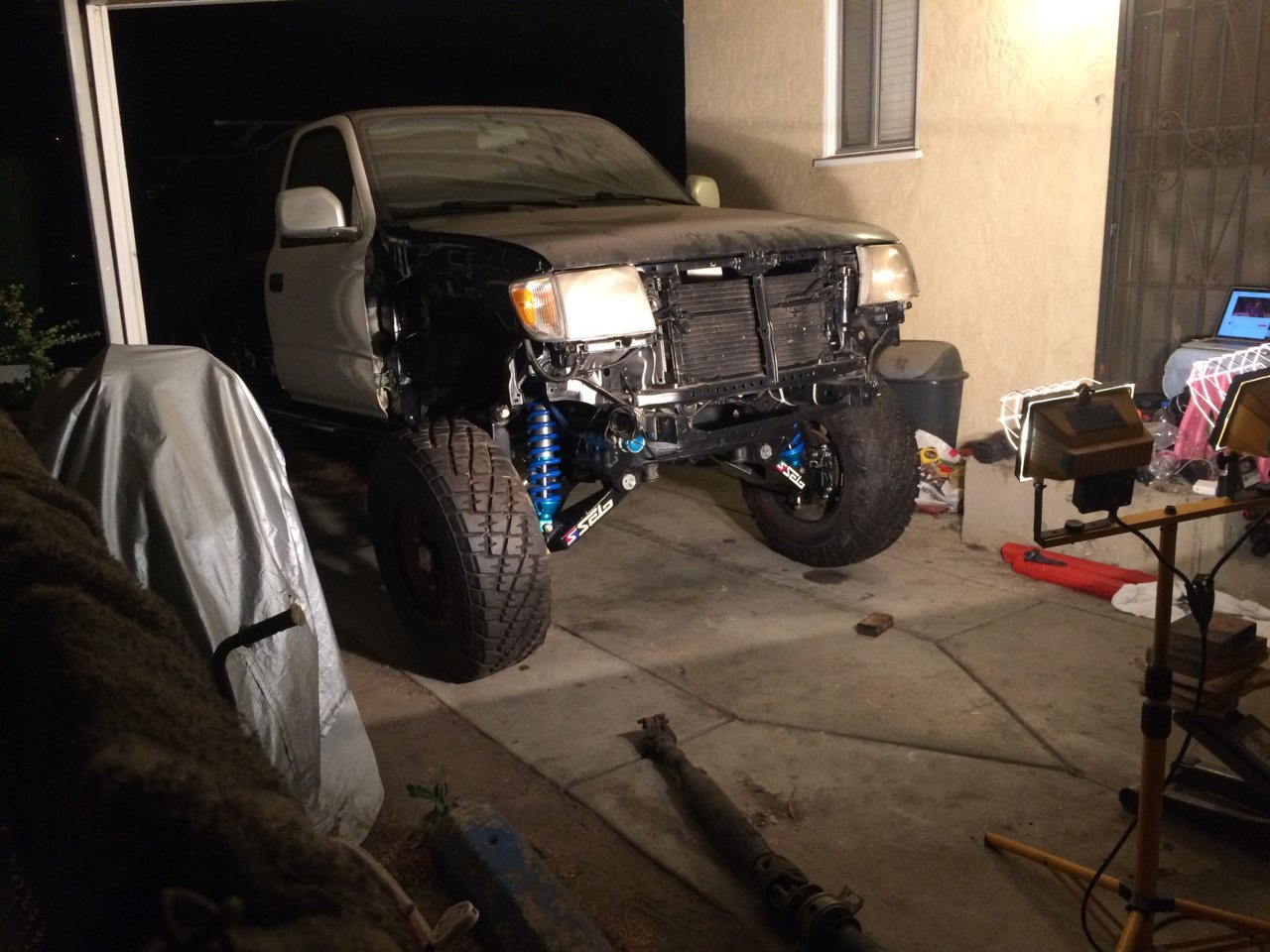

    Worked all night to get the first side installed.
    Had to modify my wrench to work in this tight space.
    I love working on these Dana 44 hubs. It feels super user friendly compared to press in Toyota stuff and I'm loving the smell of bearing grease lol. The socket I had for the spindle nuts kind of sucked. It slipped off a couple times and gouged the nut in this pic, but hopefully the burrs won't mess up the bearings - I couldn't find them when I looked for them and just chalked it up to experience. Next time I'll find a better socket and clean everything out before re-assembling them.
    Obviously the springs might be a little stiff - they're only 16's so there's actually no preload on them. I need to install my bumper, winch, and axles so hopefully they'll work - I can always get lighter ones if necessary. All in all it was a wild ride over the course of this last month working on the ol' bean.
