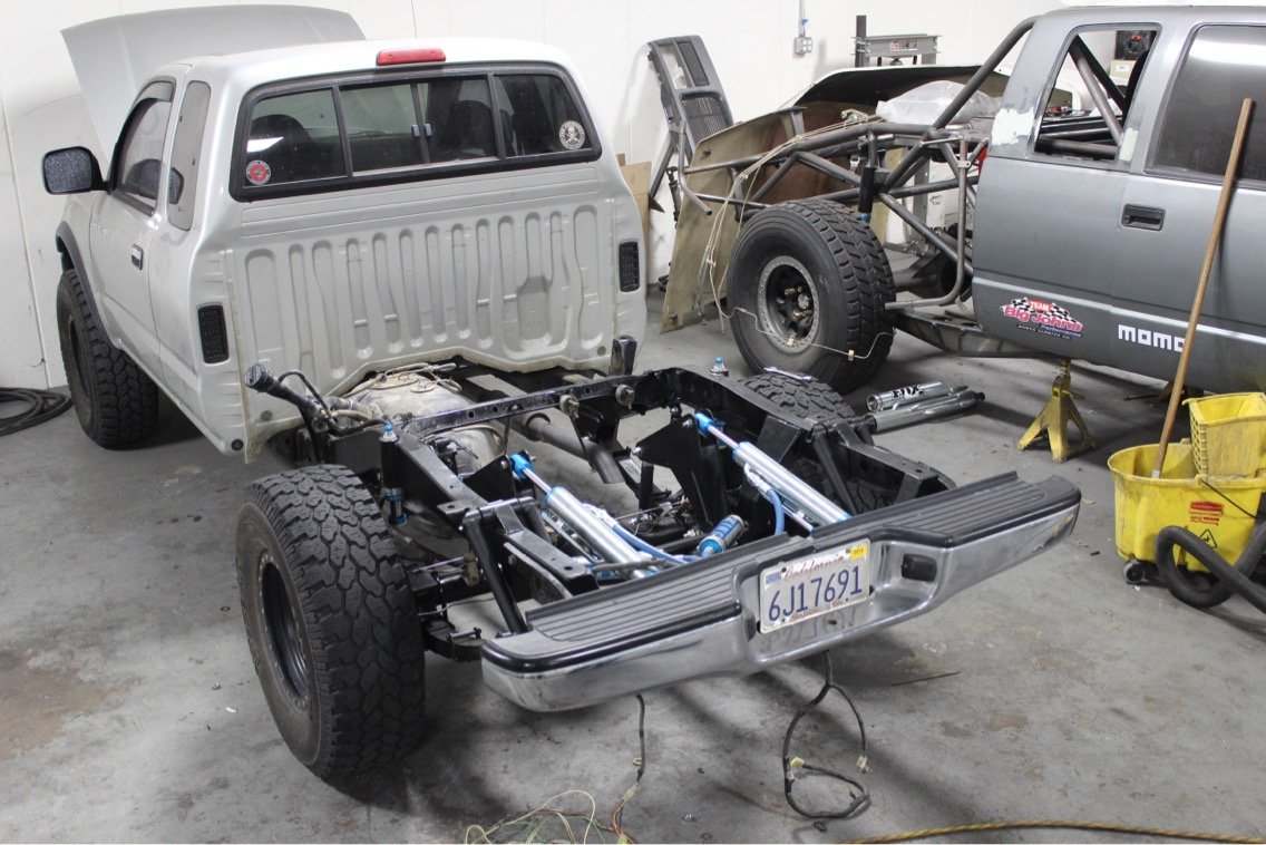

    Sometimes you get sent to the "good corner"
    Picked up a second set of bumps for a decent deal - rear bypasses are all I need to have all my shocks :)

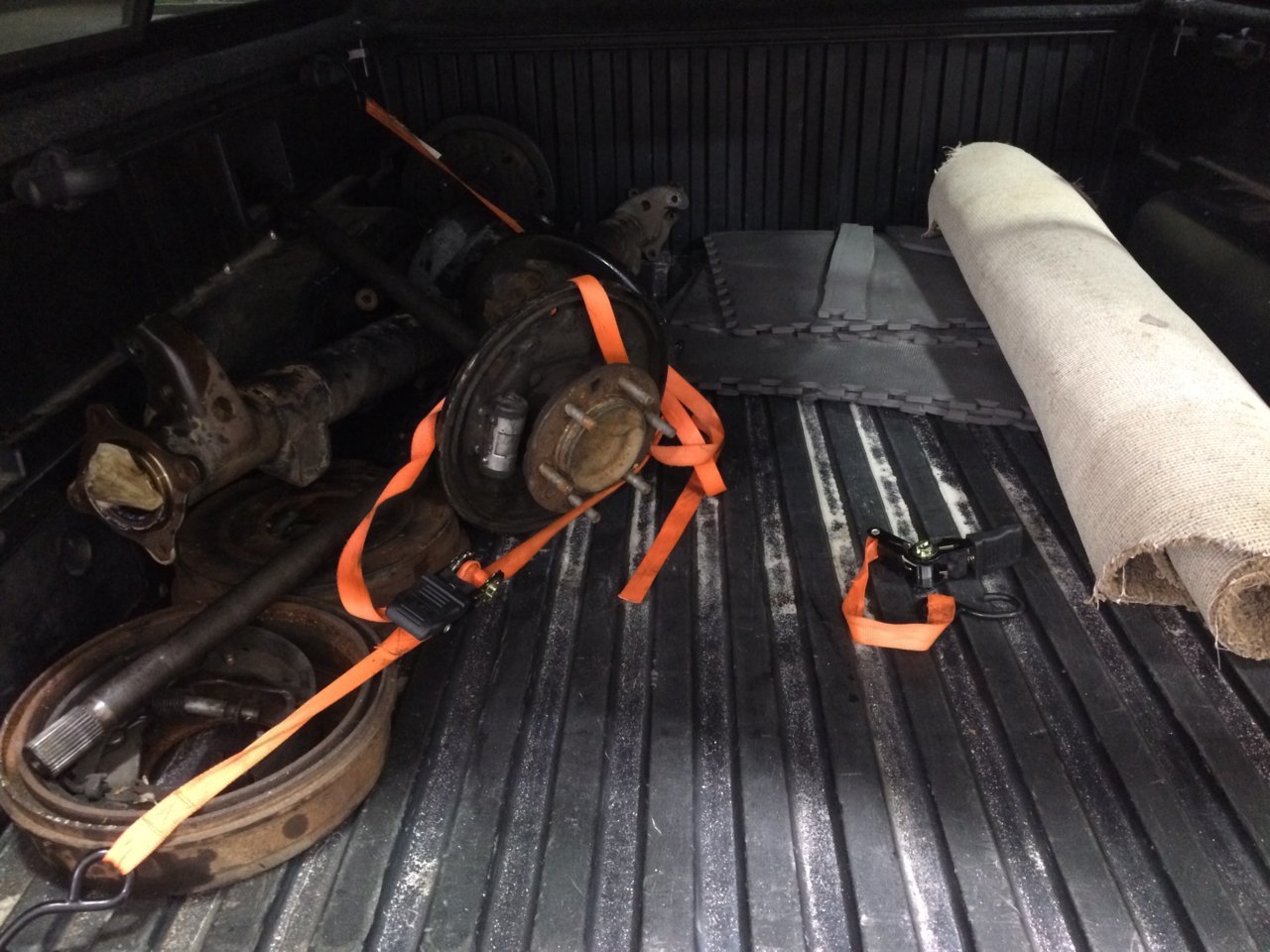

    2nd gen axle

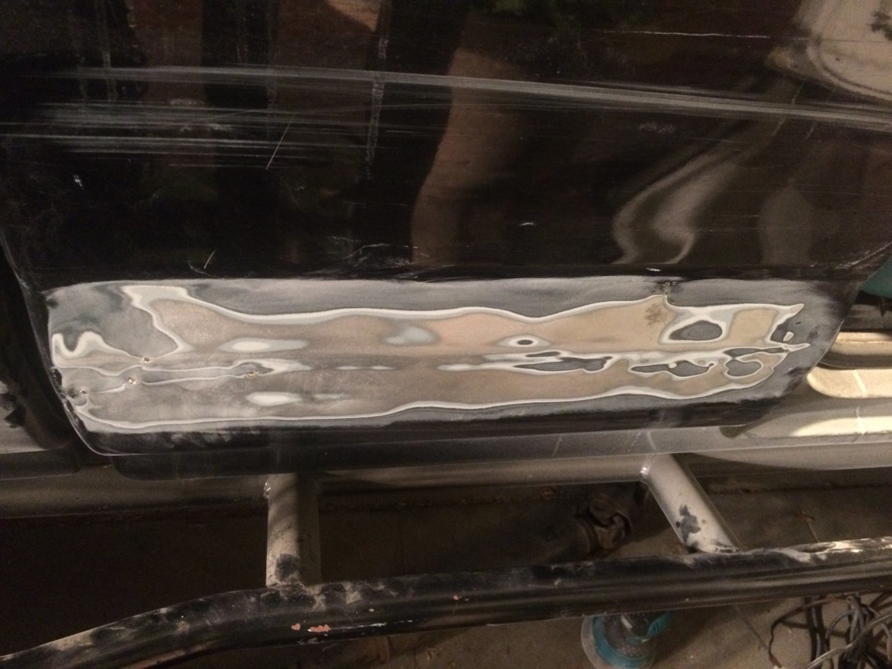

    Picked up some 12" bypasses for the cantilever LSK kit. Need some shorter rod ends and to convert them to remote reservoir. Gonna rebuild and refinish them - think I'll try Steel-It. Got a decent deal on them so it should work out for the best.
    Anthony (250) is helping me make some shock hoops. We're kind of working on it via text message and I'm getting the tubes bent by Ryan who's about half an hour away aka @Shmellmopwho so it's going at a moderate pace - basically the trick will be getting the driver's side bypass to clear the booster. Bobby (Solo) got in touch with a friend at King to see about getting a little special treatment for getting my rod ends welded since the bypasse are brand new (even though I bought them used). His friend was at SEMA so I'll hopefully hear back from him next week. That will get me about an extra inch under the booster to fit the bypasses. :thumbsup:

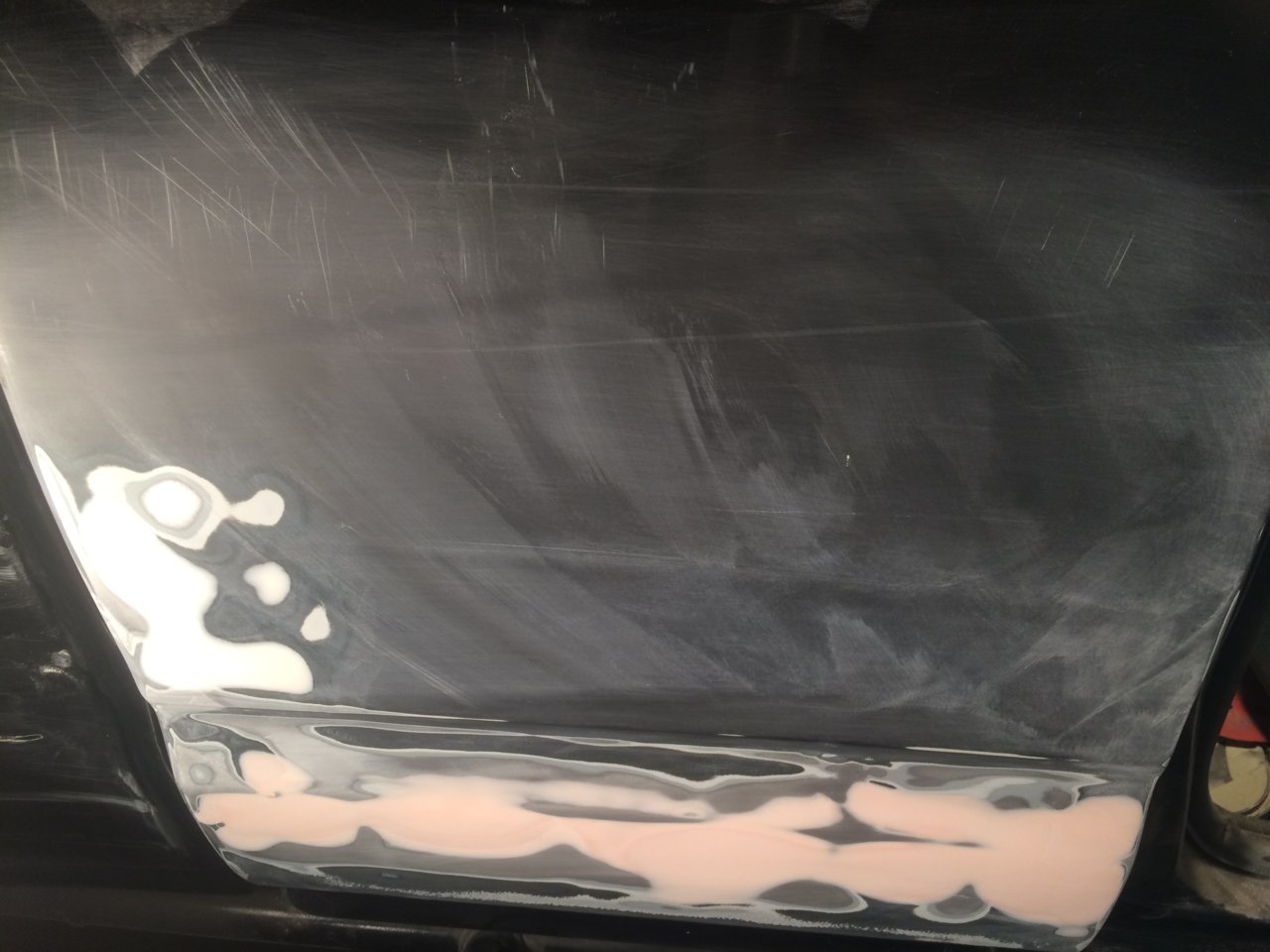

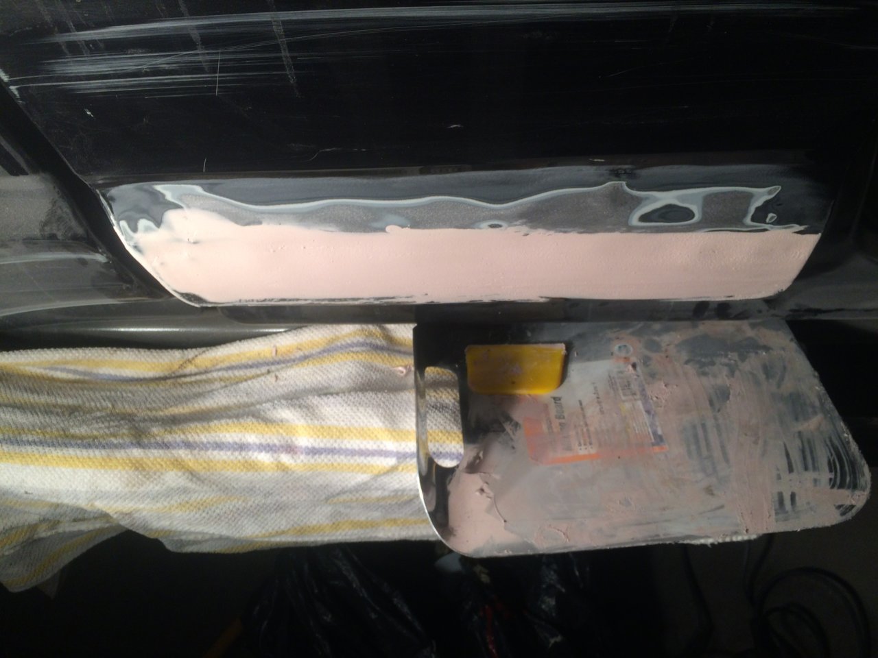

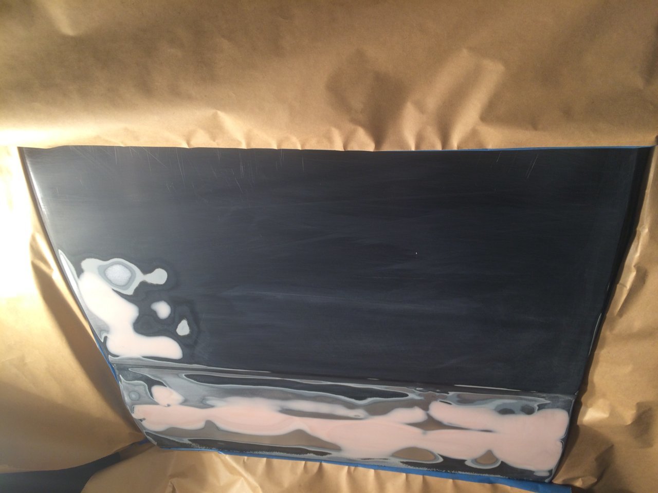

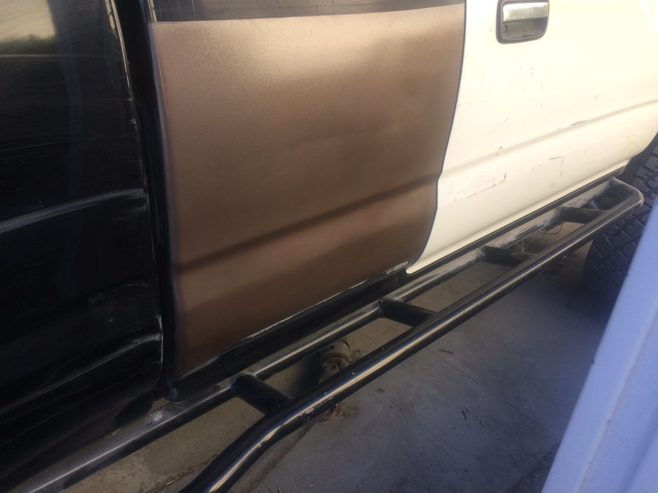

    Got some body work "finished" - little rough, but when the po dragged it across a tree it left a deep / tight dent running down the side of it right under the body line. Looks alright, maybe I'll touch it up before I give it a real paint job.
    Had to superglue my finger after slicing it on a burr when pulling the dents out with a screw in a hole. Went to the grocery store to get some baking powder to have it set quick.
    Got some bondo from a year ago - the hardener smelled spoiled - ew.

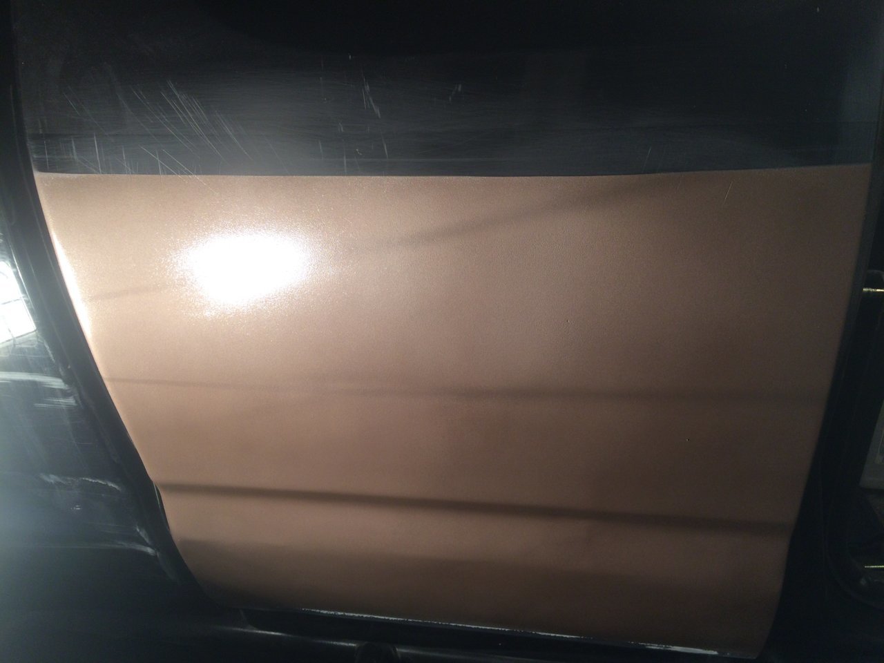

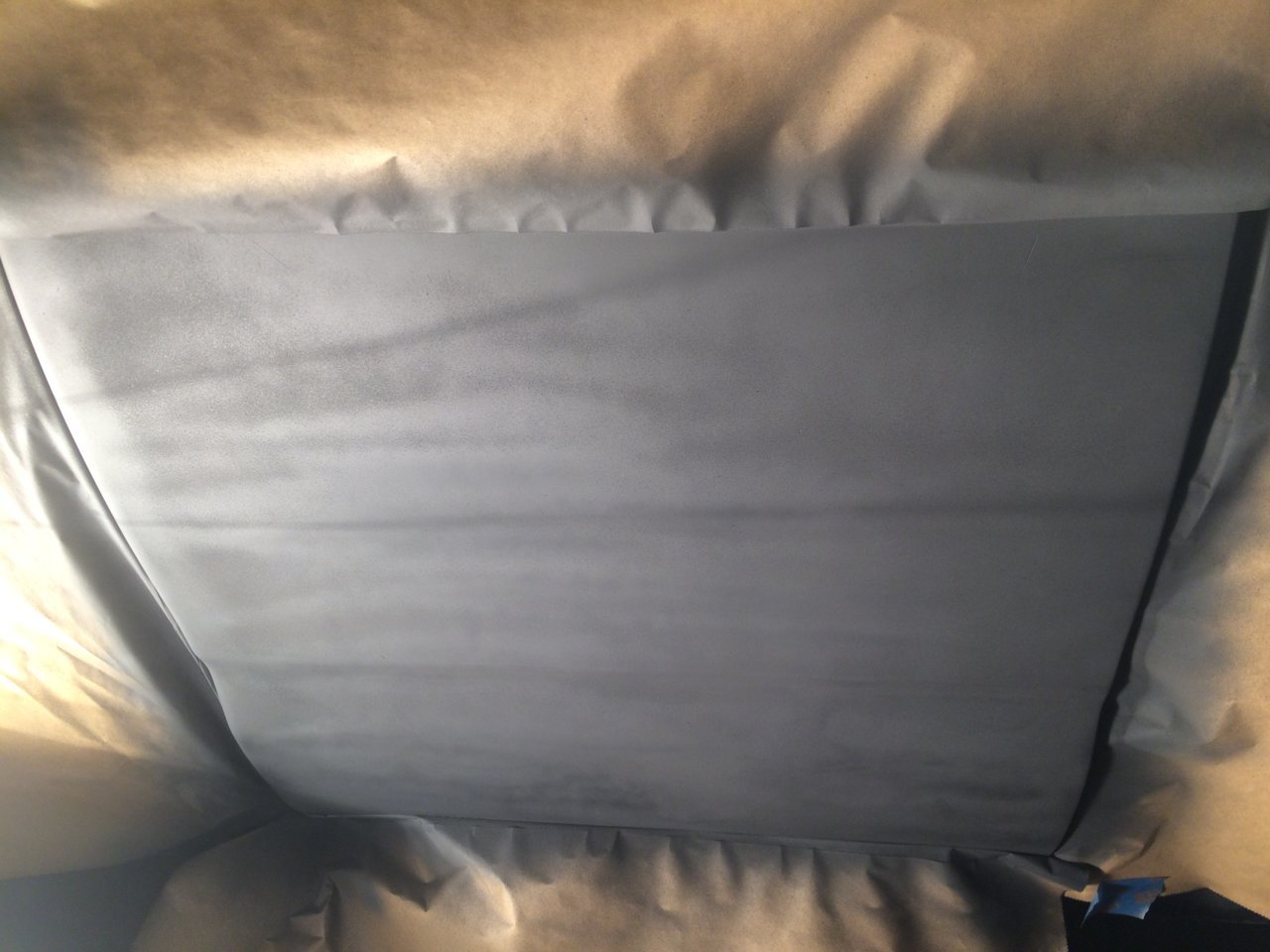

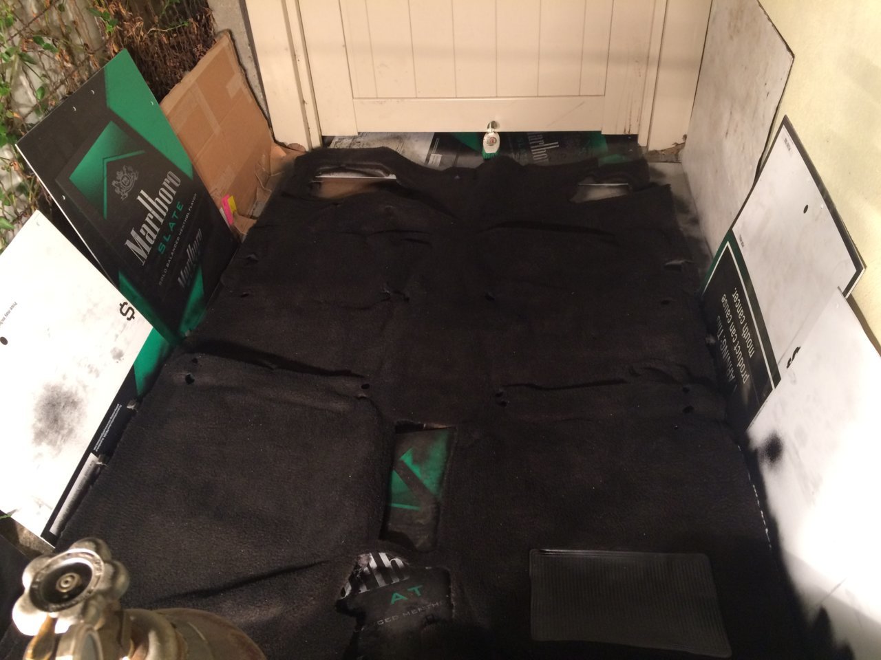

    Decided to test out some hammered tones paint from Rustoleum - possible trim color for when I paint the truck
    Daylight shot:
    Don't have a good before pic, here's one I found from another post:
    This was the last thing I wanted to get done before soundproofing the cab and putting my interior back in (a good portion of it is in my bed). Then I can sell the camper shell. Then I can remove the bed. Then... :)

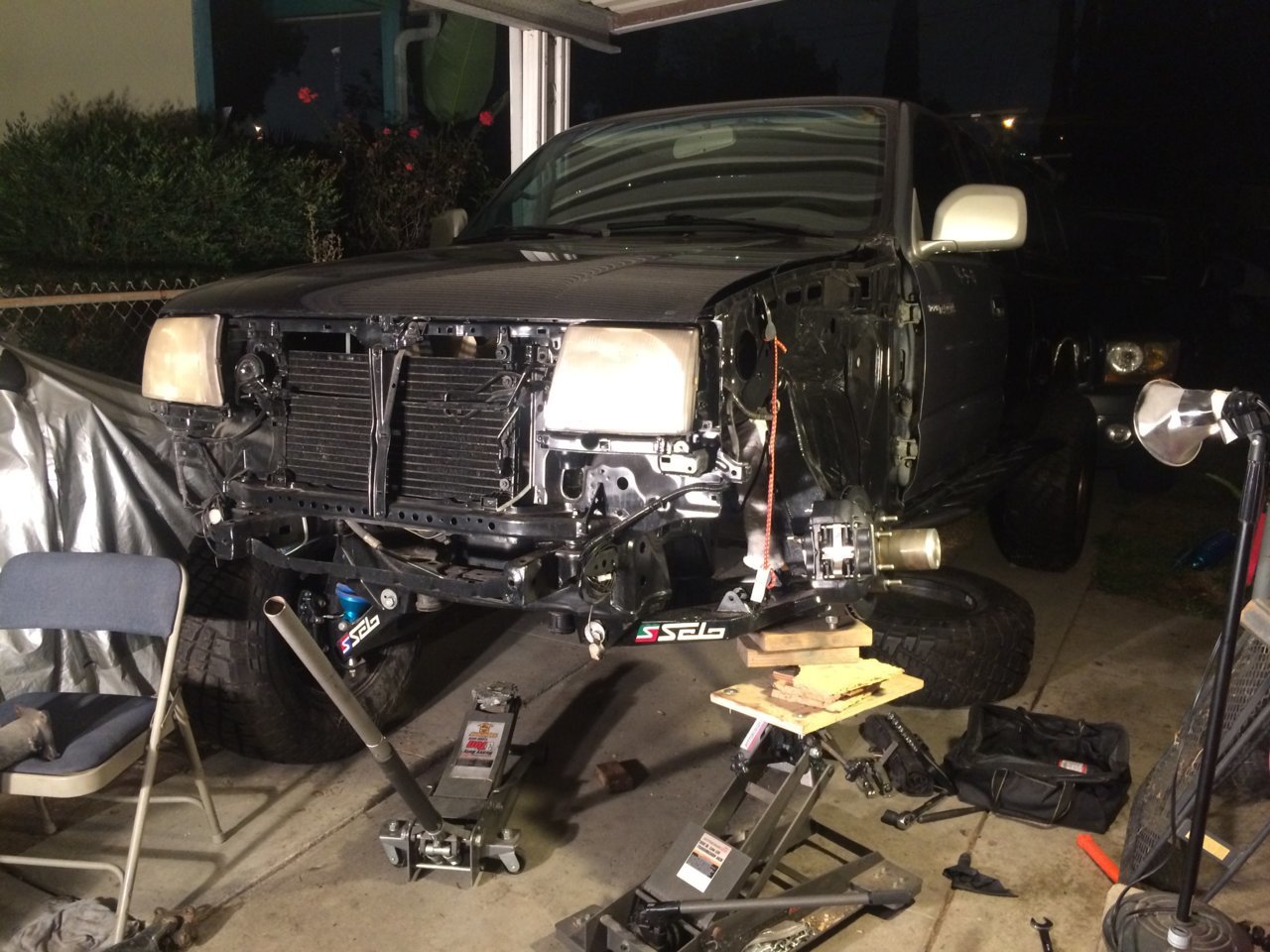

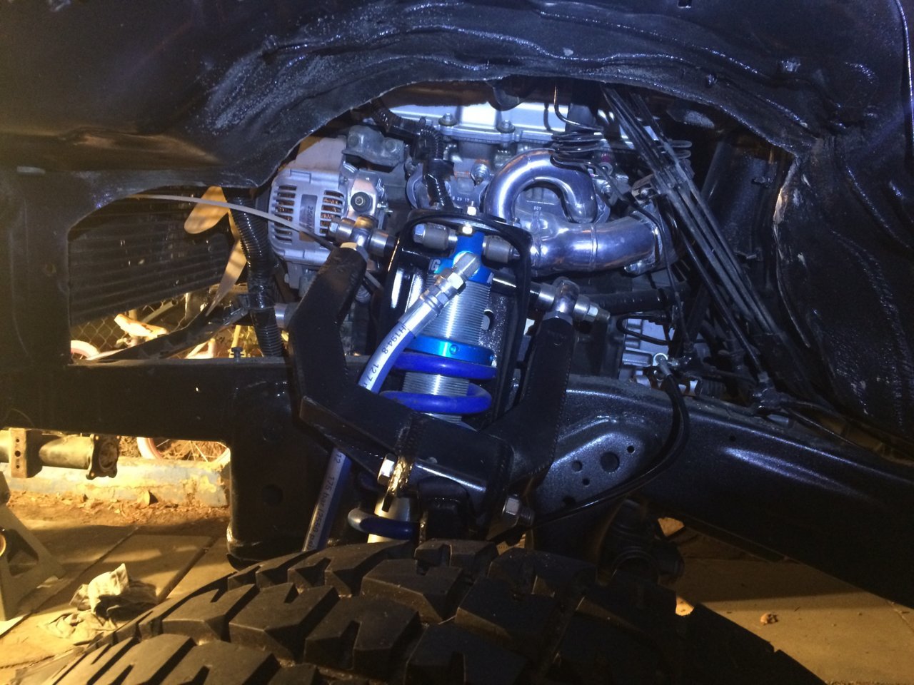

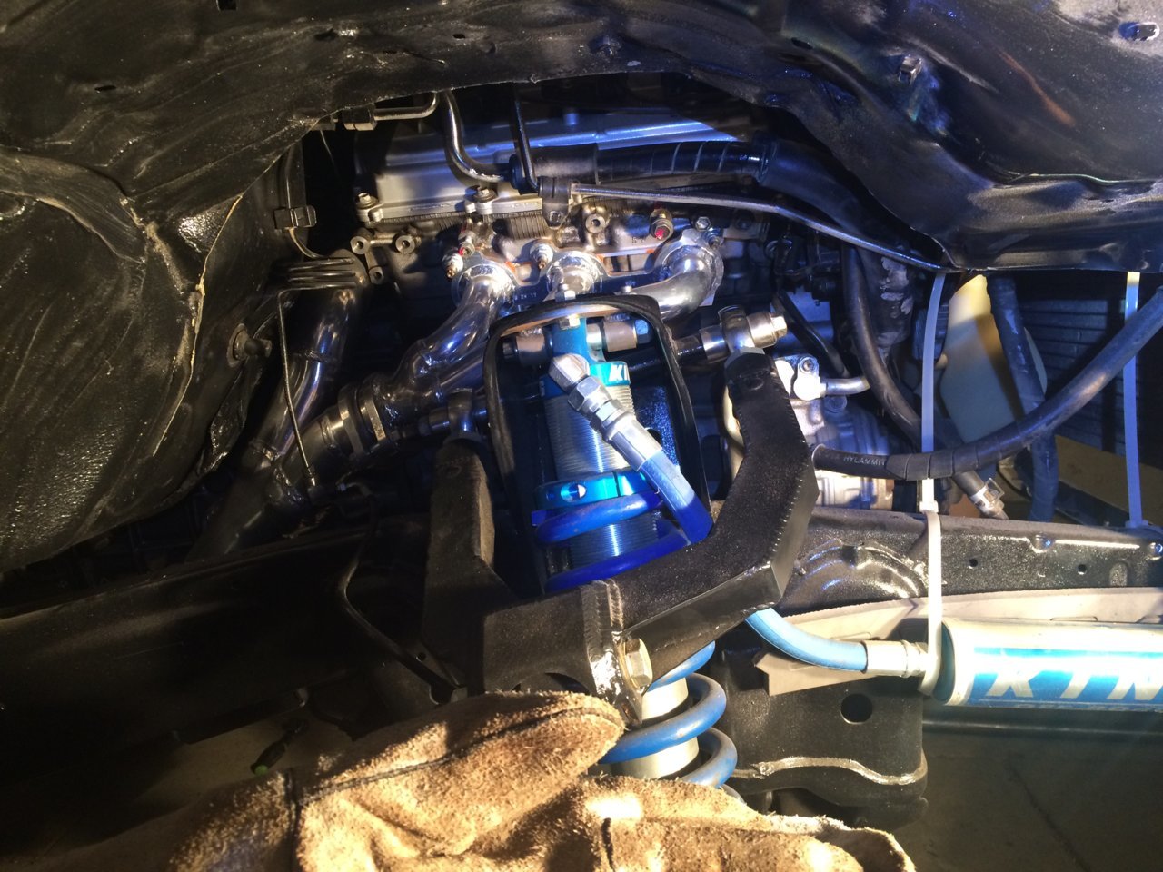

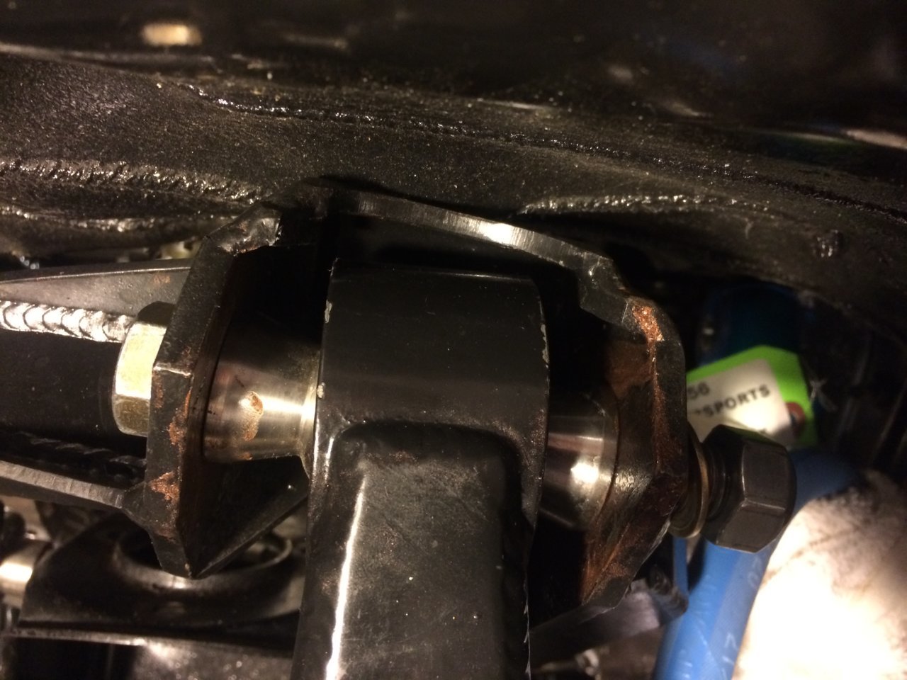

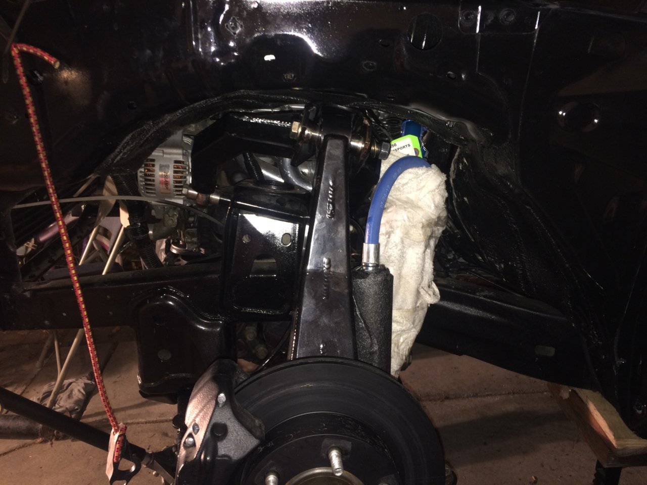

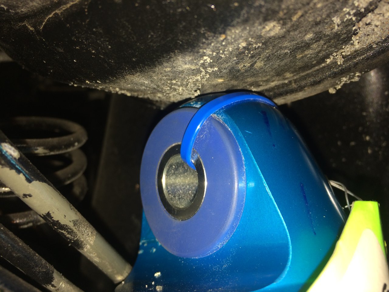

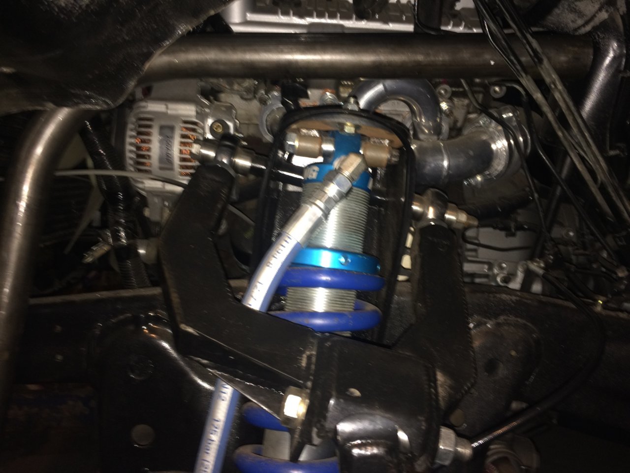

    So the limiting factors on this kit's up travel are the fender well and the brake booster getting in the way of the bypass. Getting welded rod ends will provide an extra inch of clearance for the bypass - gotta get them taken apart and brought to king.
    Didn't want my bypasses to get cold (or scratched haha)
    See where the uca hits the fender and the bypass basically hits the brake booster at the same time.
    And finally how close the bypass is to the booster at full bump - no thank you haha.
    Getting pretty quick at tearing the coilover out of this thing lol

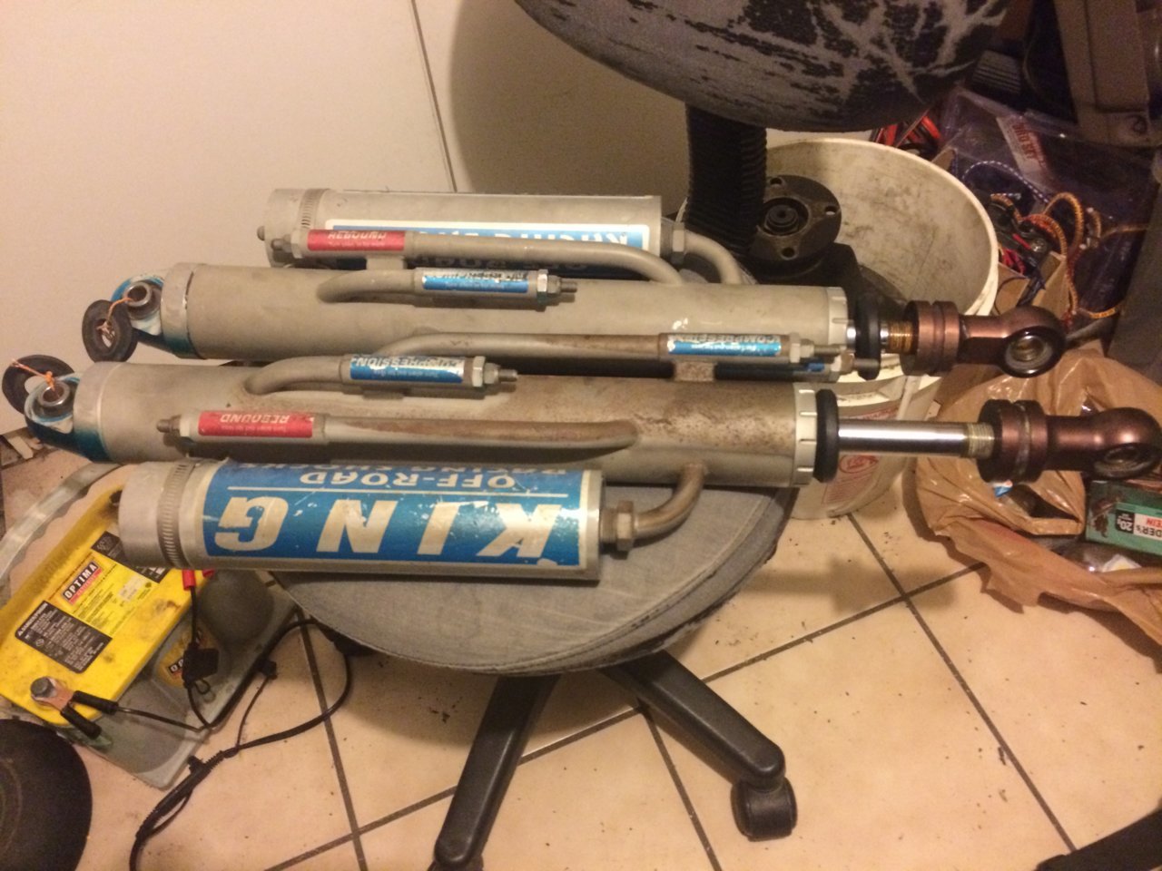

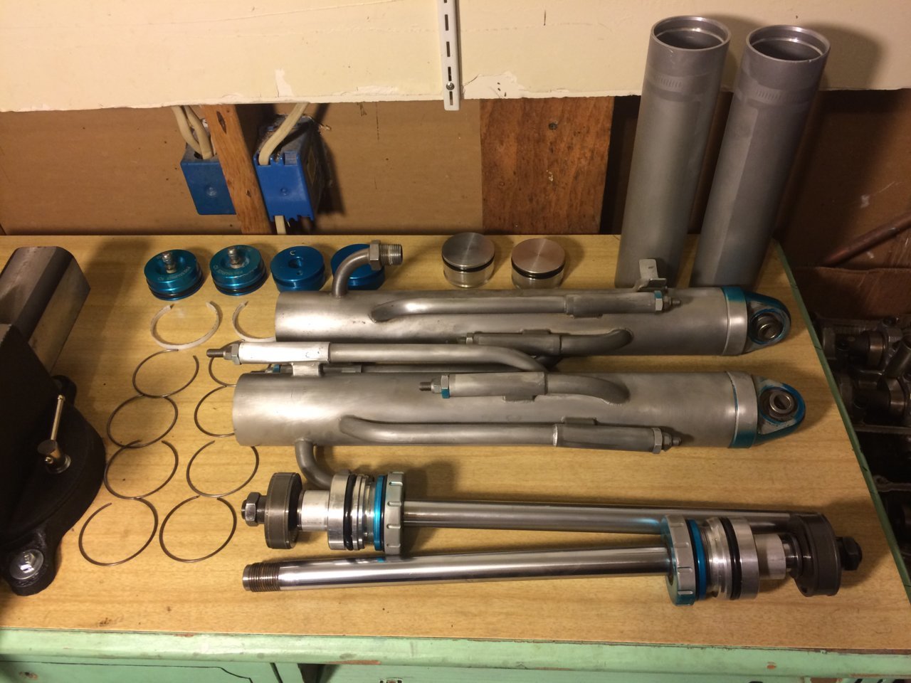

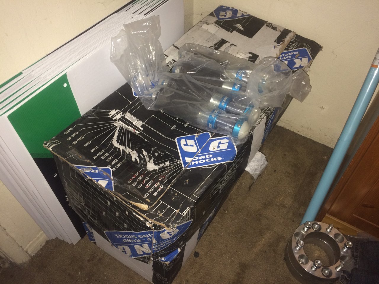

    Big thanks to Anthony - he helped me take apart my shocks to save $ and time getting them worked on by King. Went to his place and got all 4 shocks taken apart as much as needed for the fronts and totally (almost) for the rears.
    One rod end gave us a little bit of a hard time until we got the loctite nice and melted.
    Two hours later we had all tasks completed. Super glad to have the shafts ready to bring in on Friday.
    Saw this on my way from work to King
    Possible paint job option...? J/k

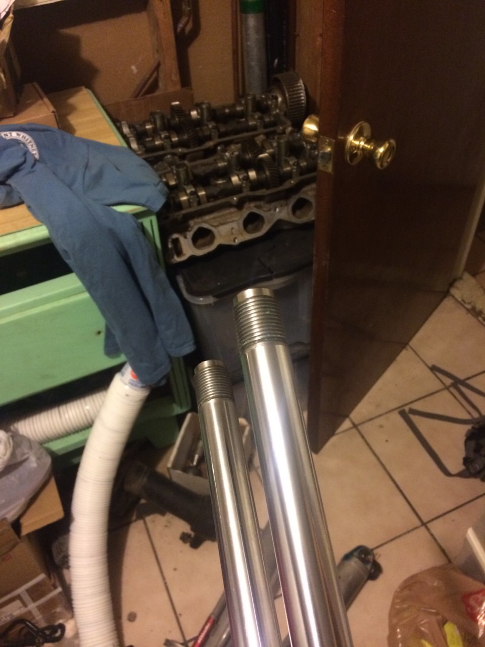

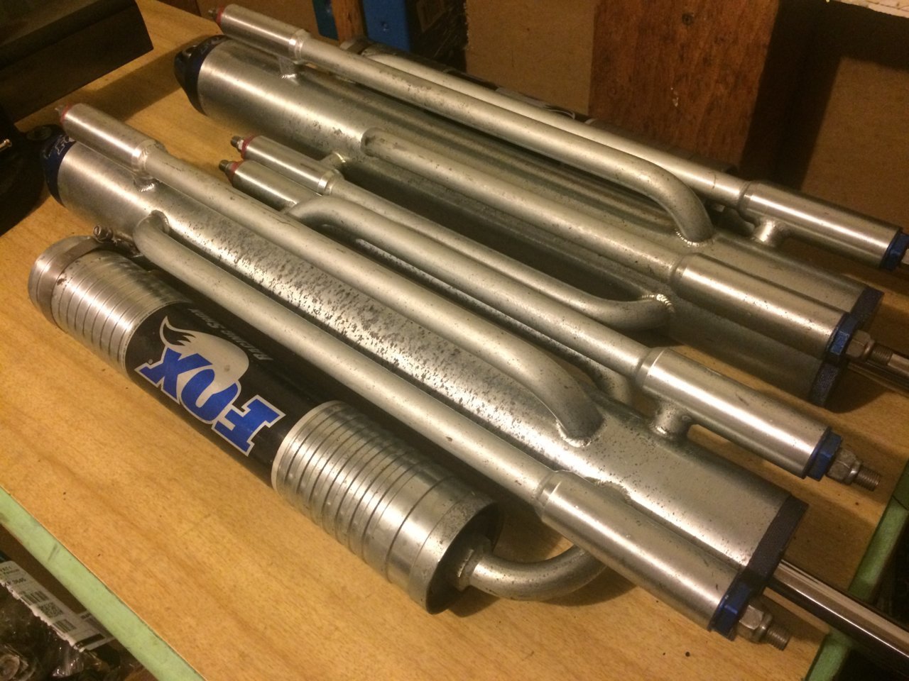

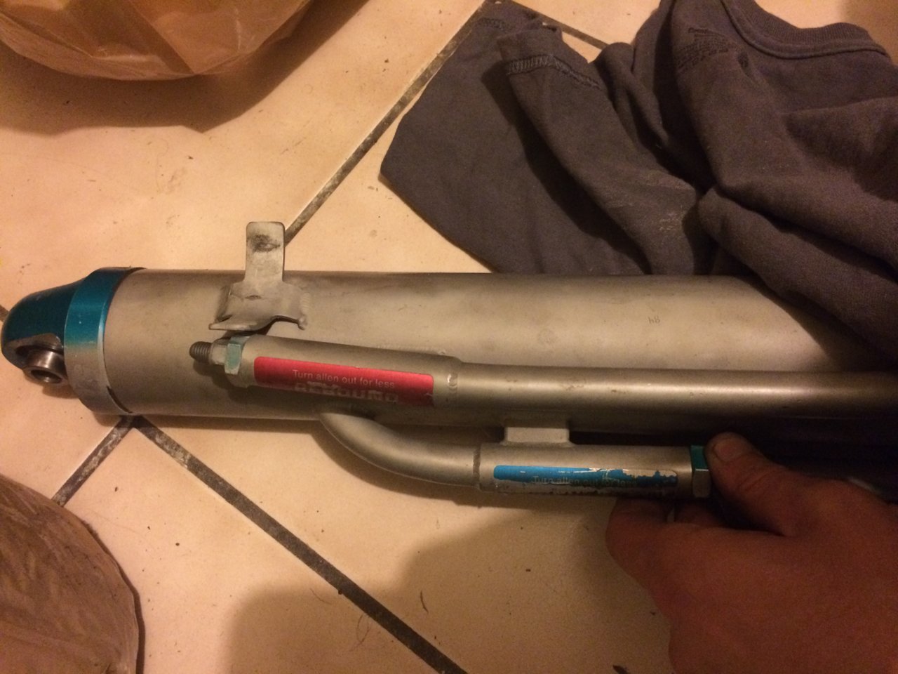

    One bypass tube on my rear shocks was bent - hammered it some with a plastic mallet. Cut off the resi mount and I'll bend it more when I figure out a better method.
    I stripped down the shock bodies and cleaned them and got everything organized for rebuilding them after I get seals, valves, hoses, and shims.
