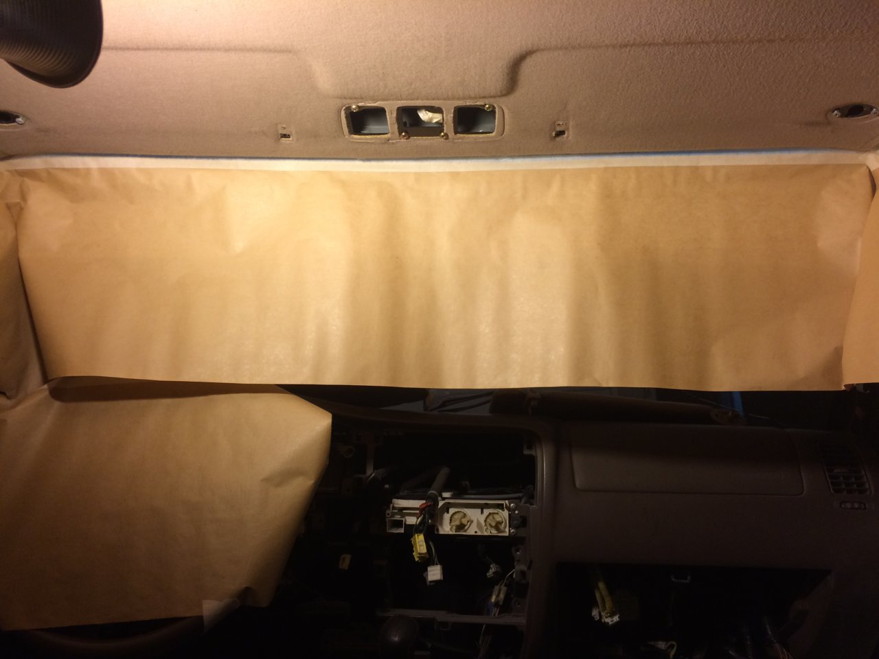

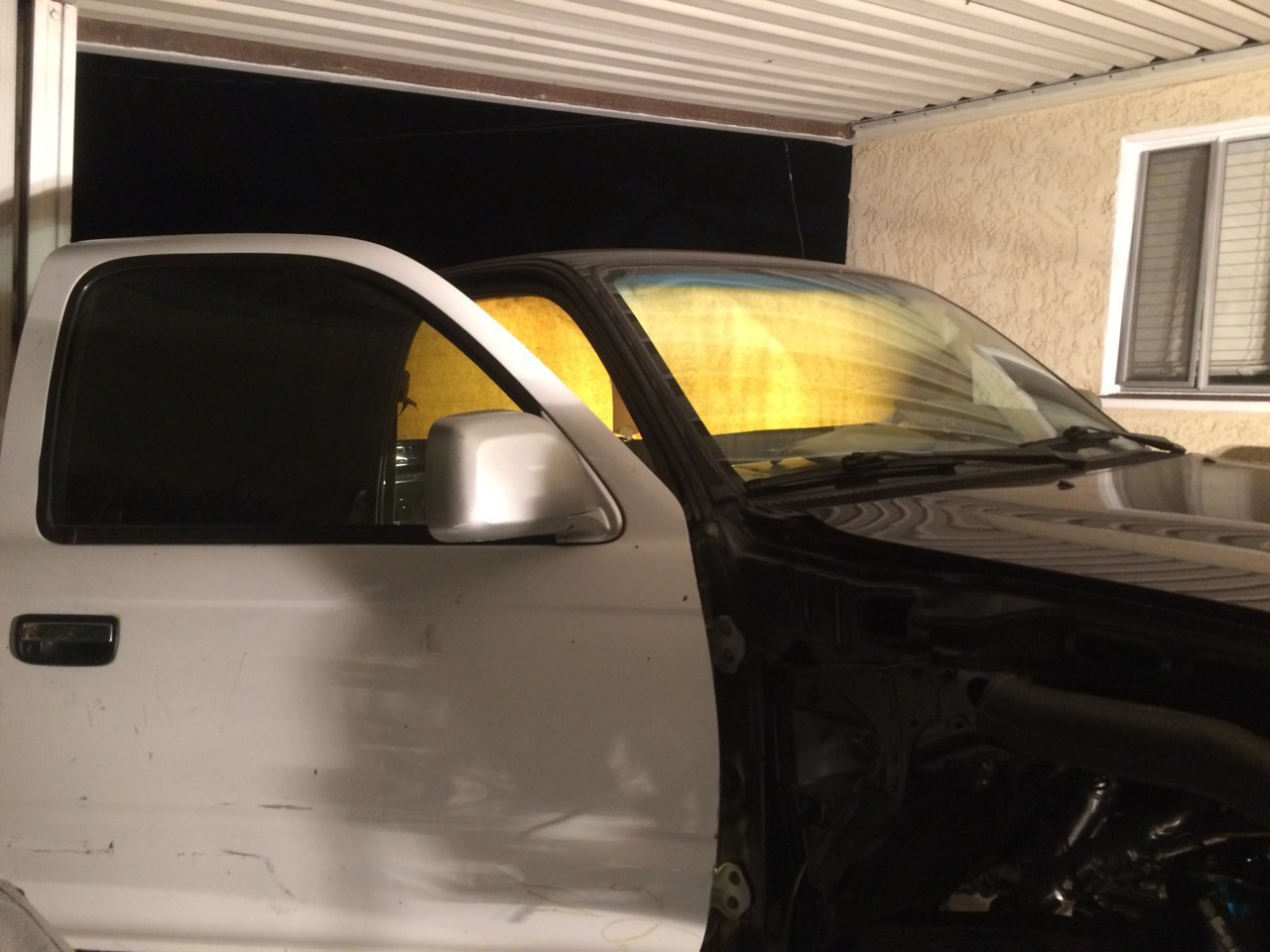

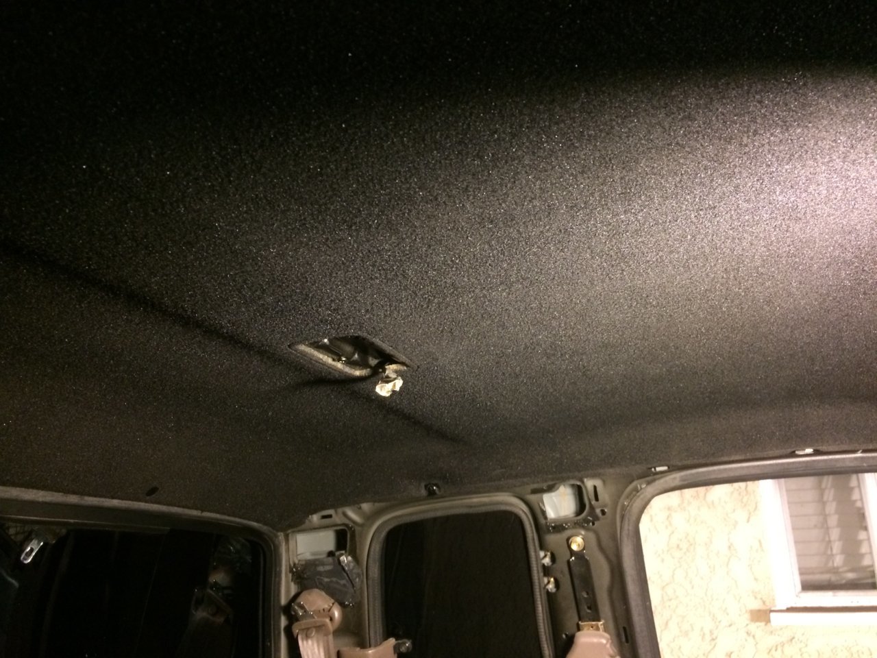

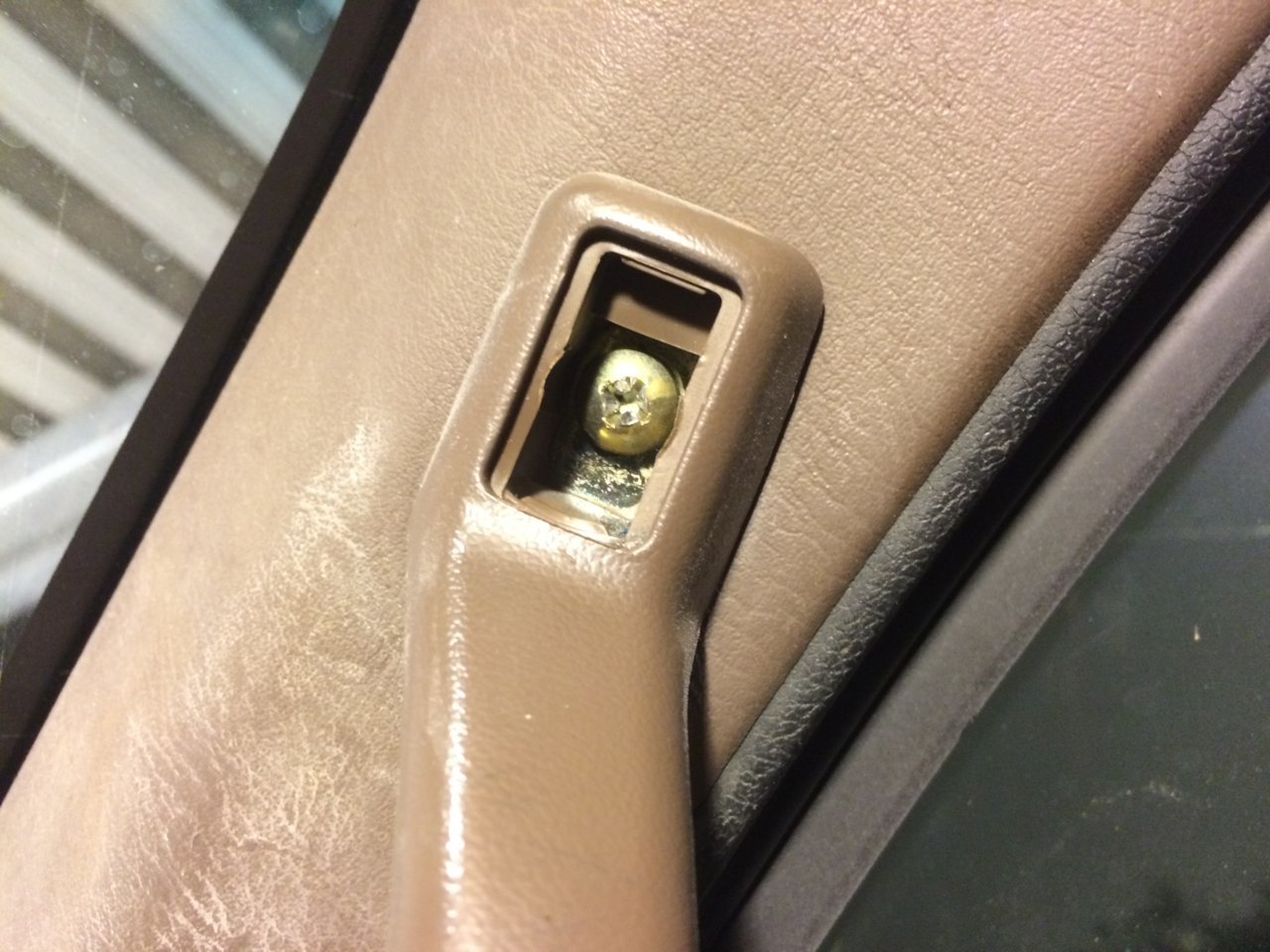

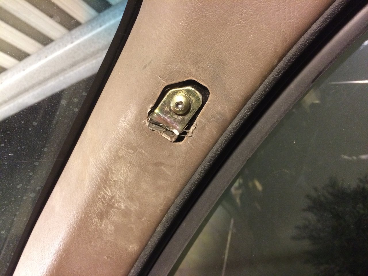

    Toyota, who said loctite and philips head machine bolts were a good idea?
    Decided to paint the headliner, but got to bust out man's best friend first (the dremel). Going to need a new grab handle...
    Shine bright like a lantern!
    Stoked.
    On to the other carpet panels.

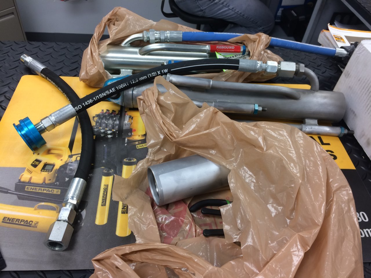

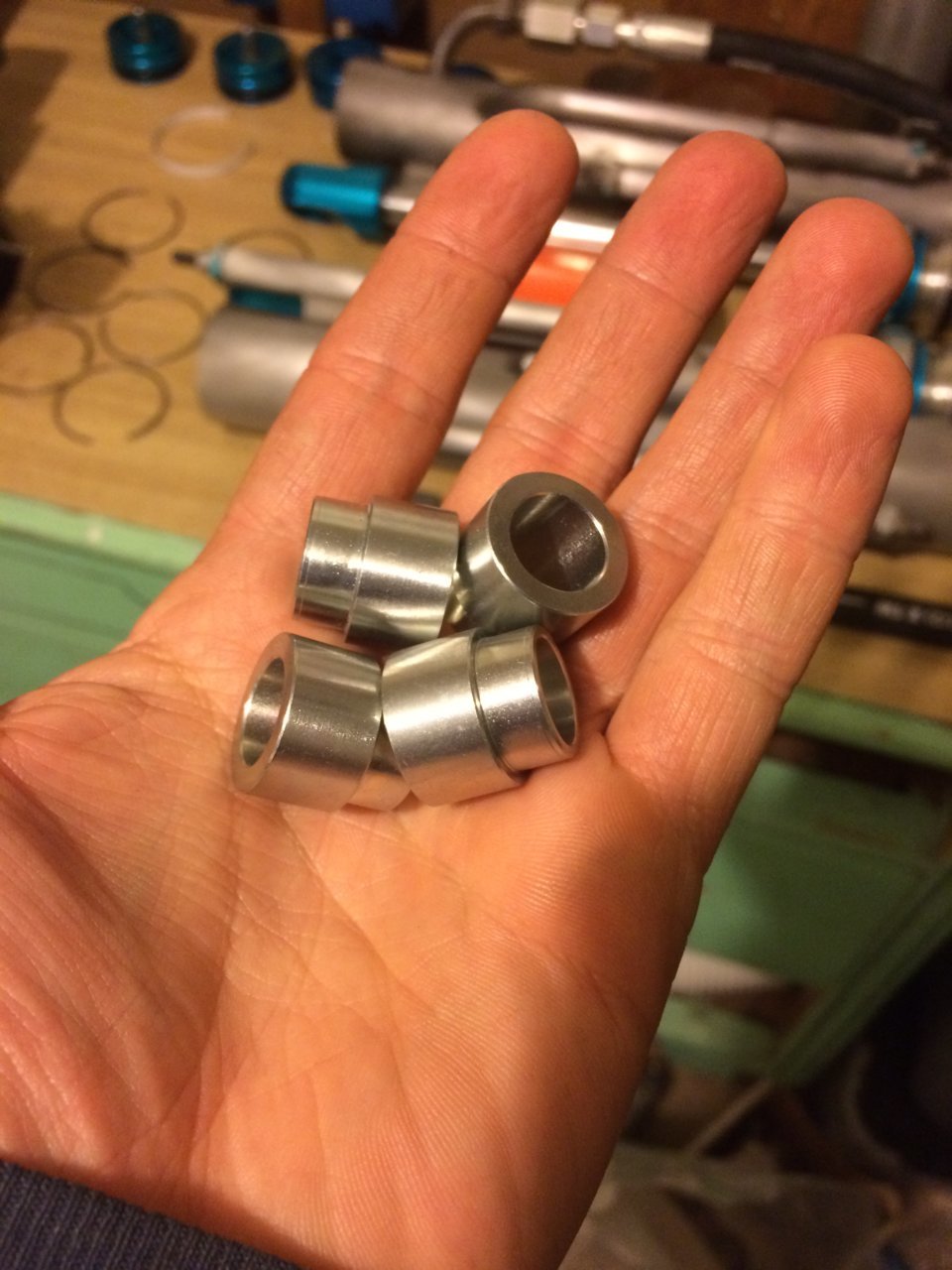

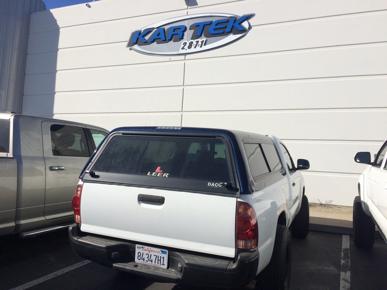

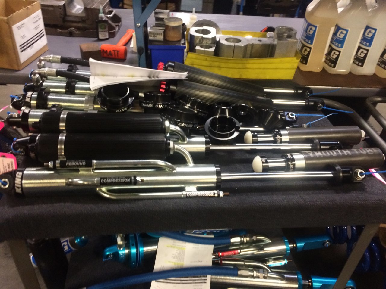

    Got some time this week to gather parts for my rear shocks. Also picked up a bunch of parts for the shock hoops up front at Kartek.
    Got new hoses made for converting the reservoirs to remote for $52 here:
    Measured the shims to find the valving is 15/12

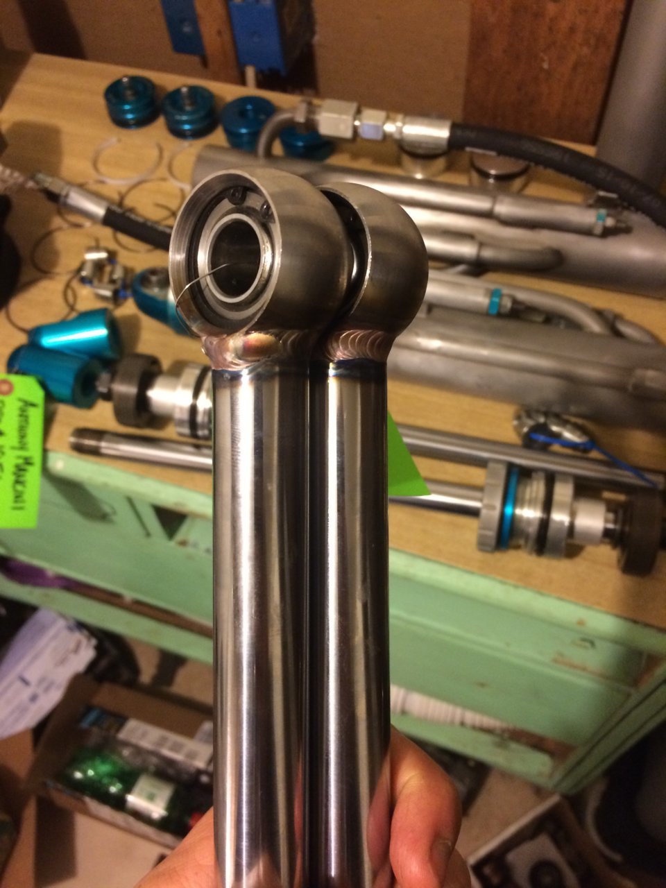

    Went over to King and picked up my shafts that were converted to welded rod ends to clear the brake booster.
    Got some other parts for my rear shocks.
    Ordered some new seals and lower uniballs, almost ready to put them back together!
    This video has been useful

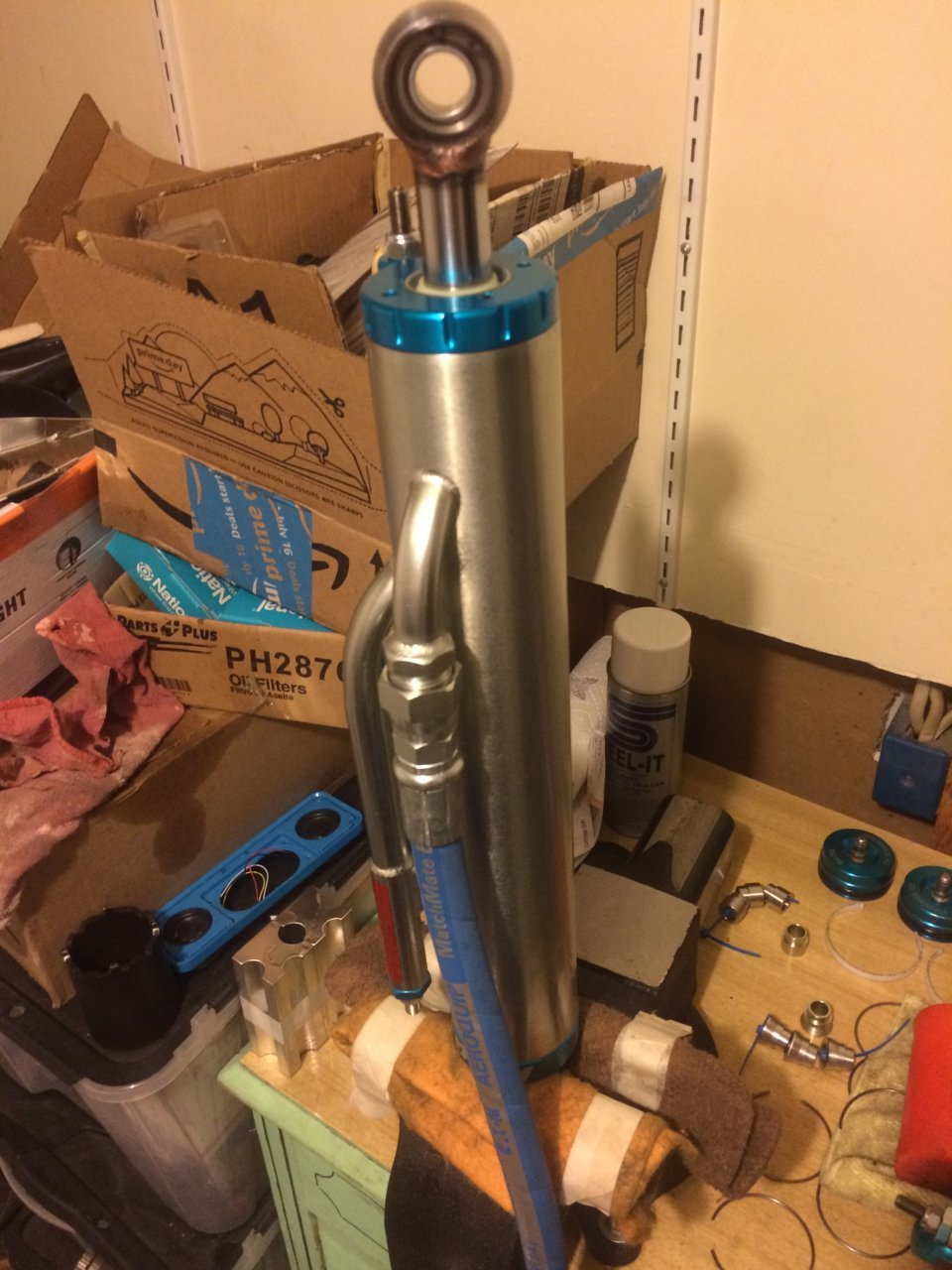

    Rebuilt my bypasses
    Gained over 1.25" (very conservative estimate) from the brake booster. Ready to start mocking up the shock towers w/ @Anthony250!

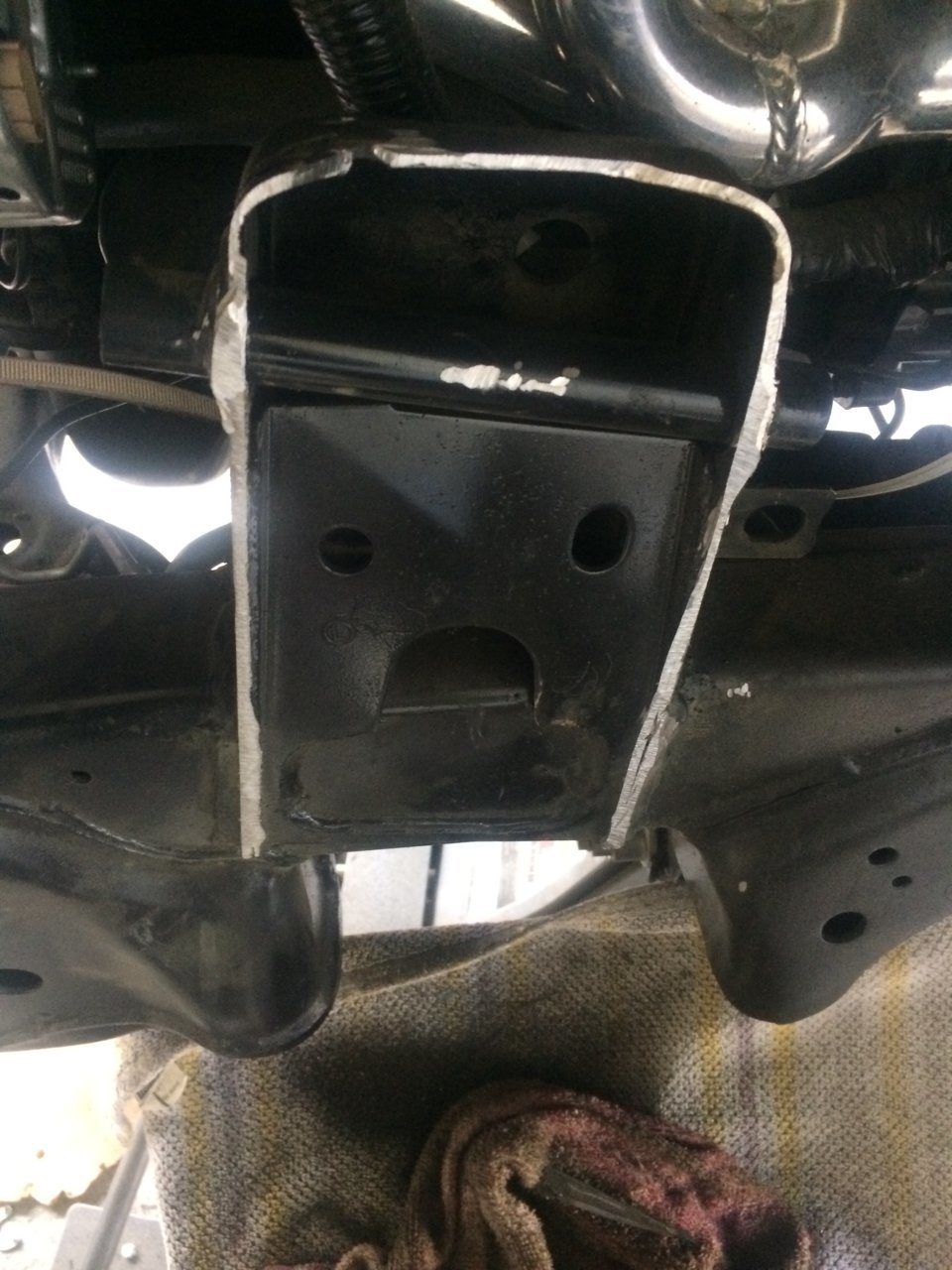

    How / where exactly did you cut your coil buckets? If you have a good photo to show how much I'd appreciate one more person's input before I do it tomorrow.

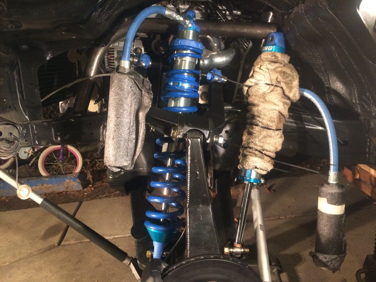

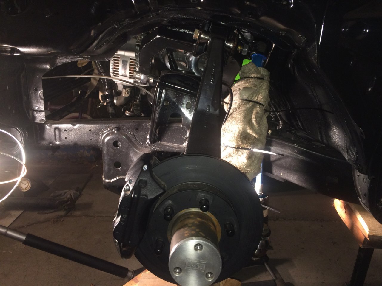

    Anthony250 and I started getting the driver's side together. He and Sean, @SanClemTaco helped me greatly today!

    Cut the part above the cross bolt off too, it’s no longer necessary
