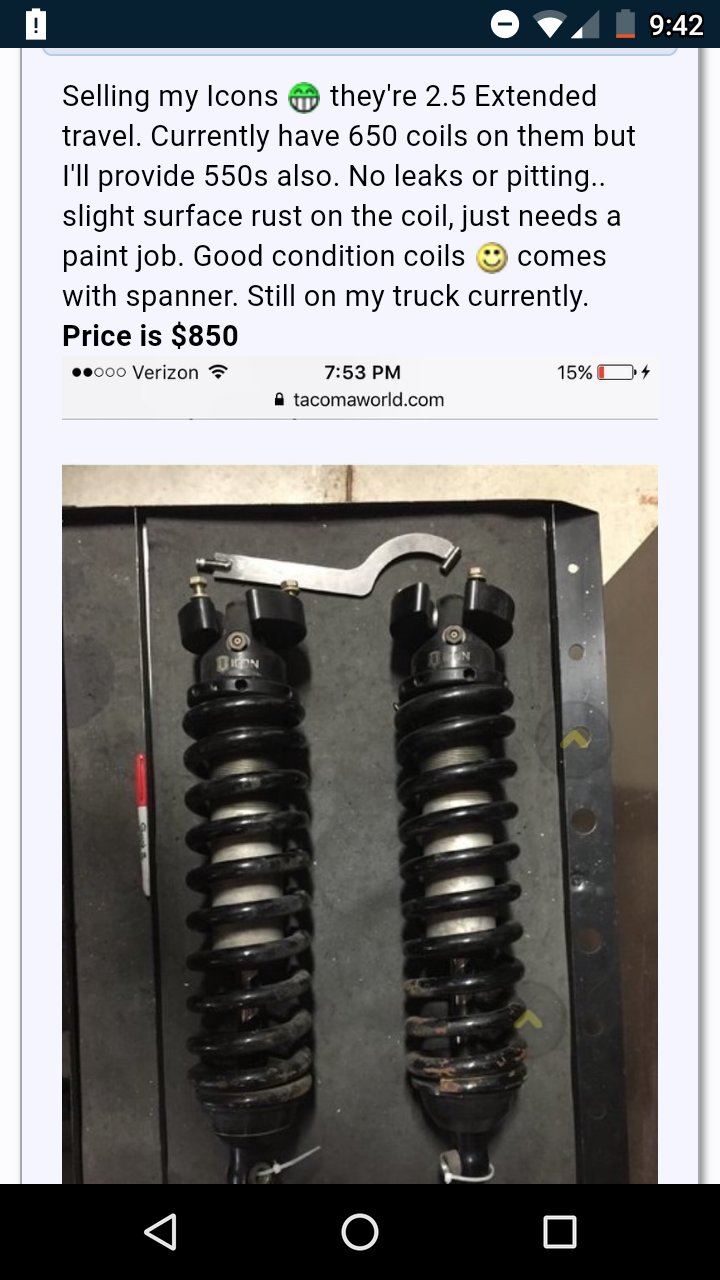

    Do you think we should preload them before installing or do it on the truck? That's the one thing I've never done before - just installed coilovers with preload already set. @Nicklovin how much lift are you looking to get? What coils do you want to use - the 550 or 650lbs?

    I would put the shorter springs on, those are the 650 lbf. ones. about 1/16" on the passenger one and about 1/4" on the driver one. that should sit about 50/50 in the travel if there isnt a heavy front bumper.

    So you're saying put on the 550lb springs at the preload you mentioned?

    the 650 ones, the shorter pair
    the longer set is 500lb, it sits below halfway about 40/60

    My bad I only saw the ones on it. The pic Nick posted says that the 650lb springs are already on it though? I don't think that was the actual pic at the time of sale since it said they were still on the truck when the ad was made. :notsure:

    couldnt say. that pic is from when i sold them awhile ago and they had the softer springs installed, i thought the tool cart looked familiar and its a cropped pic of what i sent to the guy i sold them to.

    lol I see. Yeah I was just going off of what was written. What did the 550lb springs ride like - did you test them out against the 650 lb springs?

    They're already set at 3 inches of lift, to be honest I was thinking of lowering them a bit to lower the center of gravity slightly. All my friends want me to keep at 3 inches of lift, they love the bro lean.... beach people hahaha. Oh hey I forget to mention with everything going on, Itaro volunteered to help me out install everything over at his place on the 19th next month. So I won't have to bother you with that:p, worked out too since I could get the day off from work to have the whole day to install.

    The 650s are on them right now, planning on keeping those on since they'll help me keep the truck under control better at speed. Better for my madman style off roading hahaha
