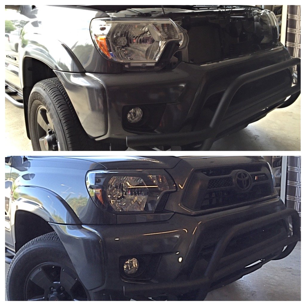

    I just need to color match the chrome grill surround piece now.

    I did this on my old Frontier - will definitely do it on my new Taco. Try setting the light on a baking sheet and wet (not dripping) towel while in the oven, its a little less flammable than cardboard :)

    What's the differance between the SR lights and BHLM lights?

    The black chrome is lighter and is actually made out of plastic and is an entire OEM light housing where as the BHLM is actually stock all chrome headlights taken apart and painted with spray paint and put back together :)
