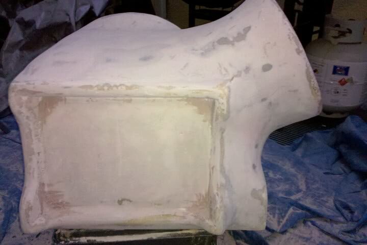

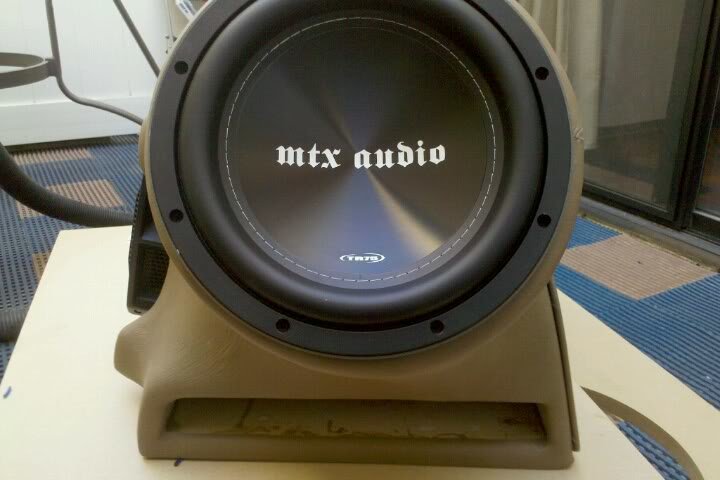

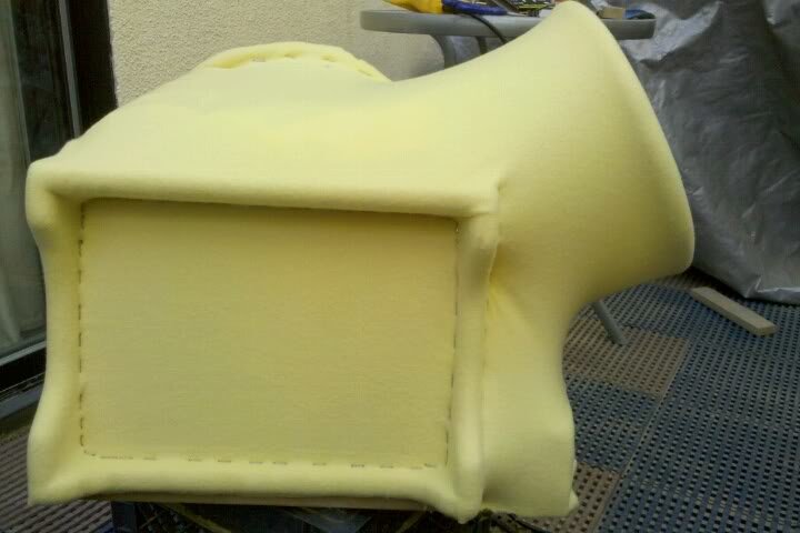

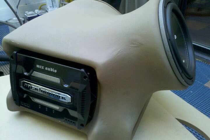

    I just finished this box for a friend of mine. It took for ever and to top it all off he wanted it wrapped in vinal.
    Check it out
    I started with a MDF sub frame
    Next wrapped in Fleece
    Glassed
    Bondoed i didn't take a pic when I was completely done with the Bondo.
    I think it turned out pretty good except for the bubbles where the Vinal stretched
    It's L slot tune ported at 38 Hertz
