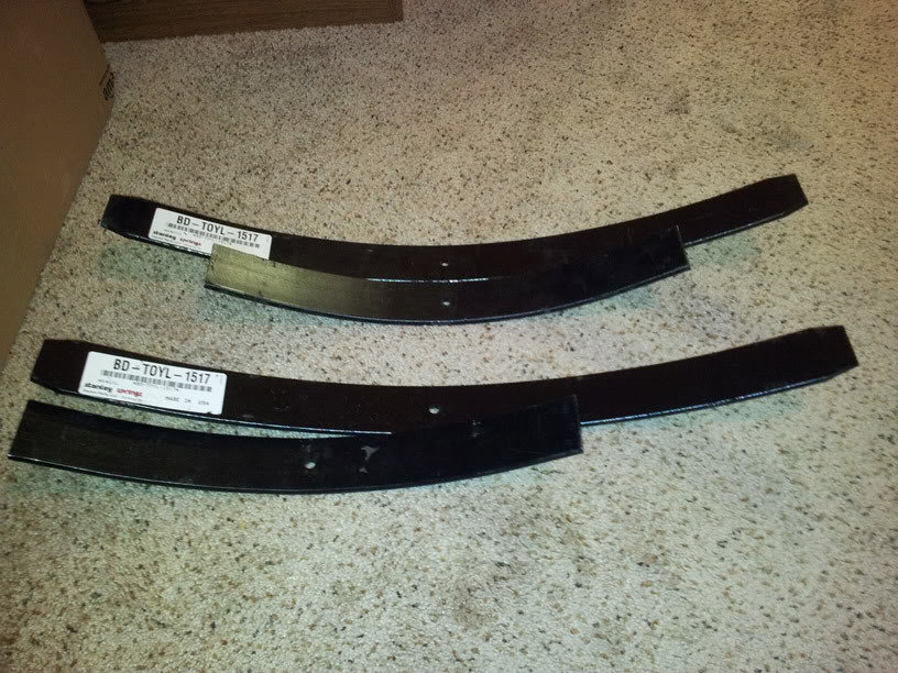

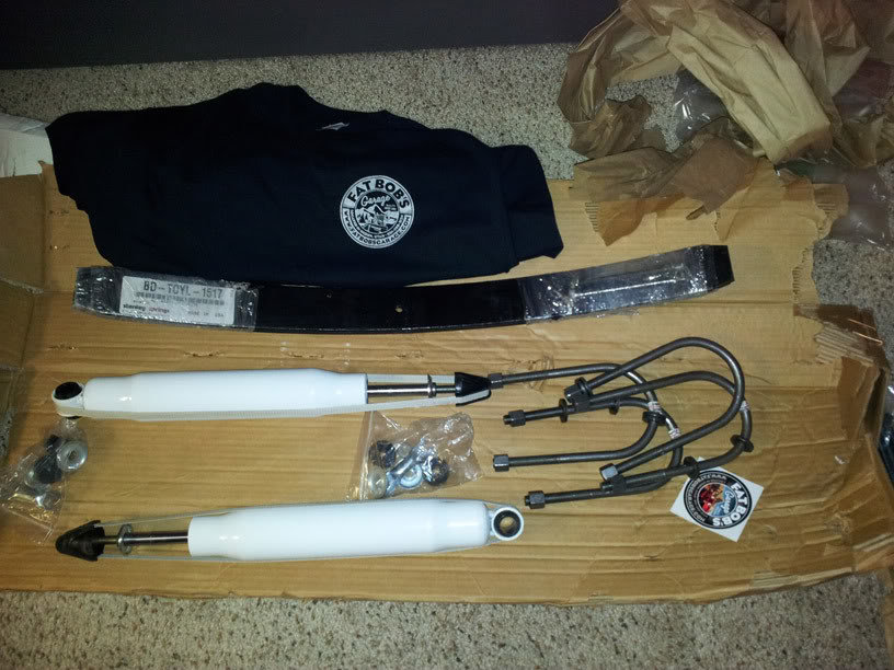

    The order mixup has been resolved. Thanks goes out to Josh at FatBob's. Along with the missing parts, I also paid the extra money to get the longer AAL's. I'll be shipping the shorter ones that I originally received back to FatBob's.
    My plan is to install everything over this 3-day weekend. I'll have some pics for you guys when it's complete. Wish me luck :D
    The missing parts....
    Here you can see the size difference between the long AAL's and the short AAL's. The long leafs are about 30" and the short leafs are about 20"

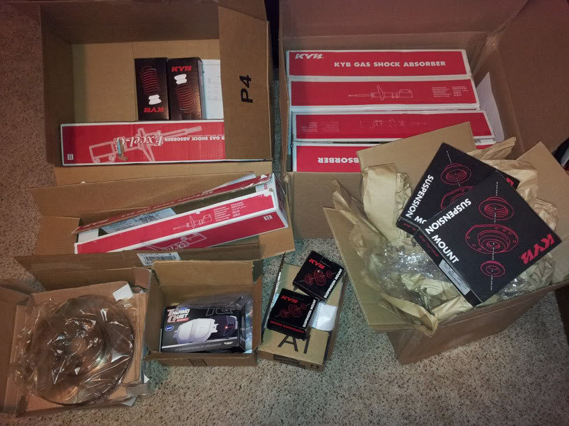

    On a slightly different note, my wife's car had a bad front and rear strut (so I'll be replacing them all) and needed new front brakes. I'm hoping to have enough time to tackle that this weekend as well. Our automotive budget for this year is stretched thin. As you can see from all the boxes below, I've been keeping the UPS guy busy lol. Free 2-day shipping with Amazon Prime is awesome.

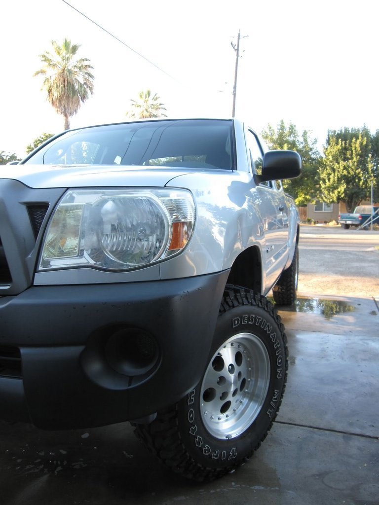

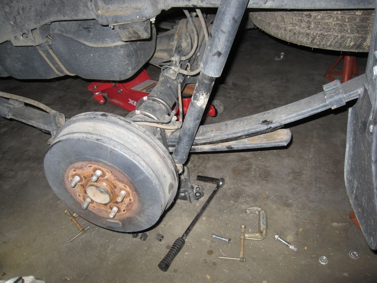

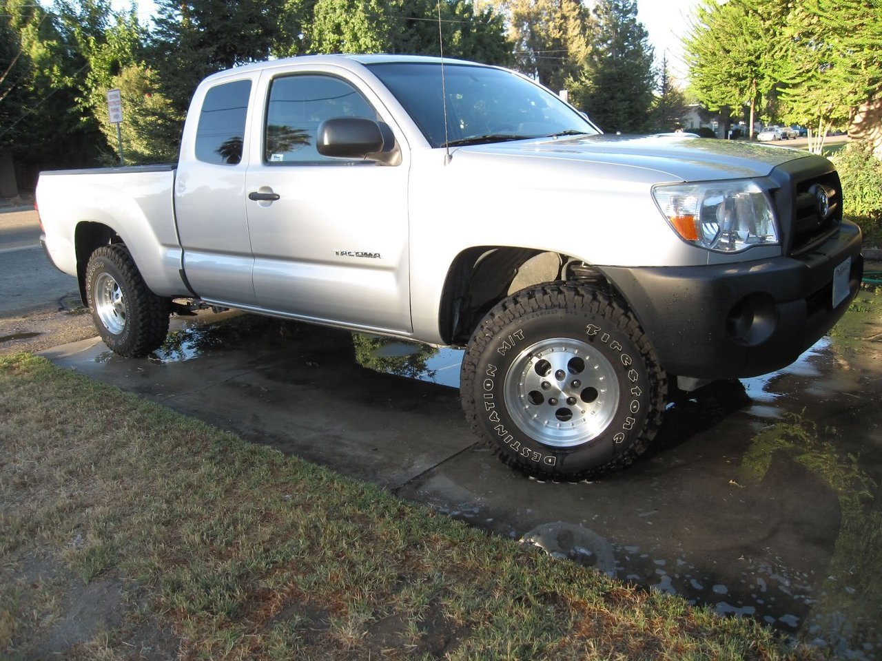

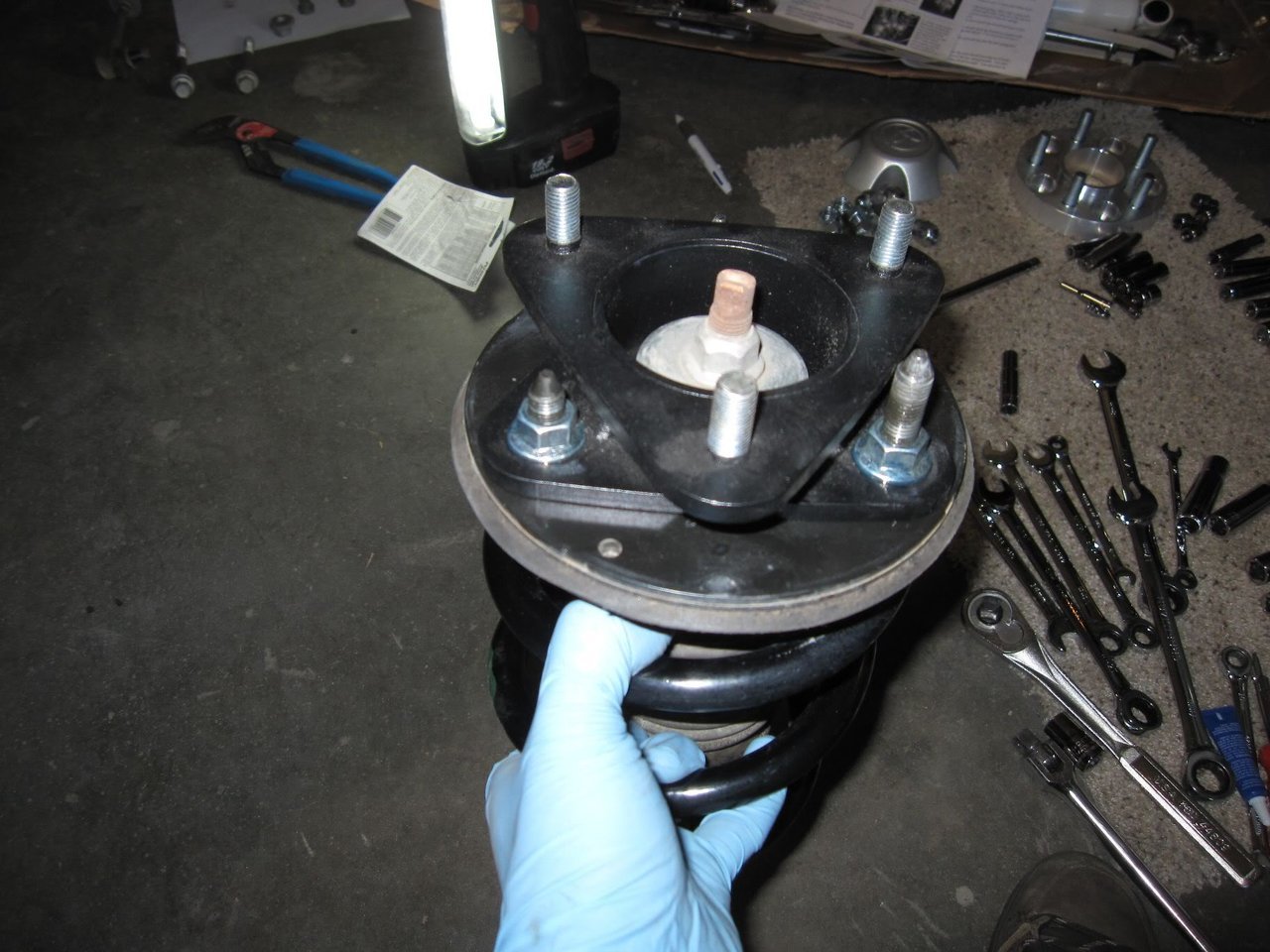

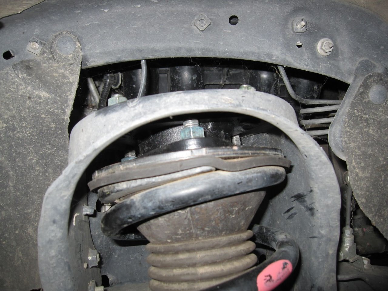

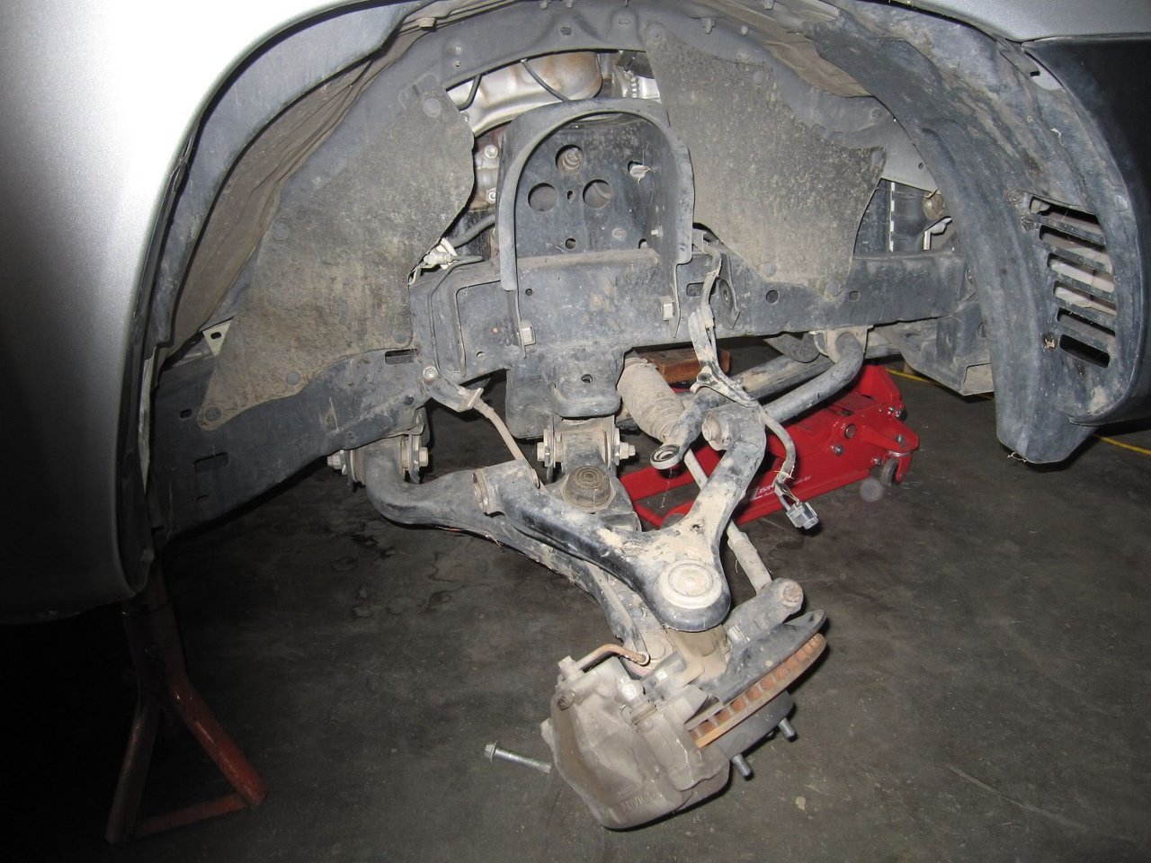

    Alright everyone, I got everything installed over the past weekend and the truck looks a hundred times better :headbang: It's been a hectic week which I why I haven't had a chance to post until now.
    Anyways, the install went fairly well. The instructions from FatBob's aren't very helpful at all. I ended up following ReadyLift's youtube video for the most part which was very helpful. The install took longer than I had anticipated and there were a few hiccups along the way but overall it was a success.

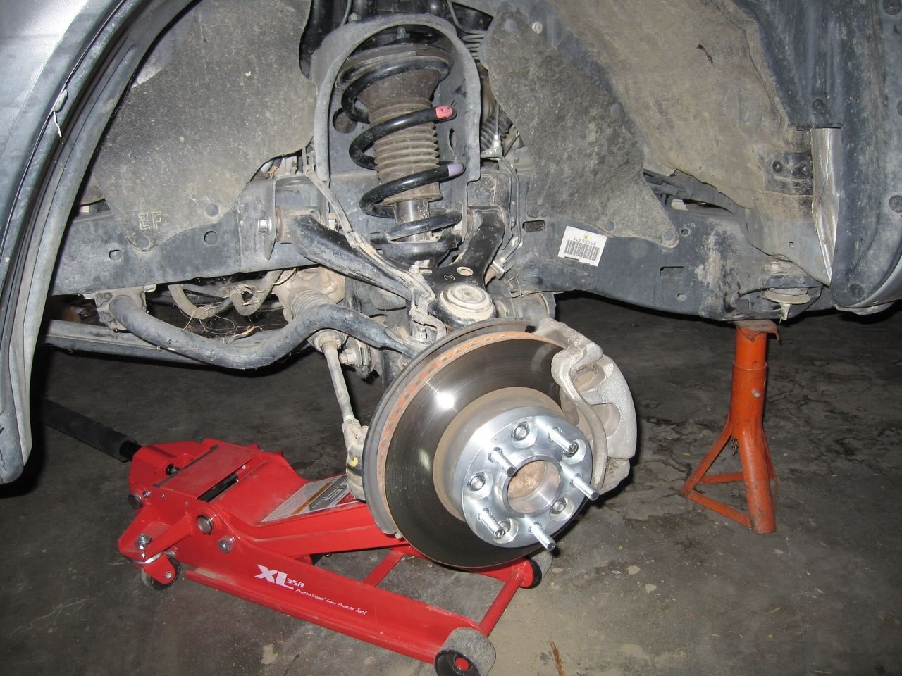

    Passenger side was attacked first...
    You can see that the stud on the right of the strut (not the spacer) is longer than the others. I forgot about this at first, went to reinstall and was wondering why it wasn't fitting *doh*. I used a reciprocating saw to cut it down to size. I ran into some troubles though when the instructions said to "rotate strut 180 degrees" before reinstalling. I did what apparently many others have done and rotated the whole strut only to install it and find out the bracket for the brake line was backwards and the upper control arm rubbed severely on the strut. So after some research I found out you had to use spring compressors in order to rotate only the top of the strut and not the whole thing. There wasn't any mention of needing these in FatBob's or ReadyLift's instructions. I really don't know how you'd accomplish it without spring compressors so it's definitely something to be aware of if you're planning on installing this kit. After compressing the springs, the top of the strut rotated no problem and everything lined up and fit the way it was supposed to. Oh, and the camera makes this picture look worse than it really is, but yes, I got a bit over-zealous with the locktite at first .
    Driver side with FatBob's spacer installed and the MotorSport Tech wheel spacer installed...
    Close up of the FatBob's spacer on the driver's side (I must've still had locktite on my gloves when I put the nuts on lol)...
    FatBob's long AAL installed...

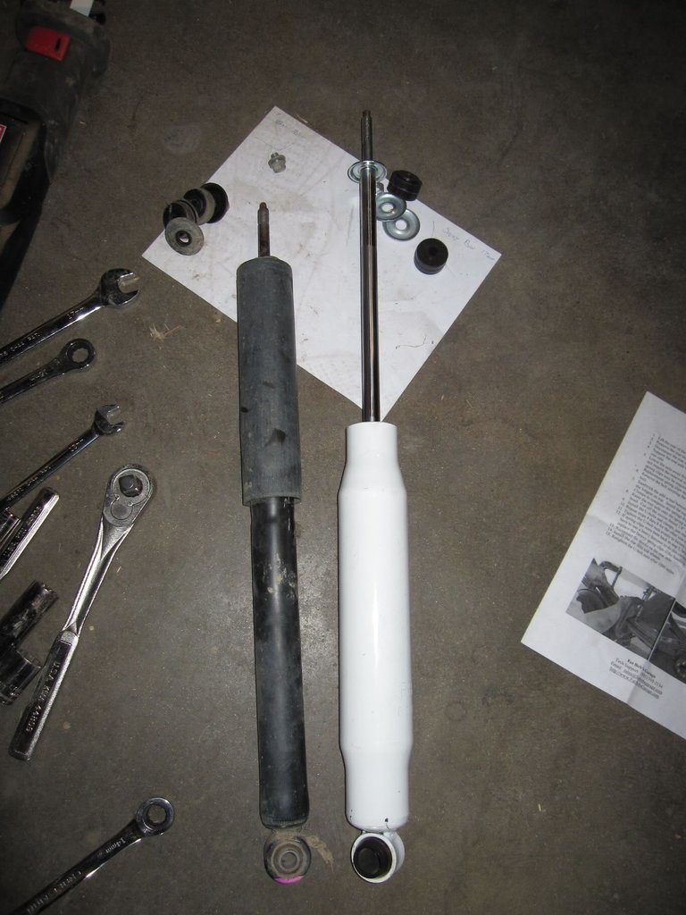

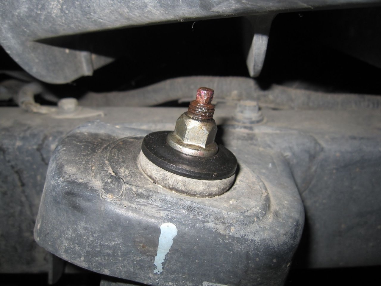

    Removing the factory shocks was tricky as the shock will just spin when you try to remove the nut. After seeing what people here on the forums recommended (cutting the shock, grinding the nut, clamping down on the shaft with vice grips or pliers, etc) most of which tend to ruin the shocks in the process, I thought I was going to have to resort to one of these things and destroy the factory shocks. I wanted to avoid ruining them if at all possible. I ended up having success with some PB Blaster and an adjustable wrench tightened on the flat spot at the top. Took some time but finally got them out...

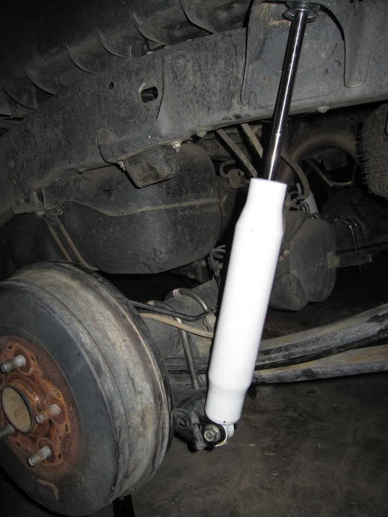

    Here you can see the size difference between the factory shock (left) and the pro-comps included in the FatBob's kit (right)...

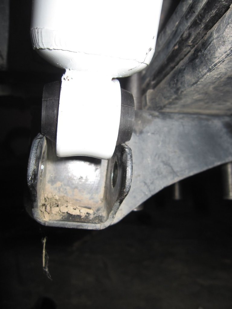

    I went to install them and ran into another problem. The bushing at the bottom of the shock was way to wide to fit into the mount. I tried using dishwashing liquid and some aerosol spray lube to help it slide in :wink: but no luck. After going at it for about 30 minutes, I decided there was no way that bushing was gonna fit. So I ended up having to shave about 1/16 of an inch from each side of the bushing with a razor. Even after doing this, I still had to muscle them into the mount, and get it just right so the bushing wasn't binding up and blocking the bolt from passing through. This was probably the most strenuous part of the install...
    Here's the shock finally installed. Dust boots are not included with the kit. I just bought some the other day and will install them this weekend. My plan is to remove the top nut on the shock and compress it enough to fit the boot over. I don't want to have to take that shock out again :smash:

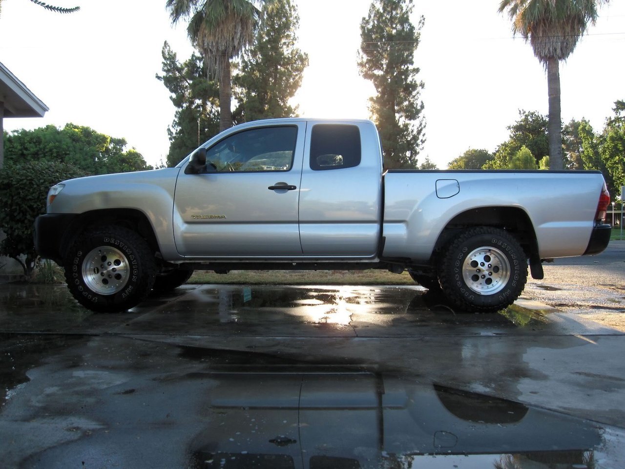

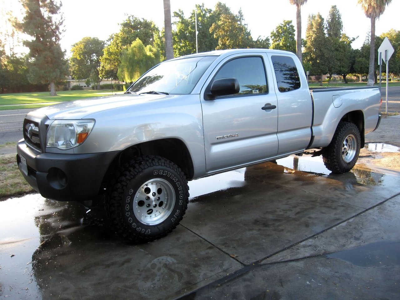

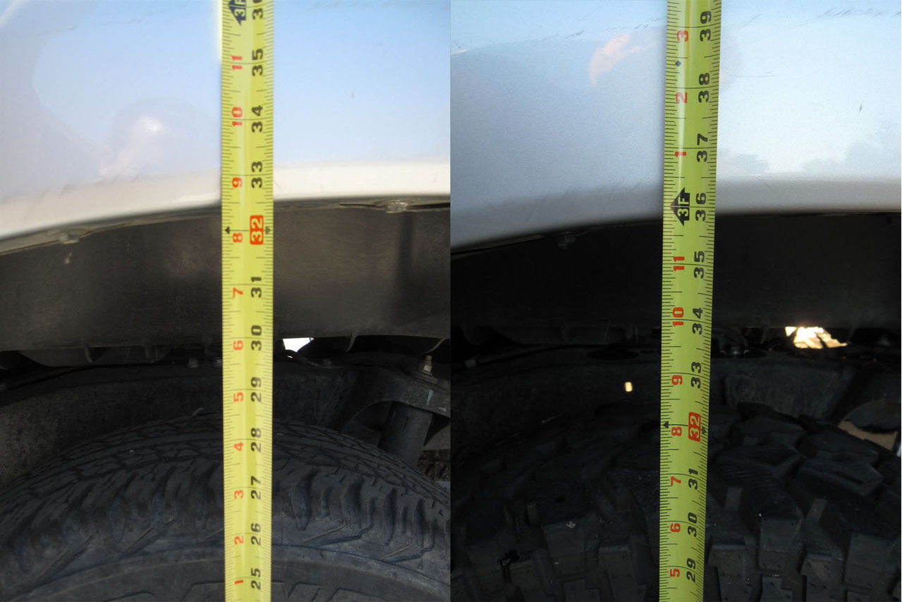

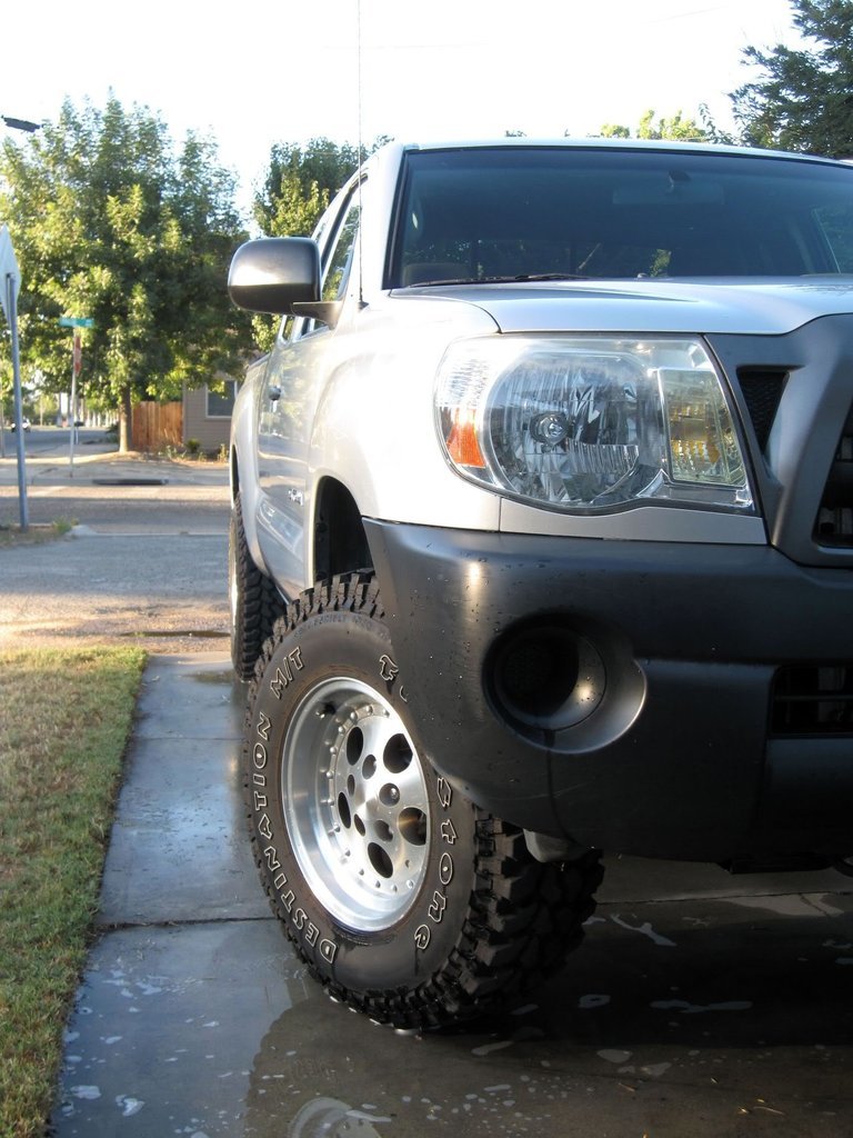

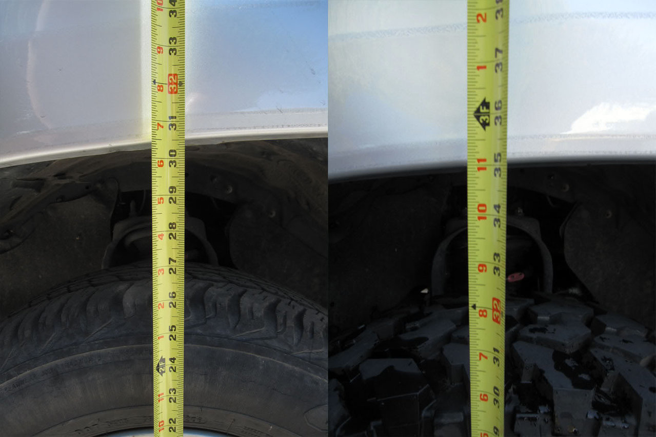

    And now, for the results....
    I took some before and after shots of the height difference with the new tires and the lift.
    Front = 4 1/2 inches
    Rear = 3 3/8 inches

    Not trying to sound like an ass, but those jeep wheels look wayyyy better than I thought they would, I honestly thought they might be a little goofy, but dang they're sweeeeeeet! The truck looks great man!
