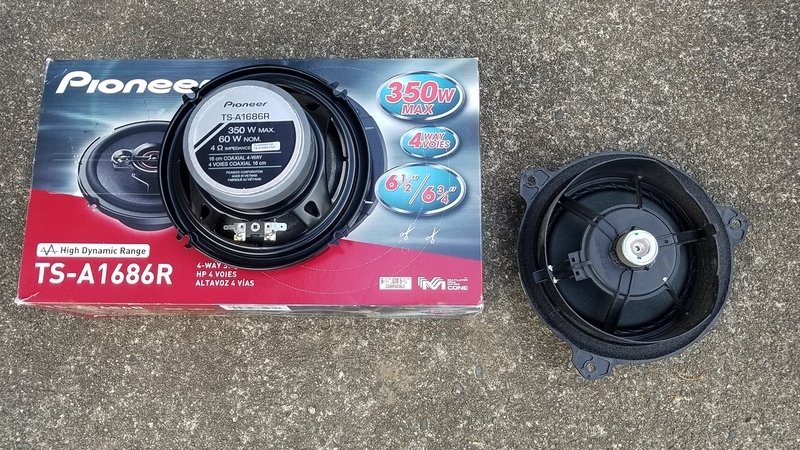

    So here's what I've got on the way:
    Front doors:
    Pioneer TS-A6986R 6x9s (http://www.pioneerelectronics.com/PUSA/Car/Speakers/A-Series/TS-A6986R) - $71 (Amazon)
    6x9 speaker adapters (https://www.amazon.com/gp/product/B00801K2XQ) - $20 (there are cheaper ones available, but these looked a little more robust for only a few dollars more)
    Rear doors:
    Pioneer TS-A1686R (http://www.pioneerelectronics.com/PUSA/Car/Speakers/A-Series/TS-A1686R) - $50 (Amazon)
    (I went with the 1686R instead of the 1676R because they are only a few dollars more and have a larger cone area that is essentially equal to a 6.75" speaker)
    6.5" speaker adapters (https://www.amazon.com/gp/product/B007ZQGZWO) - $7
    Other supplies:
    25sqft of Noico 50mil sound deadener (https://www.amazon.com/gp/product/B012AVX5HQ) - $37
    Sound deadener roller (https://www.amazon.com/gp/product/B00GMOI98S) - $7
    Speaker harness adapters (http://www.ebay.com/itm/331706690937) - $10
    So, for just a hair over $200, I should be able to greatly improve the sound from the factory stereo. As I mentioned before, I intend to add an amp in the near future, but not at this step.

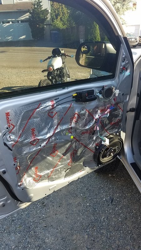

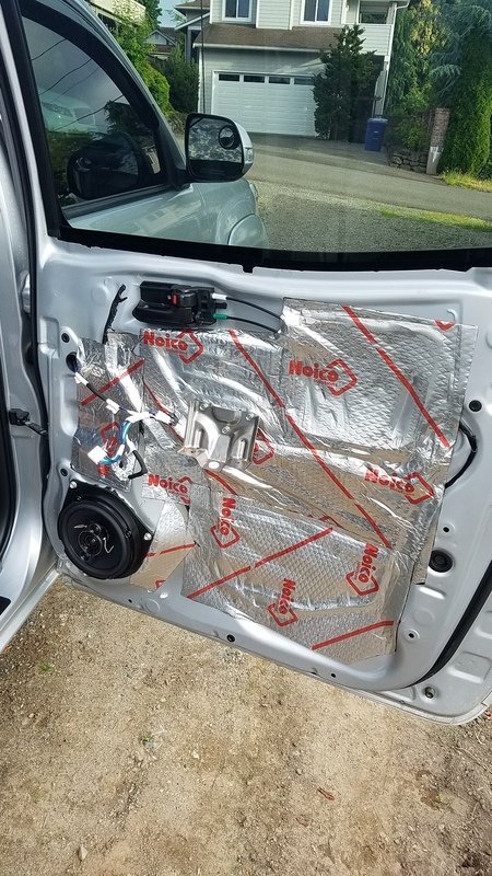

    I had some time this weekend and after work last night to get the speakers installed. Installing everything was really easy. If you take your time, it takes about an hour per door.
    The door cards pop off in no time flat (there's plenty of other threads that detail that procedure if you haven't done it before).
    Once the panels were off, I removed the factory plastic from the door panel. Next, I wiped down the door panel, and the inside of the door with acetone to ensure it was nice and clean to ensure the Noico sound deadener would stick.
    The Noico deadener comes in sheets that are about 14x20 inches. For the inside of the doors, I used one sheet on each door. I cut each sheet in half and put one half above the crash bar, and the other half below the crash bar (Note: on the front doors, there is a metal panel held in with a few screws you need to remove to gain access to the inside of the door). Then I used the roller to make sure it was stuck on good. You don't need full coverage with this stuff, technically all you really need is around 25% coverage.
    Once the inside of the door was done, I used two more sheets to cover the door panel (so, a total of three sheets per door). The goal here is to seal up any holes in the door (except the holes the door clips go in!). This does two things: 1, it replaces the plastic weather protection that was on the door, and 2) it blocks noise that otherwise would have been transmitted through those holes and reduces vibrations.
    I just covered everything, including the wiring harnesses. The sound deadener is pretty sticky, but it's not so sticky that you can't get it off if you need to access something in the door sometime in the future.
    Here's what one of the rear doors looked like when I was done:
    And a front door:
    After covering the door, I used whatever was left of the two sheets on the back of the door card. Basically, I just applied some to where the different parts of the card are plastic welded together to prevent rattling in the future. I also added a little bit to the door switch to keep it from rattling as well.
    Then, you put the speaker rings and speakers in, and put everything back together. On the back of the speaker rings, I used some of the butyl left over from the plastic to seal them to the door. It's kind of messy and you probably don't really need to do this, but I did it anyway.
