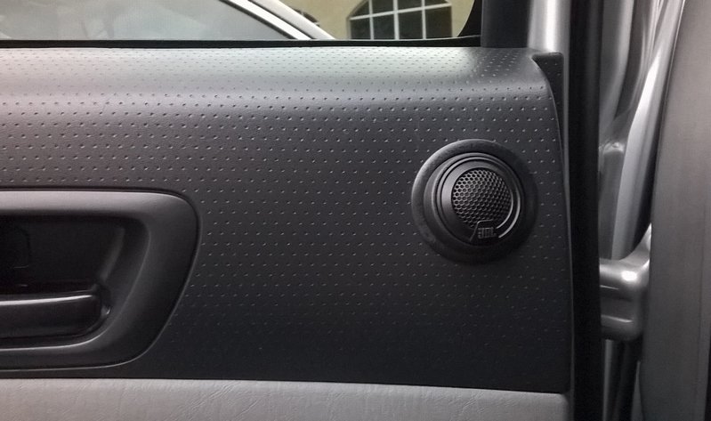

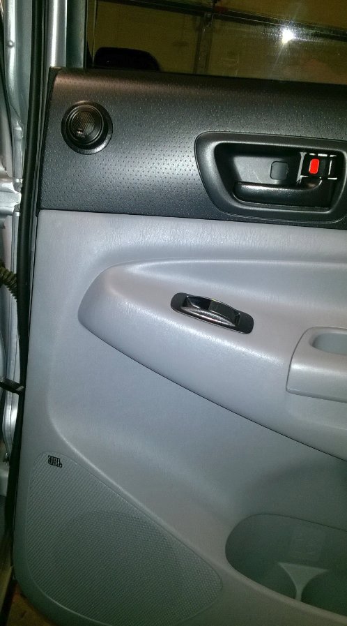

    I have a 2012 DC also. Since you already have bought the 6X9's and 6.5's spend a few $$ more and upgrade your door tweeters.
    Just use the factory wiring takes about 20 minutes a door and makes a lot of difference in the highs as now the tweeters are not directed at your feet.

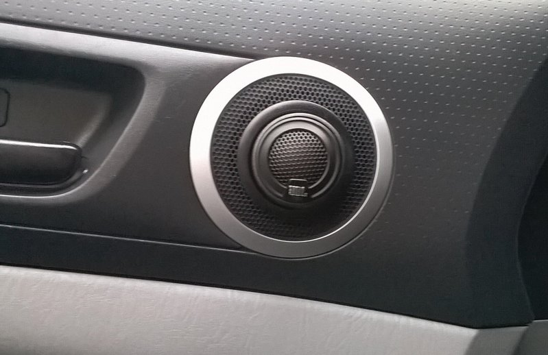

    The JBL tweeters like I have above are directional and pivot in their mounts.
    And since anyone rarely rides in my back seat I have all 4 pointed at the front. :yay:

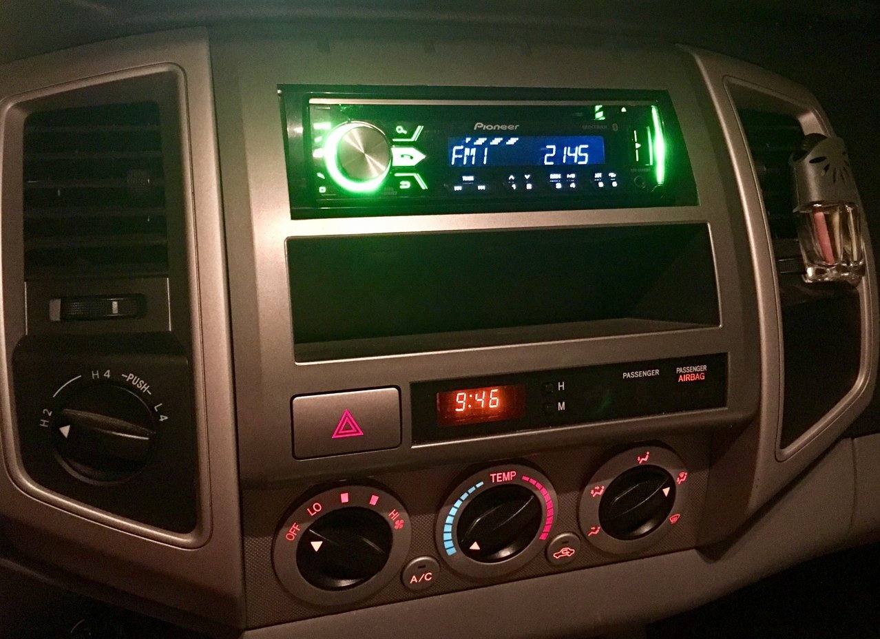

    Wow this thread was super informative!
    I just put a pioneer deck and pioneer speakers 6x9 and 6.5 into my 08 DC. This really needed to be done since the stock radio was such crap and my state has gone to
    -you can't have anything in your hands-no distractions for driving.
    This is what started the whole ordeal to change up everything! I picked up a pioneer deck and speakers from ebay as a package deal for $90, plug and play wires for the deck and speakers $15, both speaker mount sets for about $25, and my single din dash mount for $25. I am still using my stock tweeters but only for now.
    So far it's a major difference in sound and quality, and now legal for me to use my phone- hands free.
    After reading this thread though I definitely want to put some of that noise reduction on the doors. Maybe later on install kicker sub, tweeters, and amp.
    I think this is the next step in this little project.
    http://m.ebay.com/itm/Kicker-43TCWR...%3A36a55e8f15e0abc55a8a0bc5fffe9941%7Ciid%3A9
    Super simple install!!
