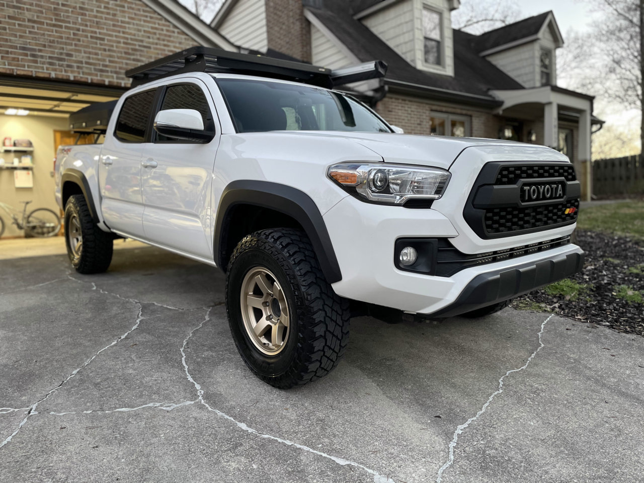

    After being told it was totaled I then moved on to a 2017 TRD OR in white:
    As of 04/24/2020:
    As of 03/03/2021:
    Current Mods:
    Wheel / Tires
    Level 8 Bronze 16"
    Cooper ST MAXX 265/75r16
    Exterior
    Front Runner Roof Rack
    Front Runner Bed Rack
    iKamper Skycamp mini
    RCI Bed Rack
    Tepui Kukenam 3 RTT
    Interior
    BROG First Aid IFAK Bag
    BROG Visor Panel
    BROG Taco Tray
    BROG Trash Bag
    Alpicool C40
    Custom Fridge Platform
    Camping
    Goal Zero Yeto 500x
    Goal Zero Boulder 100
    Custom 16 Gallon Water Tank
    Performance
    X2 Power 27F

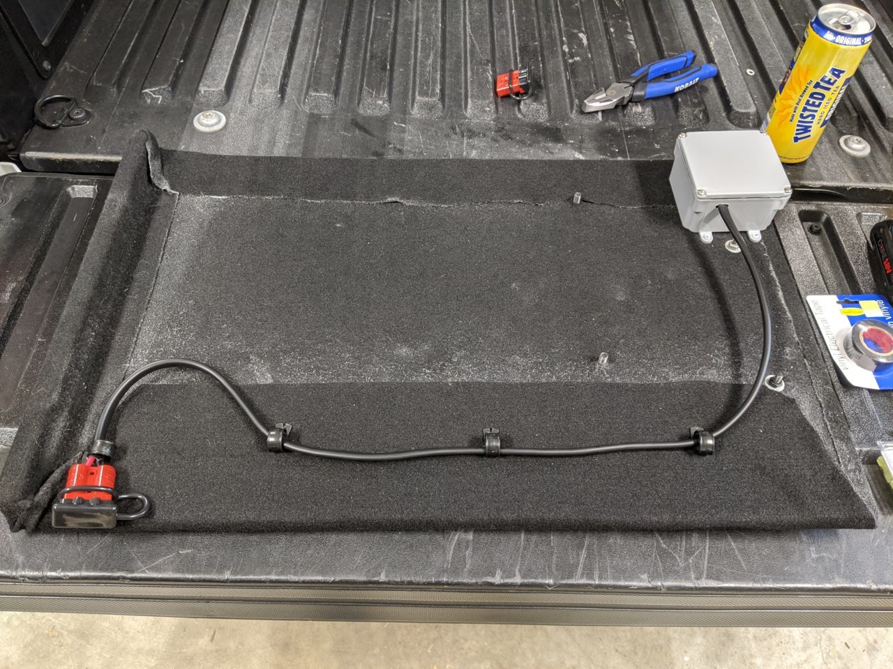

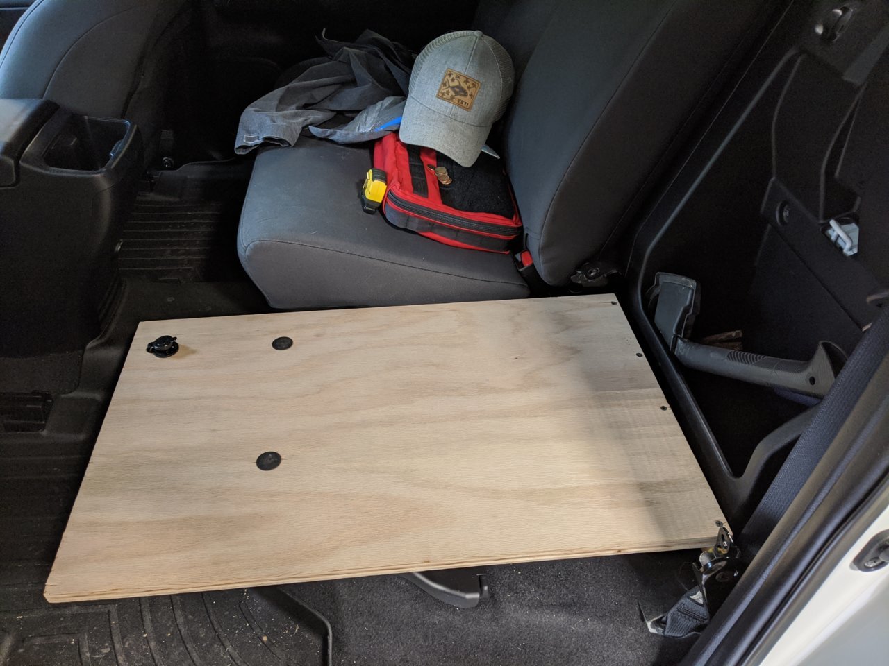

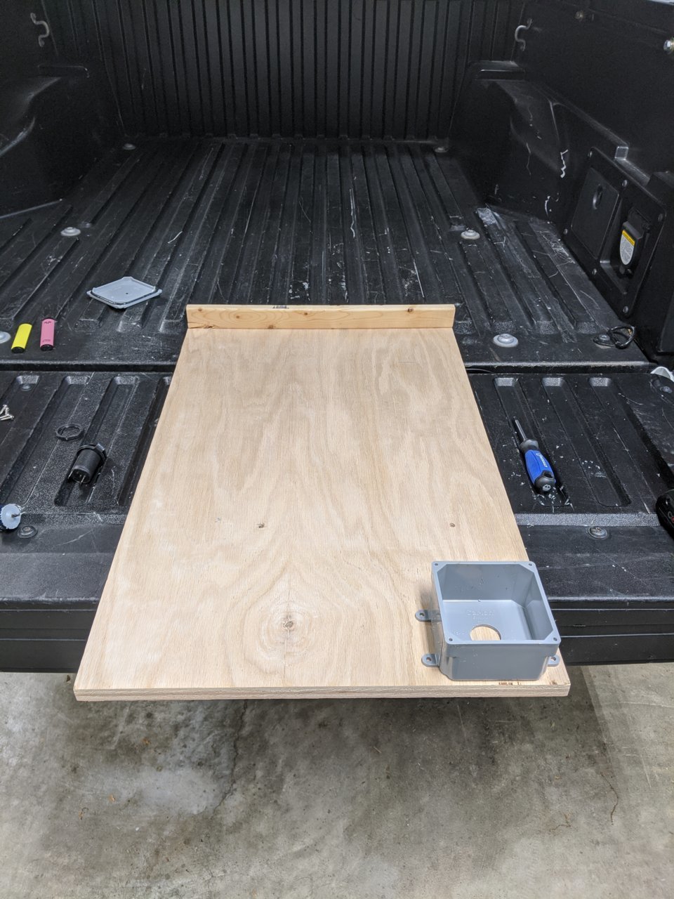

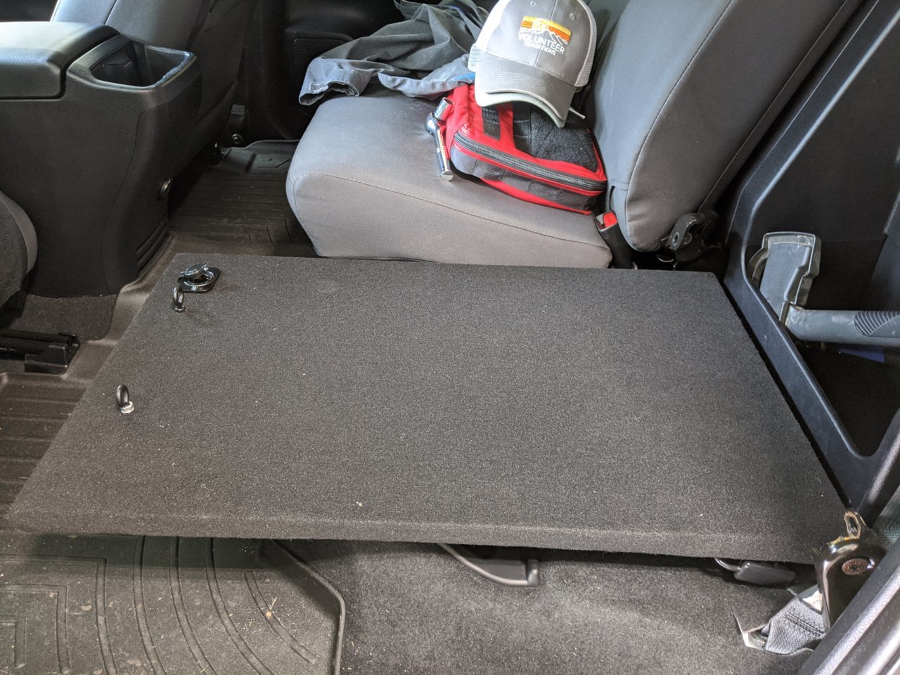

    Fridge build. So far...
    Have the platform built. I did not want to drill a hole anywhere inside my Taco ( not yet at least... ) so I ran power underneath to a BlueSea 12v socket with a quick connect so I can unplug power then remove 2 bolts and the platform is out of the way. The spray glue is still very noticeable in the under side pic but has since dried gone.
    Haven't ran wire from my battery yet because I'm stuck on selecting a battery. Leaning towards spending the extra and getting an Odyssey over Optima. Any suggestions? I will eventually be ordering a Prinsu rack and installing a 100w solar panel to help with charge. In the mean time I'll make sure my NOCO is always with me. Once the fridge gets in and I select a batter I'll update!

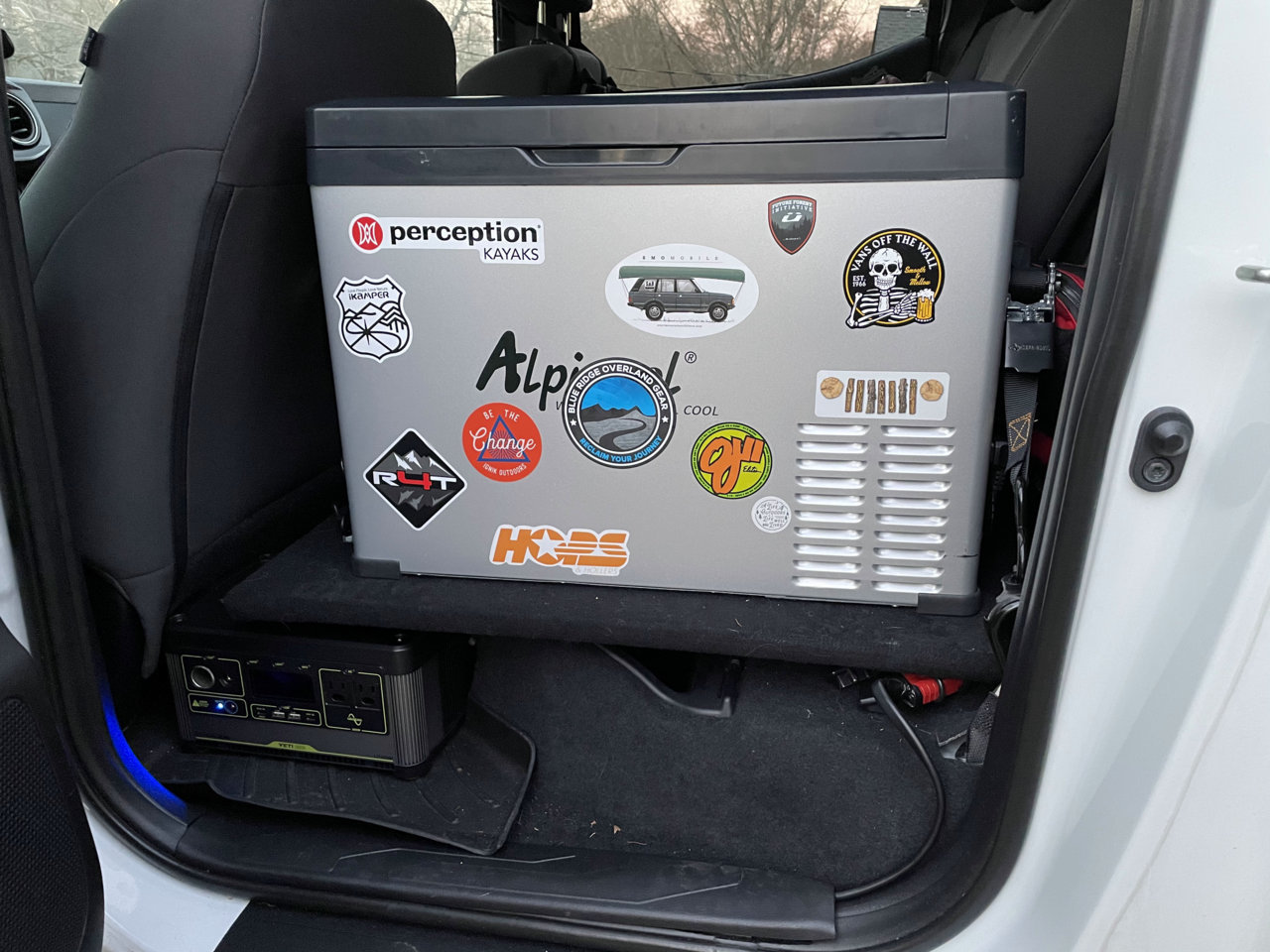

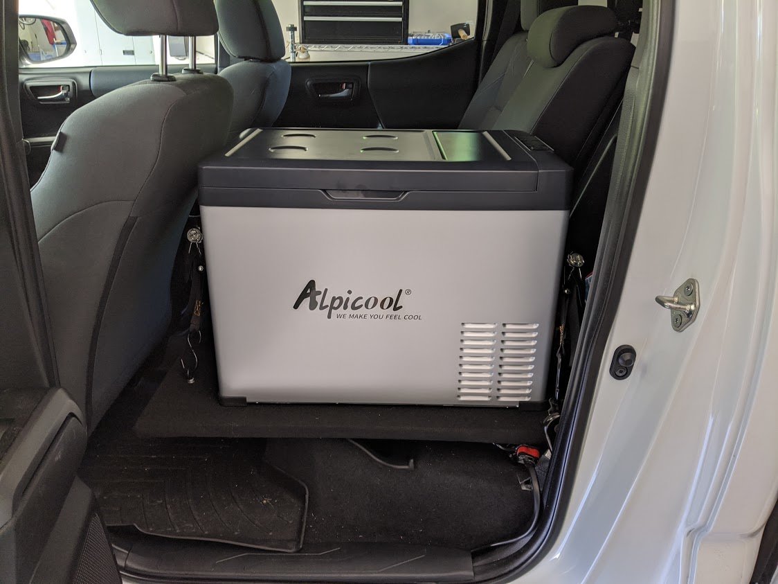

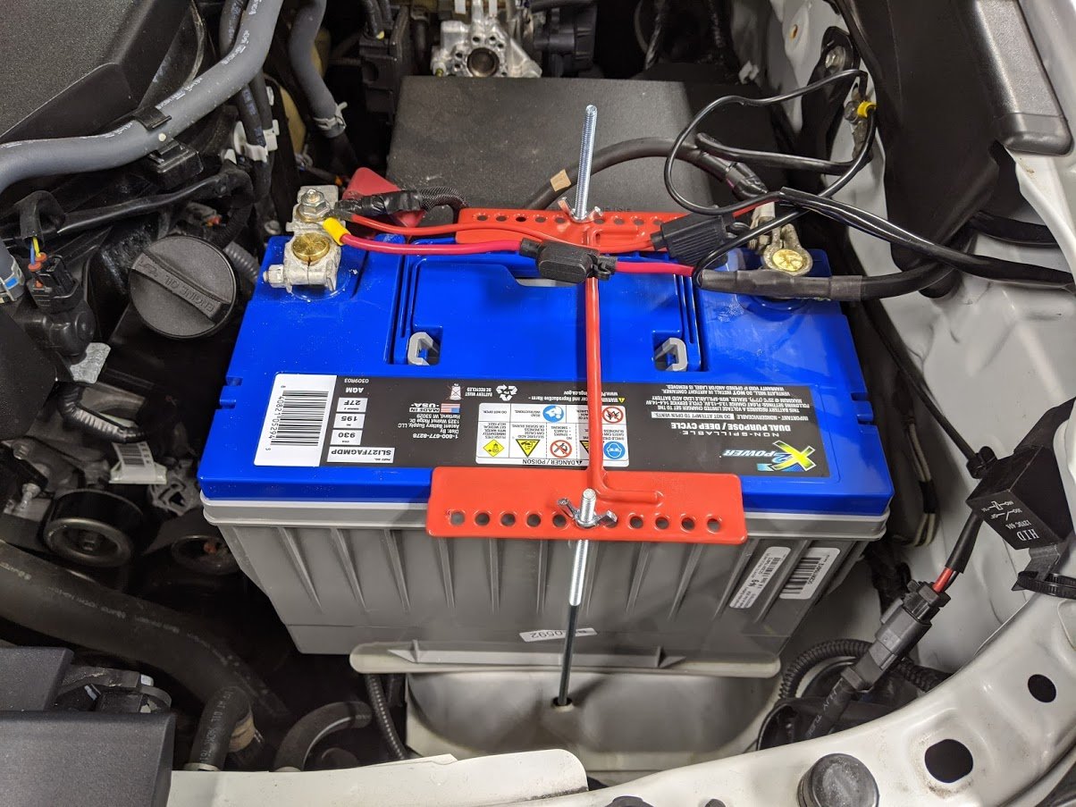

    X2 Power 27F and fridge is in! Any recommendations on a battery tray?

    Thinking about getting the same battery. SO, our stock battery tie down wont work for the 27f battery? For Battery tray everyone is using the 2nd gen with tow package

    The stock tie down would not fit for me and I grabbed a cheap alternative from AutoZone for now. I'm still using the stock battery tray and there is a little overhang right now. I'm not doing any kind of intense off roading until I decide on and order a new battery tray / tie down.

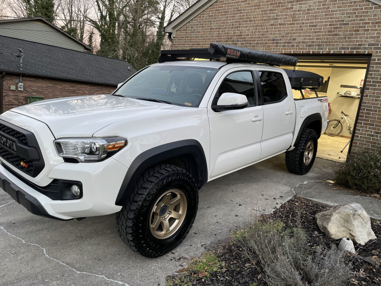

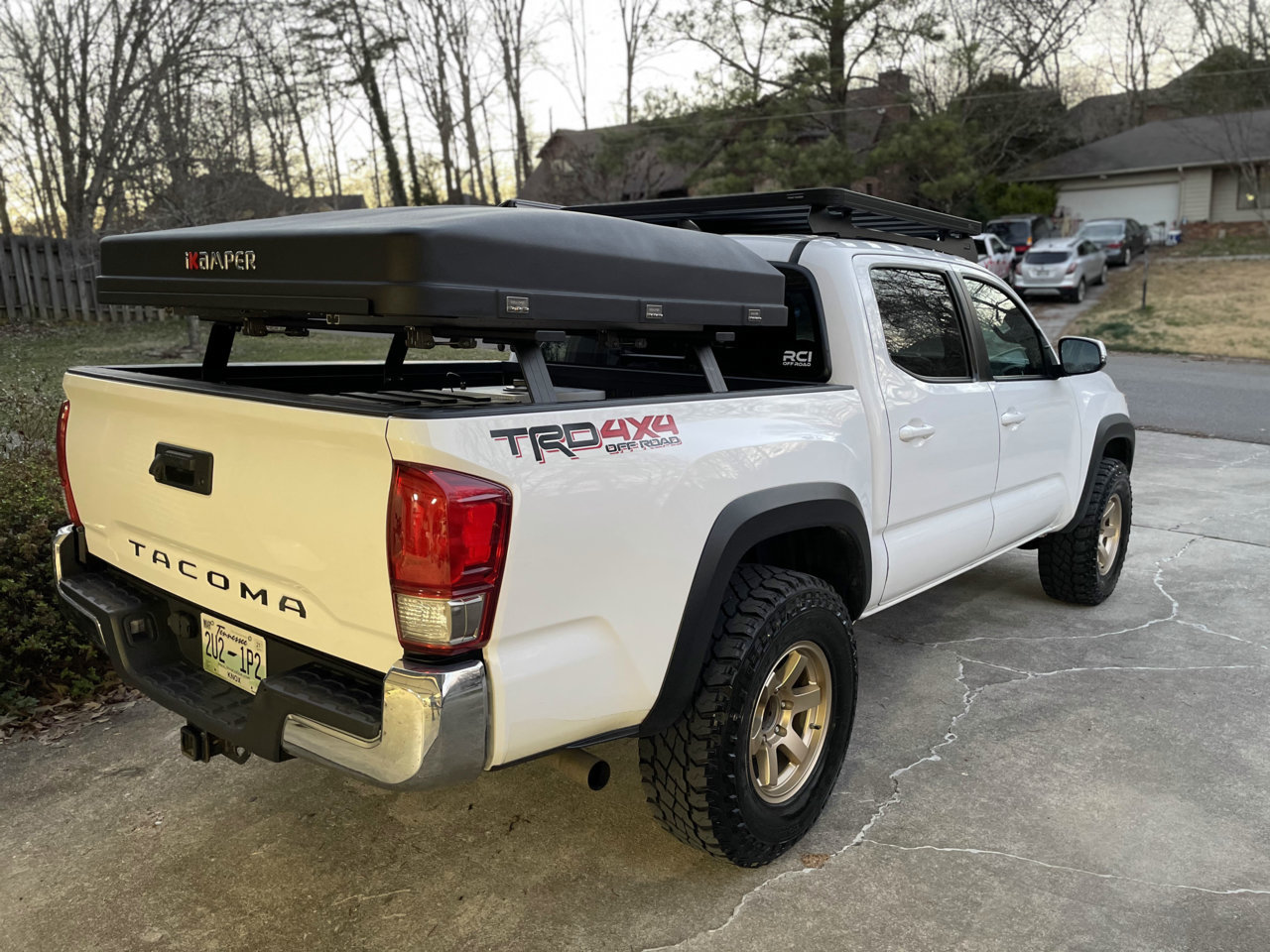

    - Replaced bed rack and went with Front Runner for the roof and bed
    - Out with the Tepui and in with the iKamper

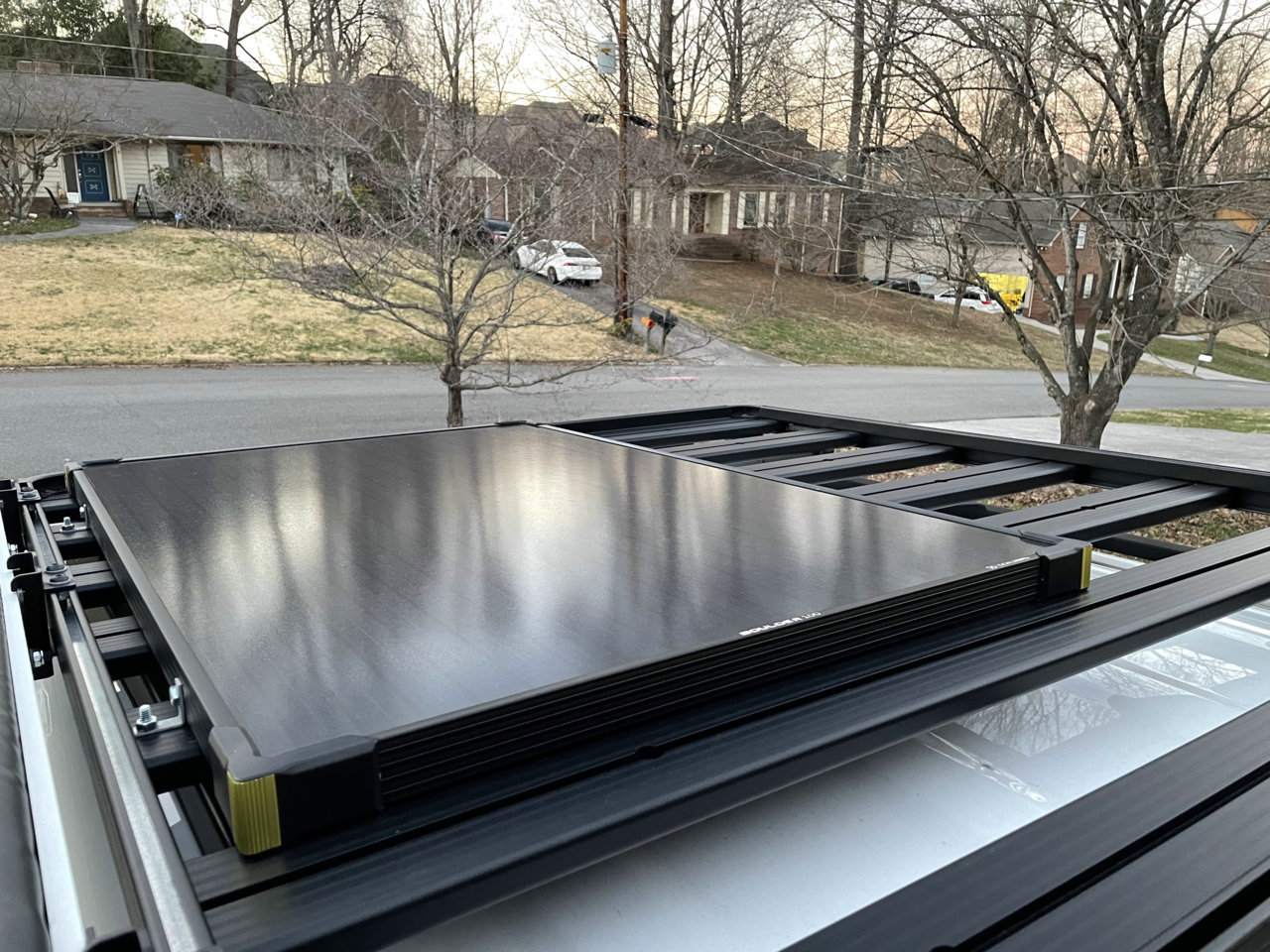

    - Purchased a Goal Zero Yeti 500x and paired it with a Nomad 100 I mounted to the roof rack

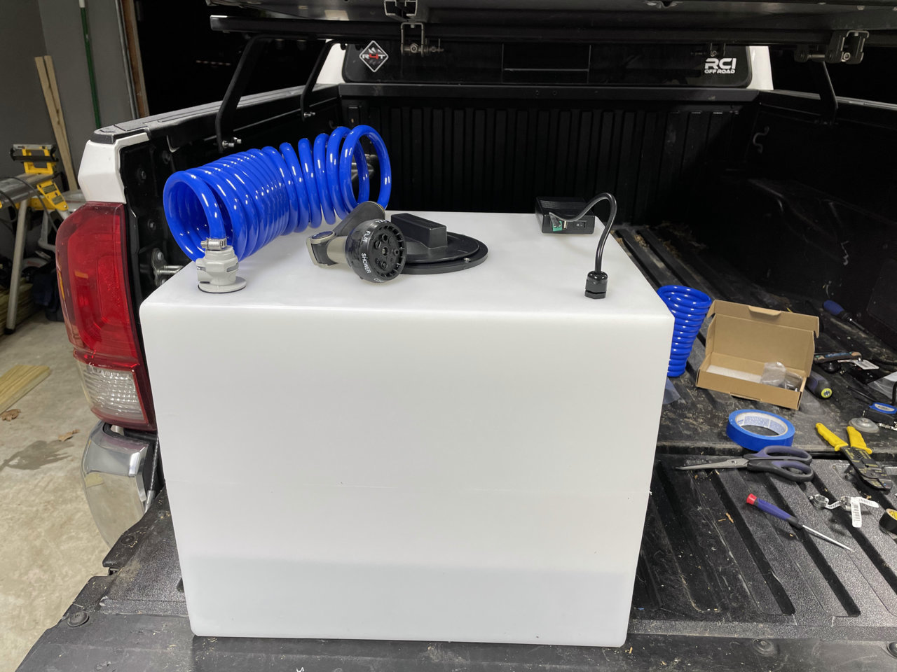

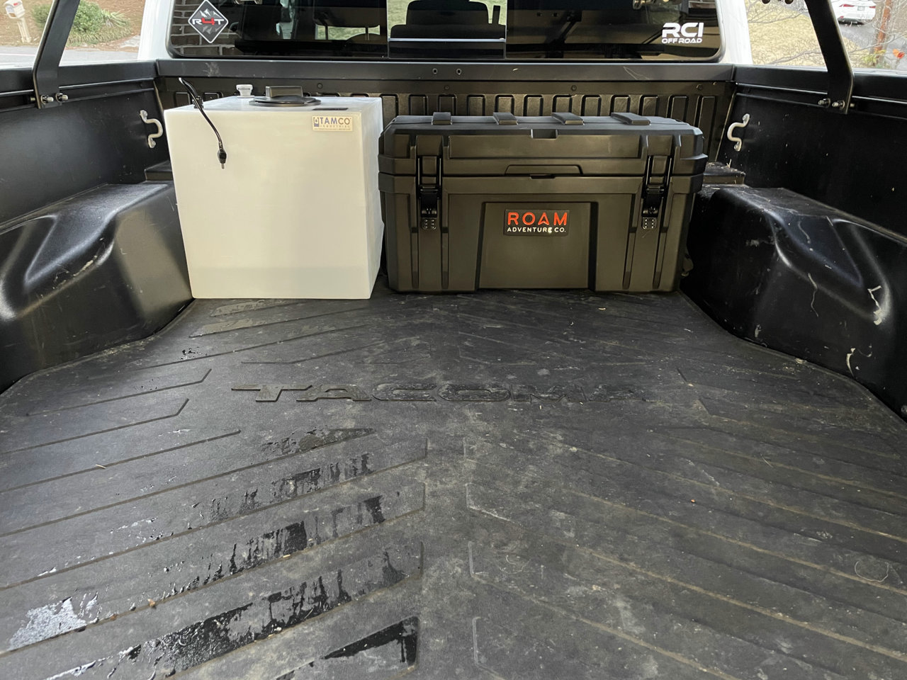

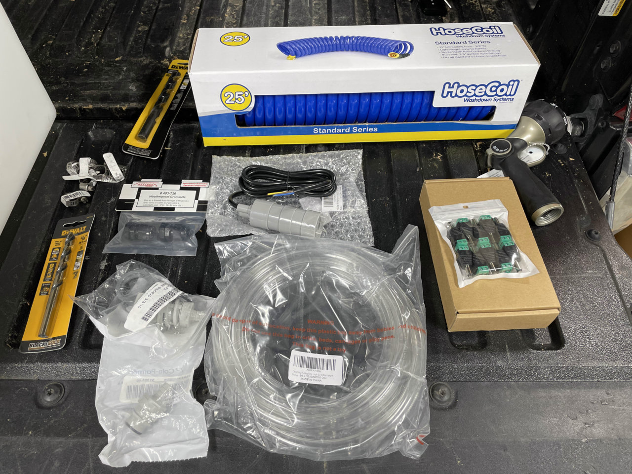

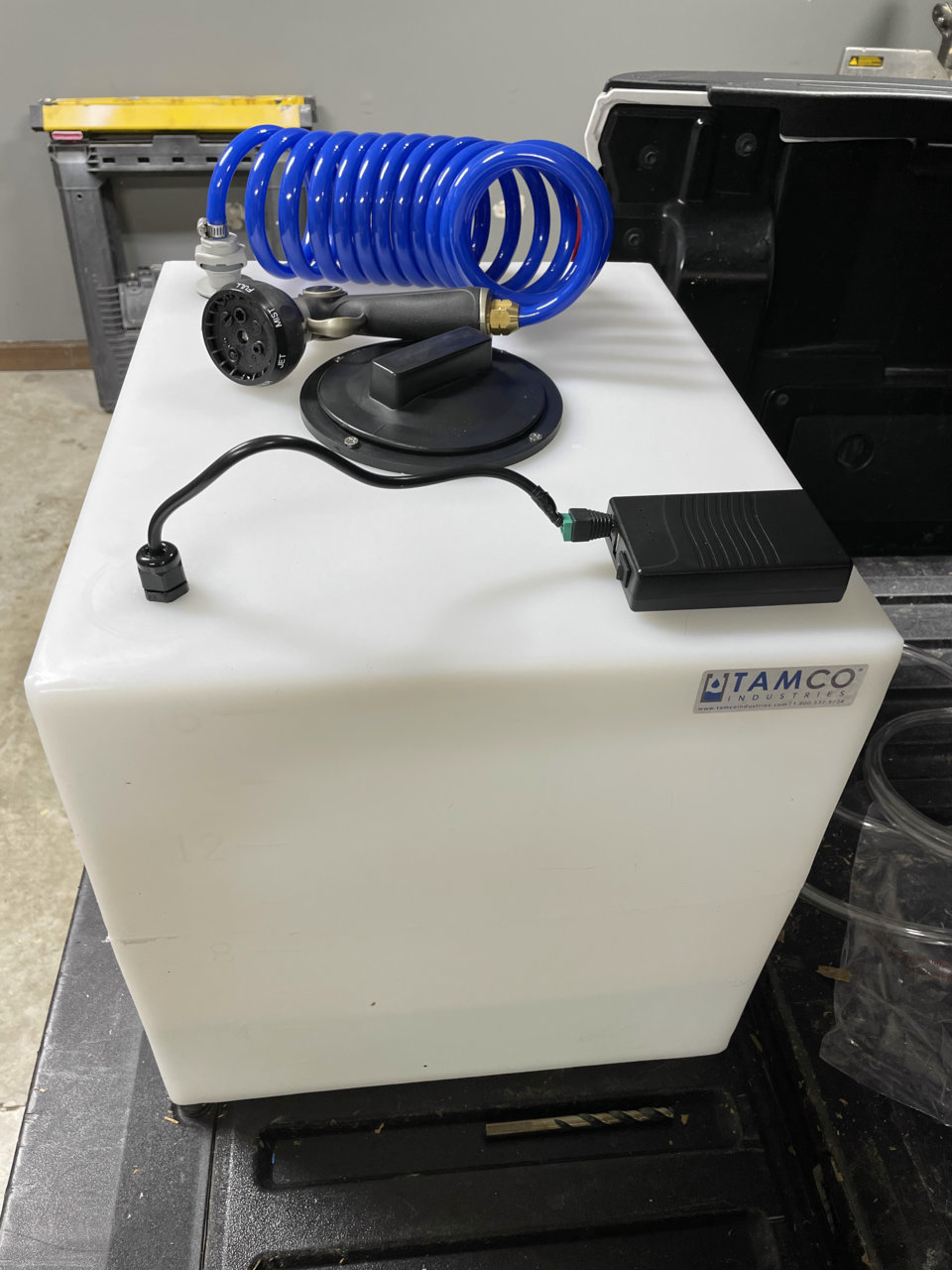

    Made a custom 16 gallon water tank with pump!
    It's powered by a 12v battery and the hose has a quick disconnect so it stores perfectly in the side cubby of the bed.
