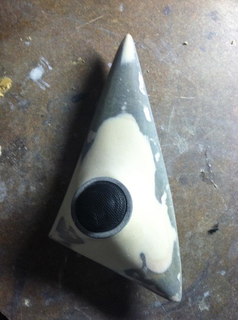

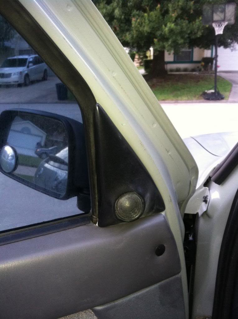

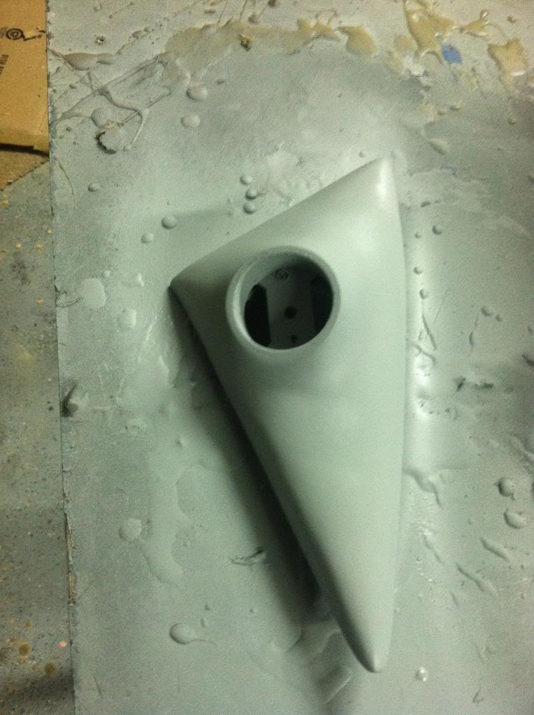

    I needed a place for my new tweeters so I made these

    is that straight bondo?

    No it is fiber glass then bondo to smooth it out

    nice! I was hoping there was fiberglass in there!! I might do this how do you like it?

    its awesome and kinda looks like the factory would put it in.

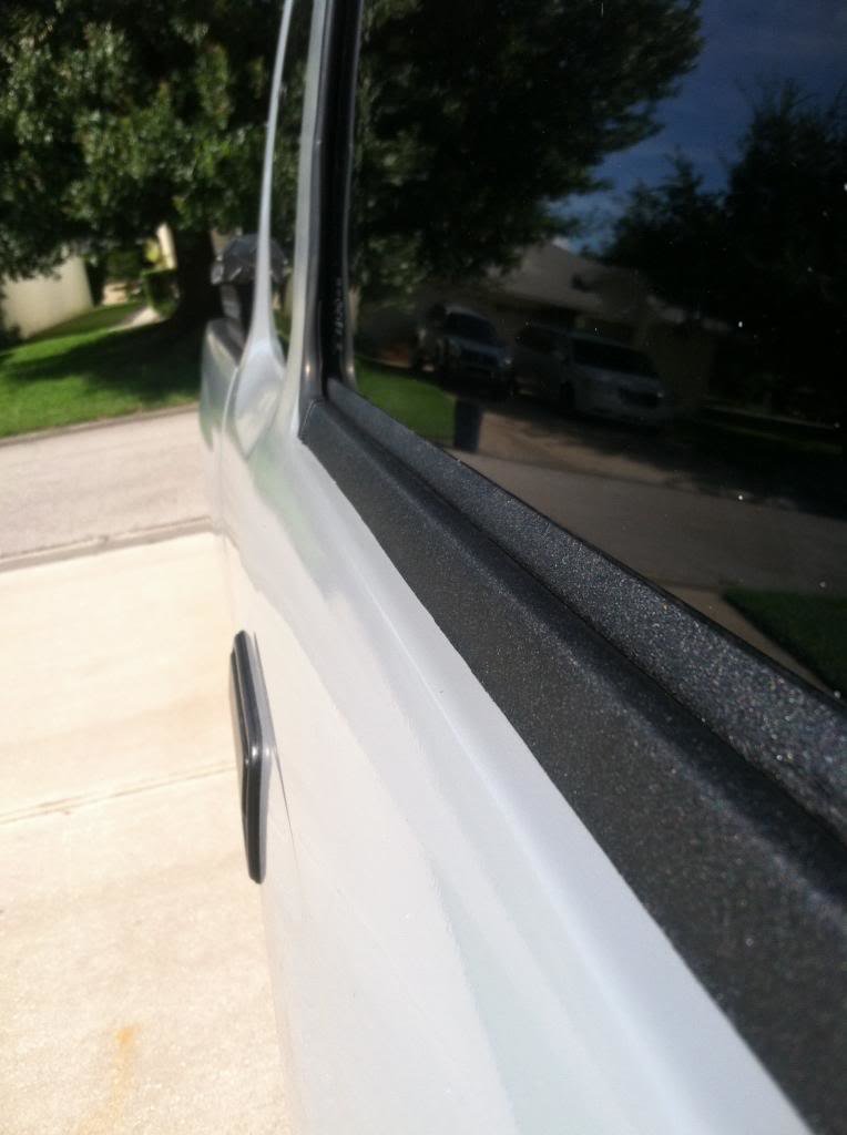

    Some of my friends have commented on how nice the trim looks for being such an old truck. I sanded the factory rubber off with 80 grit then sprayed on dupli-color bed liner.

    you will want to start with felt or i used an old t-shirt then you want to put a layer of fiber glass matte over it. For something this small I only used one layer of glass, any more would be a waist. I also used the stock insert and cut out some of the center for the back of the tweeter mount and the wires. dont cut any mouts off. Any other questions I am more than happy to help.
