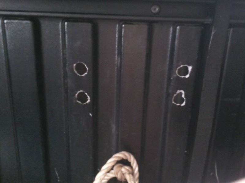

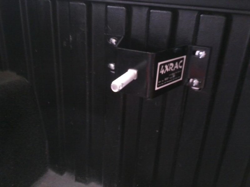

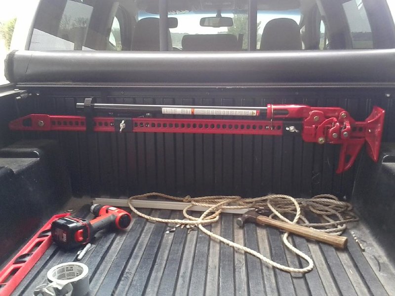

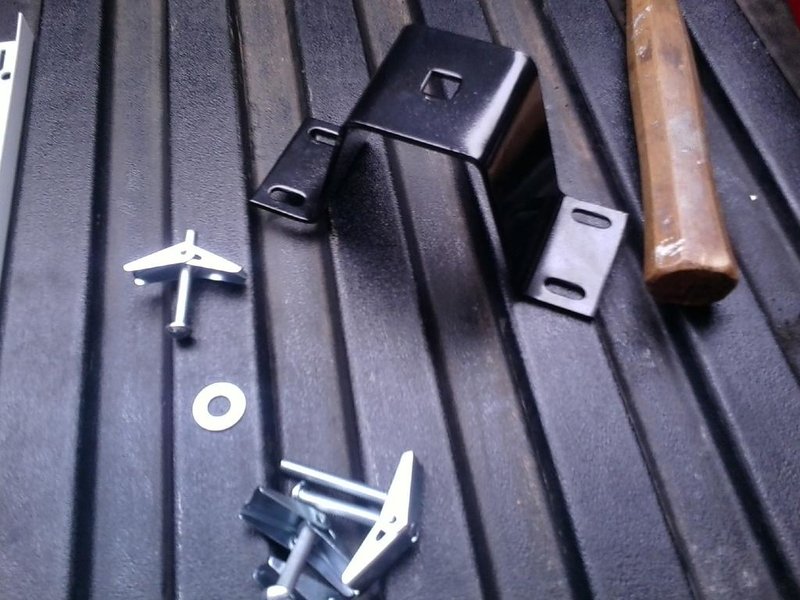

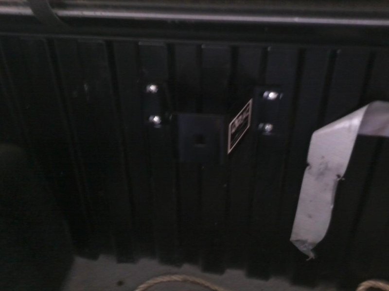

    These are some photos I took of mounting my hi-lift jack. I used 1/4" x 2"machine screws as well as 1/4" anchors. I Also used a 3/8" drill bit which I know what you are saying.. that's too small but I used it to also gauge the hole just big enough to fit the anchor through but nothing else..( it took a little time to do that) Once I drilled holes I assembled my mount w/ screws and anchors and put all four into holes at once ( no other way to do it.. then tightened the screws and used a level to straighten them. It worked very well and only took a total of 30 min. I really like the placement. I hope if anyone uses this technique this thread helps.. thanks for all the inspiration from the other threads on this subject.
