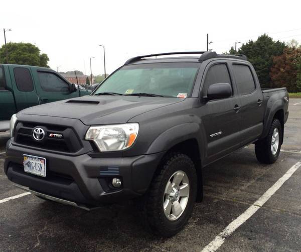

    My 2010 Converted.

    ok roger. I am looking for a new fender and thought I was limited to 05-11.
    Great job guys, looks good!
