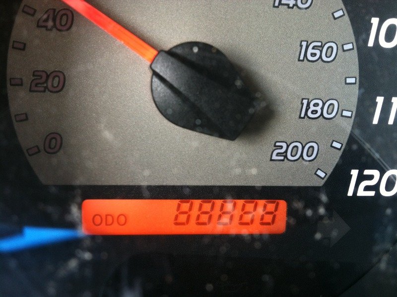

    Not a whole ton happening in here lol. Picking up 4 new tires next week when i get the truck inspected. Up next in the mods category would be to reinstall my cb stuff from the reg cab and i think a satoshi grill with my hella lights behind the grill is next. I need to stop spending money on my integra to make that happen though.
    I hit all 8's yetserday. Everything is still going as it should with this truck.
    9855D42F-B5FD-4C69-9F24-78AFDA235611_zps_034b75d59dd982271b05a62ff0b9bfcfabd1f5e7.jpg
    I clearly need to dust off the gauge cluster...

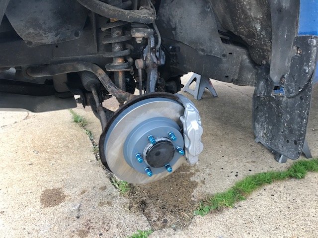

    Finally got some more updates. I've been driving the Acura so much i've only put 600 miles or so since i've taken the last picture picture. I've had quite a few good deals pop up on CL lately. I purchased a brand new OEM bed mat for $25, and i purchased a new to me LEER cap. Not perfect shape, but the price was really good. Of course a couple of photos are necessary:
    I really dislike the factory leaf springs. I will need an upgrade at some point to get the factory rake back.

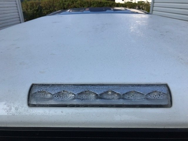

    Does anyone know how to take out the third brake light to get that condensation out of there? I did not see anything on the inside of the cap...unless its under the carpet?
    I'm still in process of the not fun stuff... My one caliper was completely seized and the other one wasn't doing much to help. So i got 2 rebuilt calipers, new pads and rotors since the stuck calipers cooked my current pads and rotors. What a freakin disaster this is turning out to be.
    Painted the calipers to hopefully eliminate some of the rust factor
    I knew the brake lines were going to brake from the rust. I ordered new ones from the dealer, and they are not even close to being correct. I matched vin number and everything an it says they are for my truck. I had to bend these things so many different ways to try and get them to fit the truck. Unreal. Then, the one brake line's flare nut was stripped. I could not get it to budge from the caliper. So i said fine, i'll remove you from the hose. Well, that stripped out too. So i ended up getting a new hose just so i could get the stupid brake line off.
    I still need to bleed the brakes, there is where i left off yesterday. I do like the little lift i have going on in the front of the truck right now while its up on the jackstands lol

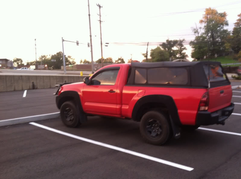

    I'm having a bit of a hard time deciding which direction to go with my truck. Since adding the cap, the rear of the truck sags and i hate it. This truck had the new leaf springs from the Toyota recall (or TSB i cant remember which it was) when the frame was replaced. So it is 3 leafs and the OL leaf. I really want the rake back to the truck, but i don't want to lift the front much if at all. I've been researching options and i'm not sure which is the correct direction. This truck sees little to no offroading, nothing that i would call serious anyways. I have had the truck full of passengers and had camping supplies in the bed of the truck before and i am pretty sure we were riding on the bump stops. I am purchasing a small trailer(utility size trailer) this summer, but i do not anticipate towing anything heavier than that at this point. i also assume replacing the rear shocks with all of these options
    option 1: AAL to the factory leaf springs - Cheapest option, however it sounds like the ride quality is not fantastic and it doesnt sound like the lifespan of an AAL if all that great.
    option 2: Wheelers or other brand 3 leaf AAL - Sounds like a better ride option, but to leave in my OL leaf it sounds like the rear would be lifted a good bit more than i would like. I dont want my hauling capacity to suffer by removing the OL leaf.
    option 3 (getting more expensive): Firestone air bags - seems like a straight forward installation, i'm not sure if this is just a band aid for the crappy leaf springs though. I'm also not sure how these things hold up long term, especially with our salt and winters. Essentially it seems like i would just inflate these until i am happy with the amount of rake on the truck.
    option 4 (most expensive): Replacement leaf pack - looking at the wheelers HD leaf pack, it is supposed to add 1.5" - 2" roughly of lift per an email discussion i had with them. I may need to lift the front as well compensate for a new leaf pack.
    Here is a picture of my old truck, i would be perfectly happy with this amount of rake. You can see a few posts above how my truck sits now with the cap.
    Any suggestions or input on my options is greatly appreciated.

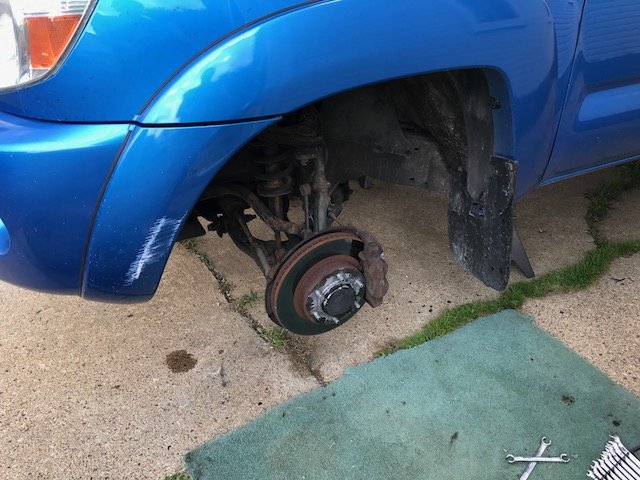

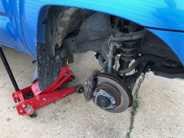

    So, i was changing a flat on my truck and noticed this awesomeness peaking around my fender flare. I poked it, and my finger went completely through. I'm sure this hole will be at least twice the size by the time i clean it out to good metal. Is this hole worth trying to repair? Or should i just try to locate a new to me bedside and paint it?
    Since i think i'm the only one that comes through here, i'll post this elsewhere in the forum too.
