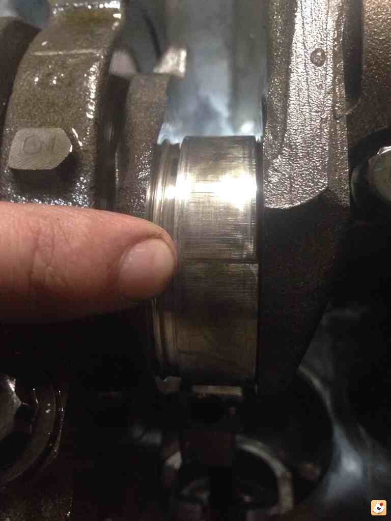

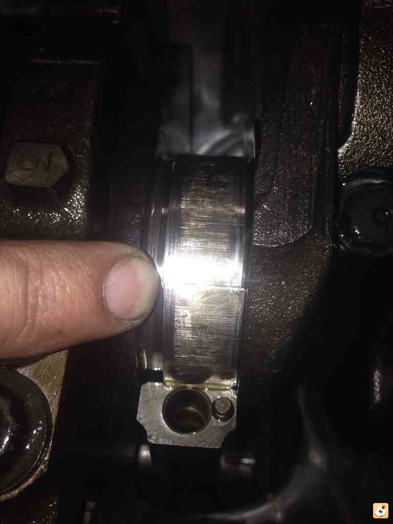

    Houston found the problem. Spun the rod bearing on piston no. 4

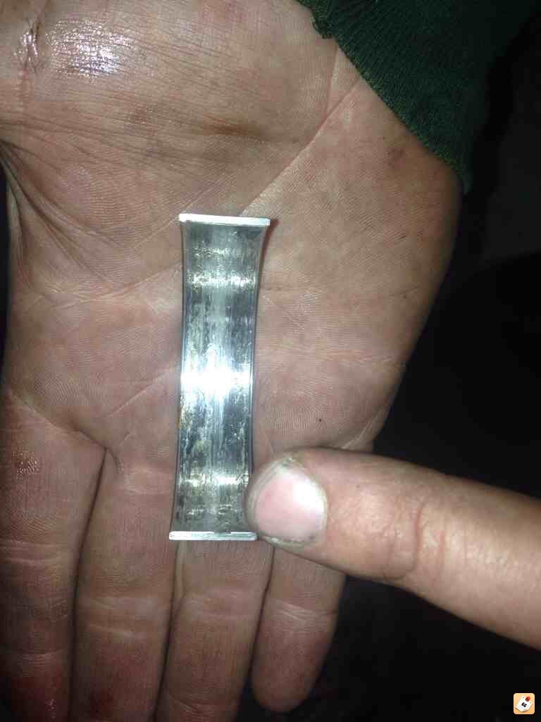

    Oh and all bearings looked like this

    Damn. That'll do it.
    When you first noticed then engine problem, what kind of driving were you doing? Also, do you remember what weight oil you were using?

    parts and stuff
    i put a catch can on the truck last jan. week later went wheeling. on teh way back, i got a p0016 and it felt like the truck hit a brick wall but then picked back up and ran. the catch can had a huge vaccum leak and was causing it to run rough and not even run after i starting to figure out the problem. removed the catch can and everything was fine then i would have issues later. basically it wouldnt go until the truck got to operating temp and would run ok. altho it sounded rough. evidently i was having low oil pressure too but didnt know until i put a gauge on it back in june/july
    running 5w-30 right now, probably going to bump up to 5w-40 next oil change.

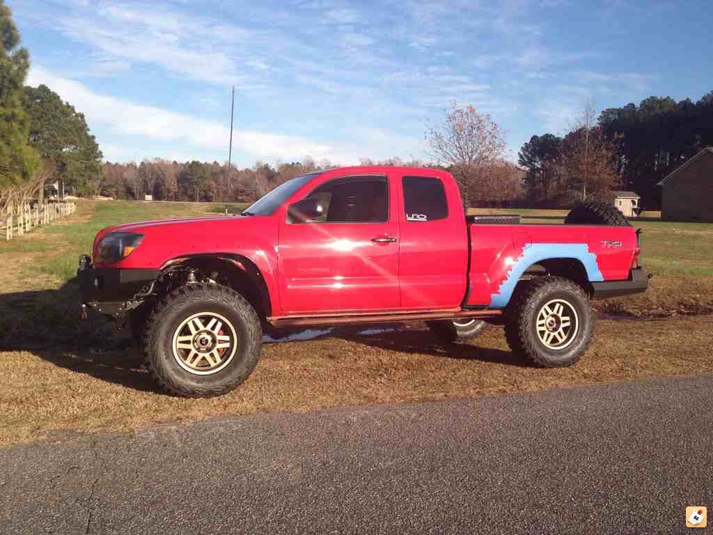

    The truck finally sittin at home
