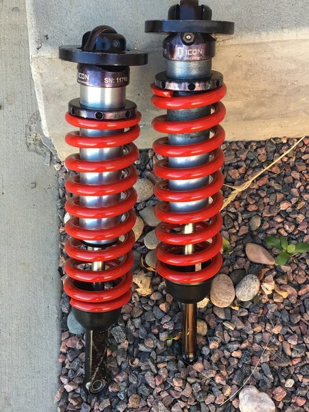

    Mmmm rebuilt coilovers

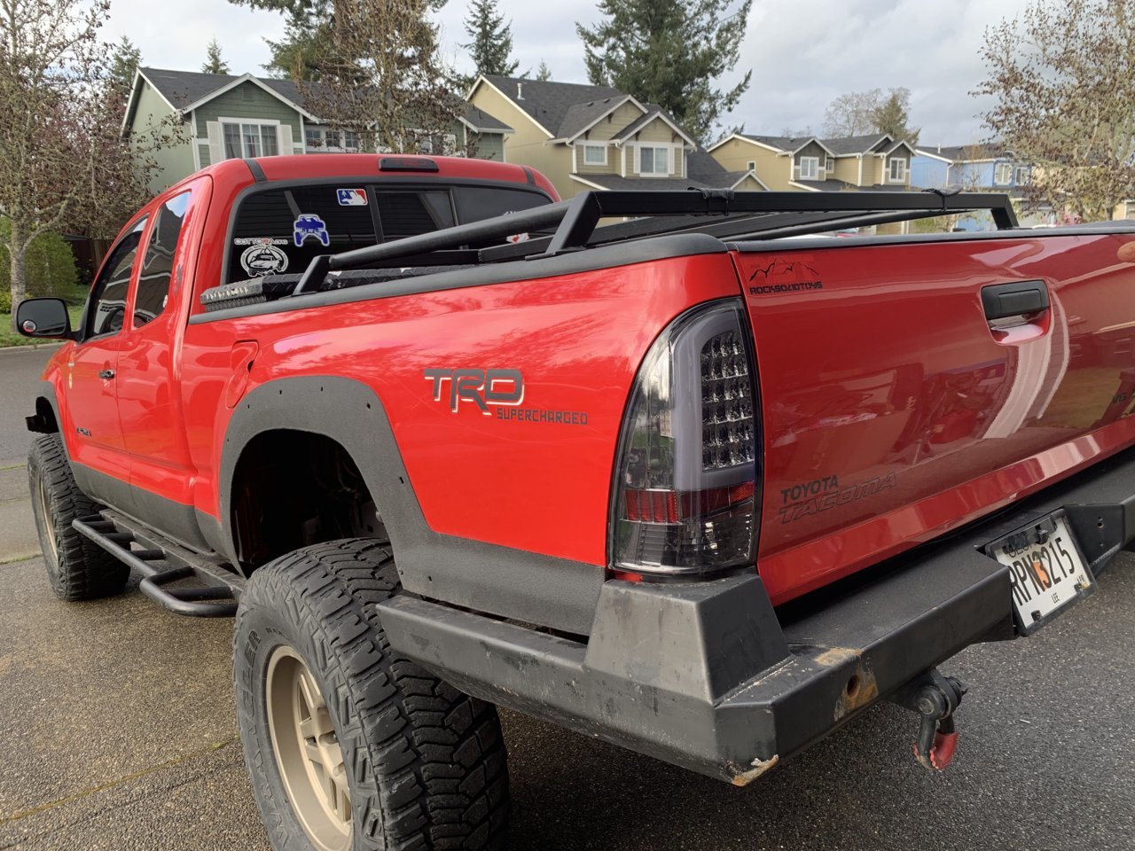

    So haven’t updated this in a while. Kind of hard while being in Korea and can’t touch the truck. But I did some stuff.

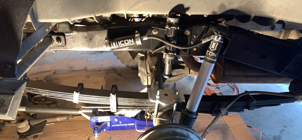

    Installed shocks and bump stops
    And I busted out my left taillight back in 2015 and finally replaced it with these
    Got more to do on my GX 470 soon.

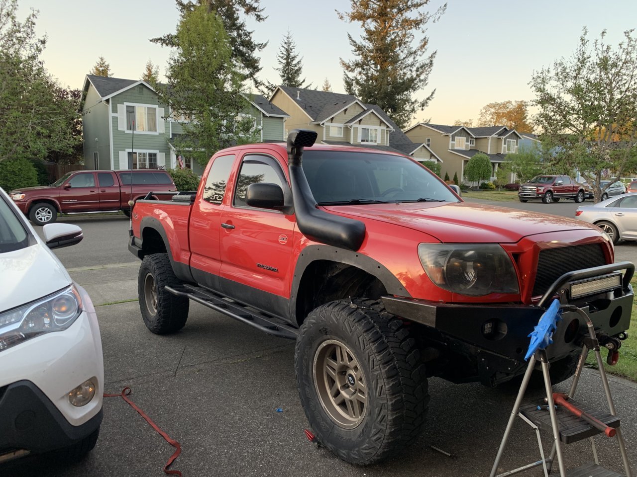

    Finally, Did this. Don’t wanna ever do it again. Sucks. Hated every minute of it and template sucks and didn’t line up for shit. But snorkel finally installed
    ready6delta and 6 gearT444E like this.

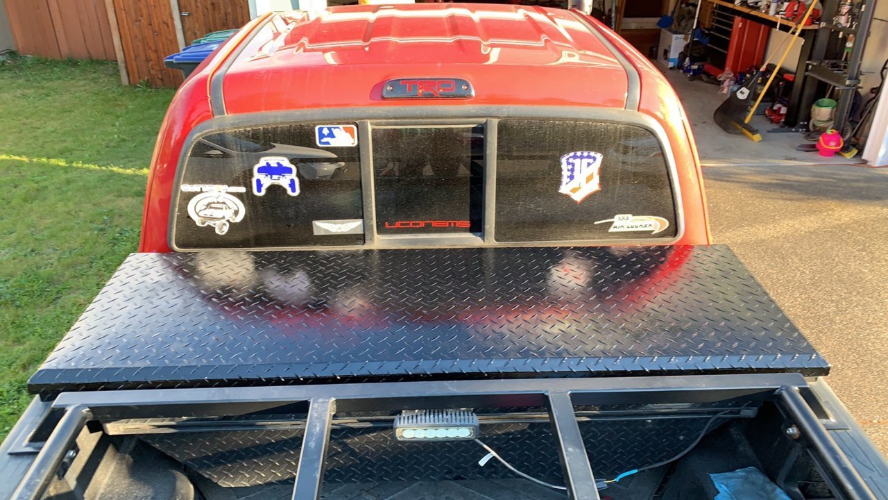

    Repainted lid to toolbox. Was peeling really bad

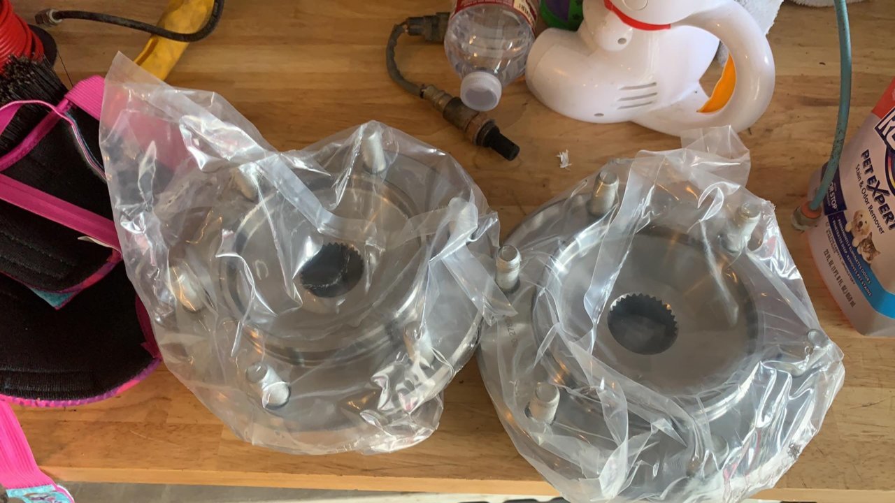

    Also was having a growing in in the front end so replaced both wheel bearings and everything is nice and smooth and quiet again. Second time replacing the wheel bearings. Been getting 6-7 years out of them

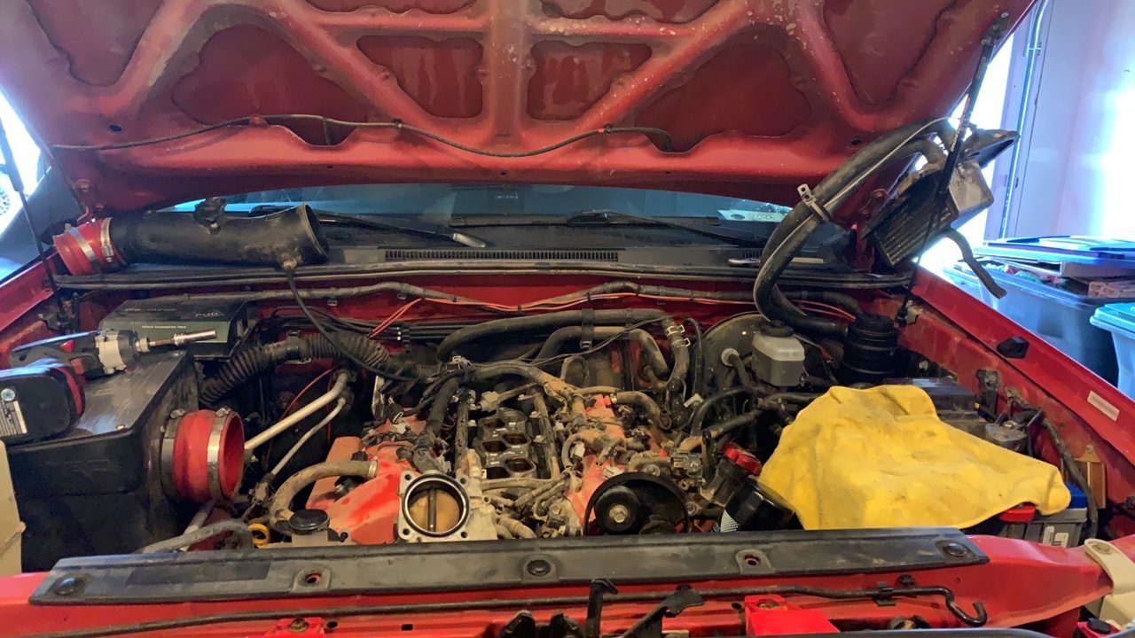

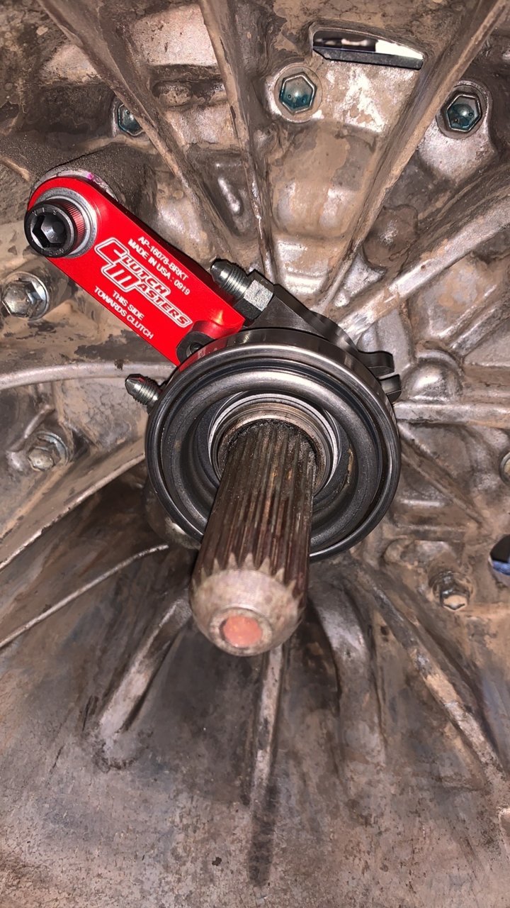

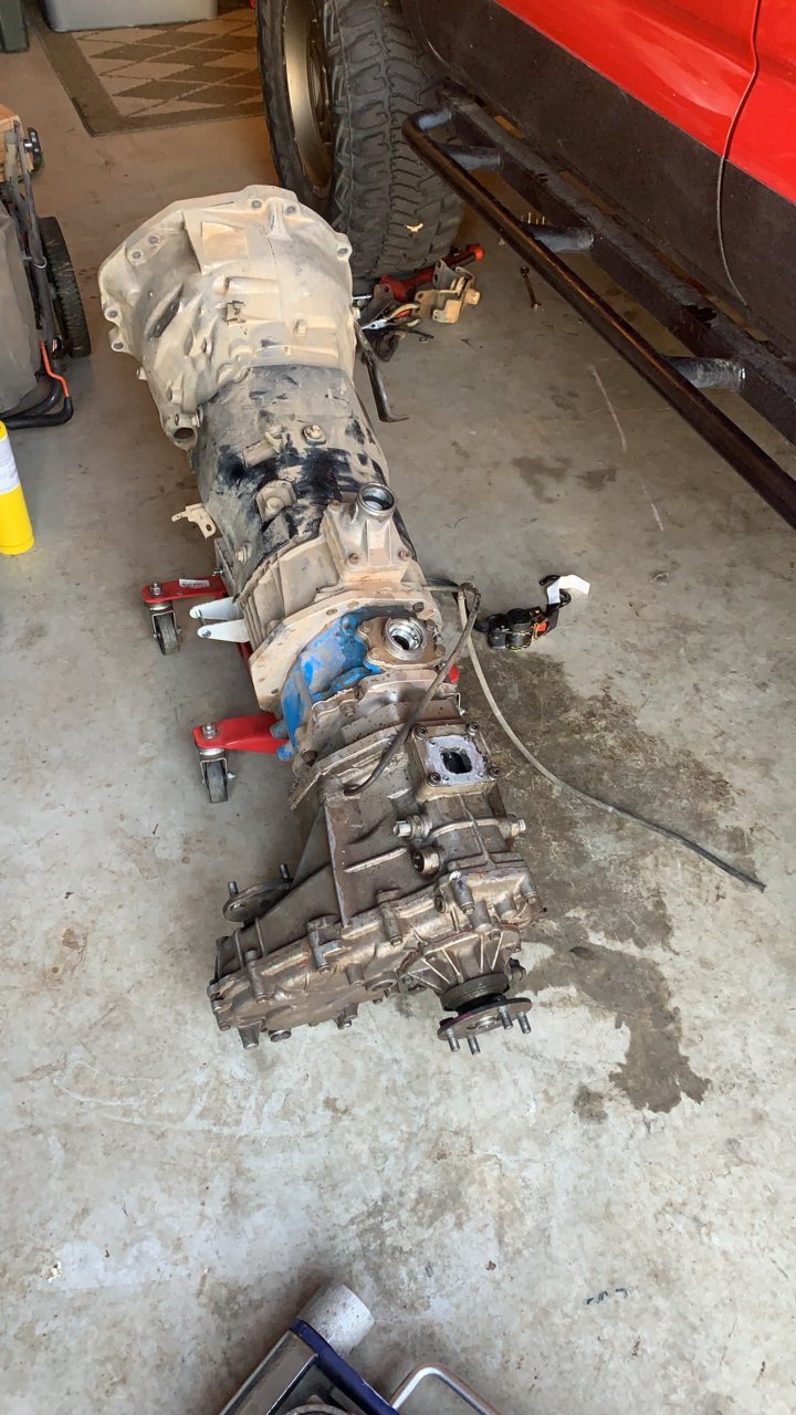

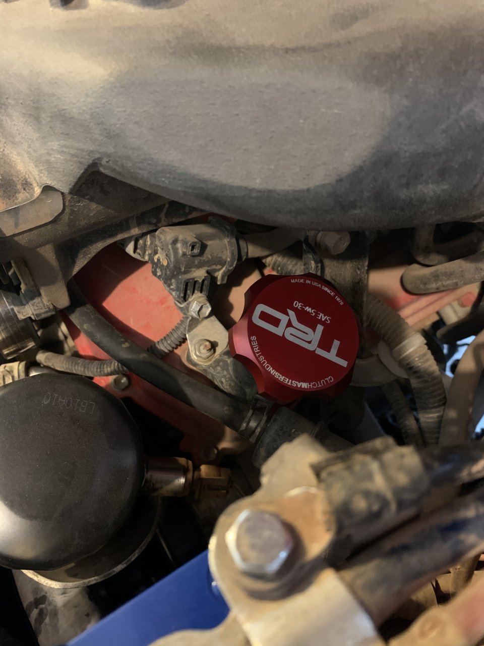

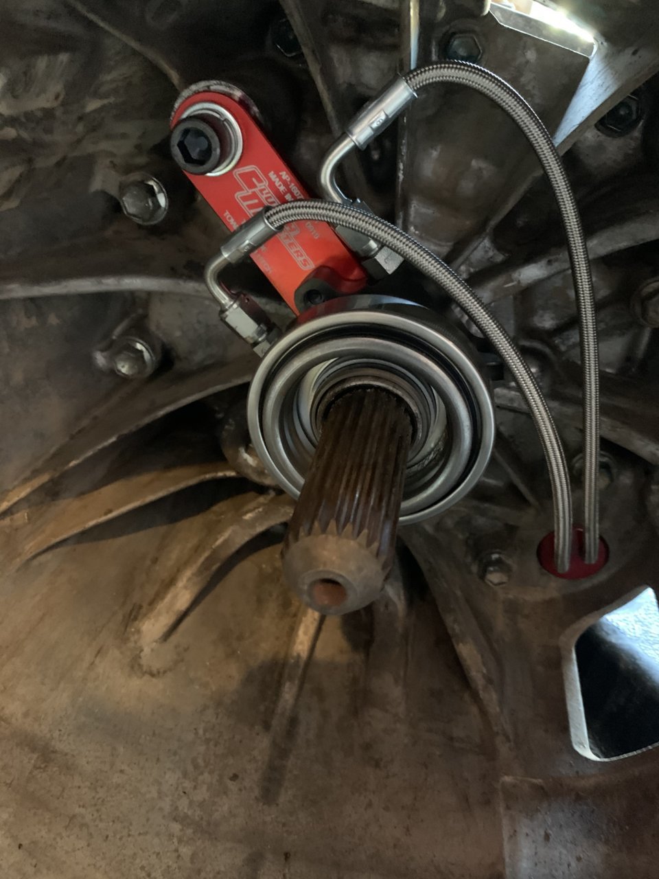

    Did a thing. Had to remove the steel sleeve for the throw out bearing and that sucked. Sucked trying to get transmission reinstalled. Also replaced the fj case. Old one had a crack in two places and leaking. Also won’t be twin sticking this one. Don’t feel the need. 1156965A-0525-404C-B895-03BFF2A319A3.jpg97A0EA38-518A-4462-B372-5006765B5B10.jpgFC66AB75-EAD0-4B63-9420-22E8A62A7EF1.jpgD7FDF693-6ED8-4336-A098-C4E4EC784DC7.jpgA1624500-7FC0-4C9B-8616-049BCCDF2341.jpg

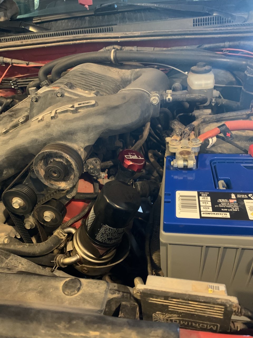

    also got a oil cap too
    ready6delta, NYCO and 6 gearT444E like this.

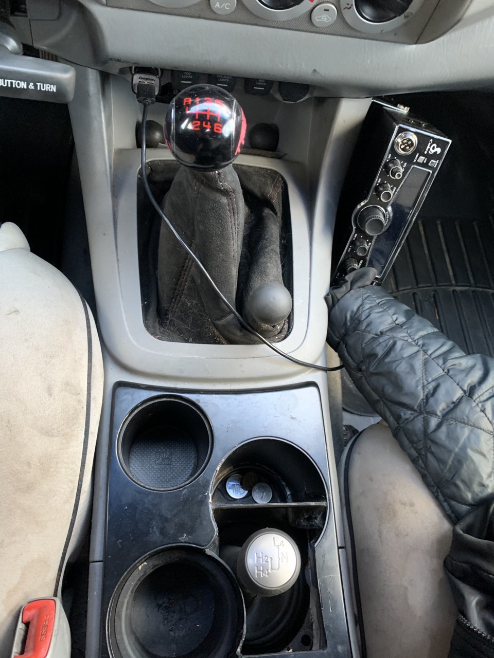

    Got my single shift fj case shifter bent back to the right spot after putting in a new tcase. EC0EAAF3-DC82-4EE8-8D94-98CE4D3C802C.jpg4B11E5BB-7EEF-4DAE-828F-A6178D36C5AA.jpg

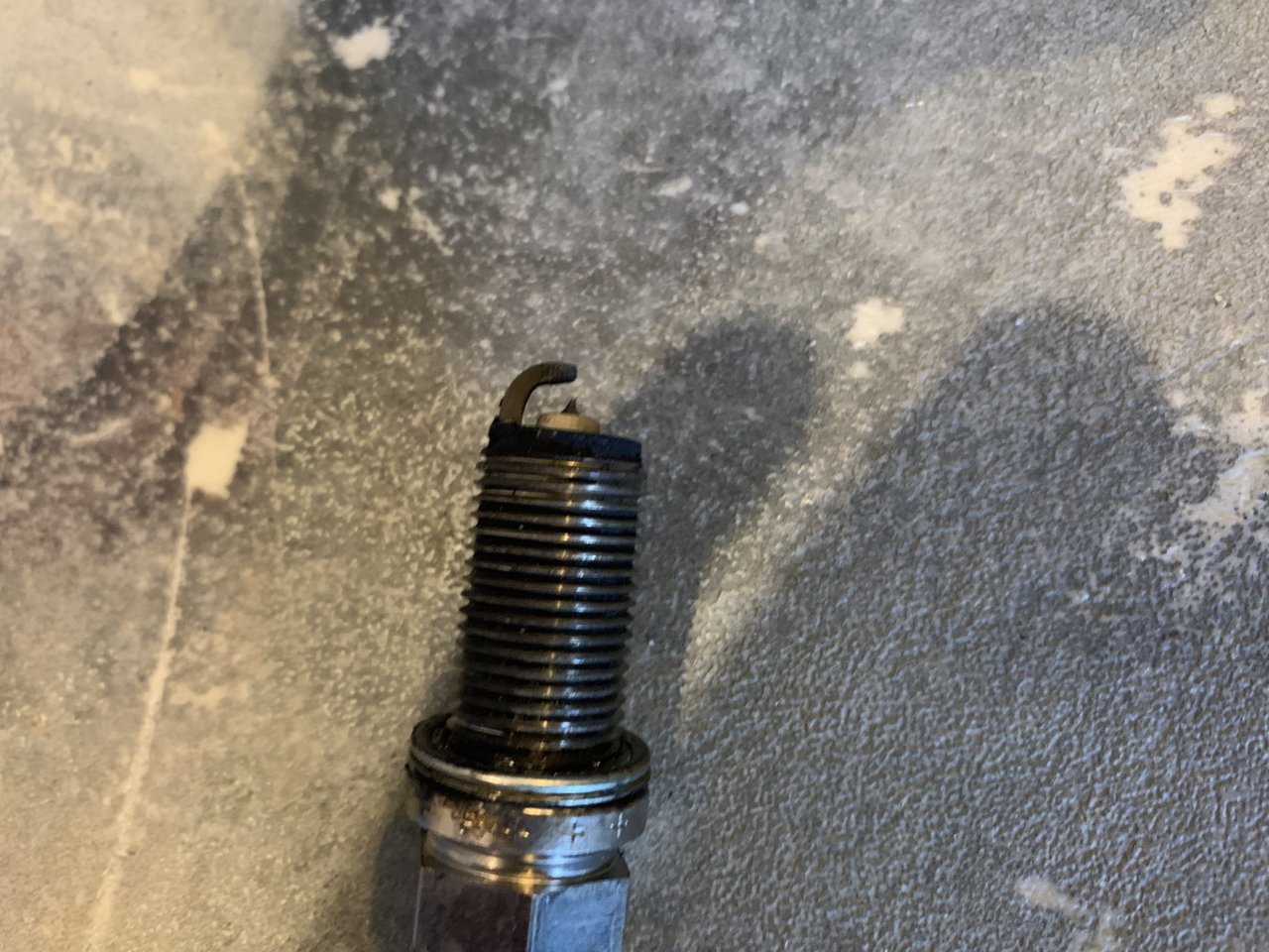

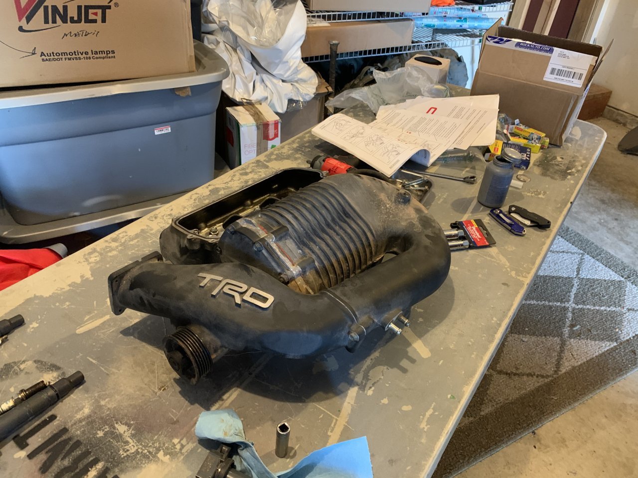

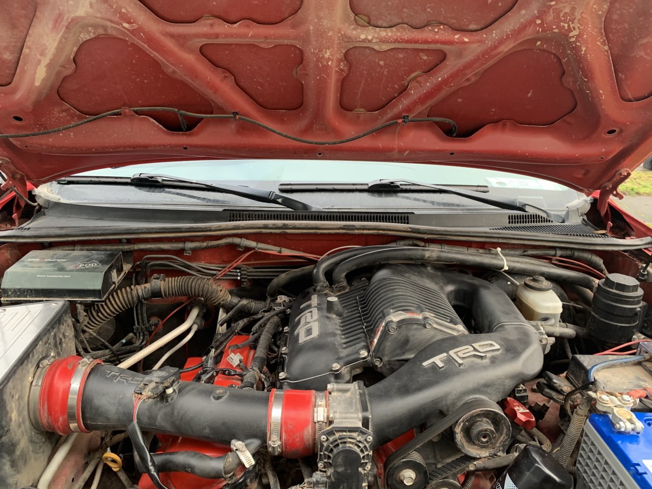

    So i was having a P0304 code popping up when i got into boost then turned into p0300. so figured it was either a spark plug or coil pack. decided to replace all spark plugs and also the coil pack on cylinder 4.B3E8E472-729D-44C7-A93C-73097AD19719.jpg 0B6C0835-7F12-4BAF-AE48-A52C9BA86594.jpg
    All plugs were gapped between .045" to .055" the manual for the supercharger states .032" below is pretty much what all the spark plugs looked like
    also i cleaned up the supercharger and adjusted the boost valve on it. everything is better and it feels like it runs better and pulls better when in boost now.
