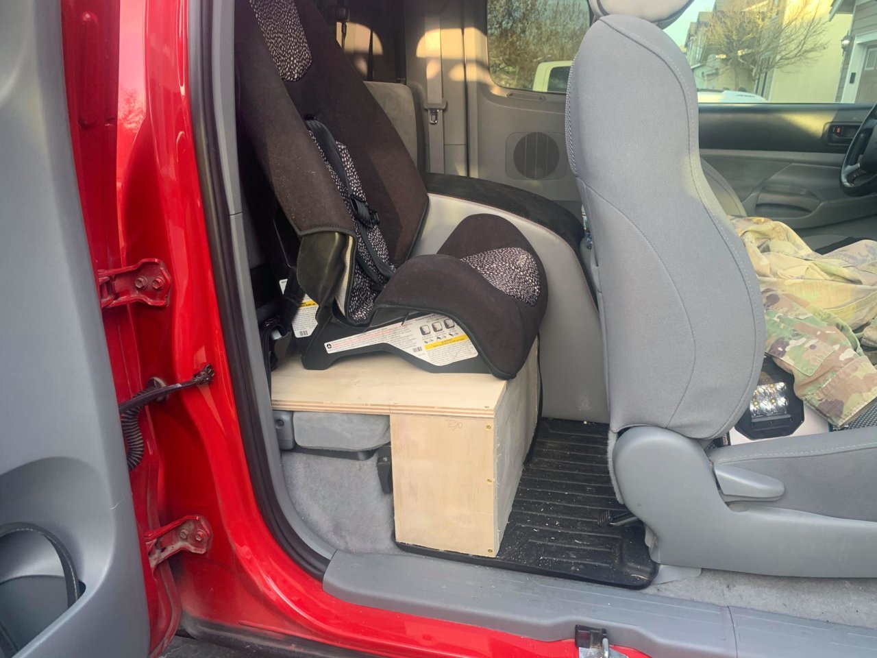

    little platforms for the rear seats and mainly to steady out the car seat.. just need to carpet these and the bed platform.

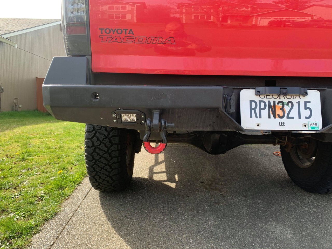

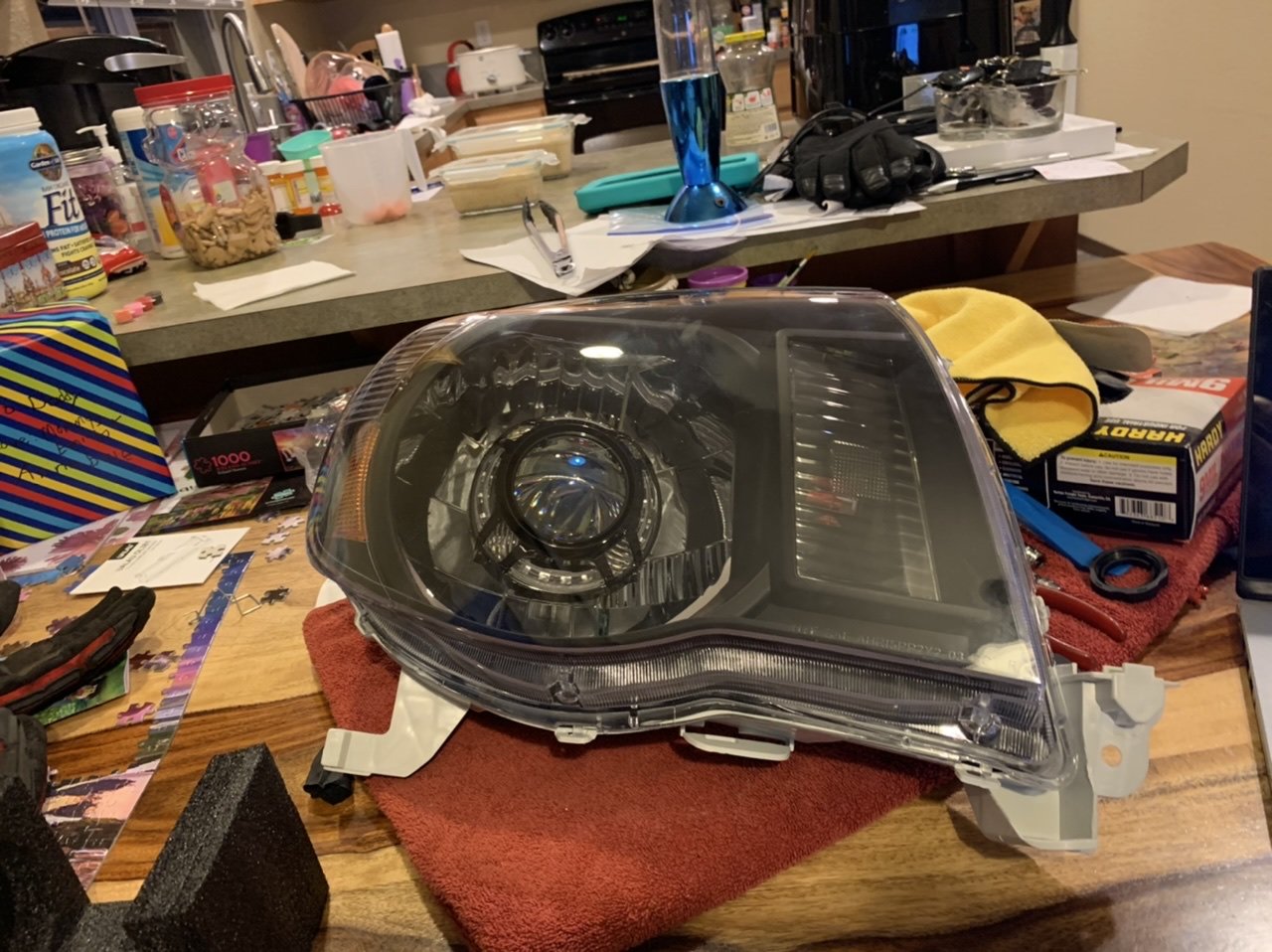

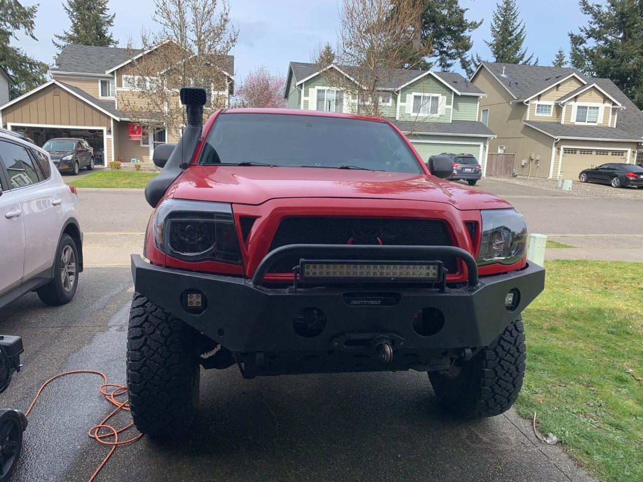

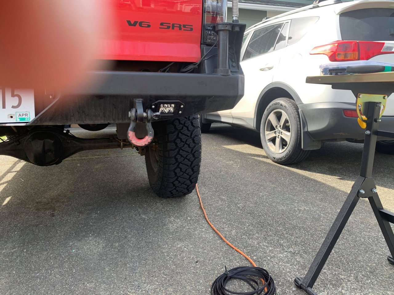

    Finally got my new projectors and headlights installed. the old ones were looking bad. plus one of the LED halos went out. Also installed some flush mount lights in the rear bumper.

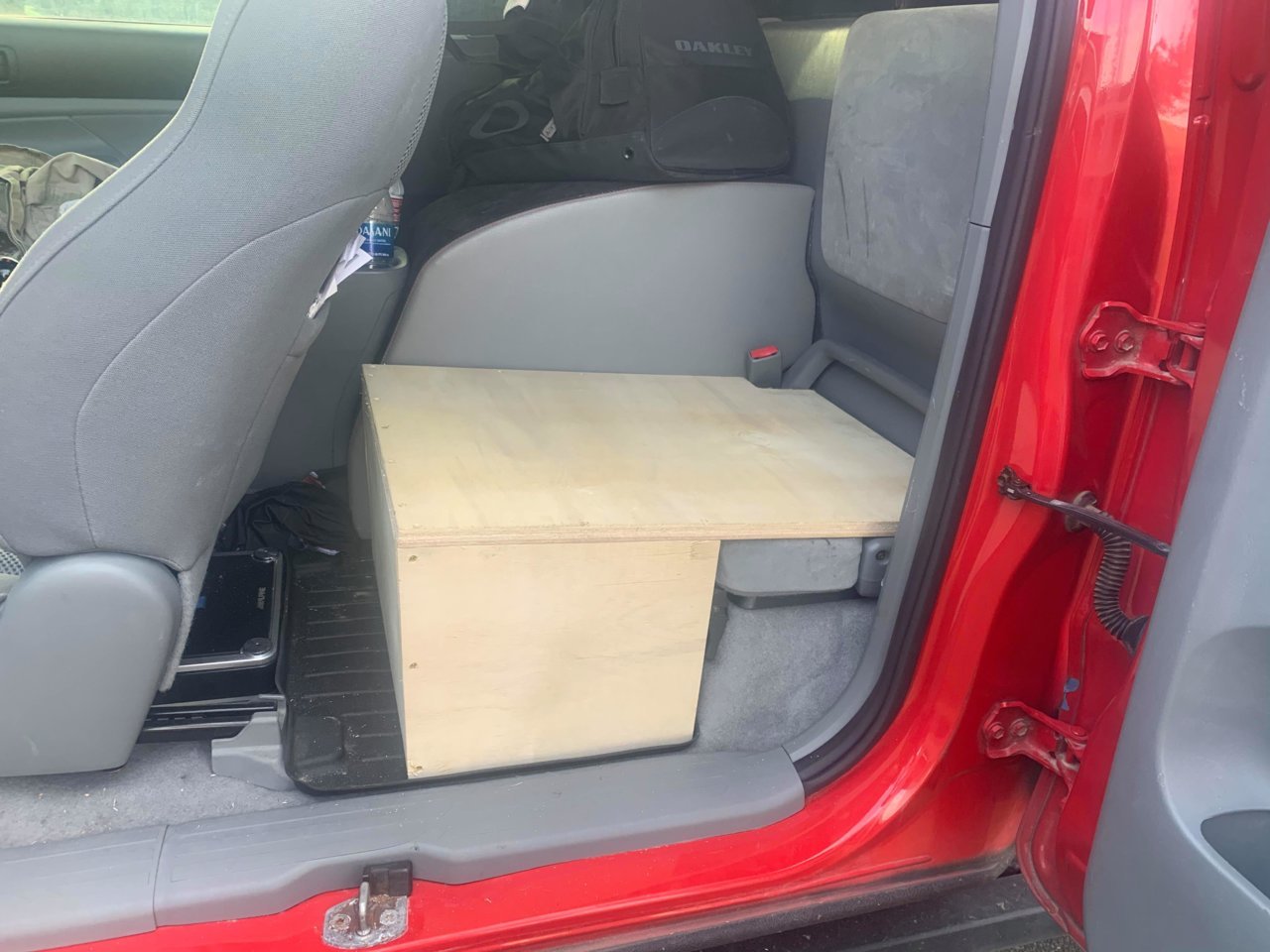

    Finally finished up putting carpet on the platforms I put in the back seats.

    Amazing that you got a car seat back there
  8. Apr 5, 2021 at 3:50 PM
    #628
    wrmathis
    wrmathis [OP] Dark Lord of the Sith
    Sep 10, 2008
    #9126
    9,428
    Bonaire, GA
    2006 Tacoma TRD OR 4x4
    parts and stuff
    Yeah. My daughter is almost 5 and fits perfectly back there. Also my wife is 5’1” so that helps too

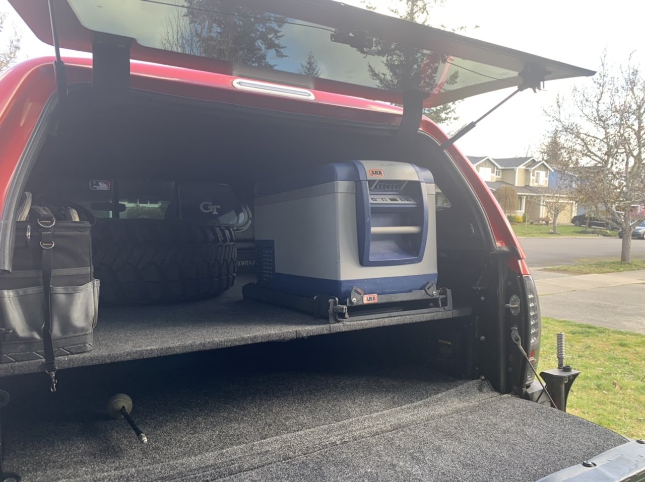

    Got my ARB fridge and slide mounted.

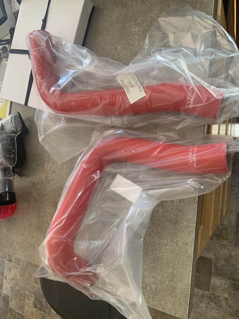

    Got these in the mail the other day

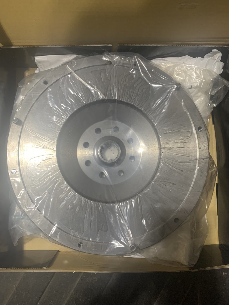

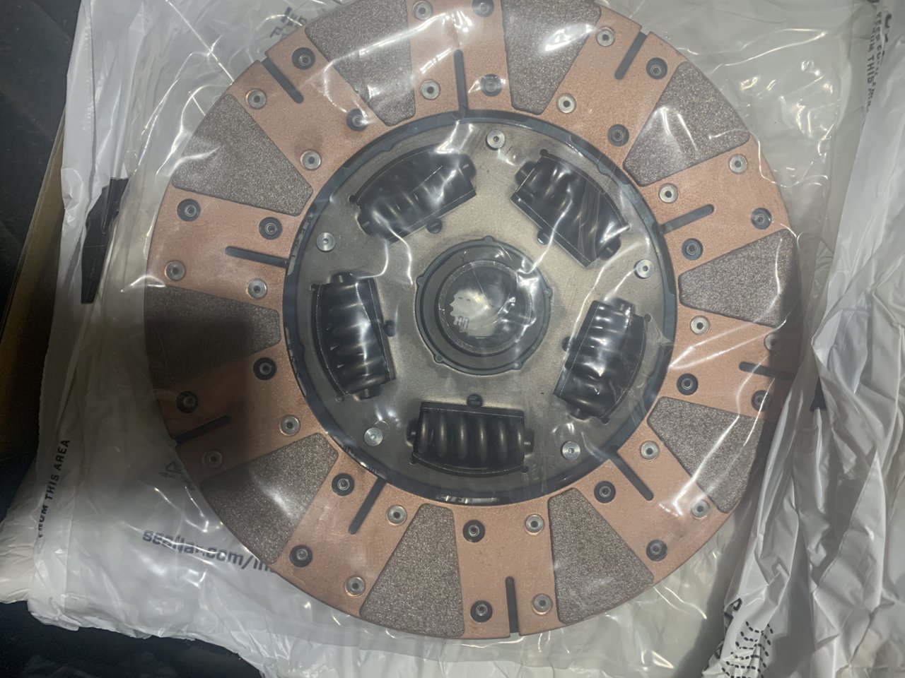

    Got these in the mail yesterday. Urd heavy flywheel and stage 3 clutch. Total weight of the box was 72lbs. The fly wheel is one heavy bastard.
