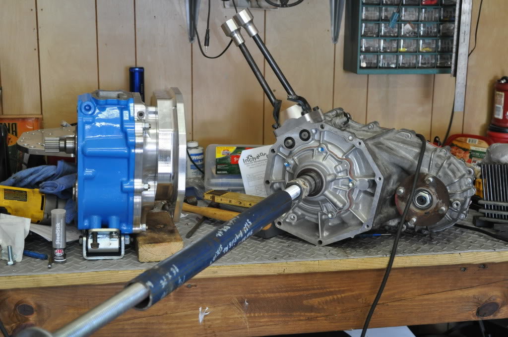

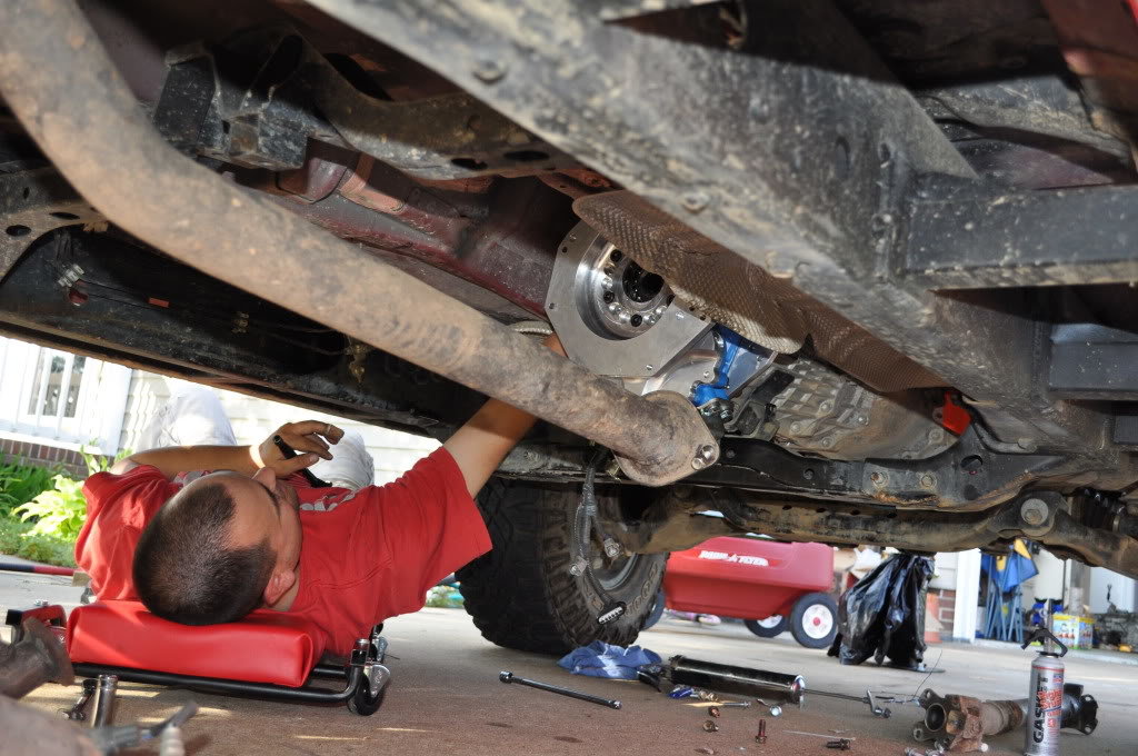

    this is my installation of my inchworm 4.7 crawl box and fj tcase with twin sticks.

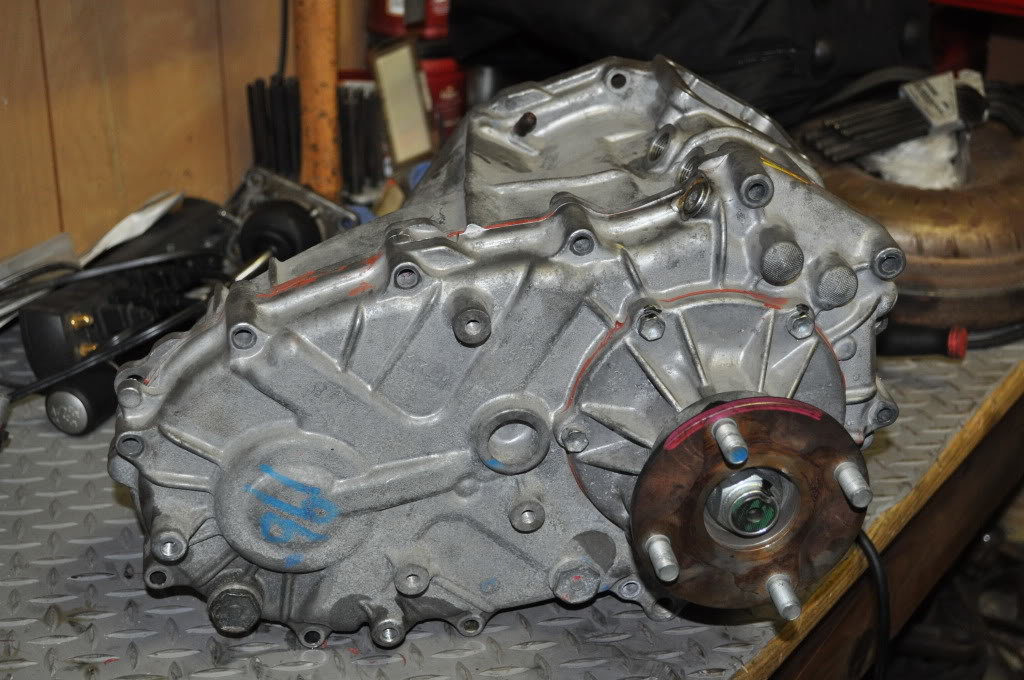

    this is a picture of the fj case that i bought off of ebay for $525 shipped.

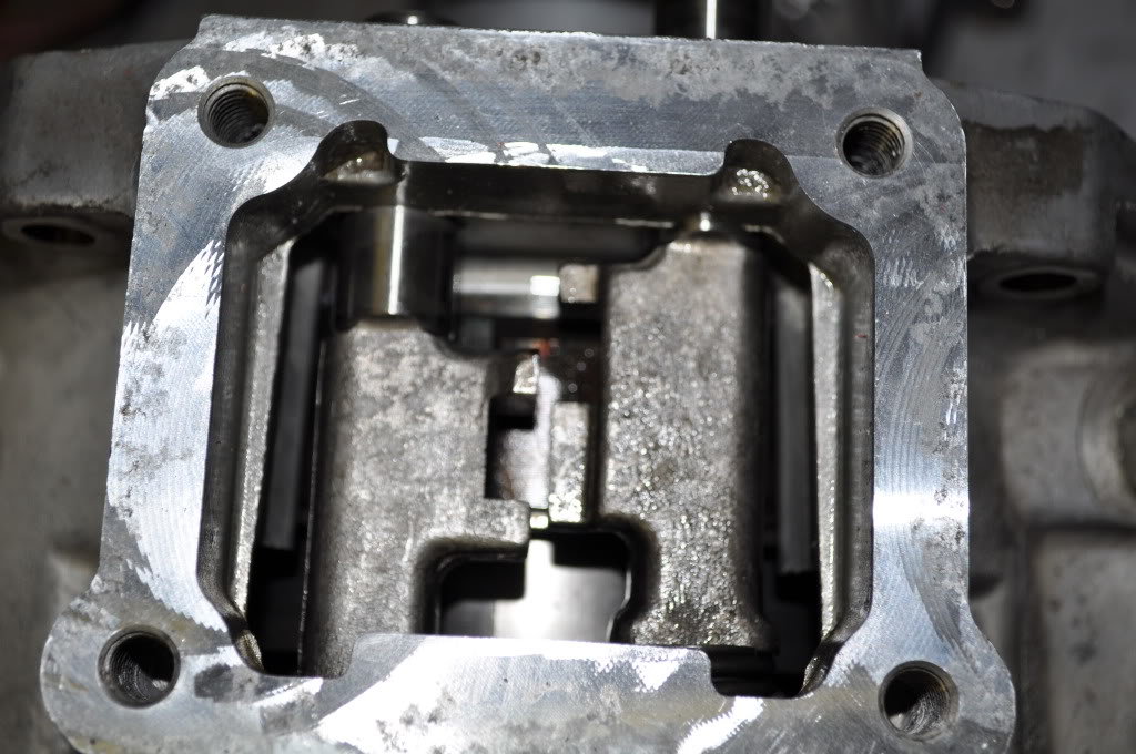

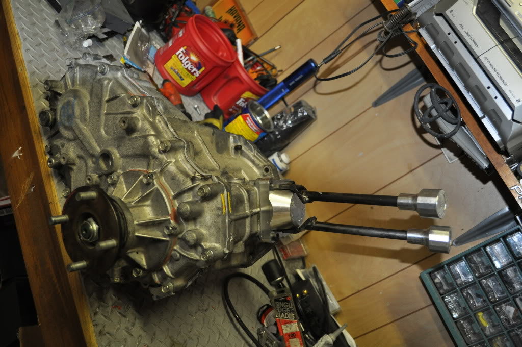

    here are two pics of the twin stick mod done to the shift rails. Dont have any pics of tearing the case apart. Wyatt has a good enough write up for that. This was very easy to do. we didnt lose any of the keys or have to even deal with them. Just pulled the one shift rail that needed to be modded and put it back on and everything works great with it.

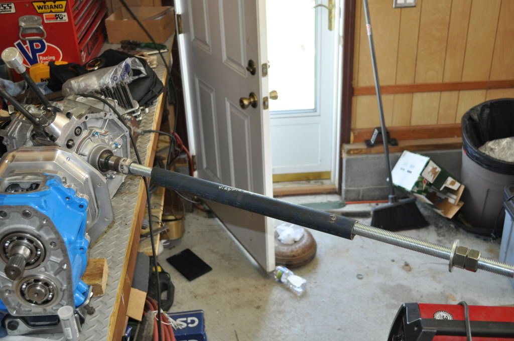

    next we had to take the little sleeve thing off the input shaft. didnt know how to do it and txted Wyatt. he said weld a nut to the end of it and get a screw to screw it off. Thats what me and Barry did except after gettin everything ready to screw off, we realized we didnt have a second wrench big enough to hold the input shaft still. well we came up with another idea and all we had to do was add a pipe. we made a slide hammer out of it and after three good whacks, it came right off.
    so after all this, my FJ Case was ready to go.

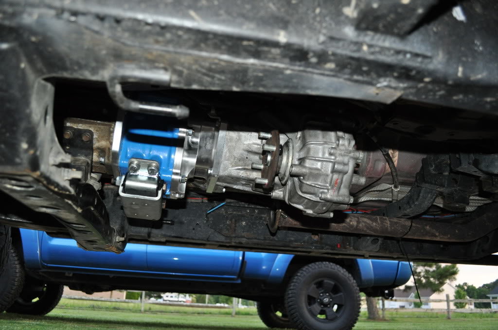

    The next three pics are of the crawl box being installed/installed. this was probably one of the easiest parts to do. Also, my girlfriend got me that creeper im on and damn, one of the best things i could have gotten before doing this job.
    The next two pics are of the shifters. We didnt mess with the twin stick shifters since i was happy were they came up in the console. we did have to move the crawler shifter forward and to the right just slightly. i gotta get another shift knob for the crawler shifter. I am using the FJ J-shifter knob for now
    The final pic is everything installed. We clocked it at only 5 Degrees. ill probably keep it like this for a while.

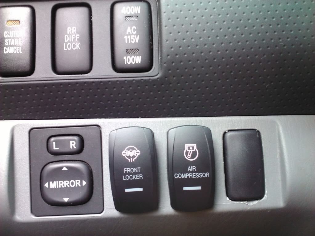

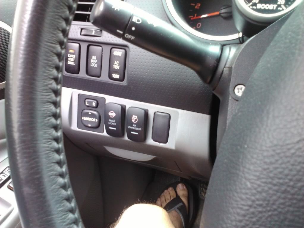

    The electrical part of this was easy. i had wired up the switch wiring harness like 2 weeks before i even ordered my parts. all i had to do was thing wire the the harness into the correct wires. also did the anytime locker mod since it was needed and right now it works, but backwards. to have it unlocked, i have to have the button pressed in. to locker the rear, i have to depress the switch. everything works like this correctly, even the dash lights. just probably got a couple of wires backwards. will correct this sooner than later. just need to get the motivation.
    all in all tho, the electrical part was easy, just a little time consuming trying to get everything nice and neat and done correctly.

    yeah we had to take mine apart twice cuz we didnt grind enough off the shift rail
