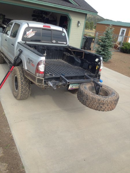

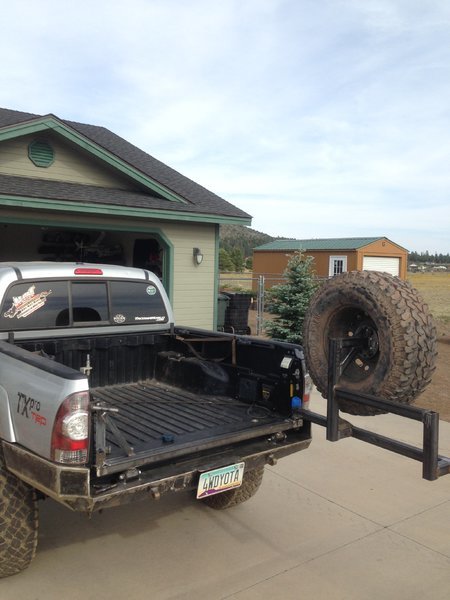

    Dual action tire gate in the making.

    I wanted a swing out tire gate, but also put motorcycles and atvs in the bed sometimes, where the tires overhang onto the tail gate. So I need it to swing down as well. Can't really have the tire gate open while driving down the road with the bike in the back and tailgate down. So this is my answer. Plus I will be able to suck the tire into the bed a little so it overhangs less so it doesn't drag while doing steeper rock crawling type stuff.

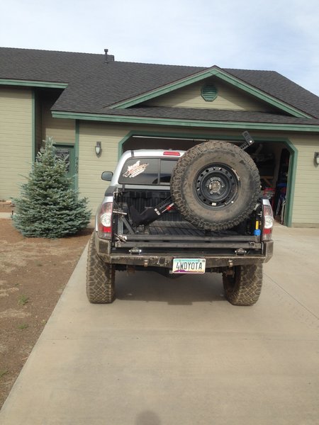

    She's at least done enough to drive around on and be structurally sound. Just have a long list of little things to get done on it.

    Gonna make my check list here so I don't forget what I still need to do.
    Cap open ends of tubes
    Mount bottle opener
    Mount hi-lift
    Make back-up camera mount
    Make mount for factory tailgate cables for added support when dropped down
    Decide on drop down table or not and either make it or just fill the back side with plate sonit can be a tailgate when dropped down.
    Fuel can holder, though may wait and get different fuel/ water containers before making this.
    Paint tire carrier and bumper
    ??? I'm sure I'm forgetting something
