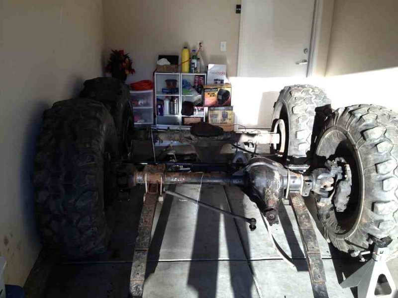

    Looks like a nice Ford HP D60 right there!! That's a very nice find. :drool: :eek: What's that rear axle? It looks quite a bit narrower than the front... What size are those tires? Looks liek they're almost bald... What are the rest of your plans for the swap? Any plans for dual t-cases are will you just run the stock chain driven case? What size coilovers are you hoping to run? Going to use a kit for the links? Plans for the gas tank? Or are you kust doing COs up front....?

    The rear axle is a sterling 10.25. I will be using ruff stuff 3 link kit in the front and the rear with ads coilovers, probably 14" but maybe 12" if it it will fit. The tires are 42" and they're pretty bald, only about a 1/4 of thread at best, but for right now I'm just doing the basics to get it done, and for the price I got them I figured why not.
    I do plan on getting dual cases, but like I said right now in doing the basics to make it run and ill upgrade as I go along, dual cases, new tires, chromoly shafts, 31 gallon auxiliary tank, and then full cage . But this all cost a lot of money that I don't have so it's going to take some time lol

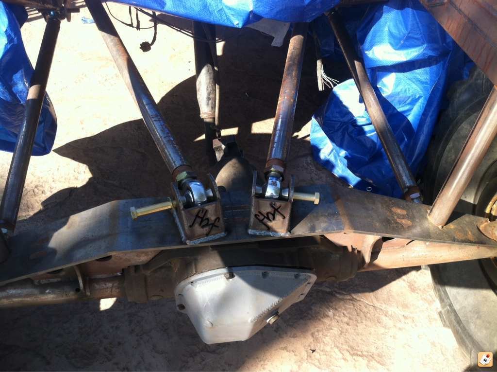

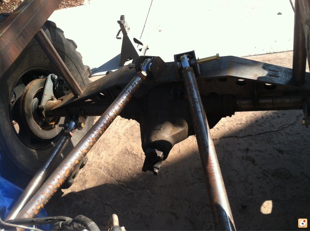

    Finished rear axle (10.25 sterling) with artec truss and ruffstuff disk break conversion and diff cover. All it needs now is paint (going under the truck today)

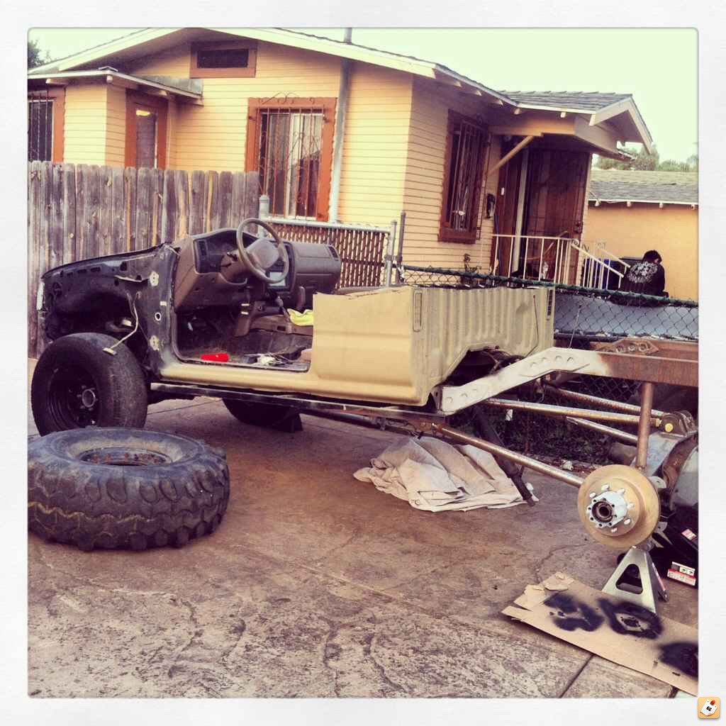

    So this weekend we got the frame chopped off, and made a new one using 2x4 square tubing. It's shorter than the stock frame and much high for more clearance. Also got my rci 22gal fuel cell in, and got the back half base color painted for the desert camo paint job.

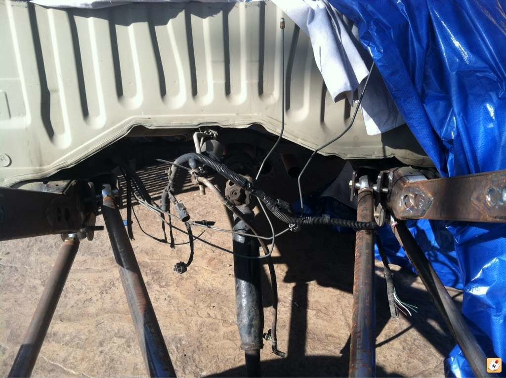

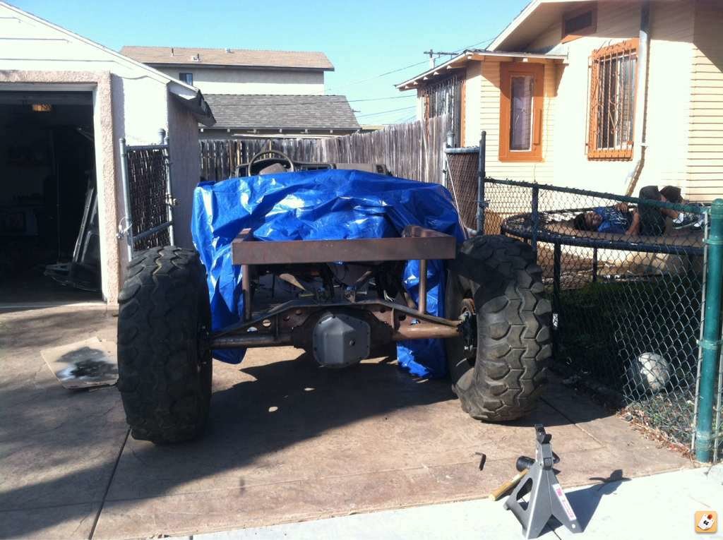

    I haven't updated this in a while, I've got my links in the rear finally and the truck is on it's own weight, but no coilovers yet, I'm going to have that stuff done last to make sure the ride height is the same front and rear. Decided that since I'm doing an Exo cage why not have a convertible Tacoma? Chopped the cab for some cash and am getting ready to take apart the front just need to sand and primer my rear. So much to do, but the possibilities are endless

    Question for ya!
    Still have any blue prints from the design around? I'm working on the same 4 link setup on another rig. Why did you put the top two links angled like that to the pumpkin? At that angle rather than straight 90 degrees to the axle dont they arc out at opposing angles throughout full travel?
