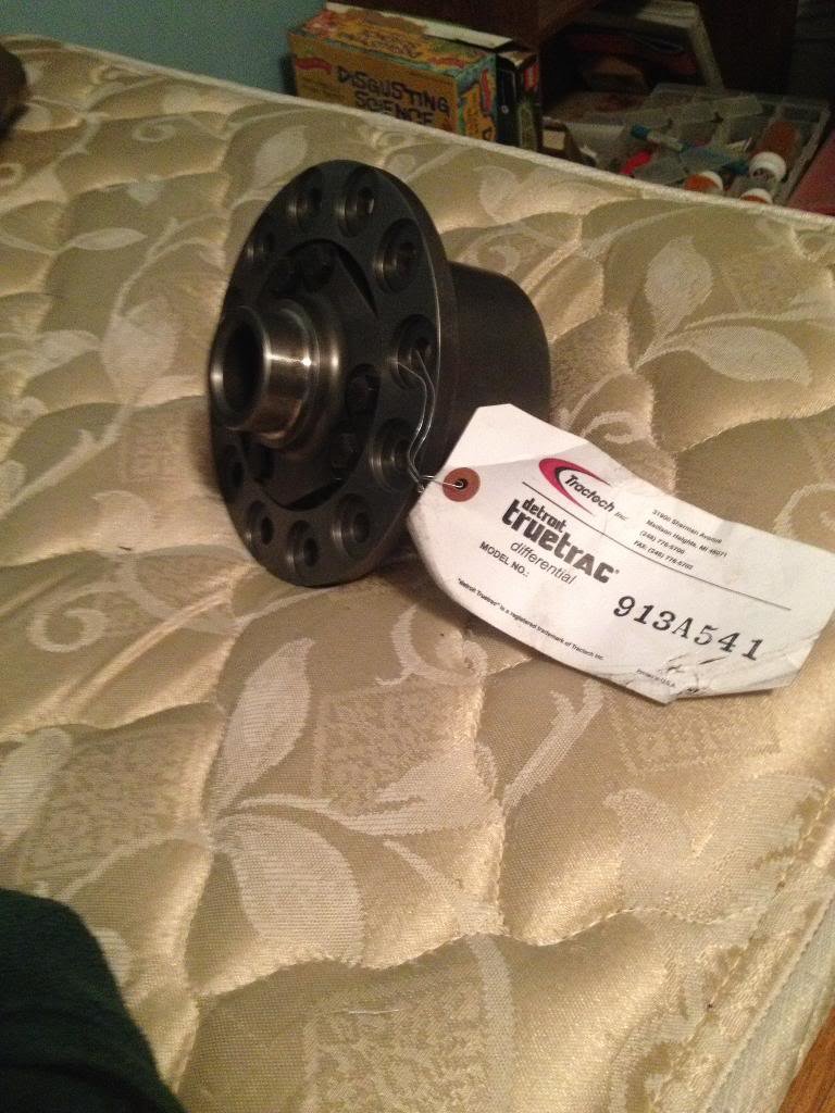

    Whoa whoa. Positraction only lol :p, but would you be talking about this :D. 50C7ECF8-1B9B-49CA-8153-93F5EE40C778_zps_f5a7118518ee0c73f5bbb2ed4315f39830e35a7e.jpg

    When are you gonna get time to put it in?
    Hey now no illegal talk on tw! :p but I must say that's quite an accomplishment!

    That'd be sweet! Is it to hard to do by yourself?

    I've never done it and don't wanna try by myself. An I would need a press to put the new carrier bearings on. It entails pulling both axles out, unhooking the driveshaft, the unbolting the carrier, then you can take everything to a bench and basically just dissemble everything, put the old gears on the truetrac, and reinstall everything in reverse
